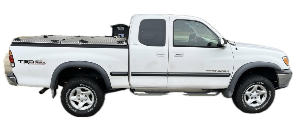

    IMG_8119.jpg Thanks to everyone who replied. Cost/benefit led me to have the SPC upper control arms installed. Afterwards I discovered a friend has JBAs on his gen3 and might have used those instead.
    Previously steering rack and tie rods done in 2024, so almost everything having to do with steering or suspension was replaced, including OEM Toyota lower ball joints, lower control arms, Eibach front springs, Archive Garage MD rear leaf springs, new bump stops, sway bar end links, leaf spring brackets, pretty much every rubber bushing I could replace… and Bilstein 6112/5160.
    Cracked rear transfer case replaced over Christmas & added skid plate (nobody would weld it) so only the front bumper & skid plate remains to be done.
    I’ll run the transmission until it fails, then replace with the later unit.
    Very pleased- drives and handles like a new and different truck. No off-road use yet, but railroad crossings and potholes no longer result in wallowing. Stiffer response, almost like a European car.
    Concluded a backup camera will be useful as the rear lift obscures my view in parking lots.
    Only downside: the tires are new, and a buddy asked me “are you getting bigger wheels? It looks like your truck skipped leg day.”

    Yup, I recommended JBA above. It's a killer option if you don't need the added adjustability the SPC offers, which ... One, most people don't, and two, trying to find a shop that understands how to adjust them has proven difficult for myself and others. My shop has a bunch of offroad heads working there, and they refused to touch the UBJ top nut on the SPCs. I think most people doing a standard lift and not going wild with their tire/wheel option are better served with the JBA. Far better than the tubular bullshit garbage KSP, Freedom Offroad, and others are putting out there. Pro-tip on the SPC's - if anyone ever touches them, always (A) make sure their upper balljoint and its retainer is properly centered in the slot and (B) the toput is properly torqued to spec after. Especially after alignments. If that top nut comes loose while hucking it, after hitting a big pothole, you're paying for a new alignment. It's one of the reasons the Toyota shop I used for alignment doesn't recommend them, and won't touch the UBJ top nut.
    Camera: This may help.
    Tires: You don't need bigger wheels. Yes, the truck would look better with 1" more tire. Those OEM starfish are 16" and I think the stock tire size is 265/70r16. If you were to upsize 1" of meat to 265/75r16 it would probably make a substantially visible difference. Pro tip: You may be able to find a used set on FB Marketplace at a reasonable price. After buying 275/70r17 for my truck, and wanting to test out how it looked if I'd have gone with 285/70r17 (spoiler: Visually at 10ft away it was almost ZERO difference in the added 0.4" of tire), I sourced a set of used Wildpeaks in 285/70r17 for $320 mounted to steel wheels. I sold the wheels for $125, ran the tires for a while, hated them, went back to the 275's, sold the two better 285s for $200, and recycled the other two. It was a break-even for me, minus the tire mounting costs.
