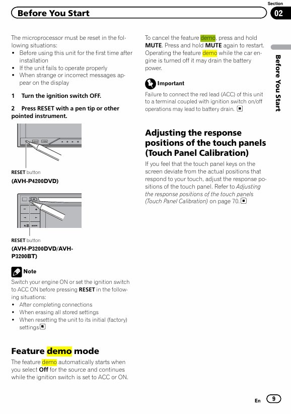

    The first thing I would do is turn off the DEMO mode..:D
    If all this happens again, I'd reset the HU.

    LOL . . . I had done that countless times . . . . it just fired up on it's own.
