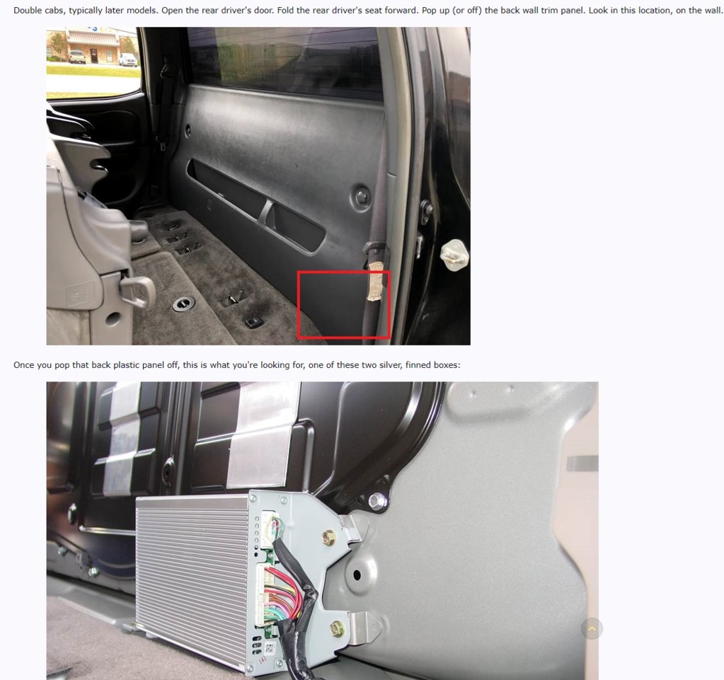

    The amp you’re looking for is the factory amp. It’s usually behind the seat in DC trucks I believe.

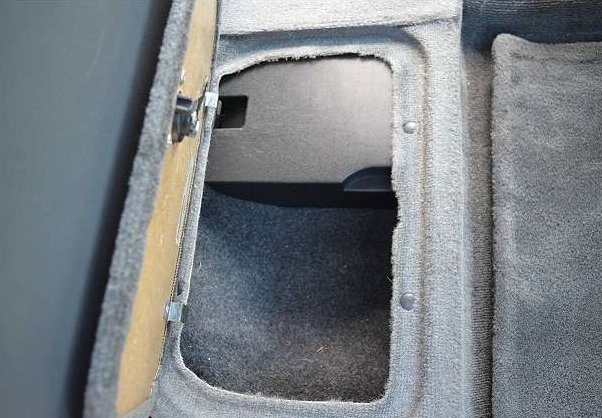

    In the '03+ years, the factory AC amp is under this plastic cover in the storage cubby.

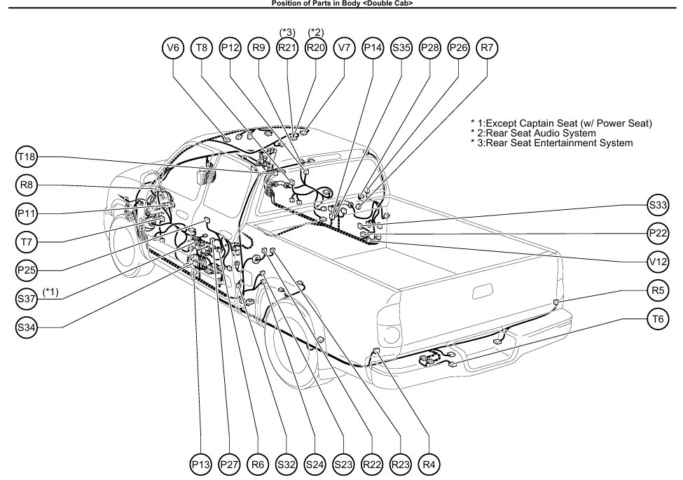

    Yeah, check the thread @KNABORES linked. It has everything you need to know. And there's a very strong chance if the PO didn't bypass the amp, that's your issue. In which case you just need to get the apropos bypass harness and spend 1-2 hours removing the Crux or Axess unit they wired, and replacing it with the bypass harness. It's pretty easy job.

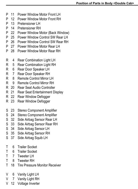

    ^ This.
    If the radio had a separate factory amp, it would be behind or under the back seat.

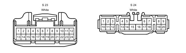

    S23 and S24
    HBTundra[OP] likes this.

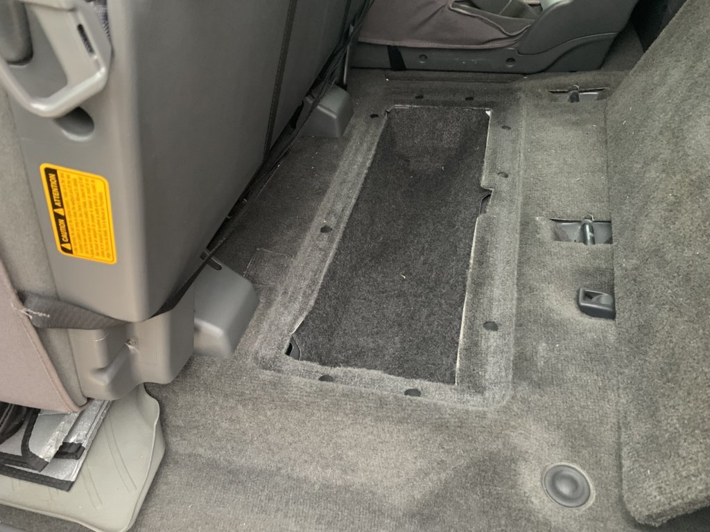

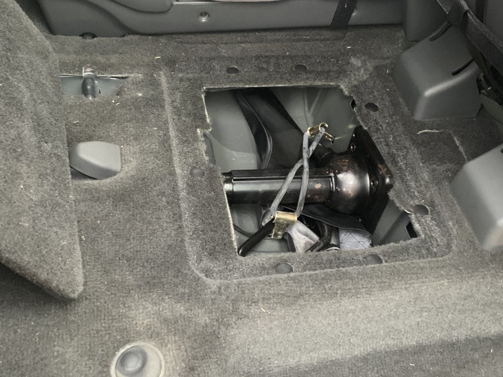

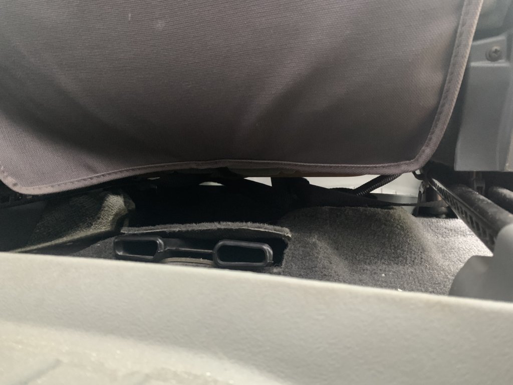

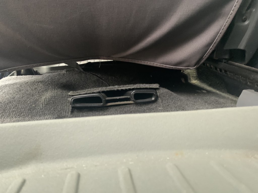

    Nothing under the rear drivers side seat . . .
    The passengers side just has the factory jack . . .
    Nothing under the drivers seat . . .
    And nothing under the passengers seat . . .

    It's behind the plastic panel, driver's side, mounted to cab wall as @KNABORES and @1lowlife said, unless you have the 6-speaker config w/no amp. See the thread K linked.

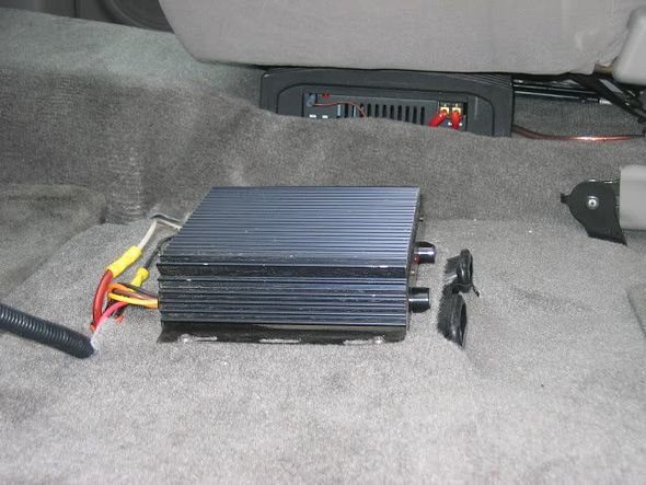

    AmpMount3_fee17d1aaa554a5e94be9f502a0f1aa4be568648.jpgAmp2_0fb79b1d11d59214e132b061160041171d76cce8.jpg
    They don't make them like they used to.

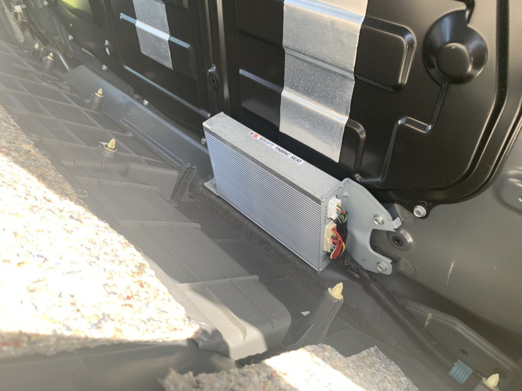

    Pulled the back panel . . . . JBL . . . . stock unit I'm assuming?
    KNABORES likes this.

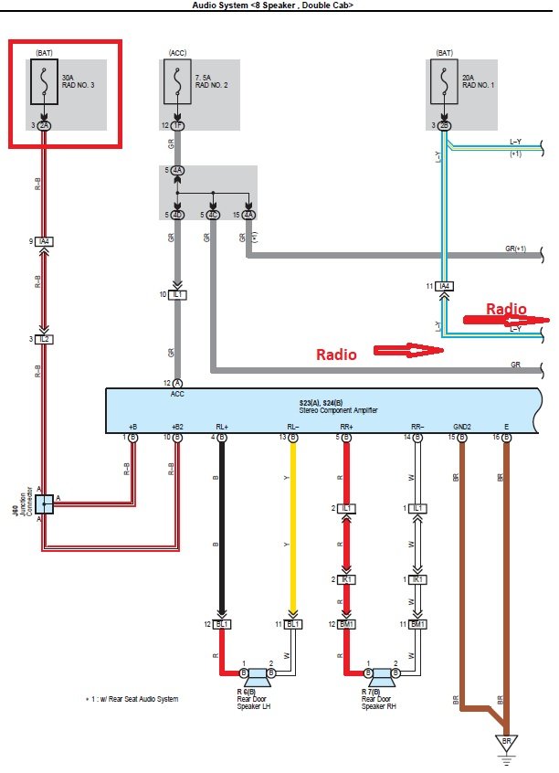

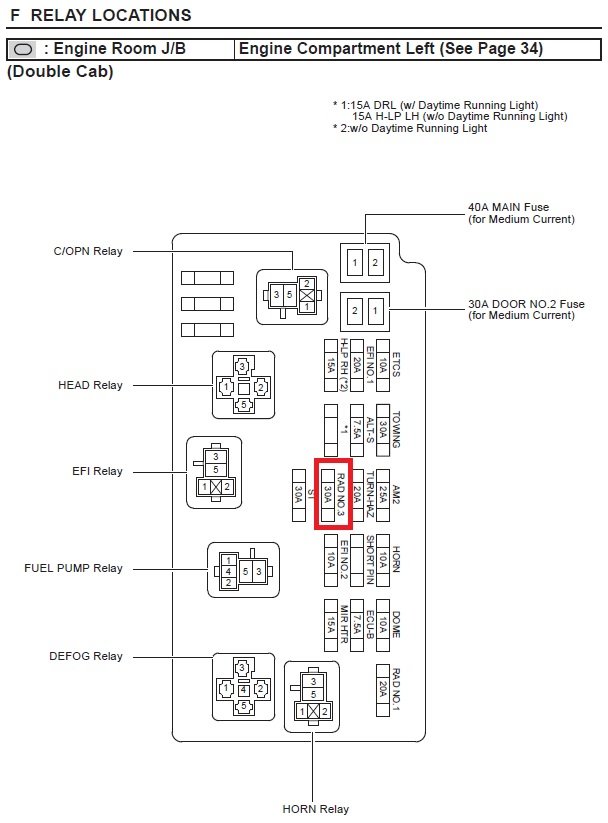

    In case it helps, what work were you doing ?
    Was the key in IGN ON position with radio possibly on ?
    Have you checked fuses underhood, in particular the 30A RAD NO 3, which is the fuse that protects the amplifier. The radio itself is protected by RAD NO 1(BAT)/RAD NO 2(ACC) which appear to be good from what you describe.

    Just re-checked Rad-1 , Rad-2, and Rad-3 fuses . . . even checked continuity with a fluke tester to make sure.
    They're good.
