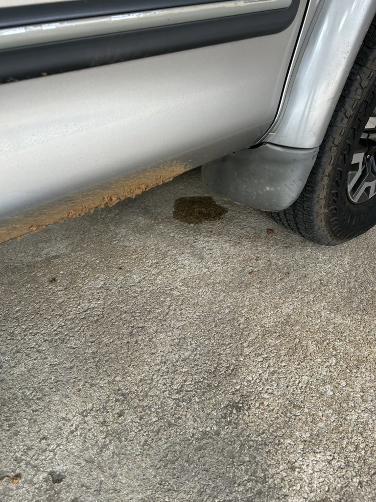

  21. Dec 14, 2024 at 9:35 AM

  22. Dec 14, 2024 at 10:39 AM
    #52
    shifty`
    shifty` We call it “riding the gravy train”
    Jun 20, 2020
    #48239
    29,825
    ATL
    '06 AC Limited V8/4WD
    That's the evaporator coil housing drain, it drains condensate from the evap coil.
    If you pop off your blower motor resistor and carefully remove, you can look at what's inside the housing that's draining.
    Was your truck HVAC controls in defrost mode or foot+defrost? If so, the A/C was on by design. I can't recall if having the cold set all the way down plus one extra bump will also engage A/C or not.
    What does the liquid smell like, look like on a paper towel?

  23. Dec 14, 2024 at 11:05 AM

  24. Dec 14, 2024 at 11:27 AM

    Upshot Knothole

  25. Dec 14, 2024 at 11:30 AM
    #55
    shifty`
    Jun 20, 2020
    #48239
    29,825
    ATL
    Yup, that's how I found out A/C comes on while in defrost mode. I was driving on the interstate and power was surging, RPMs dropping periodically and I thought something was wrong, then someone asked the defrost Q. Indeed, RPM/power drop happened every time the A/C compressor kicked in.
    There's a hack you can do to disable this automatic function. Not recommending it, and I haven't done it, but others have.
    It's just condensate, then. You were in defrost mode. The A/C was running automatically.
  26. Dec 14, 2024 at 12:04 PM
    #56
    Desert Dog
    Desert Dog Nobody rides for free
    May 29, 2021
    #63643
    1,338
    2001 SR5 AC 2WD 4.7l
    Bilstein 5100's, SPC UCA's, ATS HD leaves
    Yep, nothing to worry about. It's actually a good thing having the visual. It shows the system is working as designed.
  27. Dec 14, 2024 at 12:52 PM
    #57
    Griff04
    Griff04 [OP] New Member
    Nov 15, 2022
    #86804
    134
    Ralph
    Southwest Georgia
    2006 V6/2WD/AC
    None
    Thanks, feel a lot better now. I didn’t post it but after resolving the heater issue I had a brake line that split. I didn’t have time to deal with so I took it to the Goodyear shop for repair. The ole Tundra has been dang near bulletproof for a long time….was beginning to worry about it just a little bit.
  28. Dec 14, 2024 at 1:51 PM
    #58
    bfunke
    bfunke Tundra Curmudgeon
    Oct 13, 2019
    #37321
    2,493
    South Carolina
    2018 SR-5 CM 5.7, 2000 SR-5 AC 4.7L
    The condensate drain will drain any water dripping off the evaporator but it will also drain any coolant leaking from the heater core. AC condensate is clear whereas coolant is pink, feels slippery and has a distinct odor and taste if you touch your tongue to a wet finger. Be careful tasting as it is nephrotoxic.
