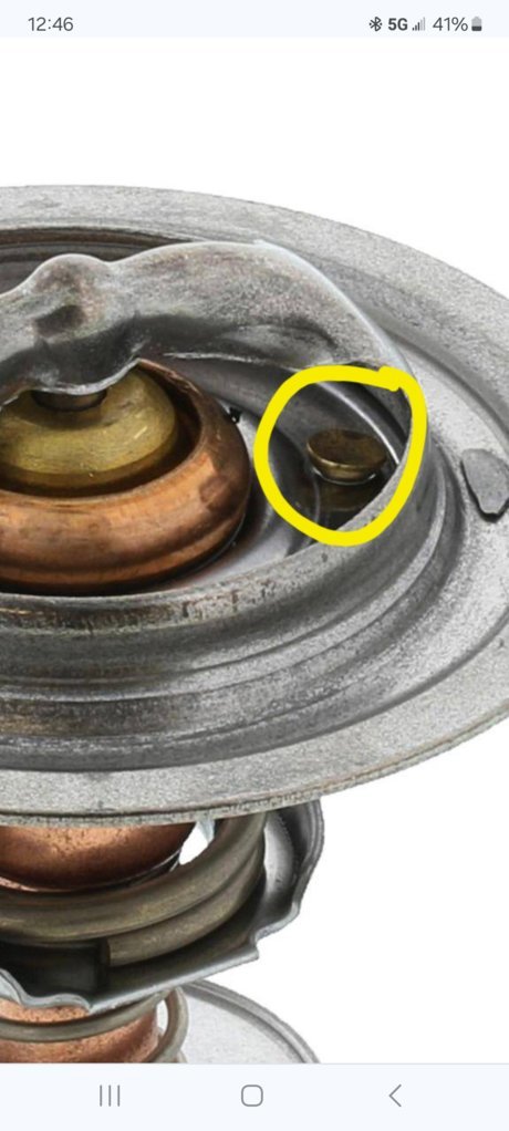

    What exactly is the “jiggle valve 12:00 position”, I’m not familiar with that terminology???
    thx, Griff

    This little fella right here

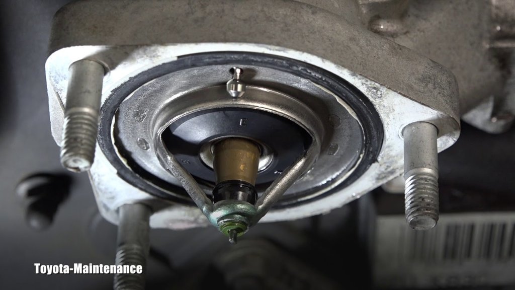

    As BroHon shows in the image, it's the pin on the thermostat. It has to be oriented at the 12:00 o'clock position for the system to function properly. I believe your t-stat is failing and/or air not purged well.
    This is what it looks like installed. Let us know what your remedy is.

    They're installed and positioned at 12 o'clock to prevent air lock and allow any bubbles/air to escape.

    Anywhere from 11 - 1 o’clock will work for the jiggle valve, but it is best to aim for high noon.

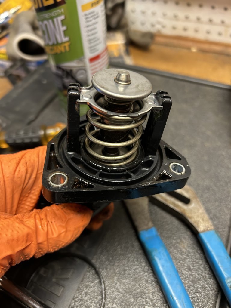

    Okay guys, the pictures of the “jiggle valve” does not match up to what I have in my 4.0 V6, this is a 1 piece until which includes the housing.
    See the attached photo of the one I swapped out today…it did not appear to be stuck open. Picked one up from the local Toyo dealership.
    This did not resolve my issue….same dang thing. May have to look at burping the system if it applies to a v6…..more to come.

    Most of us have 4.7s and don’t know much about the V-6. That thermostat is alien technology to us V-8 guys.

    Sorry, my bad, I didn't even look and see you have the V6 flavor :anonymous:
    That's quite the contraption o_O

    I’ve been fiddling with cars and trucks for 40 years and have never seen a set up like this either.

    Yeah, purging the system of air applies to all makes/models of vehicles. Some cooling system designs just do a better job of self purging -- others, not so much.
    That 4.0 V6 thermostat is new to me too. By its design it looks like it can only be installed one way, so the orientation of a "jiggle"/bleed valve (if it has one) would be irrelevant.
