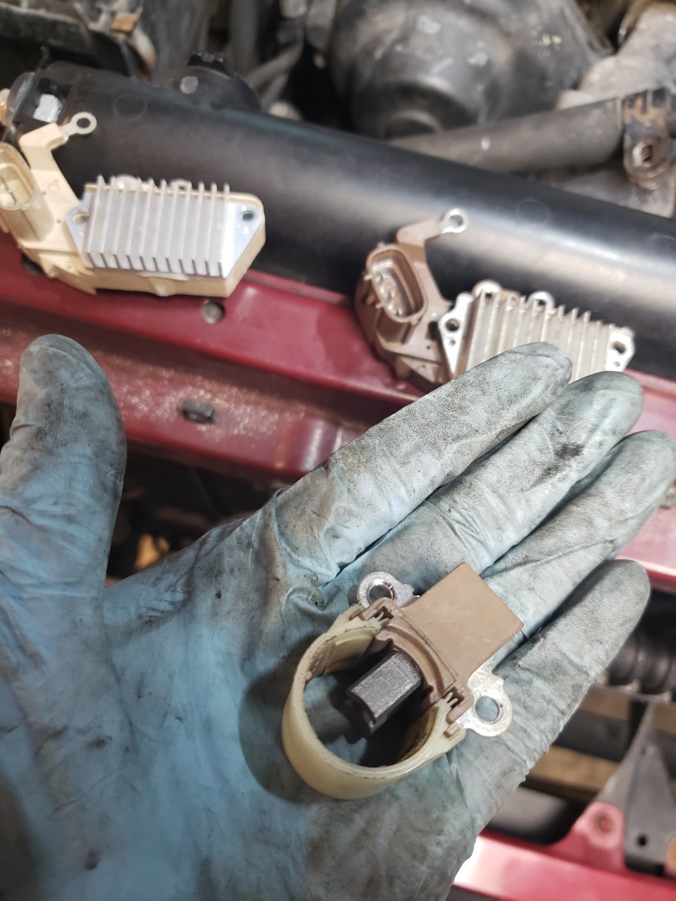

    Usually it's pretty obvious if they're worn out but they sometimes stick in the holders.

    Okay thanks that's what I was thinking. I saw it but didn't play around with it. I'll check it out tomorrow...
    Anything I should be looking for in telling me that it's bad besides the sticking?

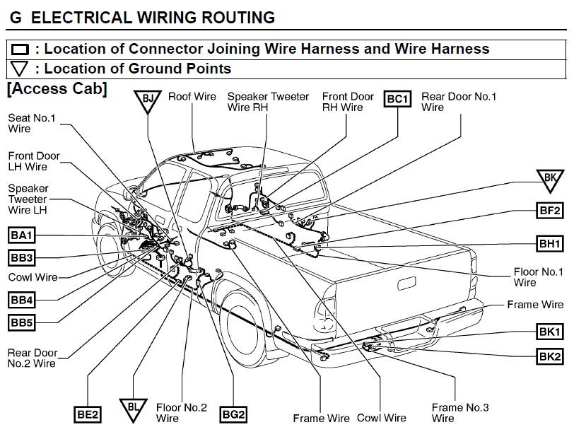

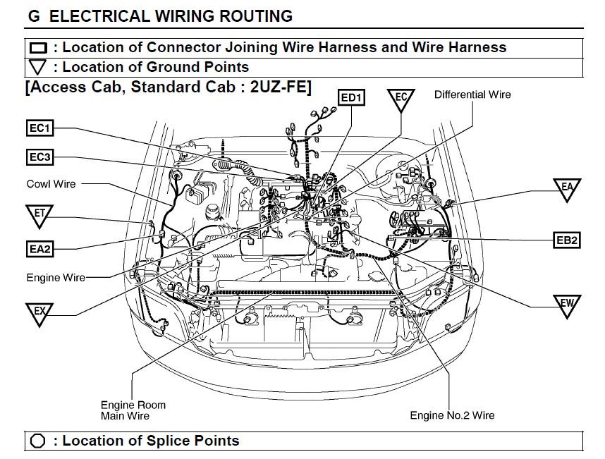

    Thanks for the update. I enjoy when people update their threads with results...helps all of us learn.

    Took it to AutoZone, had everything tested within the car. Battery was fine, starter was fine, alternator voltage regulator failed...
    Before I give up and just buy a new alternator, I'm gonna hit those grounding point with a wire brush.
    The only thing I see is that compared to my 2001 V8, that diagram looks a little different. Some points are missing on there that I see on my car such as the one attached to the firewall.
    After cleaning the connections and the problems still there, then new alternator it is!

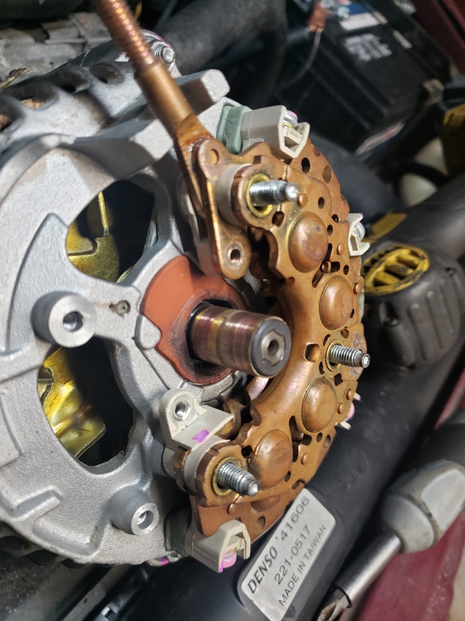

    There is the alternator opened. Took me 10 mins to get her out, I'm an expert alternator remover now haha.
    Cleaned the grounds as well, but didnt see anything too compromising, so I'm biting the bullet and I'm on my way to either advance auto or autozone.

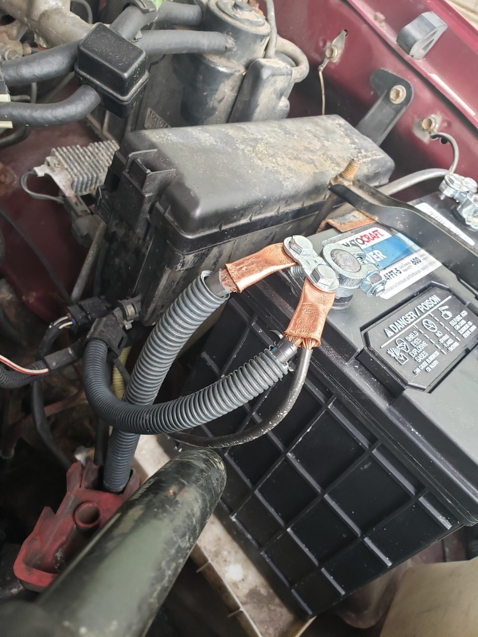

    Remanned. Went back and the employee told me it's over charging at around 15.5v. He also said it could be some loose connections or the way my battery terminals are connected. But if I wanted to I could exchange this one tomorrow when they ordered a replacement.
    Before leaving he also mentioned that it could be that I'm using the 100amp alternator instead of the 70amp, which reading through here wouldn't make sense, right?
    The car is also shaking a bit at idle now, don't know if it has to do with any of this...
    Here is a pic of the battery connections.

    Looks like the crimps could be a little better but I've had 3 reman Advance alternators go bad within months, one tested bad right out of the box at the store.

    Those crimps need to be redone honestly ground to that battery needs a connection on it.. you can have high resistance there.

    What do you mean by the ground to the battery?
    I tested grounds by following this video. It seemed within the specs that this guys says.
    https://youtu.be/1bK0De9XOP0
    I got .01v between both connections (+) on metal of alternator and (-) on negative battery post.

    Ground on the battery is bare wire that is just tighten down.. that's not a solid connection. Like I said all those battery connections need to be redone the correct way. I believe Auto and advance both sell the tool for proper crimp tool with that gauge wire. Then use a jacket where the crimp.

    I agree with Mike no offense but those connections are awful. Spend the money and buy premade battery cables, it is hard to make a good connection to the battery terminal without a highpress. If those connections are not your problem the will be in a few months corrosion will start very quickly. I have fixed lots of weird intermittent problems just by starting right at the source. Hope that helps

    No offense taken guys, the car came that way from the PO haha. I just bought a new negative terminal as the old one was heavily corroded. I'll replace them too.

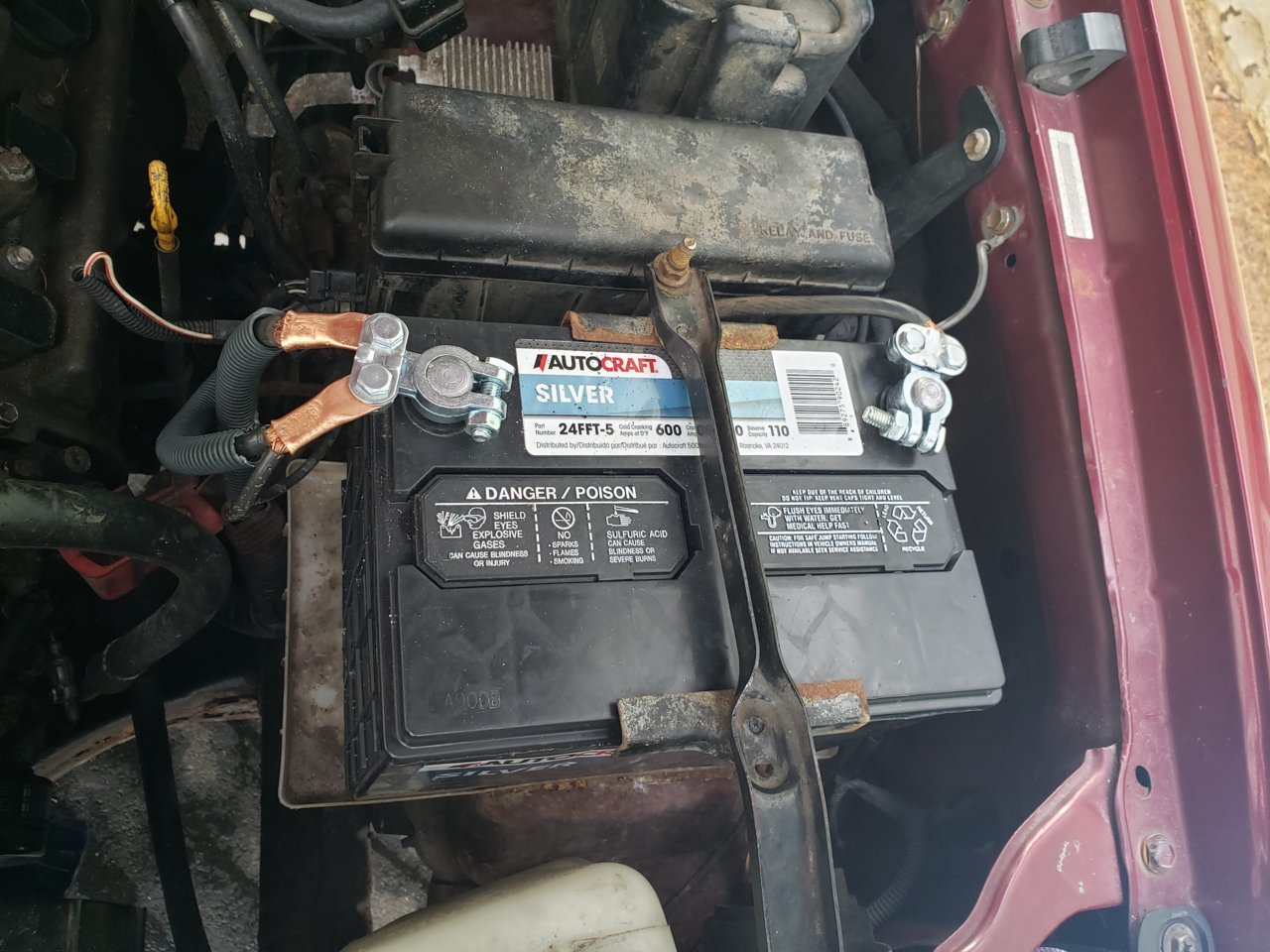

    Fixing the battery terminals now.
