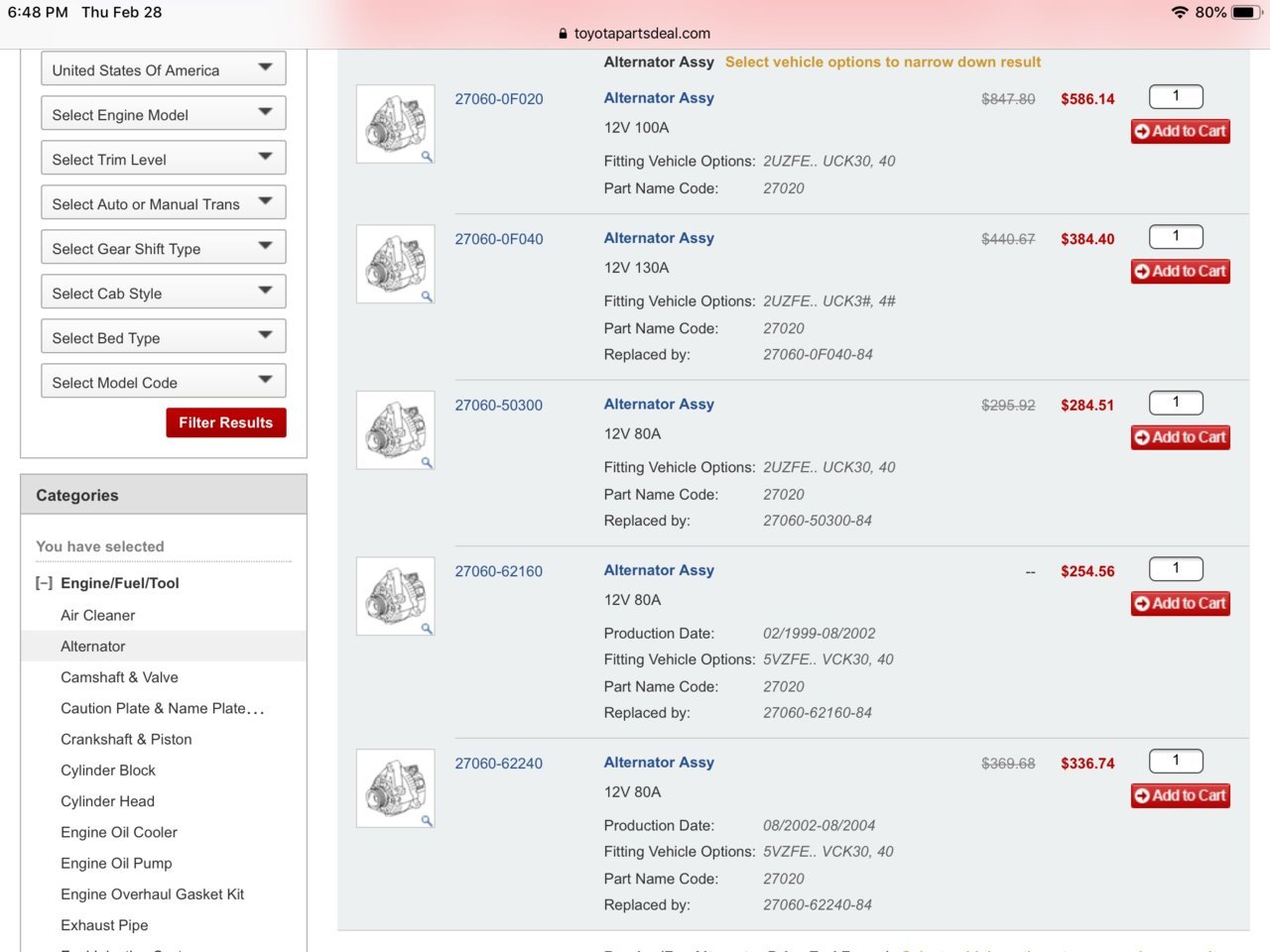

    Interesting the price difference in these alternators. Wonder if the 130A (cheaper) is pull and play with the 100A (almost twice the price)?

    And wow, now I'm really hoping it's just the regulator, that's a lot of dough for either of those :facepalm:

    Yes. Pretty steep. I wonder if the online retailers can do better pricing or even have availability on the OEM?
    The higher amp alternator above is less expensive by $200! Wonder if it will work?

    Higher amp units are usually just spec'd on higher trim models. No problem with replacing a lower amp one since the wiring is typically the same for either.
    You can pick up a new (not reman) parts store brand or a reman Denso for about $250.

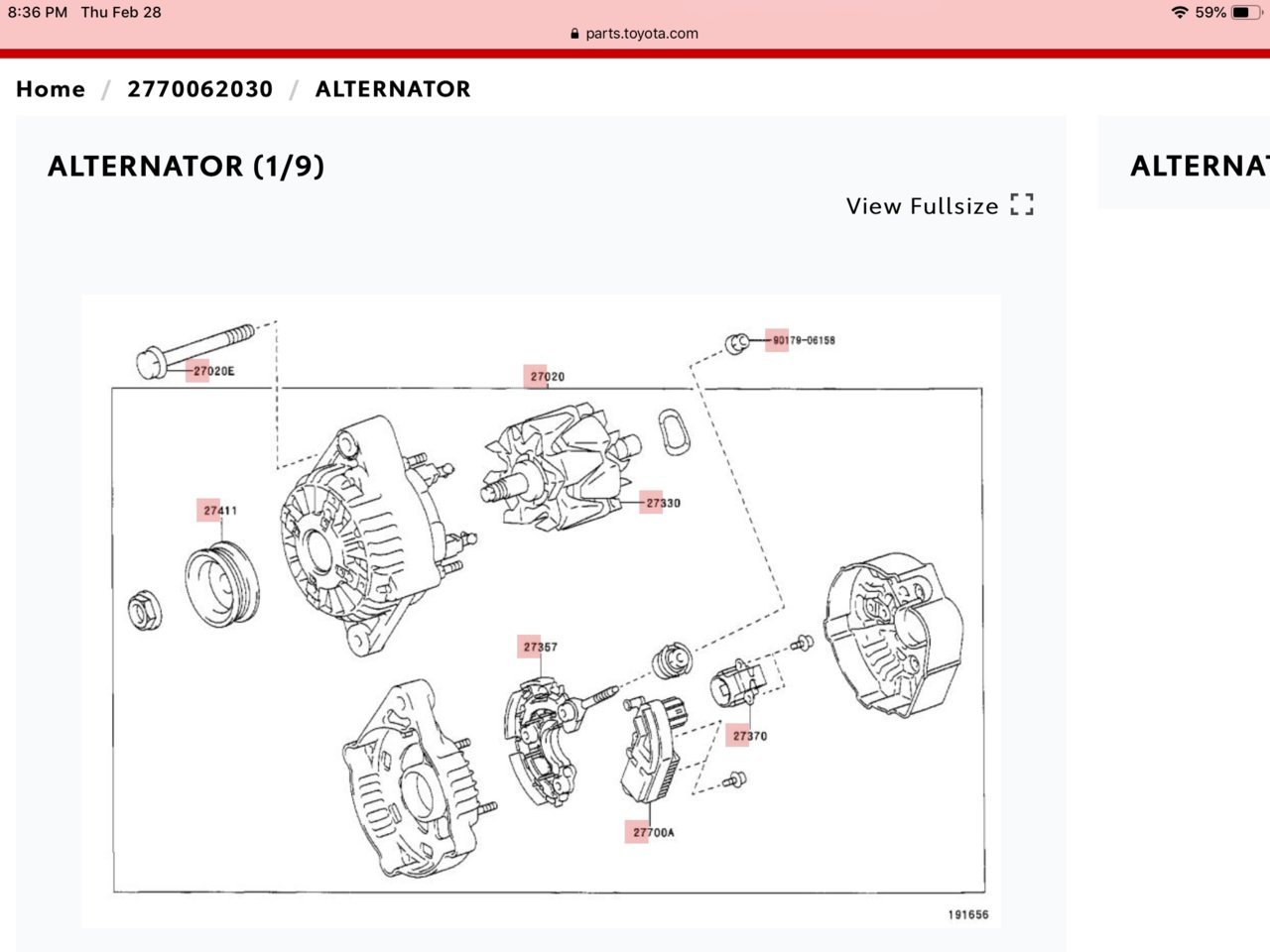

  20. Feb 28, 2019 at 5:55 PM
    faviles
    faviles [OP] New Member
    Nov 20, 2018
    #21951
    82
    Frank
    2001 Red Tundra SR5 TRD
    Stock for now
    I was looking for that darn diagram prior to taking the alternator off when I got home from school lol.
    A refurbished denso regulator with a 2 year warranty is already on it's way so there's no going back now lol.
    Regulator was only about $30, which isn't too bad.
