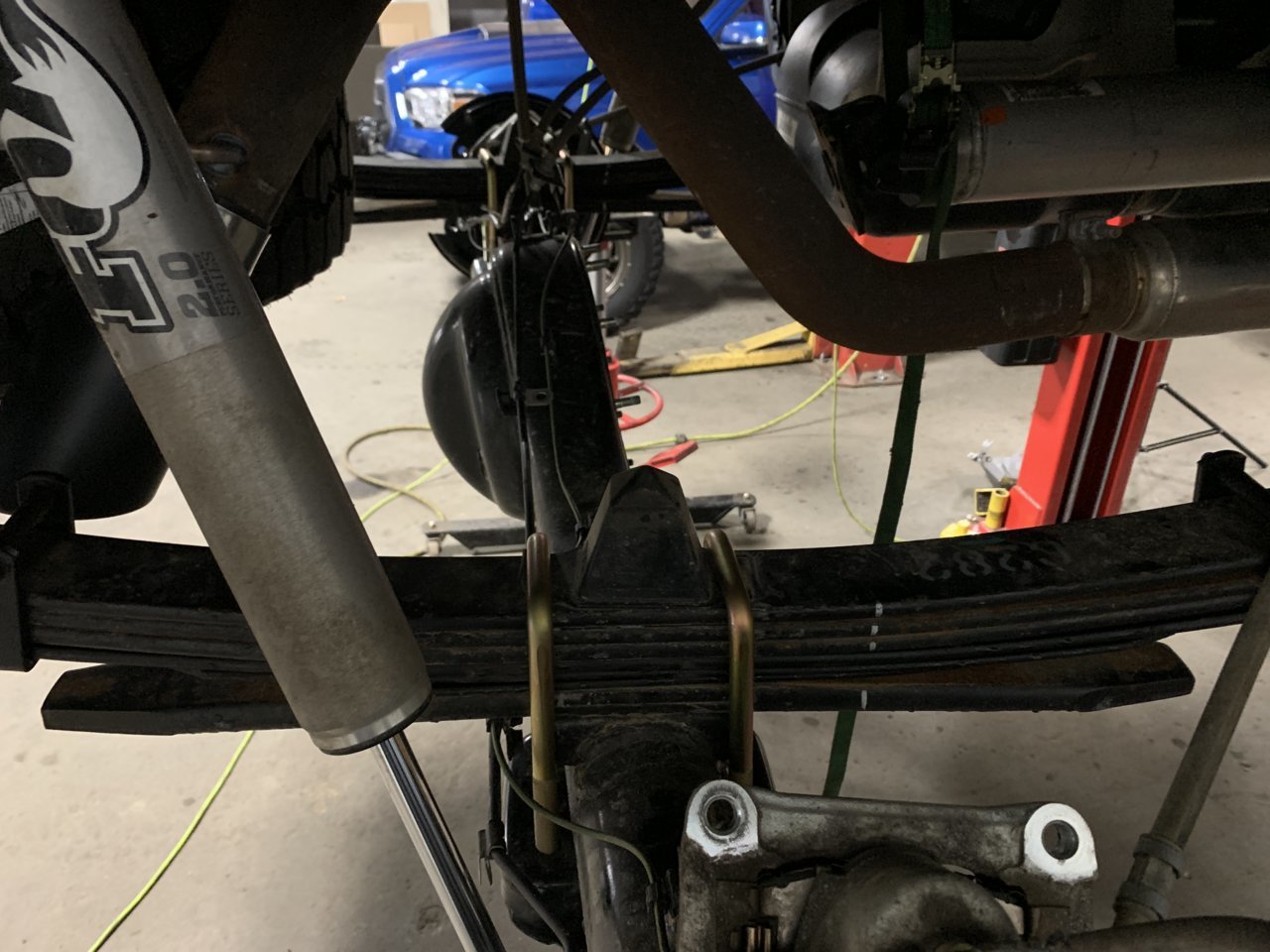

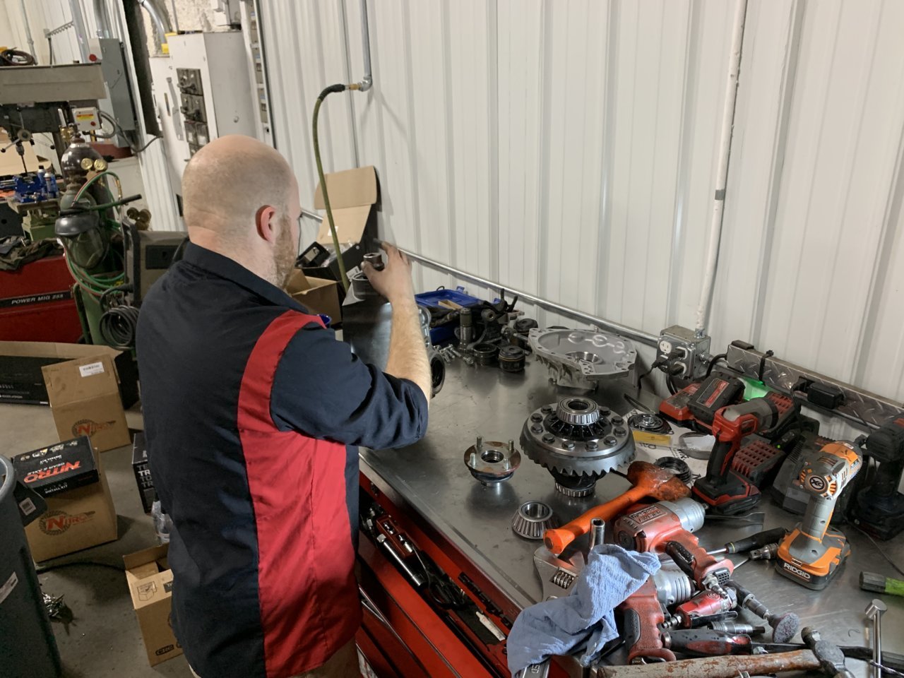

    Leave In Two weeks for our trip to Utah! Time to get this sucker going!
    Ripped the diffs out today for rehearing and ARB. Going 4.88 Nitro gears.

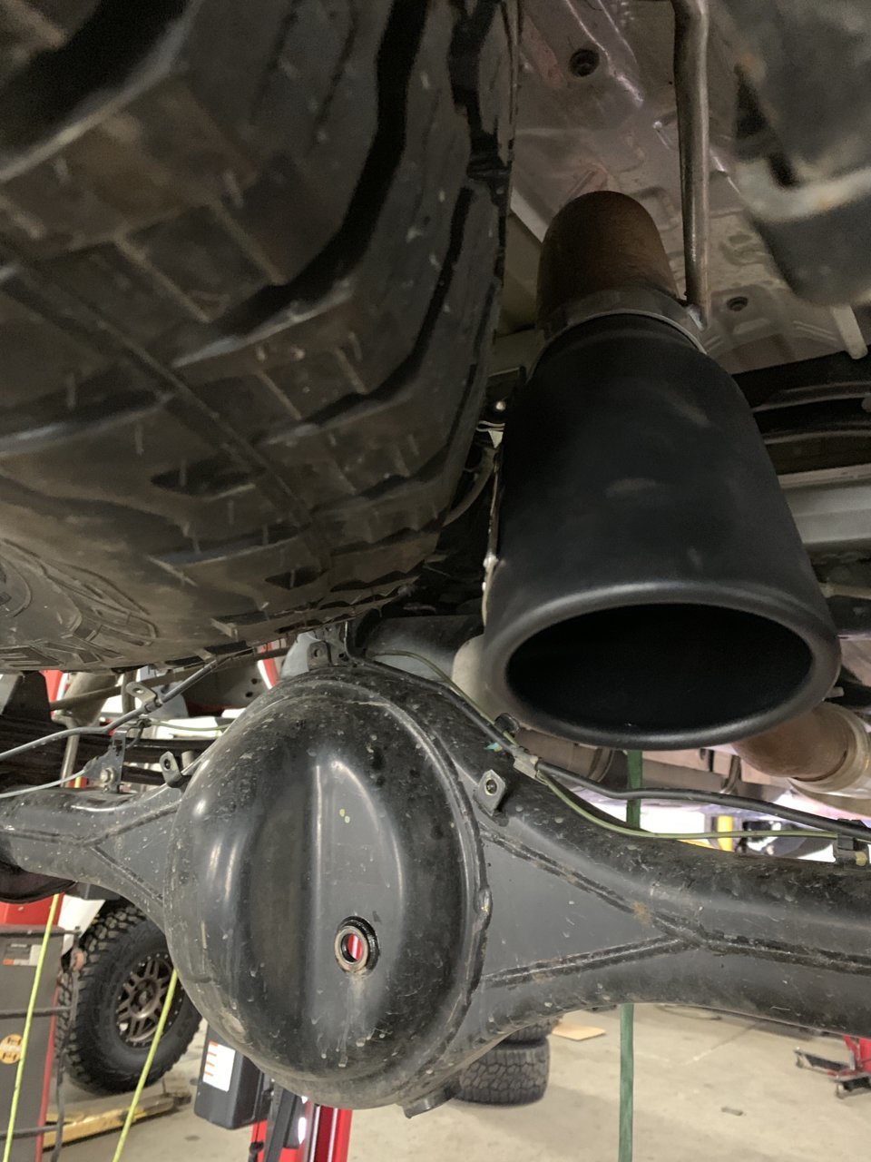

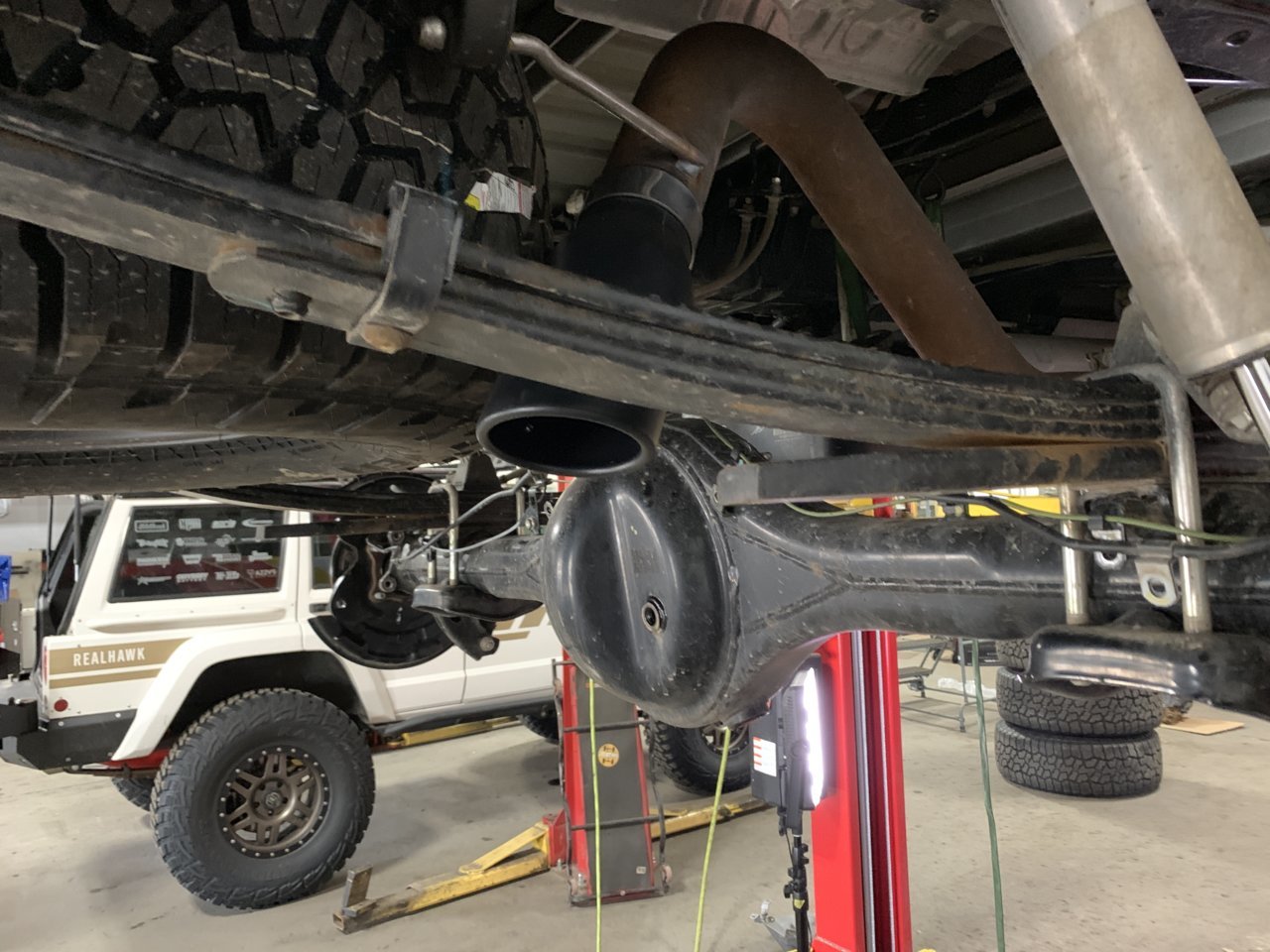

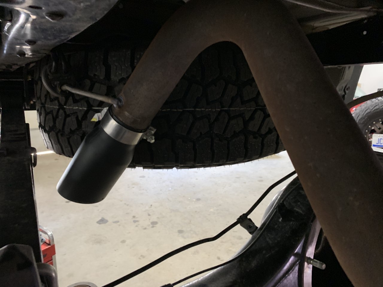

    I also mounted my 35” spare up underneath. Decided to cut the end of the tailpipe and tip off before I catch it on something. Used a 3” tip, sawzalled the pipe off, put the tip on. I did loosen the clamps, rotate it for more clearance.

    exactly what I did to mine.

    2012
    Deavers K37s. with the droop it was hitting the exhaust so at least you good with that now :)
    with your static weight, U748s would be a good choice.

    Any reason to add a tip? or just for looks? I was going to cut mine off as well.

    in my case: 1. it's a double wall tip so less heat generated closer to the spare tire 2. Tip extension sends the fumes towards the ground more 3. Looks less like a hack job too ;)

    Daryl took care of my gears and the arb install for me. He said ‘tell your tundra friends that hearing the front diff sucks!’

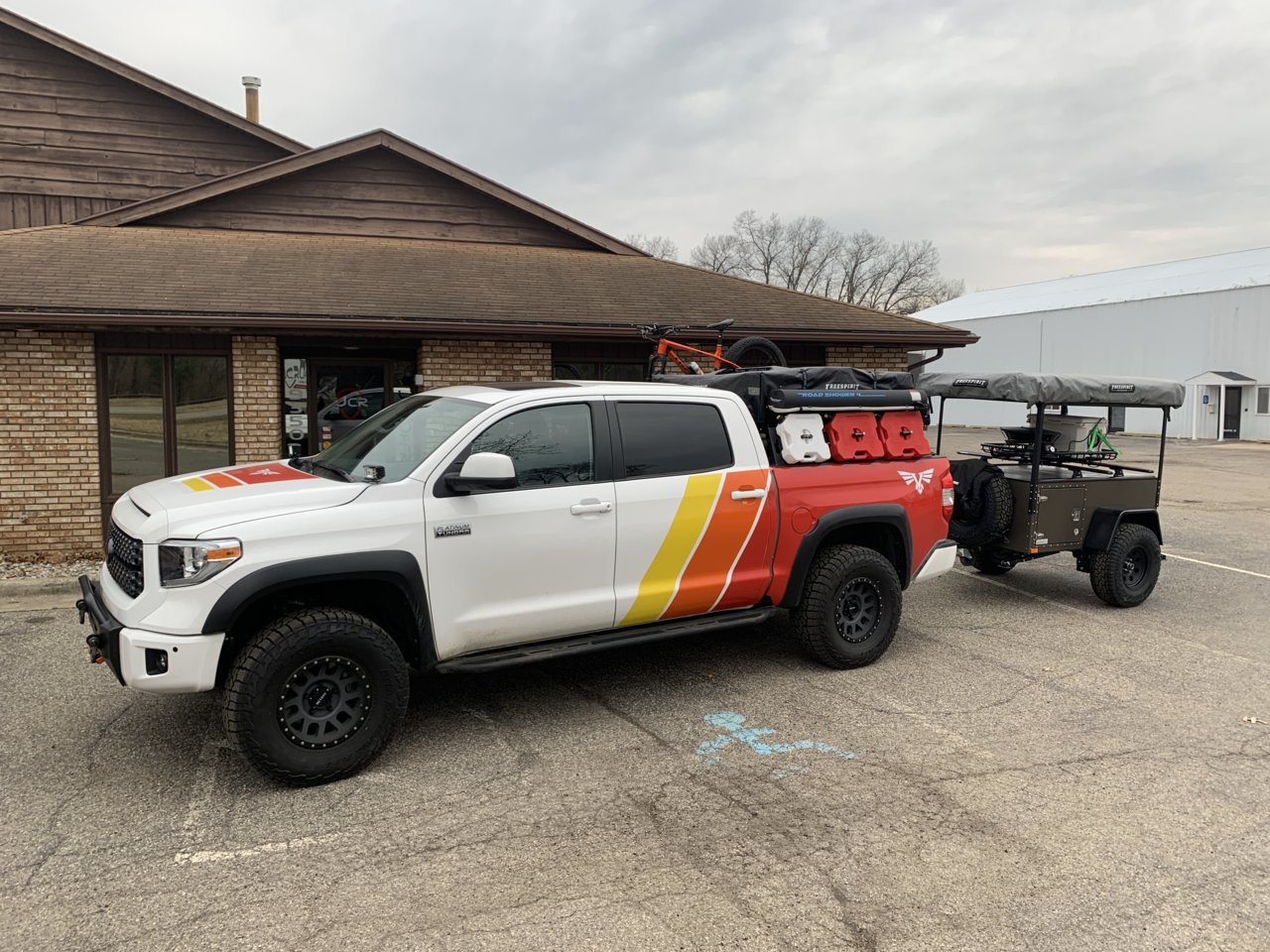

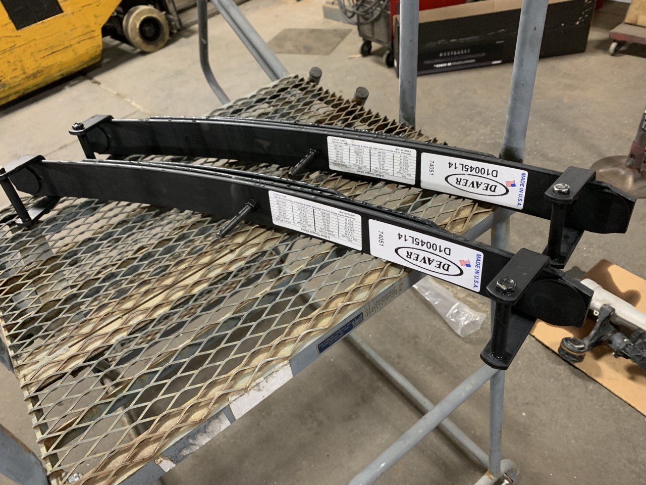

    My truck was sagging from the rack and stuff loaded on it. I opted for @Toytec Lifts add-a-leafs.

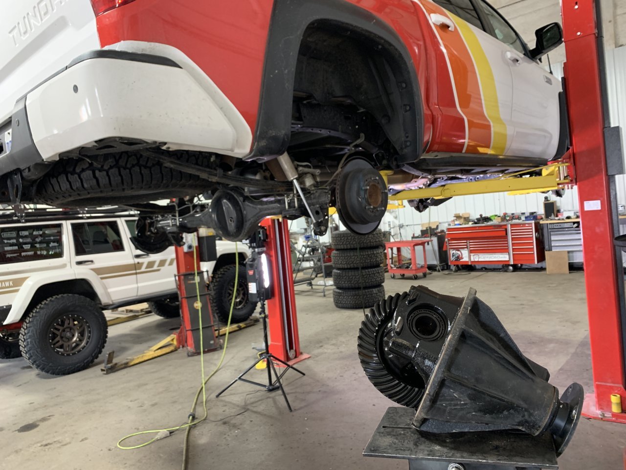

    I have a weekend packed full of work on this truck left. Rear diff is back together, just need to pump arb line.
    The front needs to go back together still.

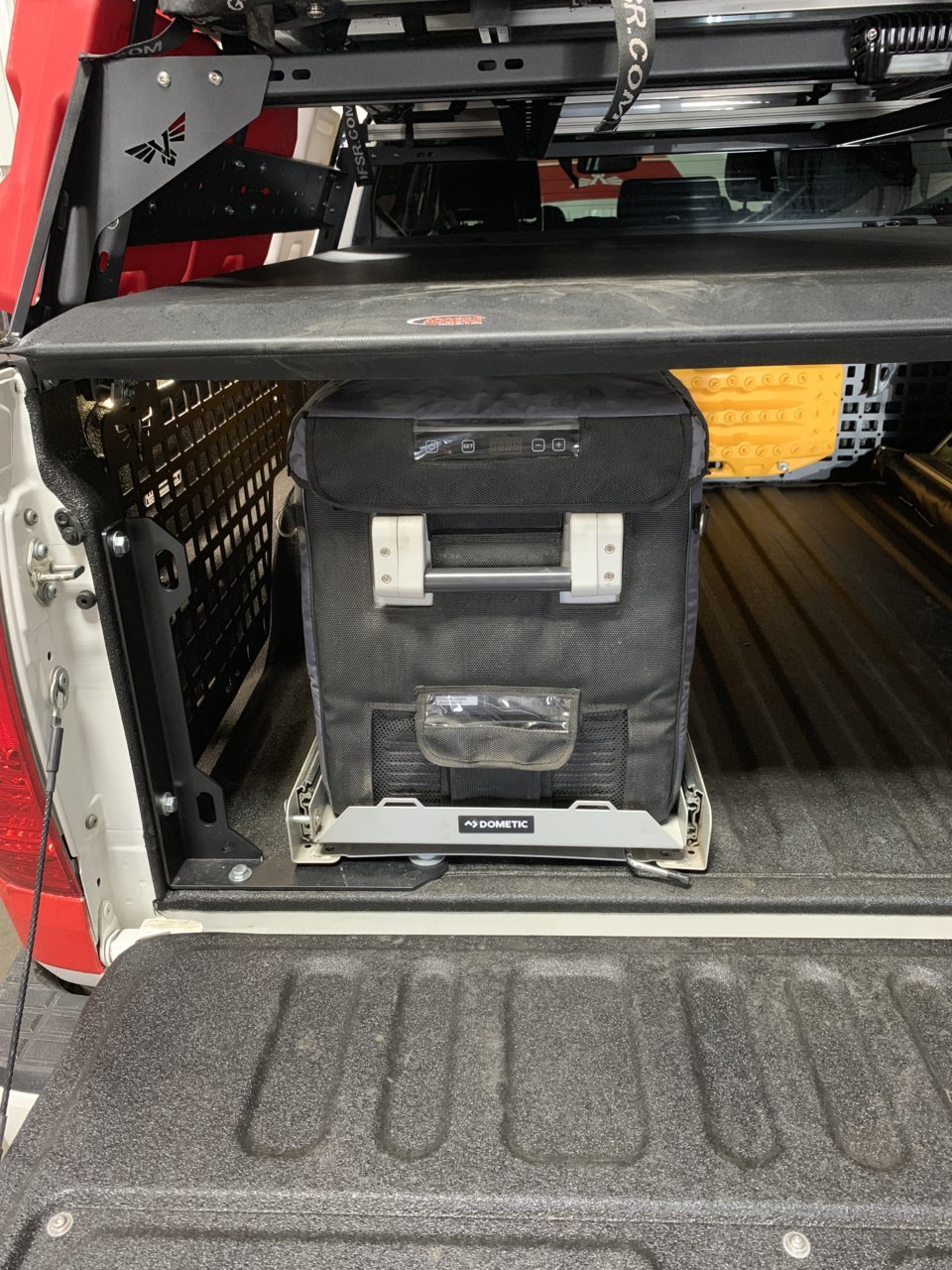

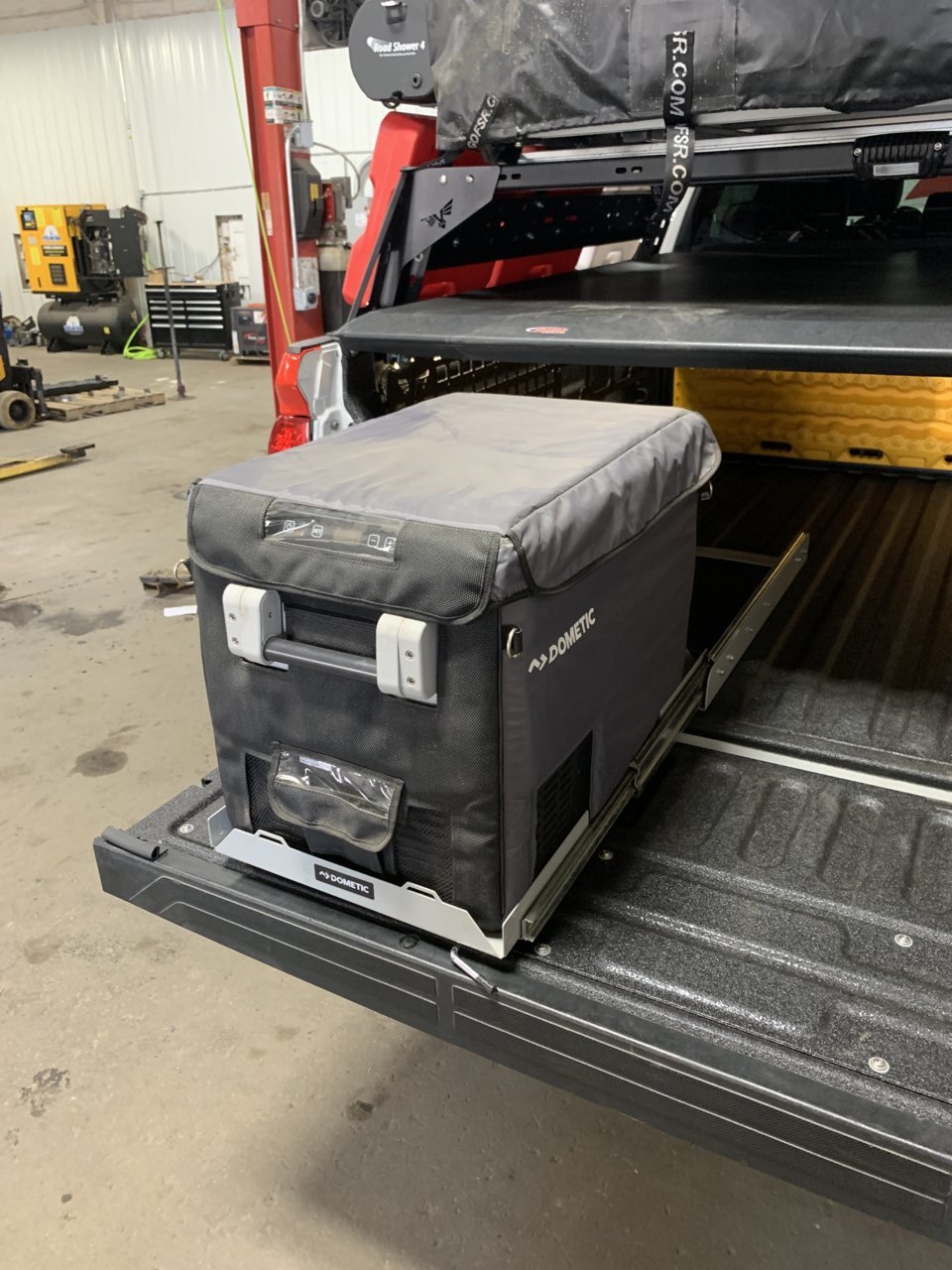

    Stole the dometic fridge from one of our jeeps.

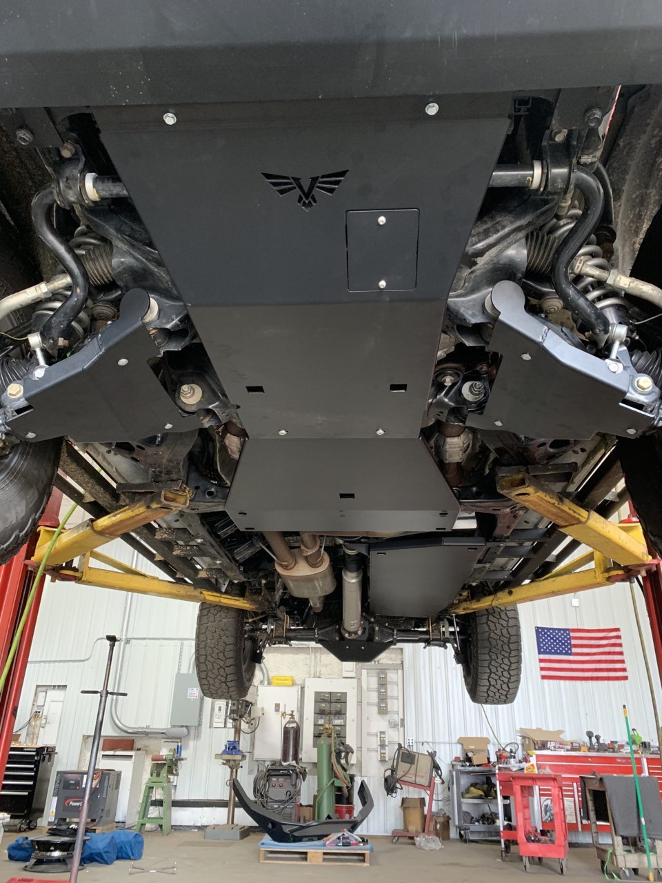

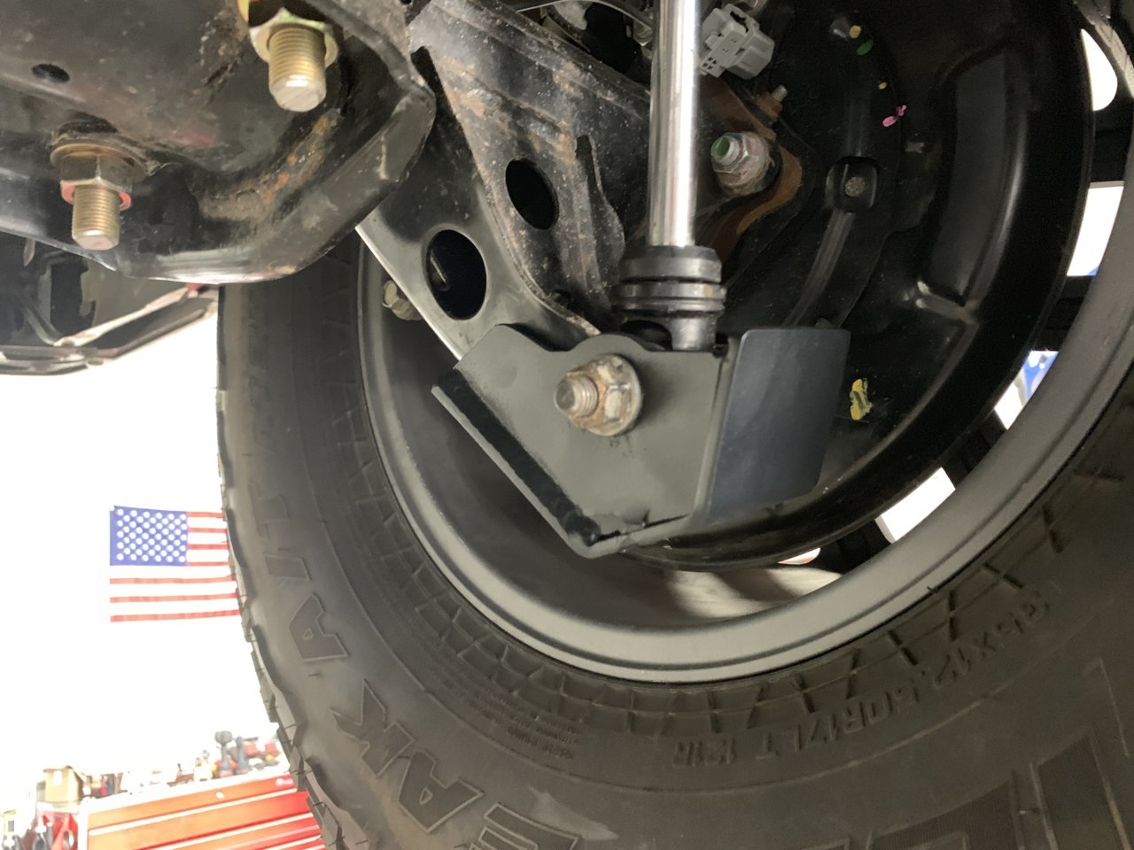

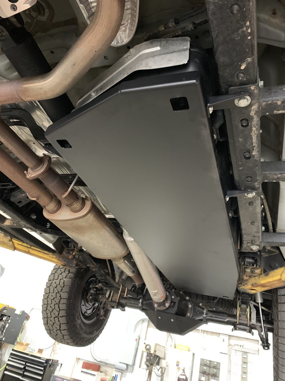

    Have some preproduction skids installed for my current trip. Hoping to get these into production in a few weeks!

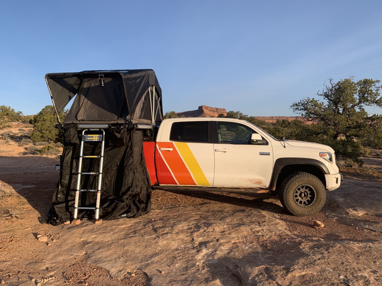

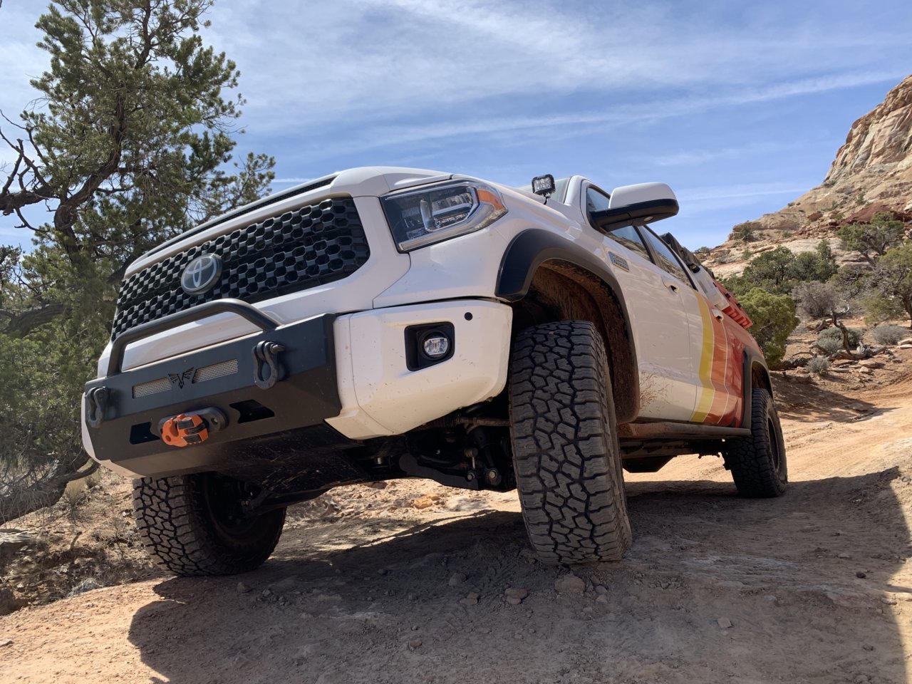

    Over 100 miles of trails and more than 2,000 road miles later, I’m happy to report the tundra did great! Happy to have the rear locker on a few obsticals. Here are some photos from the trip!
