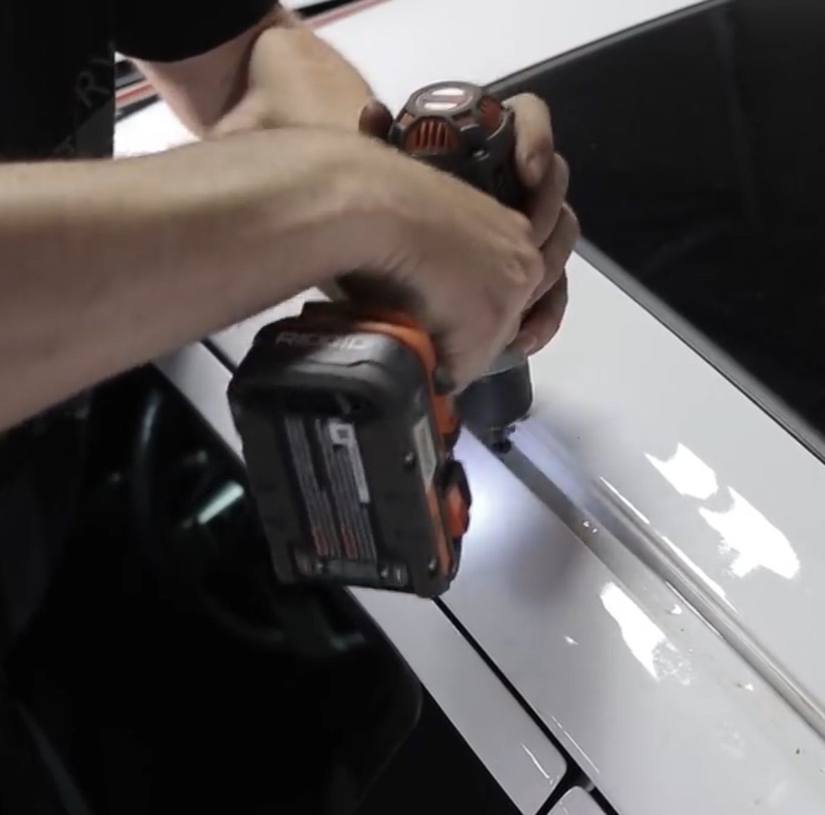

    If you choose not to follow manufacturer’s instructions, or use their supplied tools, I could envision a stronger argument for the manufacturer to claim no-fault in the event of damage.
    I don’t actually believe its possible to drill these holes with the supplied tool and only penetrate 1/2”.
    I used drill oil and was VERY patient allowing the bit to cool every 5 seconds or so. The layers of sheet metal force you to keep the bit speed up, otherwise the bit ceases.
    The hardness of the welded metal layers require decent pressure to make progress vs just heating the bit. I would guess each hole took 10 minutes. I completed them over two work periods and several battery changes on the drill.
    The instant you penetrate, the supplied bit threads the hole and you react as quickly as possible to prevent that. As shown in the video - what might “seem” like 1/2” is much more after further inspection.
    I realize there is some “idiot” subtext here, but sometimes things may not be as easy as they appear...and you have no firsthand experience with this.
    With a different tool and/or procedure, stopping the drill @ 1/2” is certainly possible.

    This statement here says everything. You're wrong. The issue is, you don't know how to properly use the tool or even clearly understand how a drill bit works. Its easy to blame someone else.

    I'm not sure what the picture is supposed to represent. I also want to be clear, I'm not bagging on you at all.
    AggiePhil likes this.

    Did you watch the install video?

    That’s A picture of the install video putting the whole drill bit in!

    Again, from this statement you do not know how to use a drill bit correctly or even drill a hole.
    This project is for DIY people and if you buy the product you are taking responsibility that you have a basic understand of how to accomplish it.
    If the instructions tell you to only go 1/2" deep but you watch the install video and see them sinking it all the way to the chuck, you should have had concerns which should have made you ask questions. Pretty simple
    It doesn't require a drill stop. Plenty people with experience could do this job with out one, would it make it simpler for you ? Maybe, what if the stop moved ? They do that a lot and need to be checked after every hole, would you know to do that ?
    I'm not trying to bag on anyone but get tired of hearing people blame everyone but themselves when things go sideways.

    In the install video, the installer states that the holes are drilled in safe zones away from airbags (as stated throughout this thread).
    Are you of the opinion that the customer should not trust that information when doing the install? And if they do trust that information, its their fault that they damaged airbags?
    The screenshot shows that even the manufacturer can’t keep the bit from penetrating beyond their recommended depth. It appears they do, until you go frame by frame in the video (which you may want to watch and listen to). So you expect the customer to be more proficient than the manufacturer?
    This thread was not here to blame anyone. If you read it in its entirety, I think you’ll see that.
    Personal abilities and the arguments of drilling excellence aside...some folks are going to have damaged airbags and they outta know.
