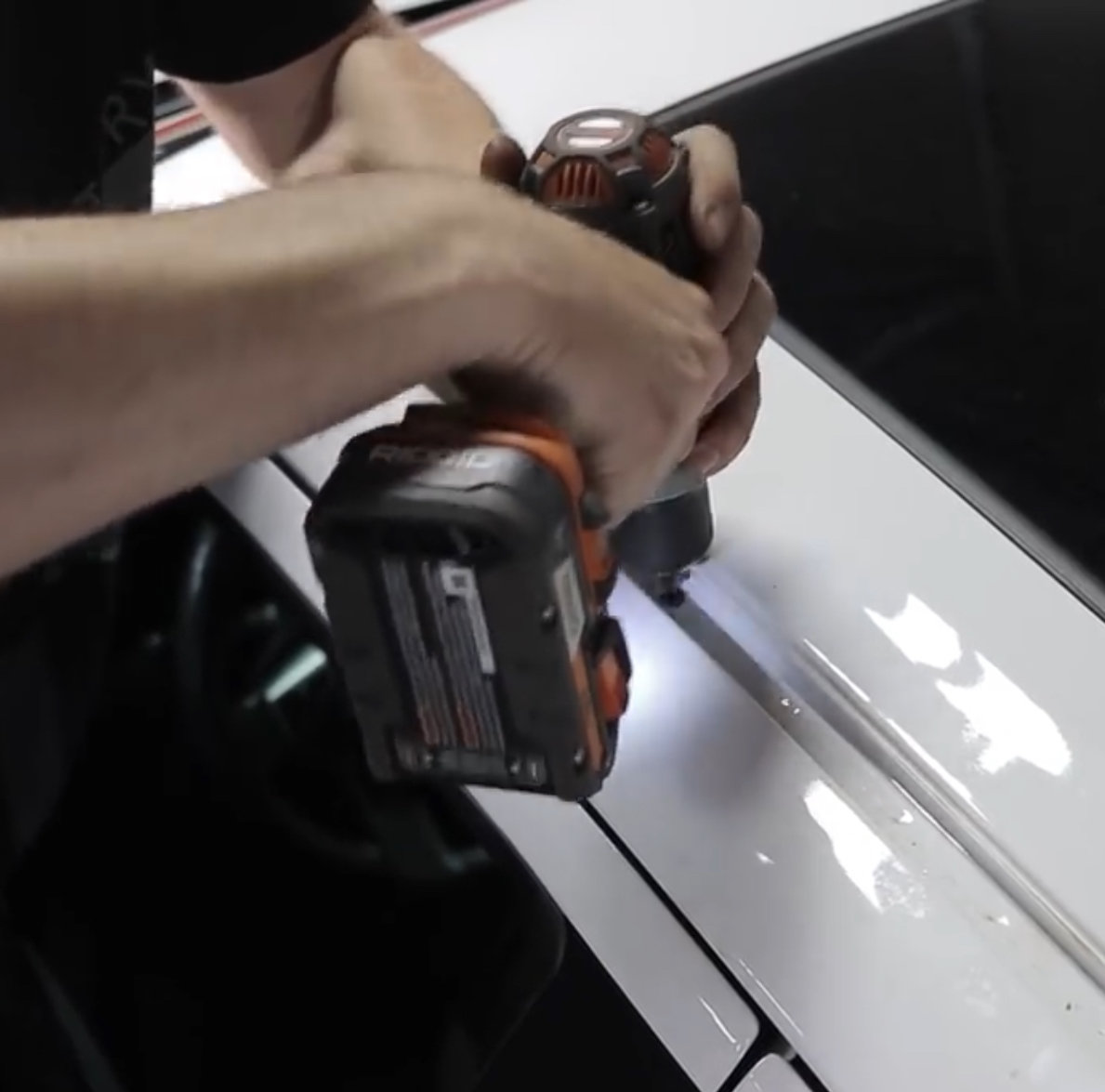

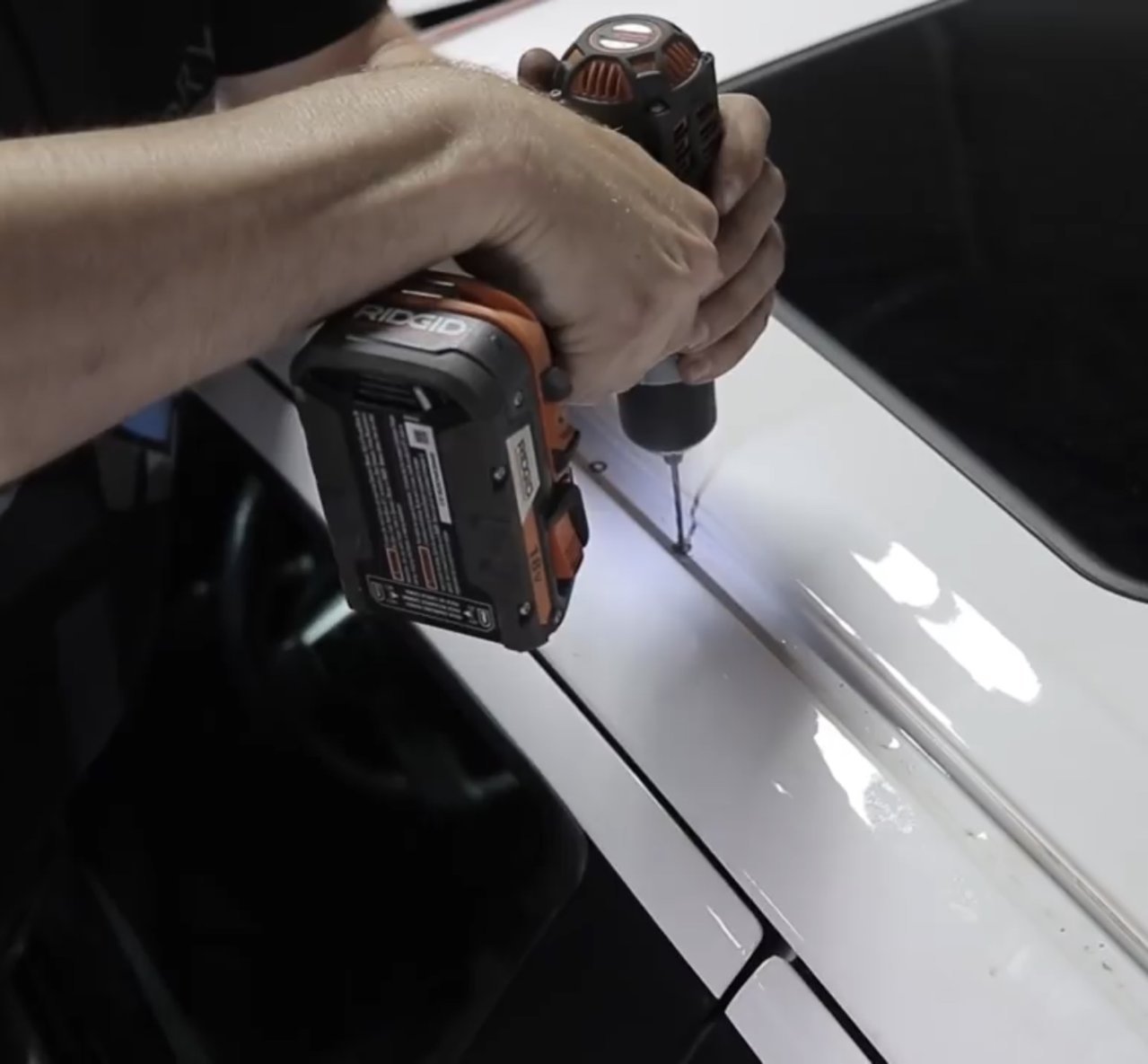

    I just had to watch the video also. He said “this is a safe zone to drill”. His drill bit did go in almost all the way in also...... this is going to be interesting. I hope that every one who bought one of their racks checks the air bags. This is scary to think about.

    Haha. I had to watch the video too. It went in ALL THE WAY.

    @ 10:36 "So were in safe zones away from the airbags"
    @10:46 "Only drill a half inch in"
    @ 11:12 proceeds to drill ALL THE WAY INTO THE ROOF!
    @18:14 "Like anything, just use your brain when your doing stuff!"
    Haha This is bad
    https://www.youtube.com/watch?time_continue=713&v=Sj35Bm7i6z8&feature=emb_title
    Also am I the only one who is going nuts watching him rest all his steel tools on the paint? Also not protecting the paint from the wrench, Mesure tape, and RTV? Jesus, all it would have taken is a few strips of painters tape along the roof and a towel. No care taken whatsoever. Staying away from @Victory4x4 products until I can see some care taken in their instruction and product design. If the manufacturer cant get it right with the drill how can they expect their customers to?

    He had the same issue I had with the drill bit grabbing and pulling it all the way in.

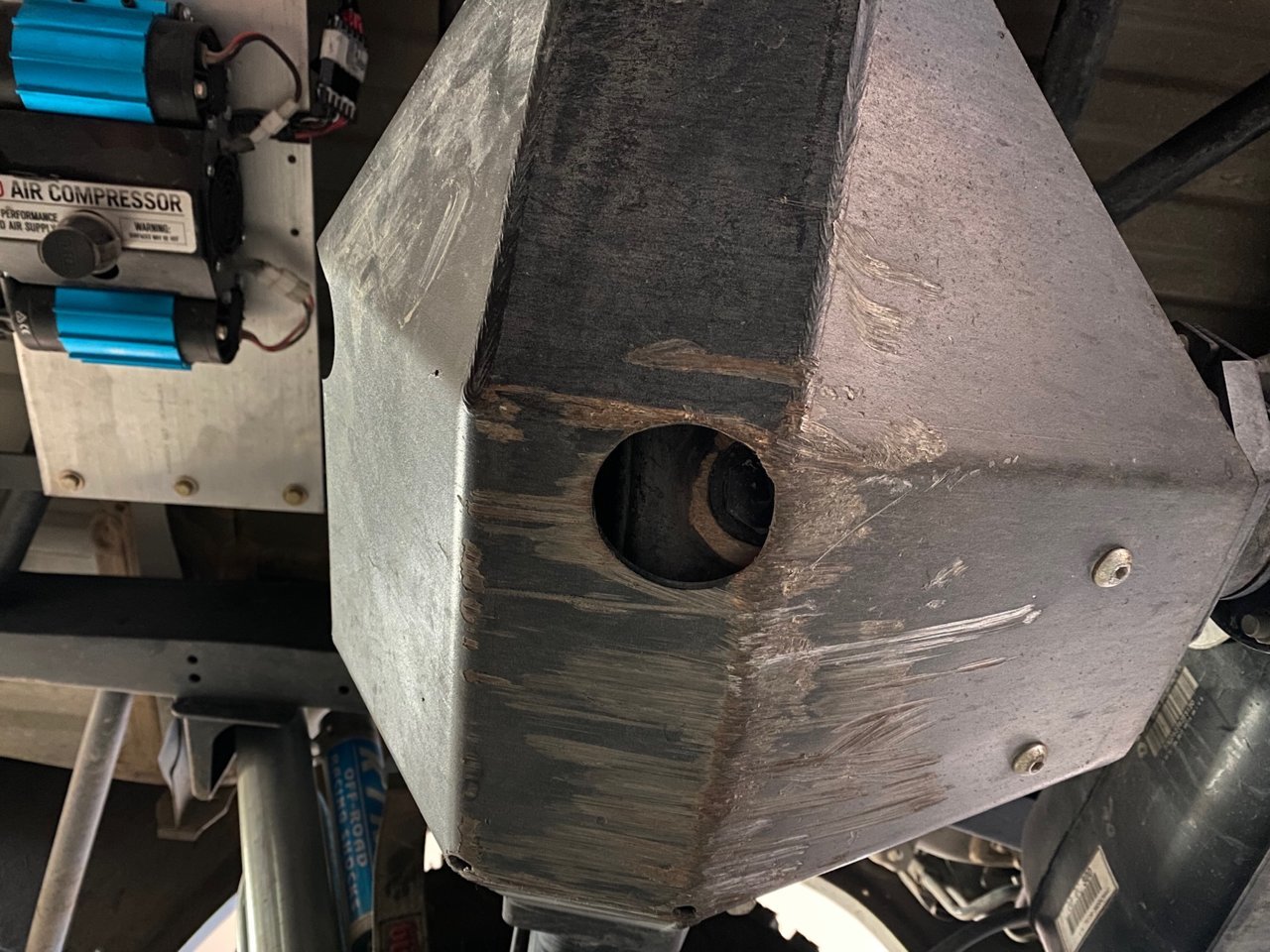

    Wow! That rotated a lot. Was there any damage to the drive shaft?

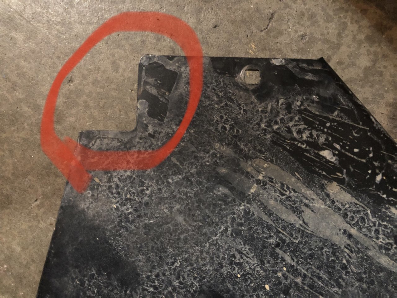

    The ones you have don’t have the issue.
    :thumbsup:
    The first rev of the LCA skids that were released had metal out to the corners (see the circled area in the pict below). They were tested on wheels that were 0 offset and there was no issue with these. On wheels with a higher offset (like +25 or the stock +60) the corner could come into contact with the wheel at full lock and shave off part of the wheel. (This made balancing near impossible.) V4x4 fixed the issue by cutting off the corner.

    No, just ruined the rear diff drain plug. Not sure why I bought a rear diff skid.

    I mean... You've got some decent scraping on there...

    Agree, it’s a skid plate though.

    Oh I'm not saying that the skid should have rotated. I just meant more that the idea of the skid is good.
