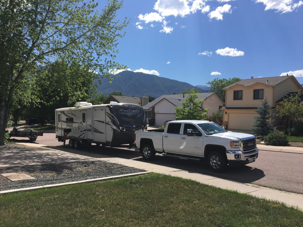

    I would also like to point out that in this picture my tundra was pretty maxed out and level. In corners over 20 mph my traction control would activate quite often. Tundra's need a little rake to perform correctly. I even had overload springs installed in that picture.
    Kinda why I went to this setup.
    Still have good rake and trailer was nose down about 1.5-2" for aerodynamics.
    We had a long trip that the wind was horrible and the trailer away was pretty bad (yes, we had a LDH with sway control) and in 5000 miles it wore out my tires.
    https://www.tundras.com/threads/tough-towing-this-go-around.15481/

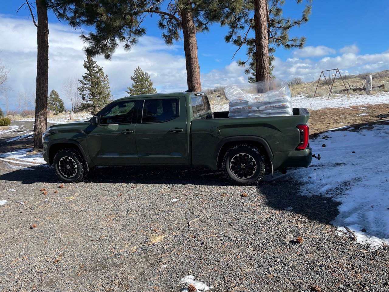

    I put some airbags on my truck to alleviate the squat you get even when the truck isn't overloaded. This is with 1300 lbs of pellets in the back. Ridiculous that you aren't overweight but yet the rear end has settled down that much but the airbags took care of that
