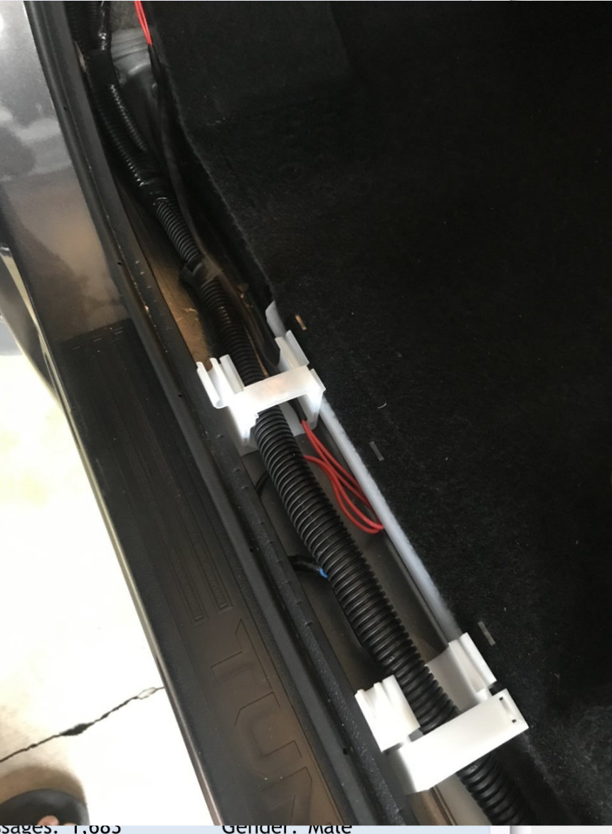

    The black wiring harness has a split, so you can access the wires by prying it open. My 2018 had a pink wire for the cargo circuit. You may have to test several wires, which is where a PosiTap comes in handy.
    Be cautioned that Toyota changed many wire colors between years.

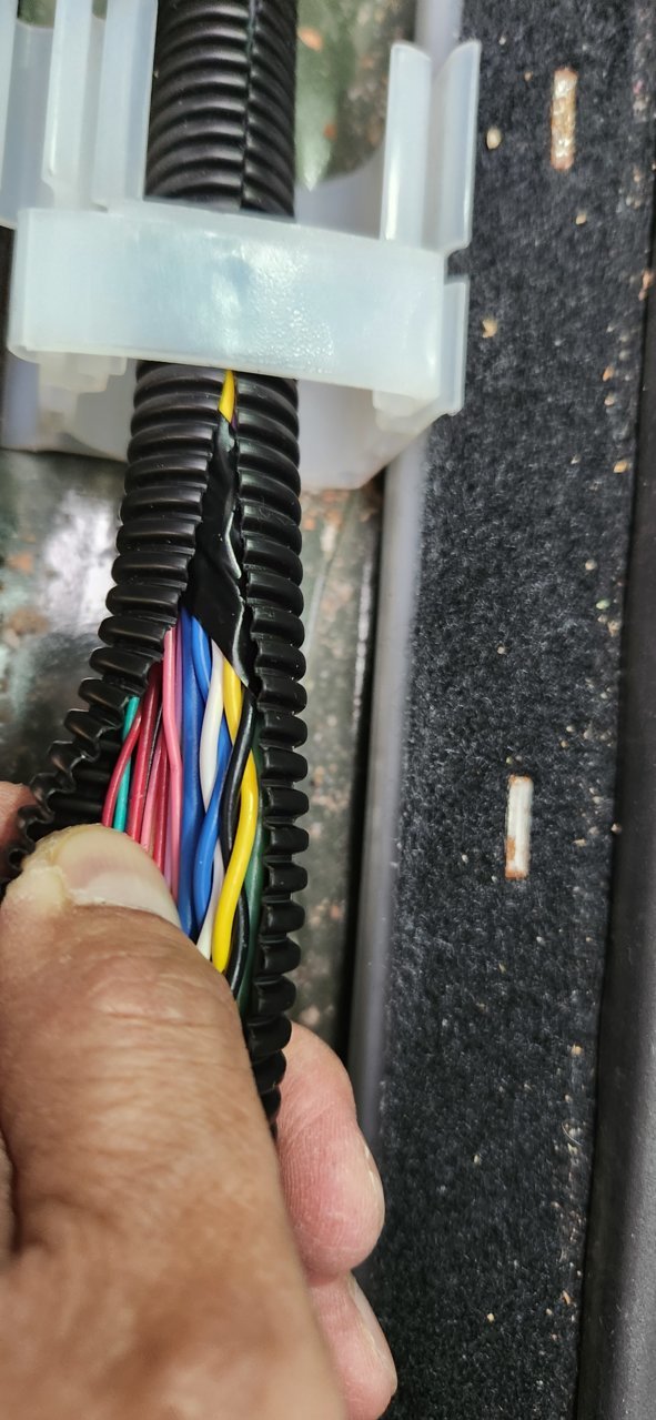

    oh! i didn;t know that black wiring harness has a split. i felt so stupid! lol i though i was going cut it open...save me time and i will try use flathead praying it open. question - which one is better? T-Tap or posi-tap? please correct me if im wrong. t-tap or posi-tap can be removed and cover with black electric tap or leave it alone. it doesn;t hurt the wired? thanks

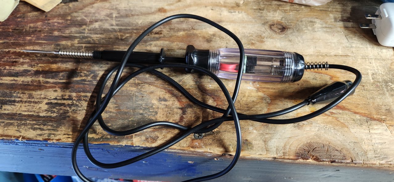

    ok, i have 2020 pro. ok, i won;t bet or high hope! i have a circult tester to see which one correct wired. i will flip switch cargo light off to see circult tester no red light, and turn door on and hopefully i will see RED solider red light since my door will be open. i hope i got right idea.

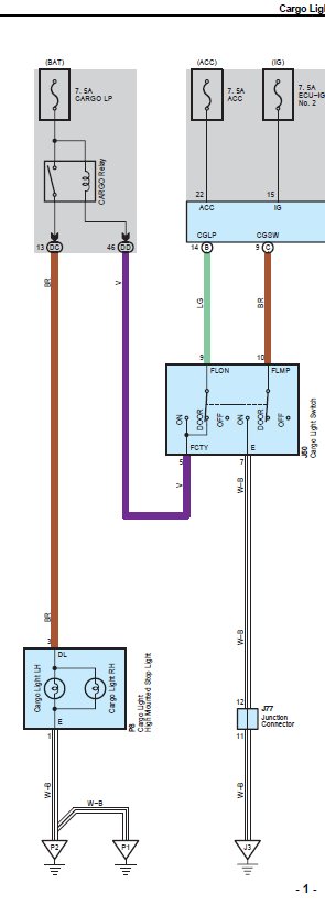

    The wiring diagrams show all truck 2018-2021 should be a pink wire.

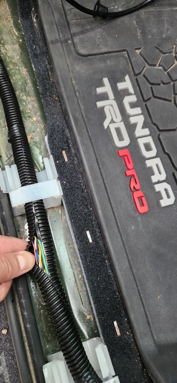

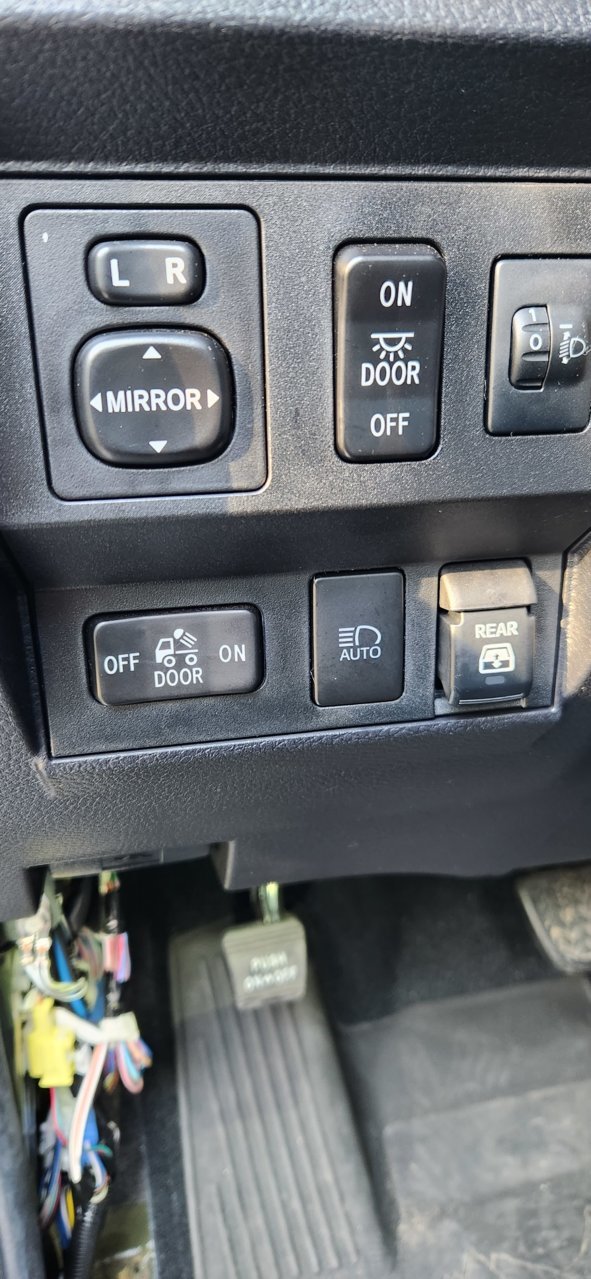

    Finally! I get a chance to take a look at it. Here is the pic. I didn't get a chance to test
    circult tester because thick wired are in the way. I need to remove black tape and do it again. I hope this pictures will help you find the answer.

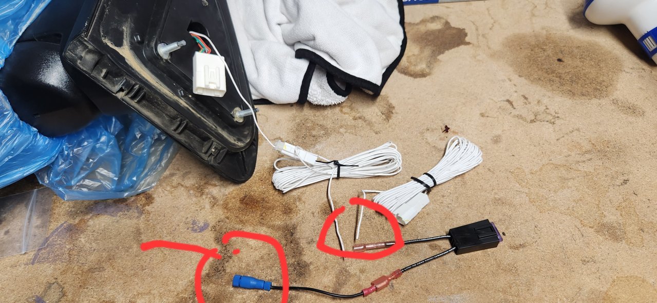

    Sweet!!! Your da man!! Me no luck!! Sighs... my tow mirrors is only white wired and posi tap each wired...nothing happens. I'm thinking maybe tow mirrors white wired is built reverse only since it have no power or maybe I will have to split to feed the power? I don't know. Does your tow mirrors have white wired only? I watched the YouTube and don't know which tap. So confused.
  23. Aug 6, 2023 at 11:52 AM
    #53
    turtle_slow
    turtle_slow New Member
    Mar 2, 2022
    #75297
    20
    2020 Tundra Pro Army Green
    Blue post-tap connected each wired and nothing come up. I noticed that when I tested it voltage 12v is on and when it's off and still got 12v. Puzzled... on or off still got 12v.

    The wiring diagrams show it to be brown on the 07,08,09... It will run from the body control module under the dash up to the cargo light area in the back of the cab.
    I think one of the problems with looking in the door sill is picking the right one. Multiple wires of several colors are there probably more than one brown. To make sure it is the right one going directly to the body control module is easiest. It is on pin #13 of the DC connector to the body control module.
    Yes you can tap into this as a "switched" positive power source, ground the other side of any added on light will make it come on/off with the cargo light.

    Yes and they are all ground wires. The "Switch" grounds out the relay so it will close to send power down the brown wire. You can see the relay is powered by the 7.5A Cargo fuse, the trigger from the switch to close the relay is a ground signal.
    If you were going to go this route, you would have to power your external lights when the key is on, then tapping into the switch would create the ground for them. I would not recommend this.
    Look in the door sill fist, or get someone who can help reach up into where the body control module is.
