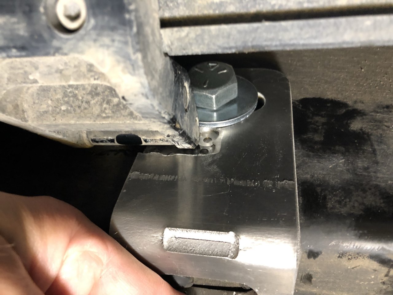

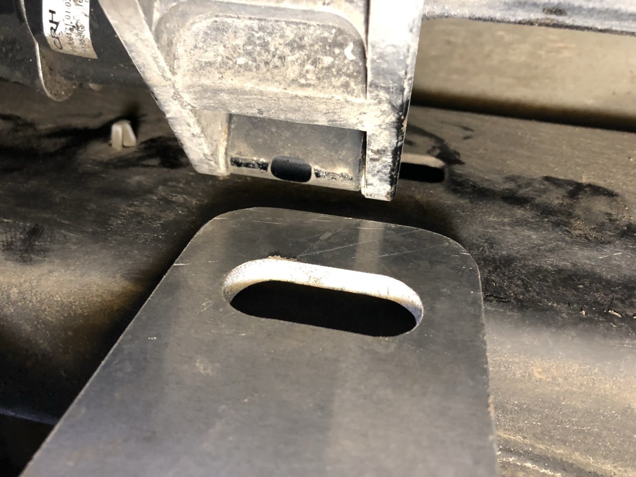

    Just a note for anyone with the Amp Research PowerSteps - the passenger side bracket for the rear cat plate interferes with the Amp Research bracket up on the frame. Mine was aluminum, so I drilled out some material to make room for it, and had to drill a second hole in the rear skid plate where it attaches to the bracket. Fairly simple, but something to keep in mind. I'll report back if there are any issues driving around and if the step bracket moves around and hits it or not.

    I have installed many plates on trucks that have AMP steps, the arm does touch the bracket, but I have never heard of any issues

    Yeah, it would retract and close without my little mod, but I wasn't really sure at the time and it didn't take that long to drill out that aluminum.
