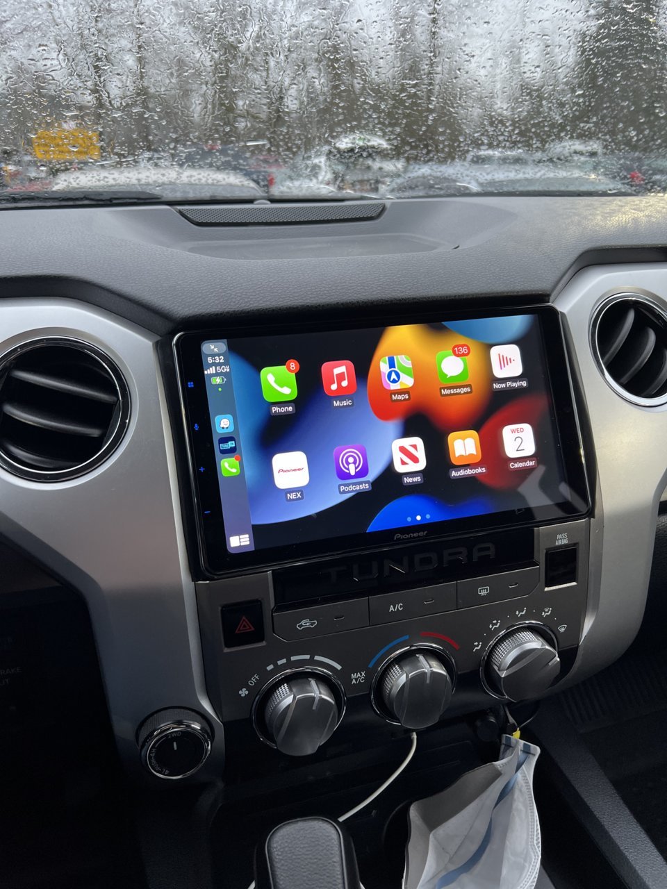

    You’ll be way happier with any CarPlay HU. I made the switch a few weeks ago and could never go back. AE6164A6-4FB2-491A-A618-456A74BC972E.jpg
    Maybe the shop can test your Entune unit and have some idea if it just went bad or if something in the truck damaged it.
    good luck- it would be very frustrating, but give you a great excuse to get a better stereo/HU.
    Sleeper16plat likes this.

    I’ll for sure have them test the old HU. The entire thing is gonna be $800 up here in Alaska. How much did you pay for your new set up with harnesses, if you don’t mind me asking?
  8. Mar 17, 2022 at 2:44 PM
    #38
    panicman
    panicman Everyone remain calm.
    Mar 28, 2018
    #13960
    1,871
    Eric
    2018 SR5 CM TRDoffroad MGM
    It’s ugly.
    Pioneer NEX8600: $1250
    Maestro RR2 module: $250
    Other harnesses: $90
    So about $1650 all in. No labor- I did it myself.
    Steevelknievel[OP] likes this.
