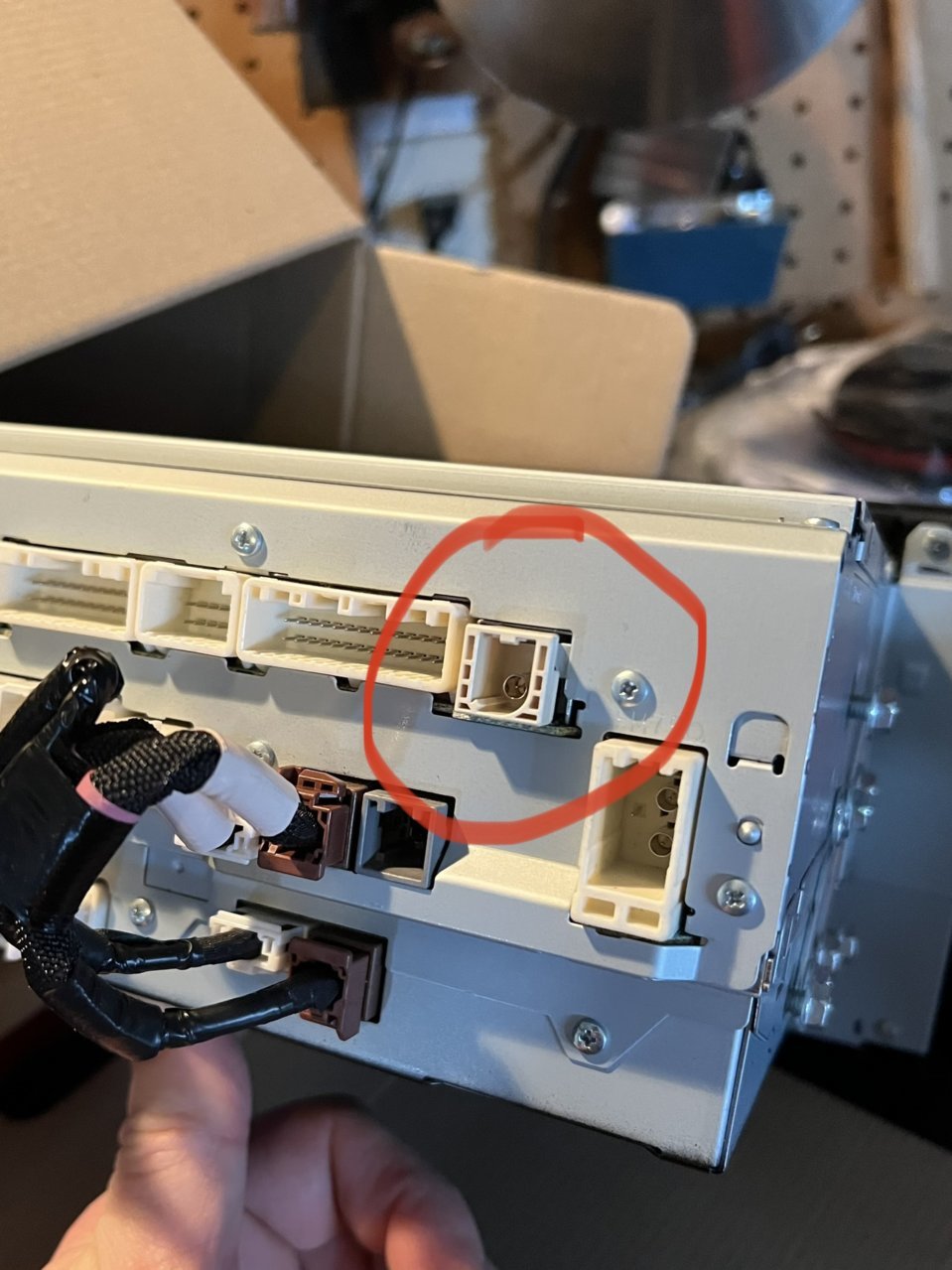

    Well it happened!? I also unplugged all the fuses to the lights instead of removing them, because that bypasses the system, and it’s still doing the same thing. I’m starting to think the HU somehow just roached itself?

    I hear people backtracking steps and restoring back to factory to see if anything changes if they install something that should be a simple upgrade. I totally agree with that EXCEPT there should be no correlation between the lights and the radio/usb. If there is a cause there will be a reaction IMMEDIATELY. That didn’t happen though as you stated all was good for a couple days. Coincidence?….maybe. Maybe not. None of us were there to see what happened or what what was done other than the op. If the lights work but the radio doesn’t a couple days later, there is no reason to restore back to factory or the way it was before. This is why I mentioned that the radio needed to be pulled to check voltage at the radio. If you have power at the radio but doesn’t work AND you have working lights, don’t lose sleep wondering and replace the radio. It would save a few steps in troubleshooting. Just my thought.
    Good luck.
    Ps…. Have you verified that voltage is good all the way to the radio before you just replace it?

    They “removed the GPS”? What does that even mean?
    I would pull the head unit and check the connections.

    I bought the truck used from a company that was a rental company. Low miles on the truck, but the removed the GPS unit from the truck before it goes to the dealer. Everything is the same but the navigation part is removed. I stated that in my last post.
