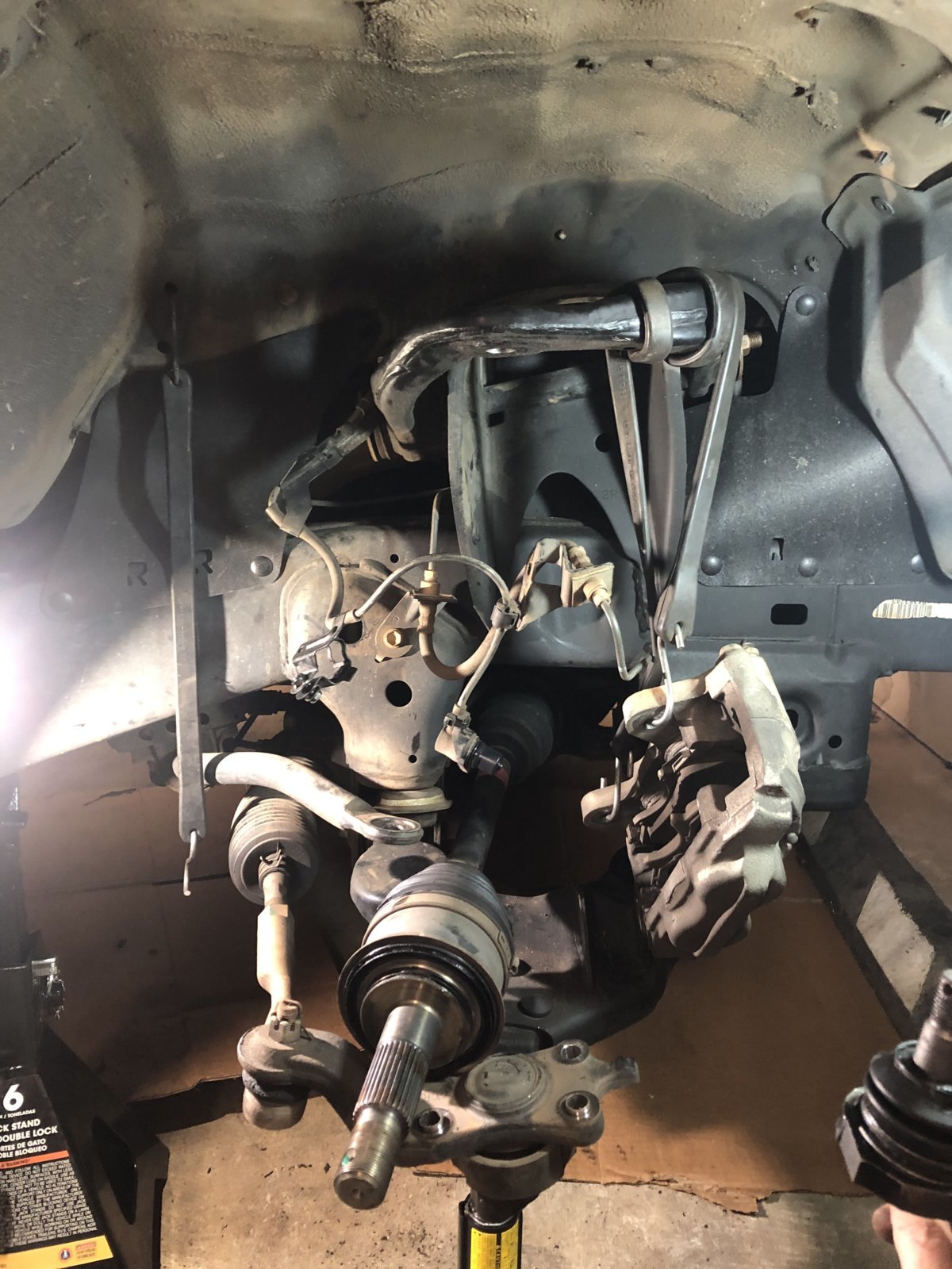

    Been there, done that. They're a bitch to hammer out, albeit impossible if you do something stupid, like fail to take out the retention clip.
    Do yourself a huge favor. Pull the f'n knuckle (spindle, whatever you prefer). It's so much easier to use a basic balljoint press kit with the knuckle on the ground, in a vice, wherever. You really hafta finagle things to get the top of the knuckle pointed just right, and risk scratching the hell out of your fender flares. I tried like hell, and even on my rust-free 75k mile '06 Limited, I couldn't get it all together.
    If you aren't comfortable pulling the knuckle (it's only a couple more bolts, and if 4WD, popping off the CV nut), then take a cutoff wheel and lop off the spindle from the UBJ, it'll give you ample room and a flatter surface to press the old one out.
    I spent 2 hours trying to finagle a setup that would work with the knuckle in. It took me (and I timed it) 14 minutes to pull the knuckle on the passenger side, and 10 minutes to pull the spindle on the driver side. Once out, I had the old joint pressed out in about 90 seconds with the knuckle on the floor. I'm 4WD, if it matters. If you're 2WD it should take five minutes less per side.

    I might've misunderstood you. I thought you were trying to replace your UBJ. In which case, you've gotta press it out of the knuckle.
    If you're just trying tp pull the knuckle, there's an extra step for 4WD which involves taking off the CV Axle nut, but gist of it is simple:
    • If 4WD, pull the cotter and cover for CV axle nut, impact the CV axle nut off (if 2WD, I don't think you gotta do anything)
    • Properly lift and secure the truck, pop off the wheel, unbolt and hang the caliper
    • Unbolt and carefully pull out the wheel speed/ABS sensor, mind the o-ring, unbolt its harness from the knuckle, set carefully aside
    • Pull the UBJ cotter, spin off the UBJ top nut, and if you need to re-use the UBJ, flip the castle nut over and spin down until its butt is just shy of being flush with the spindle threads, then BFH that MF'er until it drops loose (may help to have the OEM bottle jack under the control arm for support. If you don't need to re-use the UBJ, shove a pickle fork in between the boot and UCA, then hammer it free.
    • Pop off the rotor
    • Unbolt the LBJ, all four bolts
    • Remove the loose castle nut off the UBJ spindle, then lift and pull the knuckle out if 2WD ... if 4WD, carefully tap the CV axle spindle in to free it, then shimy it out of the knuckle, and hang the CV with a bungee ... don't tug on the CV excessively or yank on it hard, it WILL potentially pull out of the front diff
    • Install is the reverse. Be sure to use at least blue threadlock on the LBJ bolts, and torque to OEM spec. Reference the FSM for torque specs on the caliper, UBJ, LBJ, etc. and be sure to exercise caution when reinstalling the wheel sensor
    WARNING: If replacing the LBJ, as you should do at least every 125k-150k miles proactively, do not use any brand other than OEM, and, honestly, replace all 8 bolts while you're in there for safety's sake. The OEM design generally puts way too much strain on the LBJ, and aftermarket LBJ from all brands (incuding Moog, Napa, Delco, you name it) are complete shitware, prone to failure. We've got threads with dozens of failure pics from others who failed to heed the warning.

    Oh and end result moneyshot, with one last piece of advice. Always disconnect the front swaybar before lifting any time you're doing shit with the suspension, @05Dub :

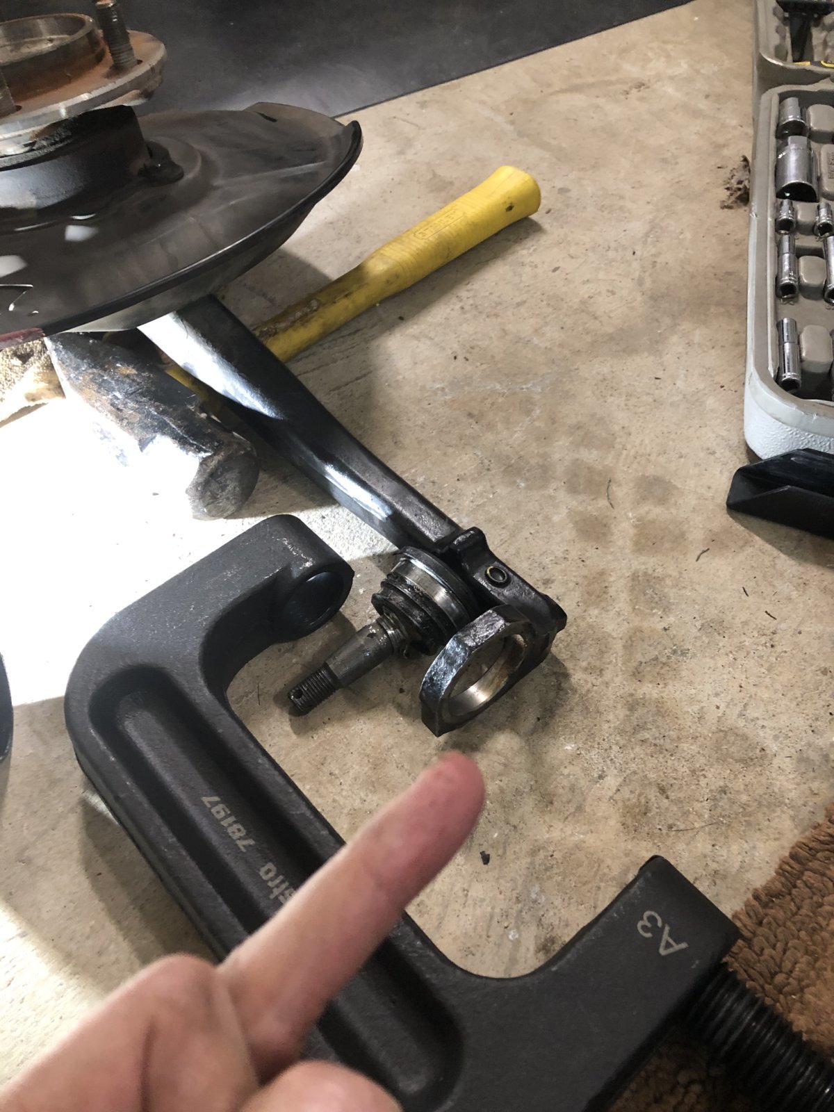

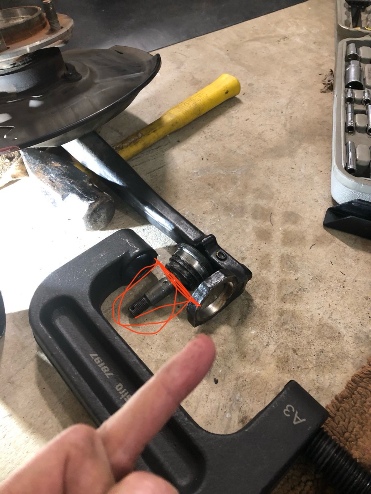

    Oh and obligatory "FU, UBJ" photo, they're unnecessarily painful on these trucks.

    thanks a bunch. Mine’s 2wd, and I was afraid to hit it with the BFH and dent it all to heck, like I saw in another thread.
    Talk about being a bone head, I didn’t know the rotor would just pop off with a hit or two…hence I never got to the part of the videos where you pull the cv axle through the knuckle. I saw that in the post 16 of the other thread.

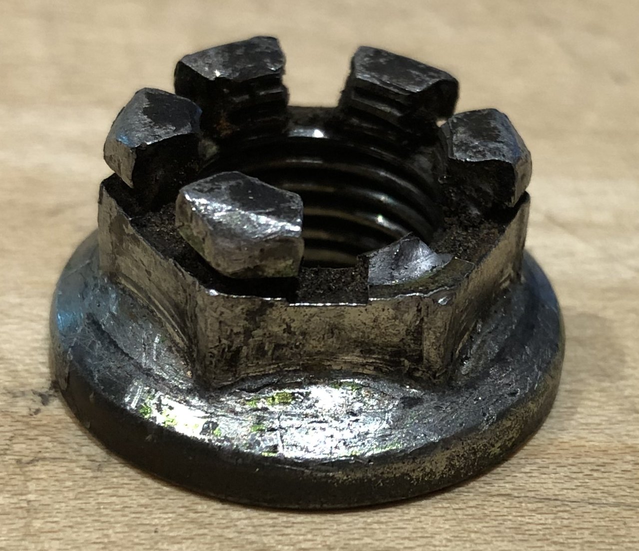

    And yeah, to loosen the UBJ from the UCA, the easiest way I've found during the half dozen times I popped mine free is just like above: Remove UBJ cotter. Remove UBJ castle nut. Flip the castle nut over and basically spin it down until it's nearly flush with the spindle bolt (i.e. almost like it's got a flat surface all the way across, which should leve a 1/8" or so gap between the castle side and the UCA). Then hammer the shit out of it, it should pop out within 3-4 good, solid hits down onto the nut/spindle, and the nut will catch the knuckle from falling and flopping out. When you're ready, lift up the assembly, spin off the nut, and voila! You're in business.
    Having that many threads engaged on the castle nut, and having it nearly flush will avoid wrecking the UBJ spindle threads and having the castle nut upside down like that not only gives you a nice flat surface to work with, but if you try this with the castle side of the nut facing up, you'll damage the little towers on the nut (example pic)! Super important to wind it down with the butt side up before hammering. Very common preactice for all kinds of joints.
