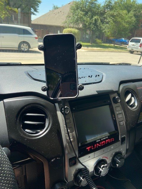

    Ranch Hand brush guard, TRD rear sway bar, TRD air filter, Husky front mats, Weathertech rear mat, LED interior lights, tow mirrors, Salex console organizer, key ring light mod, AJT key fob, Gator bed cover
    Did mine a couple weeks ago and love it! I haven't done any wiring yet but plan too eventually.

    Nice work.....I like it! :thumbsup: What size Furrion is that?

    It is the 4.3 inch screen. I had started with the 7 inch, but returned it for this one because it took up so much dash space, and the image quality of the camera isn't so good that you can see more on a 7" than 4 inch - if that makes sense...

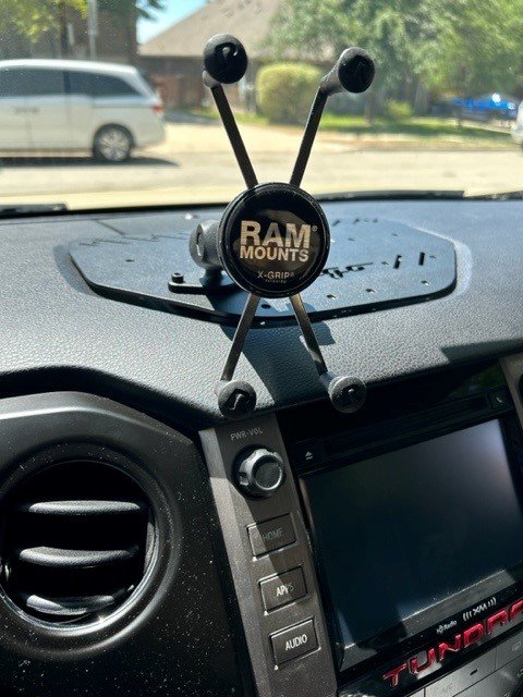

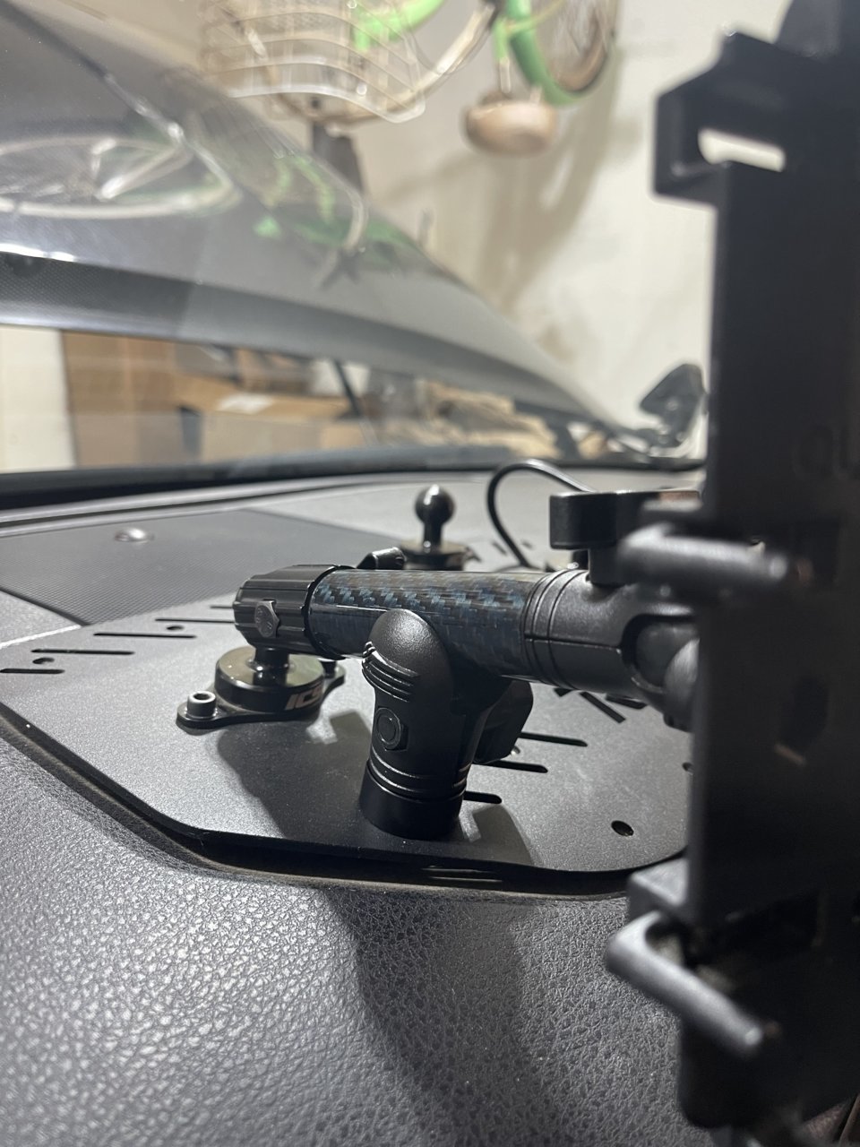

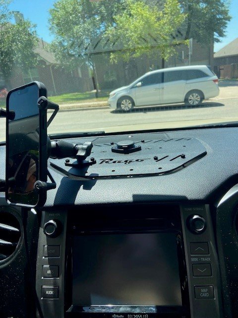

    For anyone thinking about mounting options, I spent a lot of money on RAM brand ball mounts, extension arms and phone holders. I finally got fed up with the arms slipping and falling and moving around……I bit the bullet and got the tackform ball mounts and extension arms. They are 100000000000% better - better made, better quality and better holding power with less vibration. Absolutely NO movement at all. I will likely be unloading the ram accessories and stuck with tackform

    I’m having that problem with mine. Do you have a link to those track forms? Added a support but we shall see

    Just more stable compared to the ram mounts. It certainly isn’t no vibration but way better than the ram. The longer the arms the more vibration and inherently the dash mount is the issue with the thin plastic. My point was that the ram mount ticked me off - especially in summer when heat seems to deform the rubber parts.

    I can confirm that with the ram ball. I’m hoping the steel one from track may help over the aluminum ones I run. They hold for awhile then wear and dust. But maybe the upright will help.

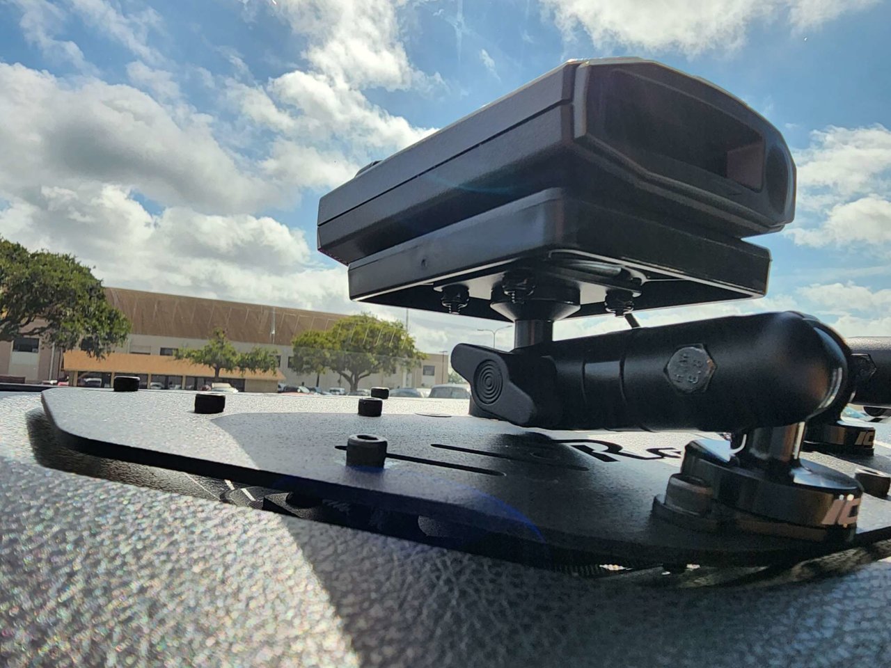

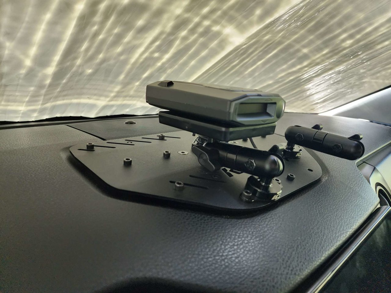

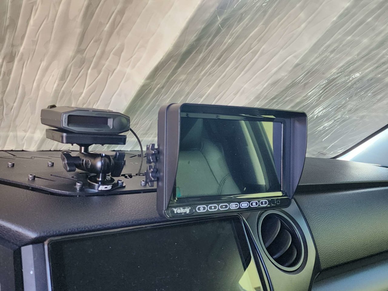

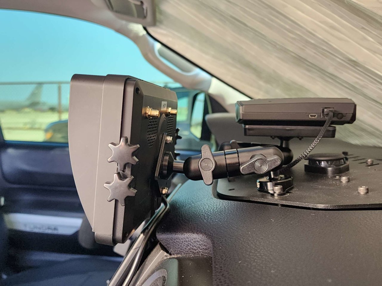

    I have ICS ball mounts and their 3.5 inch arms. The aluminum is nice. I just recently moved my radar detector to the plate due to the crappy suction cup. I also have the monitor mounted for the trip tomorrow. I have the Tachform ball mounts on the devices. Most of the Tackform stuff is a little cheaper on Amazon. I use all 20mm.
    Compress_20230602_103910_0479.jpg Compress_20230602_103910_0764.jpg Compress_20230606_091323_3636.jpg Compress_20230606_091323_3481.jpg

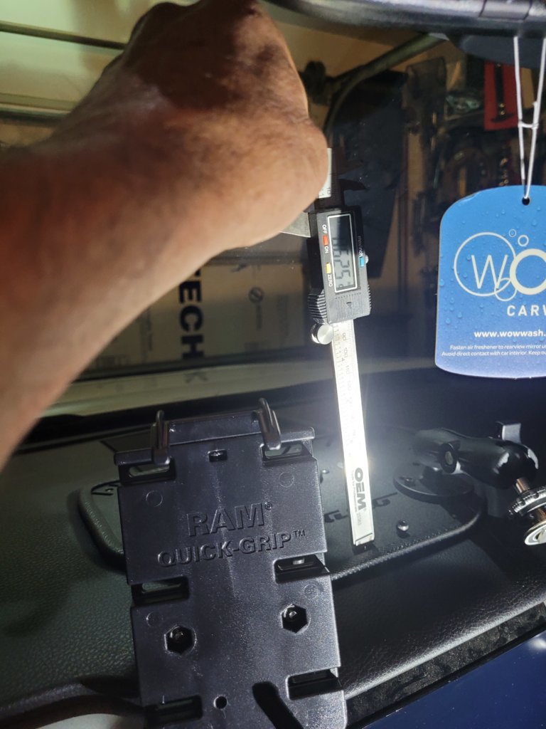

    I found that if you put moderate finger pressure on the front of Rago dash mount (even with ICS base plate) you get approximately a .033 deflection, however if you put a couple of screws in unused leading edge holes and contact dash it takes the flex away. 20241008_055442.jpg
