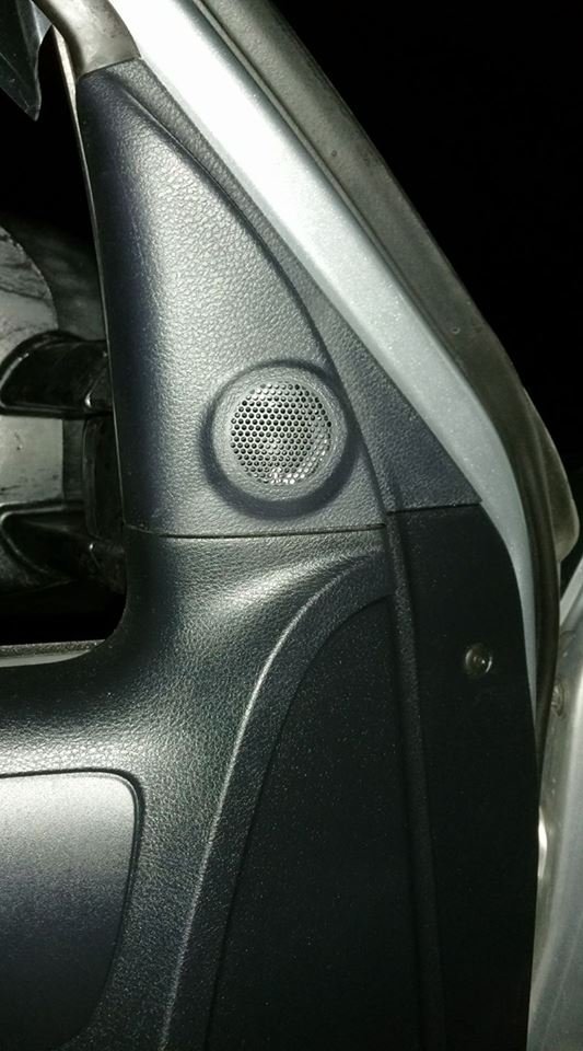

    This is a sail panel. Trucks with the JBL system have them with tweeters installed. Idk if non JBL have these, they may just be solid panels. James sells sail panels that tweeters can be installed into on his website. https://www.shop.tech12volts.com/product.sc?productId=566
    Yea this group buy is for speakers that replace the existing speakers in your truck. Included will be brackets and harnesses to make them all easy to install / plug and play. There is no need to run any wires to the head unit at all. This package is a great option for keeping the factory head unit, but will also work with an aftermarket head unit, and/or if you add an amp into the mix.

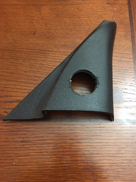

    @tightywhitey You'd either need to cut your sails or buy his pre-cut sails for $60. I'm going to have to make that decision when I jump on this in a couple of weeks, if it's still available.

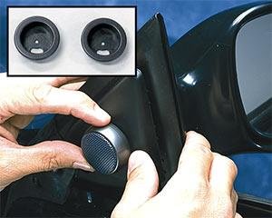

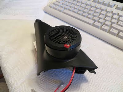

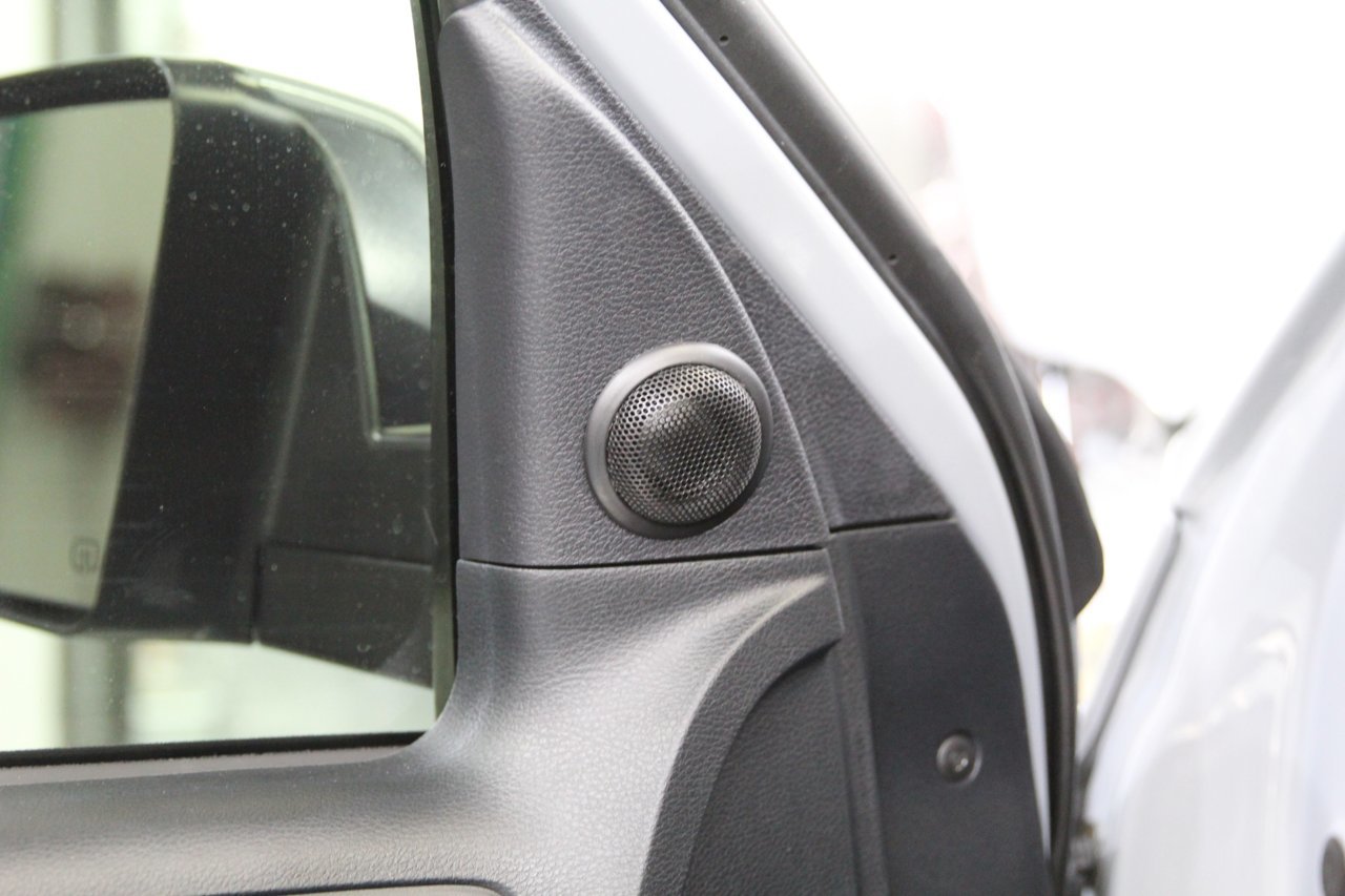

    It would pretty much be plug and play. You can spend the extra 60 for new sail panels or you can mount the tweeters to your current panels, this would require cutting a hole. My guess is that the speakers come with a template and a few options / brackets for mounting the tweeters
    Edit: the tweeters do come with mounting options. So you can definitely use your current sail panels....
    "Features
    Tweeter Mounting: Brackets are included for flush mounting and angled surface mounting (60° or 30°) the tweeters. If surface mounting, holes for the mounting screws and wire will need to be drilled."
    Here are some Pics of flush vs surface mount into / onto sail panels that dont have preexisting tweeters

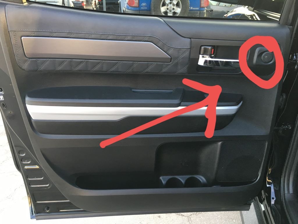

    Where does the tweeter go for the rear door speakers?

    On my platinum they go here

    Same place on my 2018 SR5 CM.
