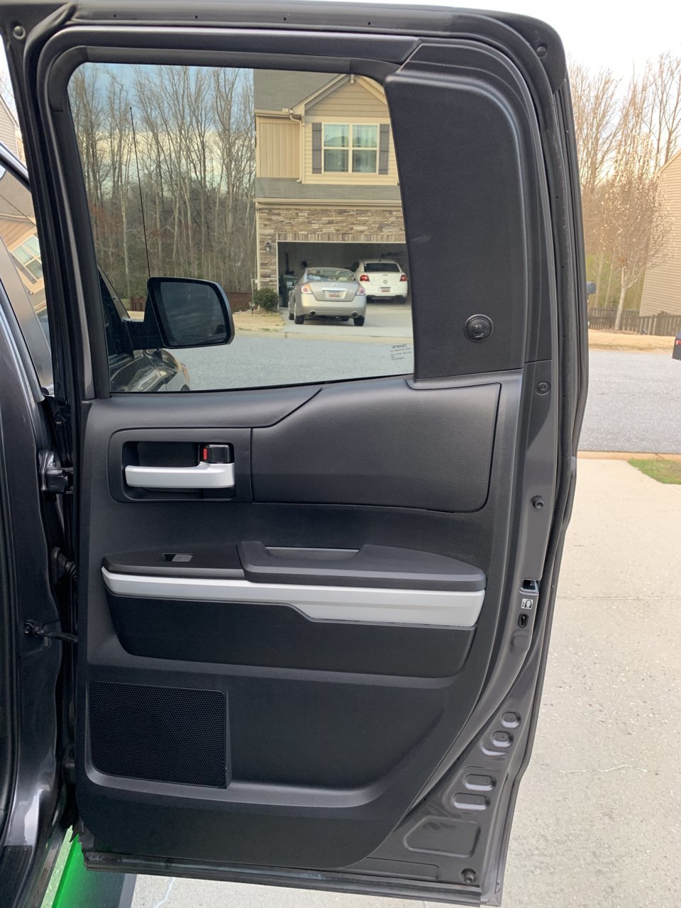

    The front if you have them are in the sail panels. You may have rear tweeters depending on your trim. Lets see uour door lol.

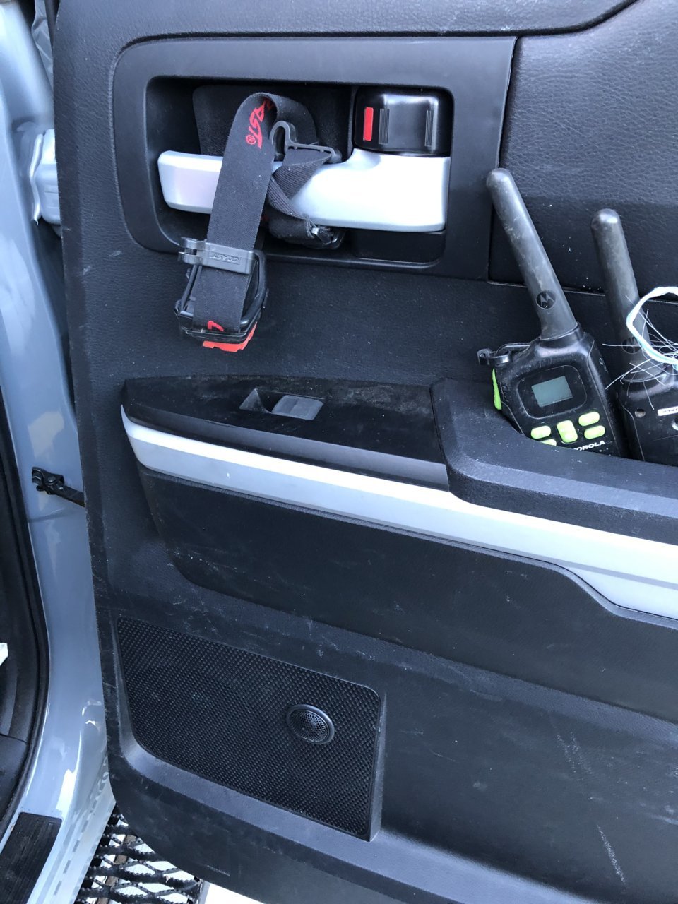

    Think the dbl cabs are missing that front area. I will take a pic of my rear door

    Oh, ok. I wasn't clear that you're a double cab. Yes, yours won't have that then. Your install makes perfect sense then.

    Yeah missing the front of the door area.

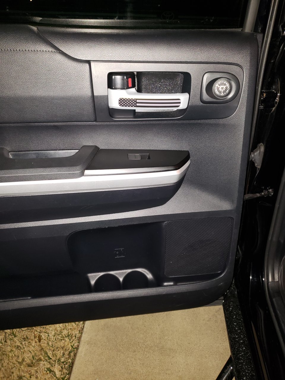

    For those of you with Non JBL Double Cabs. Just another mounting spot.
