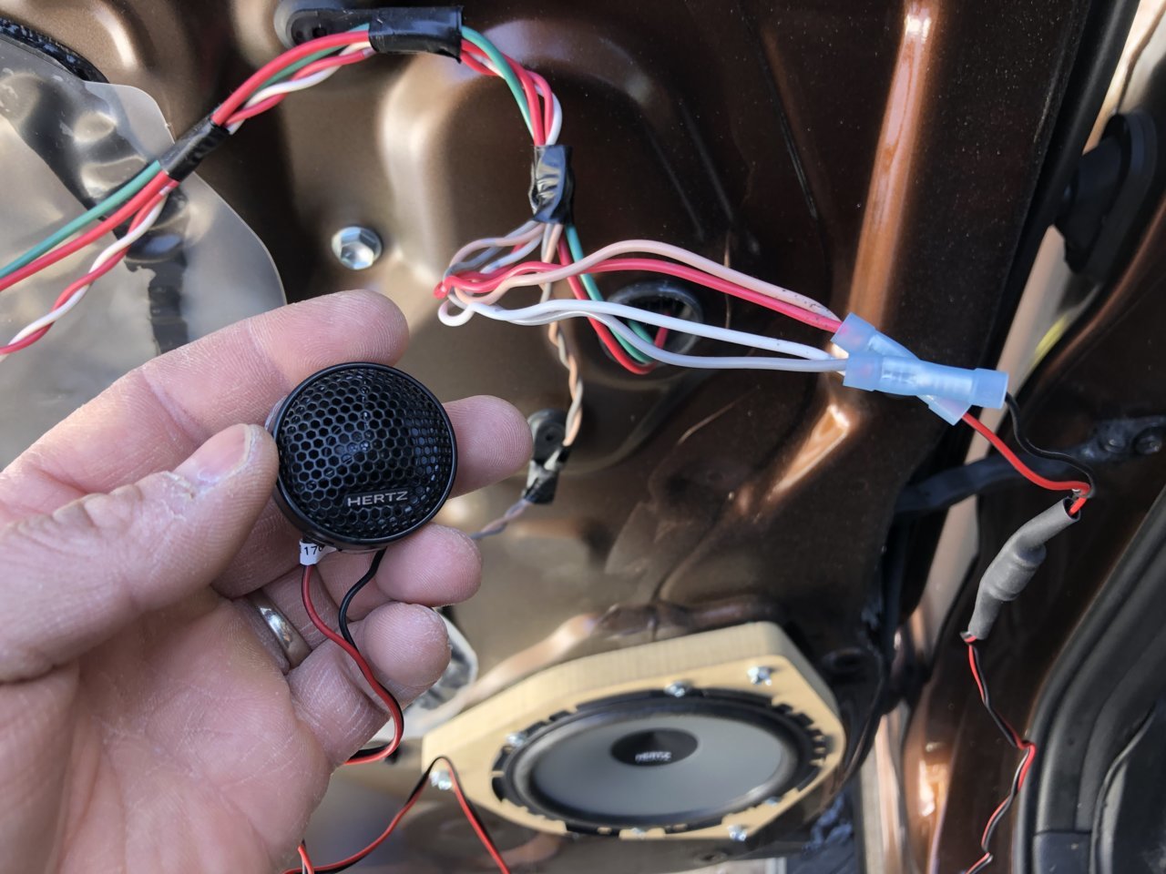

    75
    C
    Pull the harness off, and cut the wires right at the speaker. I ended up extending the wires cause they're too short with 18 Gauge Wire, and then use a female connector to connect to the speaker. This guy showed me how to do it, https://www.tundras.com/threads/blaine-18-platinum-build.39199/page-2#post-1033150
