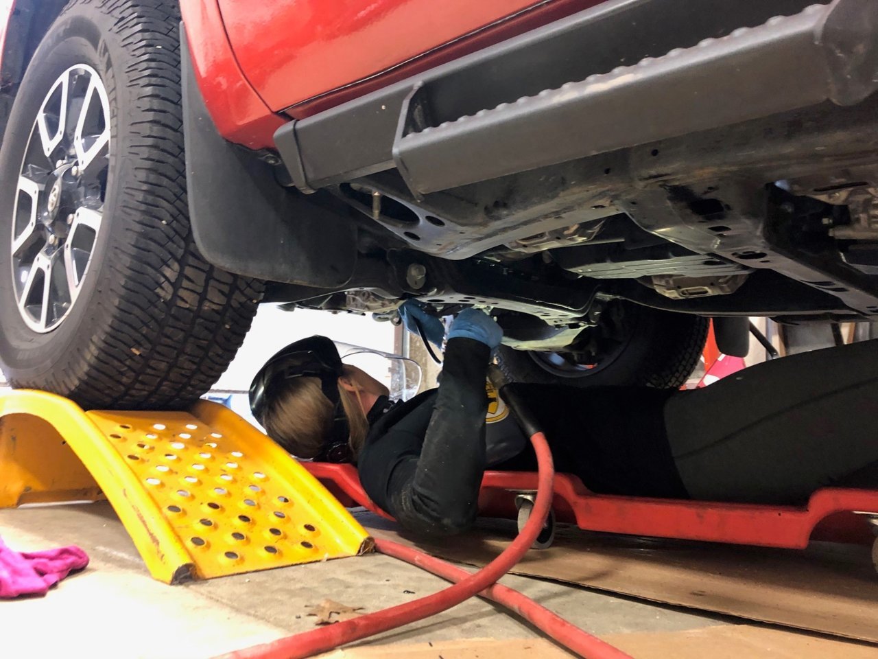

    Spent several hours woolwaxing the underfluffies of my truck a few weeks back. Went on great with the pro-gun and 80psi or so and was able to get my tiny hands into all the nooks and crannies. I've since driven on wet roads and two fairly heavy rainstorms and the water just beads on the surface, the WW sticks like a mofo. Time will tell when spring rolls around but I'm sure it'll be better than nothing in the Maine winters..

    Wanna drive up to MB and do mine? You look like a pro at it. :yes:
    Just out of curiosity, how much did you end up using to do your truck?

    I didn't even want to do my own truck so.. no.:rofl: Plus, the last time I was up there I dislocated my damned shoulder so I've sworn the entire country off. Even though it was my fault. o_O
    I ended up using about 3/4 of a gallon and got the black colored WW. Heard people that get the clear 'straw' WW have a hard time telling what's been sprayed and what hasn't once they get into it and I will say the black def helped with that.
