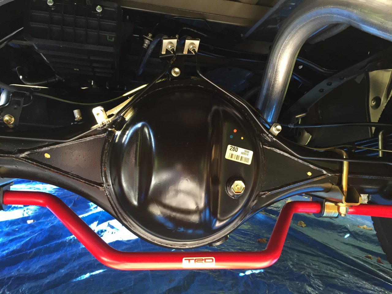

    If someone has some pics of HDMP after application I would like to see.

  14. Nov 5, 2019 at 6:27 PM
    #74
    TILLY
    TILLY Gently Used Member
    Sep 7, 2019
    #35797
    4,843
    Massachusetts
    2019 MGM TRD Sport D/C
    Luckydog, here's a few i took at the end of Sept., Plan on doing another coat tomorrow before the snow flies. :thumbsup:IMG_0466.jpg IMG_0468.jpg
    Pudge likes this.

    That looks a lot cleaner than FF. Thank you Tilly!!!

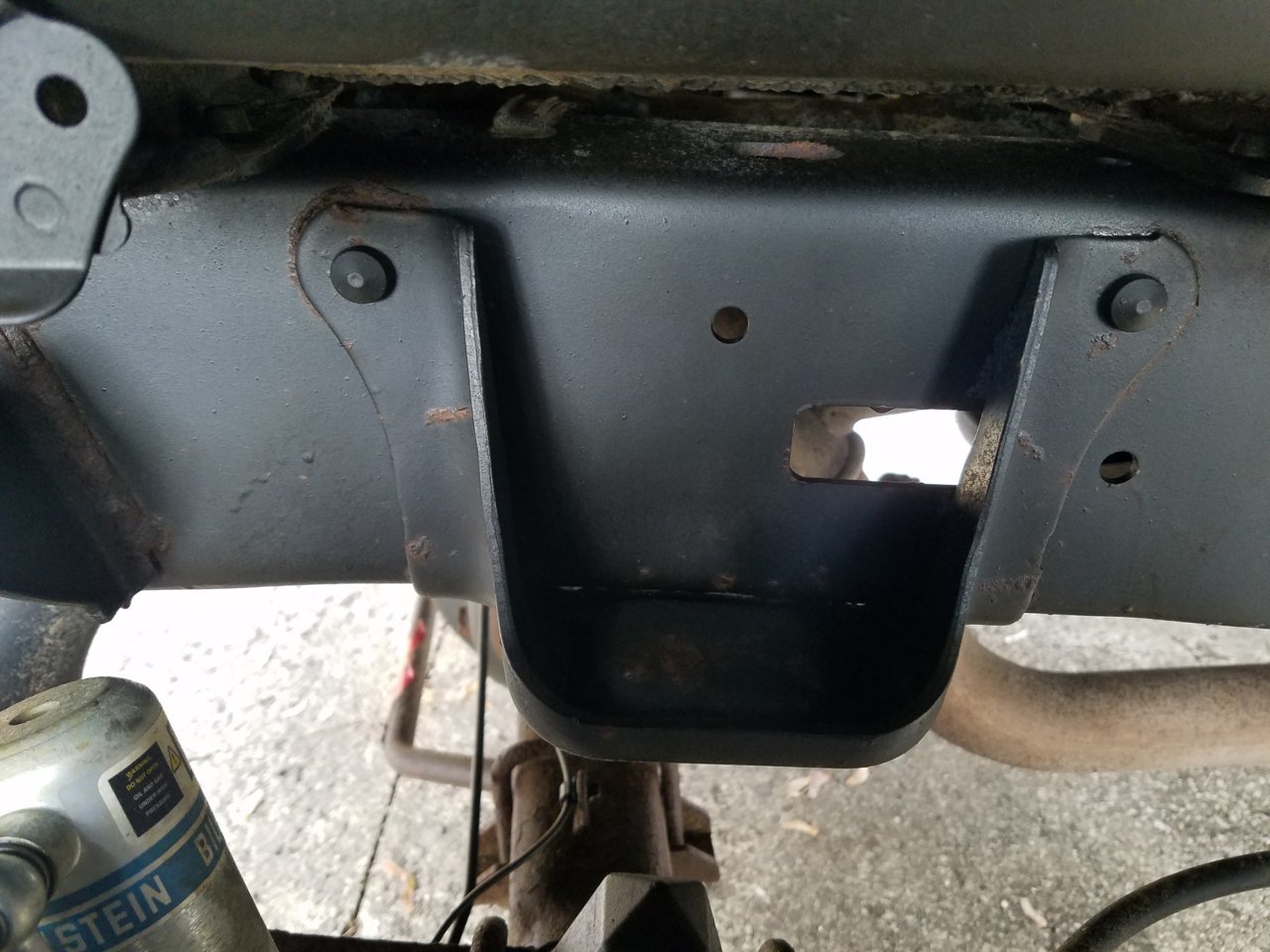

    2012 DC Pyrite Mica TRD SR5
    I like the approach Classiccat takes. I suppose thats kinda what I've done since I've FF the last few years and just now finished 4 cans of MPHD.
    For an 8 yr old frame, this looks good for NE Ohio.
    OBXTundra, TILLY, WFD473 and 2 others like this.

    Frame looks good.
