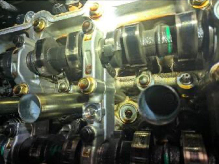

    I can't comment on what previous owners would have done, but why would the top end of this motor be apart before I got it (<90k)?

    Have you read this thread? The pics may help you determine if your engine's been opened up. Or run the vin on Toyota's website. If the cam tower job was done it was likely at a dealership.
    https://www.tundras.com/threads/cam-shaft-tower-seal-leaking-please-read.20102/

    Well, insurance was convinced enough to give me a motor. Still debating used/reman/crate, but in any case this feels like good news. Thanks for all of the help, and I will update this thread if I learn anything more.
    Here's another picture of the head I found. Screen Shot 2019-11-14 at 12.41.17 PM.jpg
