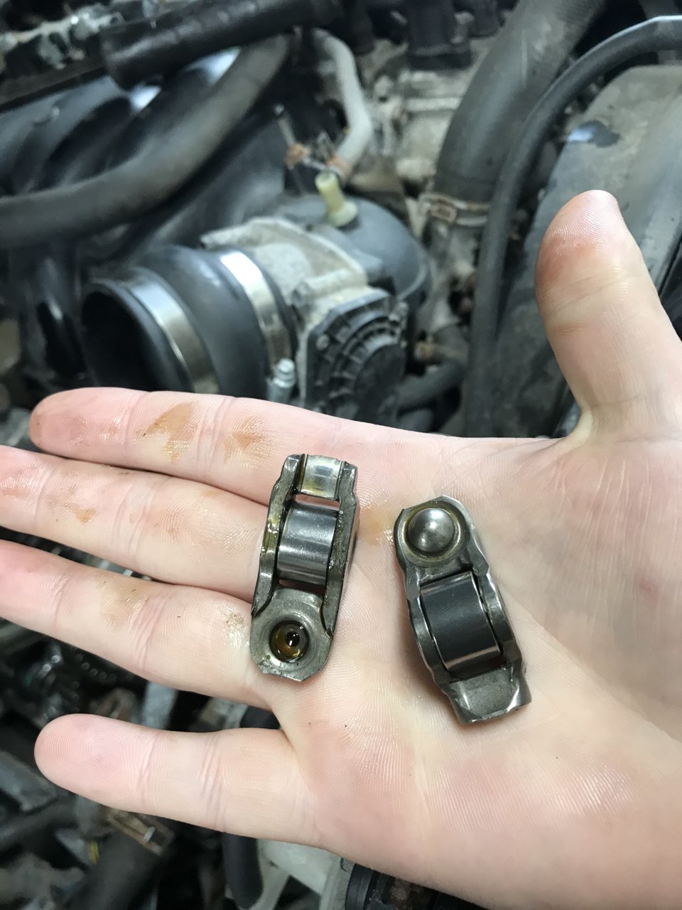

    So it's been awhile since I've been on here. Hope everyone in tundras.com land is doing well.
    This time my hiatus was not from the ban hammer (I learned my lesson) but rather due to some lingering issues that I've had with my truck. I had it into the dealership a couple of times over the last few months explaining my issues but of course each time they said they couldn't replicate them.
    Long story short, late last week the truck went into limp mode with the CEL flashing and me unable to go over 35mph (maybe a blessing in disguise). The dealership wasn't far away so luckily I didn't get stranded.
    They call me today and tell me that the code is for misfires in cylinders #1 and #3. They moved coils but misfires stayed put. Come to find out that the rocker arms had completely come off in #1 and #3. How does that happen? Hopefully it can be resolved but does anyone know what underlying issue might have caused this or what other damage it could have done to the motor?
    NOTE: I'm not here to bash Toyota and I'll delete the thread if that's where this thread goes. The dealership is another story. I'm just trying to get my truck back to running how it was when I got it.

    Need candid snaps of the affected valve train components.
    I realize it's a lot like I'm asking for nudes but this is for science.

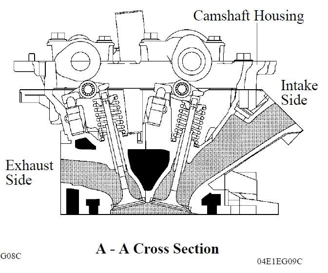

    Here is a cross-section view of the valve train. The rocker arms are not secured by any shaft but ride on the tips of the hydraulic valve lash compensators. There may be some scenarios where valve float could allow them to become dislodged (just guessing).

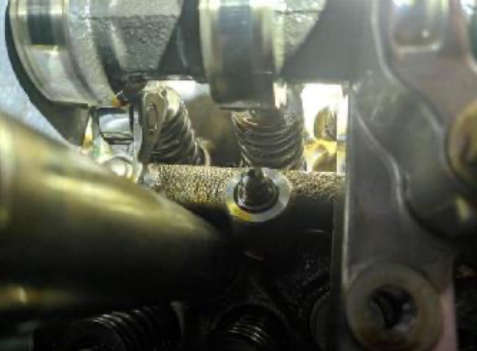

    Someone PLEASE tell me this came to some sort of resolution.
    I am likely having the exact same issue, except I believe I've lost SIX rockers.
    I posted my story here looking for help: https://www.tundratalk.net/threads/...repaired-still-misfiring.766557/#post-9474411 but the short version is I had bad misfires on 1, 2, 3, 5, 6 and 7 and found that some mice chewed two wires under my fuse block. Repaired those and the misfires continued. Pulled the passenger side valve cover and found the rockers for the intake side of #2 and #6 just sitting there. Haven't pulled the other side (because it's much harder to get off), but I assume it'll be the same on all four cylinders over there.
    I filed an insurance claim (have comprehensive that covers rodent damage), but they only want to cover the wire repairs ($500) because they don't see the link between the wiring and the rockers. To be honest, either do it, but I don't believe in coincidences like this.
    Didn't we all buy Toyotas so we didn't have to deal with this BS??

    Did the truck run fine and all of a sudden you get misfire codes?
    The only thing I can come up with is collapsed lash adjusters but that's pretty weak. The followers aren't really held by anything except the valve pushing up on them and being trapped by the cam lobe and the lash adjuster.

    Can you tell if the lash caps are still on the valve stems? And what color is the gasket material on the cam housing, black would indicate someone has done a cam tower reseal

    I can't remember if the caps were still on the stems, and can't see it in any of my photos. Same with gasket material, but I can see some green in some photos; that the right color?
