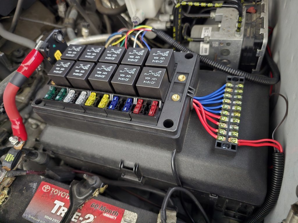

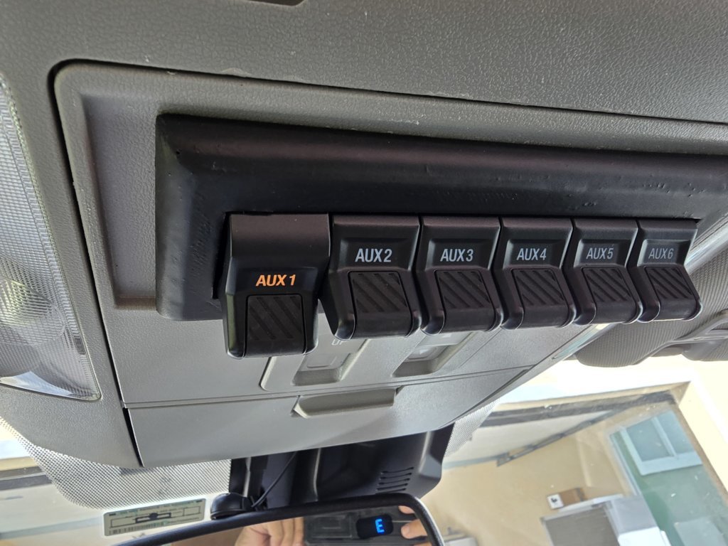

    Quick update. Tested the water/meth setup using a custom switch panel and relay box to arm it. The switch panel is connected to the accessory circuit so that when the truck is turned off, all switches automatically turn off, deactivating the relays. The relay goes directly to the battery, and when the switch is on, the relay arm the water meth system.
    Designated switch to arm the water/meth system AUX1:
    Relay box view. 6 relays are controlled by the switch panel. The first one is assigned to the water/meth system:

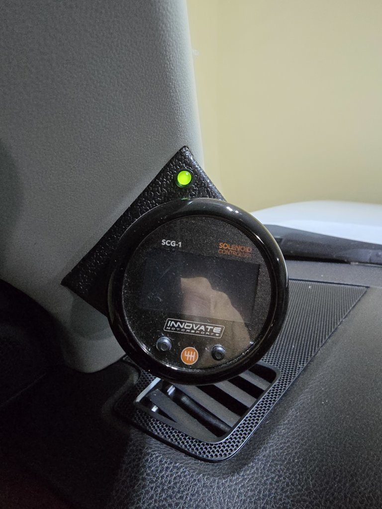

    When the system is armed both LEDs (in the controller and the external) turn on. When the pump is active the LEDs becomes brighter.
    Controller:
    External LED that mimic the controller LED:
    Love this setup and how it works. Having that second LED visible at that level really makes it easy to see when it is active or detect a problem indicated by the amount of LEDs flashes in the event of a system failure.

    I really need to mount my second led. Right now it’s just curled up and stuffed above the steering column just hanging in the wild. Think I’ve finally convinced myself to drill a hole and mount it in my a-pillar at eye level. Just no other place I want to put it.

    Nice, IMO the pillar is the best spot for it.
