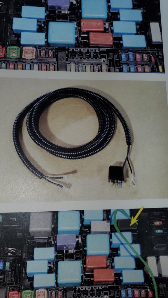

    Apparently some superchargers come with them. @mustang67408 had some funky thing that came with his supercharger that plugged into the boost port and hooked into the pump relay and it presumably increased pressure once a certain boost level was hit. Like Mdl said he removed it entirely though, since there doesn't seem to be an issue always in high pressure mode and less shit to go wrong.
    mustang67408 and Black@Blue19 like this.
  28. Apr 13, 2025 at 1:29 PM
    #2158
    Wynnded
    Wynnded What MPG...
    #379
    5,650
    Rockies
    Souped up truck
    Ya, just imagine blasting on the gas pedal and that gizmo decides to hiccup and the fuel pump dropping into low pressure mode.
  29. Apr 13, 2025 at 2:01 PM
    #2159
    mustang67408
    mustang67408 Toyota Master Diagnostic Technician
    Aug 21, 2020
    #51133
    107
    Victor
    Hot dry place in Nevada
    2010 Tundra CM 4x4 FFV 5.7 (Supercharged)
    Current : Magnuson S/C 5.7 FFV, Tundra CM, SNIV tuned w/HP Tuner, SG-1 Wide band AF w/gauge, TRD cat back, slotted and drilled rotors, stainless brake lines, TRD pads front and rear, front OEM Sport sway bar, rear TRD sway bar, 38 gallon OEM fuel tank, Tesla screen, ham radio, 2.5 Icons w/ res front and rear. X2 battery w/Voltage Booster Pro 2014 OEM wheels. https://drive.proton.me/urls/Y8739Z14BG#HCVT8AowG9fl ---------------------------------------------------- Previous: 2002 Tundra AC 2wd... Converted to OEM 4wd , S/C 4.7, TRD exhaust. 35's w/4:88's, too many other mods to list. https://drive.proton.me/urls/SWEWY4AFMC#eC7zX57Ex6pI ---------------------------------------------------- Other: 1967 mustang , Blown 408, 671Mike Kuhl 12.5% overdriven, 300shot NOs 5 speed TKO600, 4:11's Ford 9", Detroit Locker (real) Evans Coolant, Twin 12" Spahl fans https://drive.proton.me/urls/ABBVY3TQ3M#OT9LceyNwbTy ---------------------------------------------------- 2015 4runner TRD drop in filter Prinsu 1/2 roof rack, Nfab side steps, TRD FJ lift kit. ---------------------------------------------------- 2007 Prius 45mpg+ ... It's the only way to afford fuel for these Beasts!
    I think you are talking about this thing.
    Yes it's supposed to up fuel pressure under whatever point it's set at..
    I removed it and by passed the fuel pump vsv... My truck is FFV.
    0 problems with that set up..
    53 psi @idle and it's boost referenced now.
    I've seen as high as 80psi with my vacuum/ pressure pump attached to it.. just to see what it would do..
    Wynnded and snivilous[QUOTED] like this.
