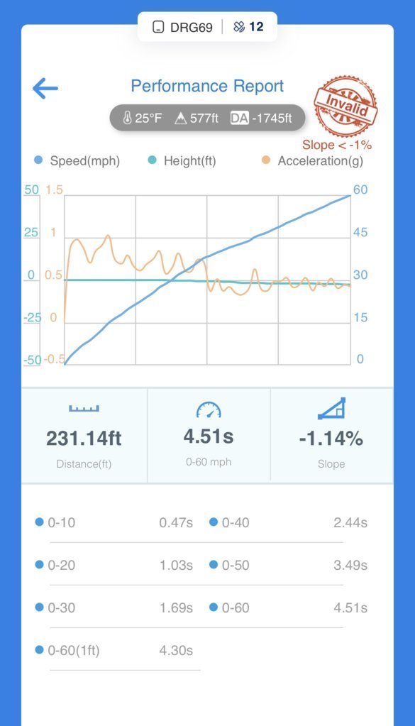

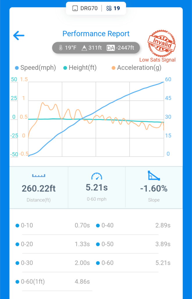

    A/B comparisons as of today. As other TC installs come online and we can get some better samples and more boost, it'll be interesting to see what the turbo charts look like to get to a matching time.
    The amount of instant power is clear with the SC. I'm also curious if the 5.29s ended up hurting my boost since there's a little less load vs stock gearing.
    Regardless, pretty cool comparison
    SC:
    TC:

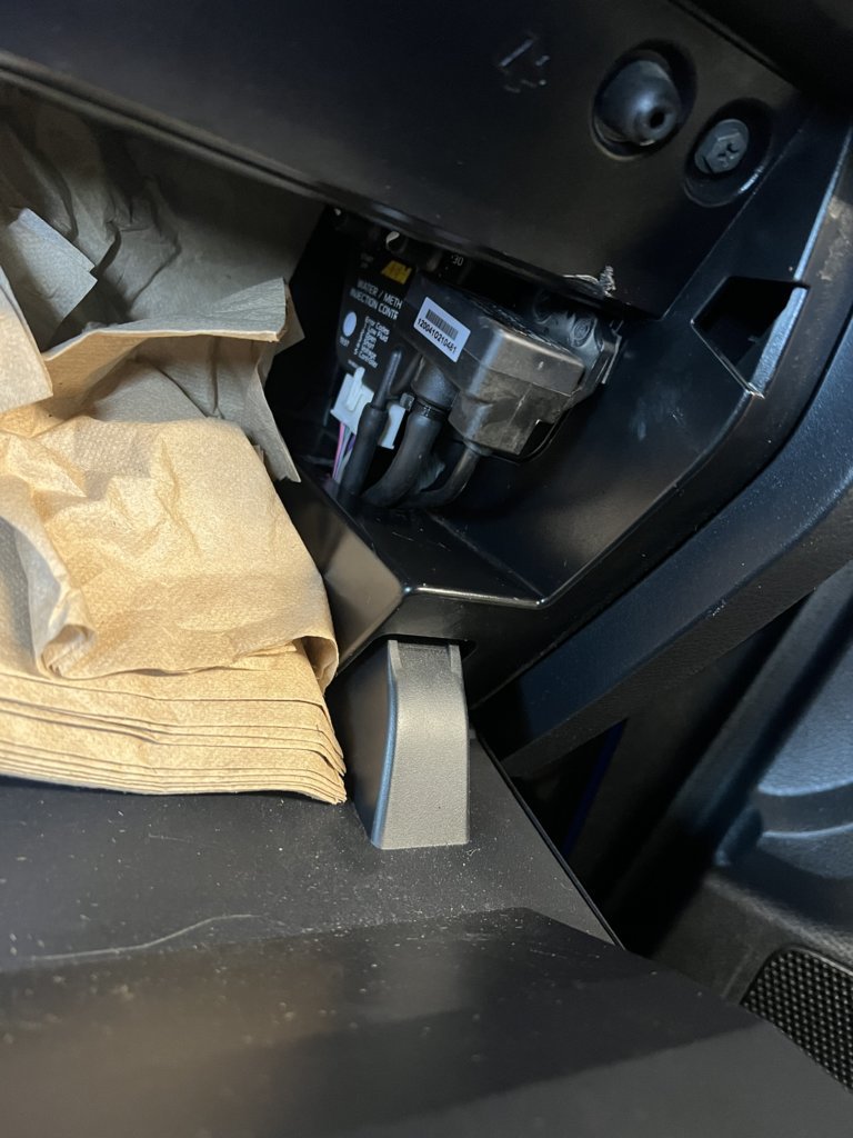

    Not certain if my MAP was bad or if the connection was loose or maybe just the under heat was screwing with it after a month or so. It worked this morning for my first drive, then it didn’t the second. Went to pull it out and the connector came apart real easily. I decided to move it to the glove box to keep it away from heat and anything else and it’ll be easier to swap out if I decide to. I’m gonna tape the connector up and see how it goes. New one arrives today so if it goes weird again it won’t be an issue.

    Interesting. I wonder if the hoses need to get hit with some compressed air prior to final connection just to rule out any contamination/debris. Both of us having this issue is strange

    That was short lived. Worked pulling out of the garage. Dead next time I start it. Oh well.

    Seems you've concluded that it's probably not a connection issue, nor with it being mounted in the engine compartment/heat related. That's something.

    Ya it’s pretty definitive. Now the new one is mounted inside so hopefully no more issues. Which is good cause I got the green light for the meth and another psi and I’m towing tomorrow so I really need the gauge functioning haha.
