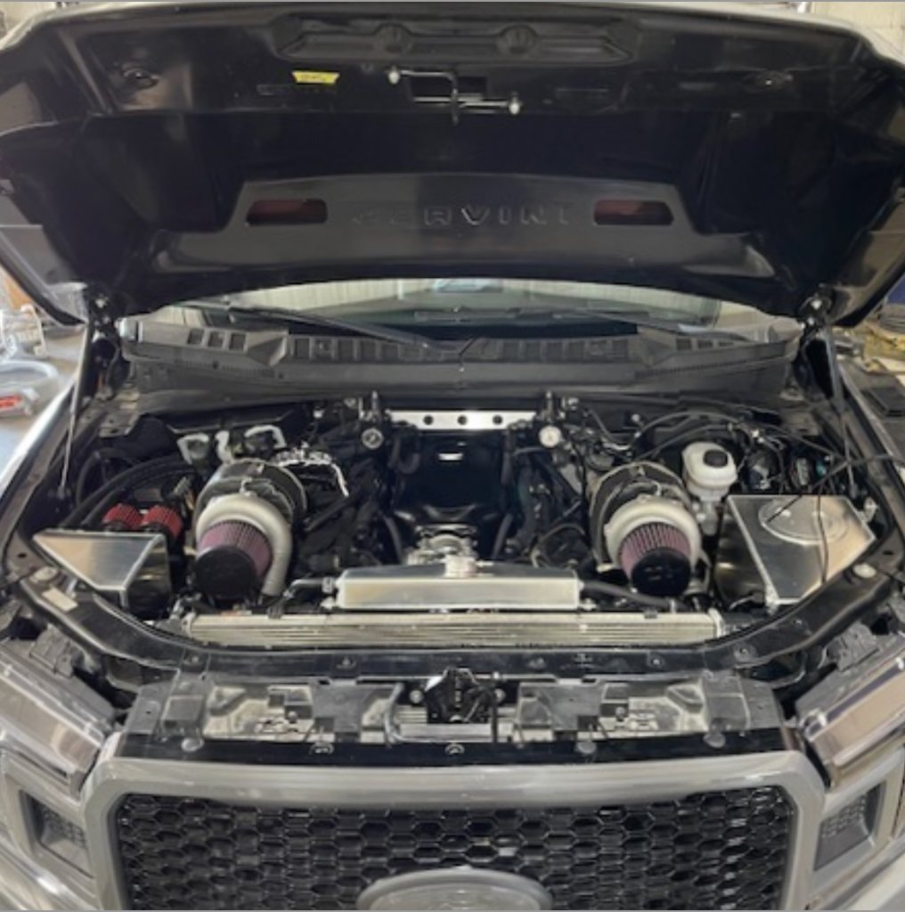

  2. Mar 20, 2025 at 2:13 PM
    #2012
    TurboKits
    TurboKits New Member
    Nov 11, 2022
    #86522
    532
    Would have to be a complete engine bay tuck most likely to fit a twin set up, maybe to smaller turbos underneath, but the complexity and cost wouldn't really bare in the market. Anyone wanting to do something like that, would just have is custom fabbed...
    Mdl likes this.

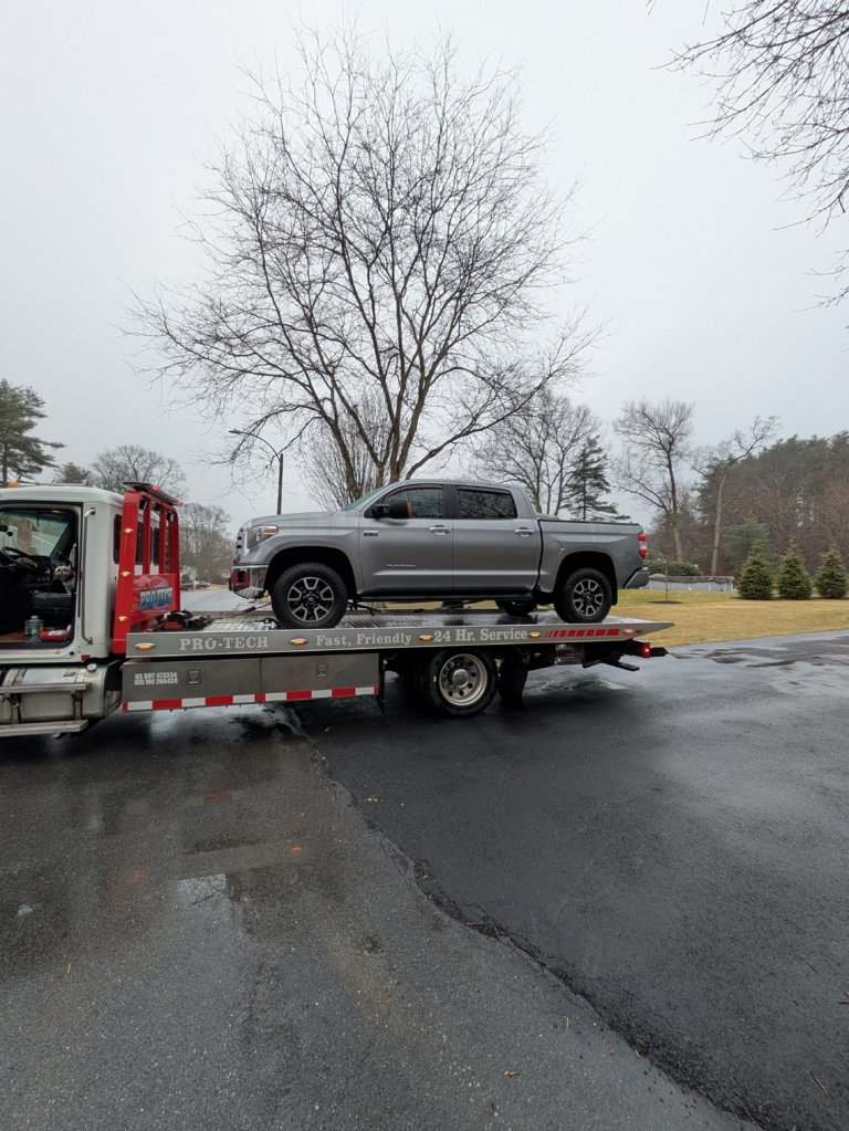

  8. Mar 20, 2025 at 4:51 PM
    #2018
    bflooks
    bflooks [OP] New Member
    May 9, 2020
    #46273
    2,054
    Metrowest MA
    Old girl getting transported in for her pending transplant. At least she still looks decent and luckily didn't get put away covered in salt.
    Silver17, TurboKits, ssmokedz and 2 others like this.
