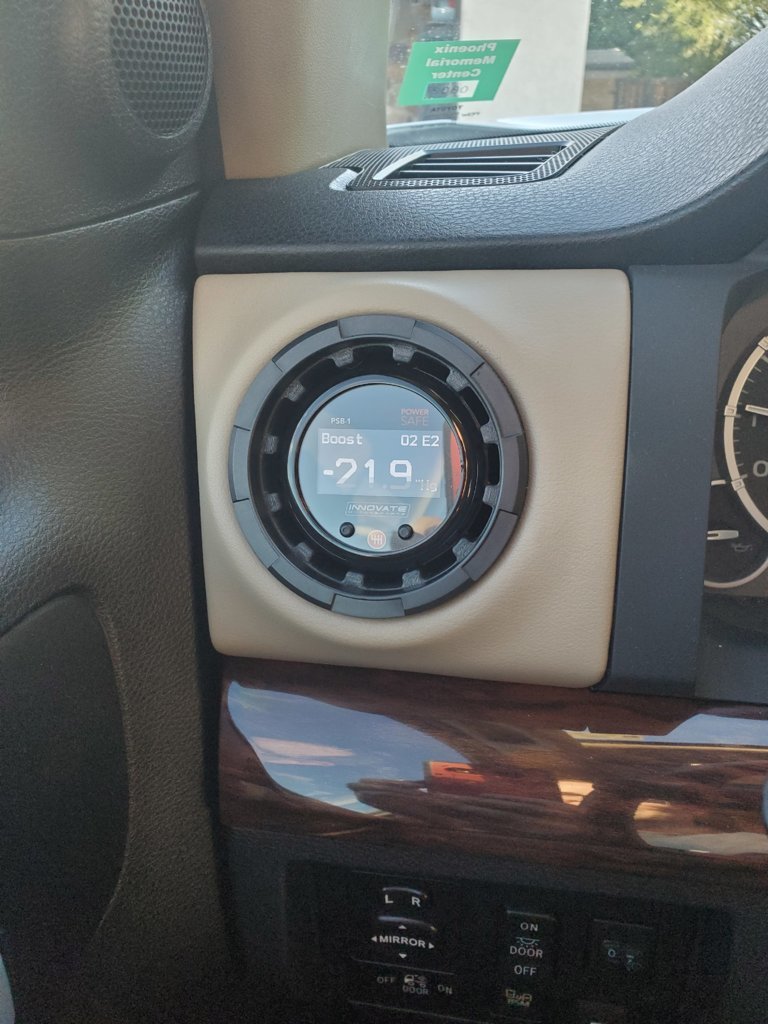

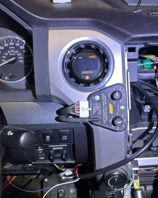

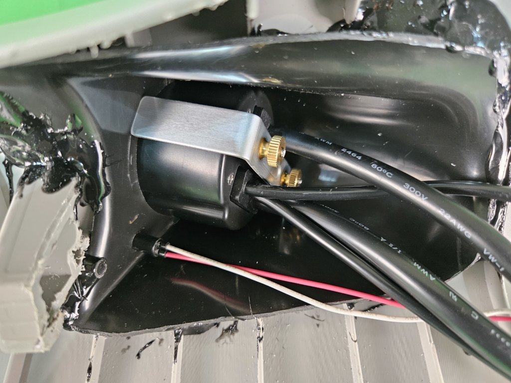

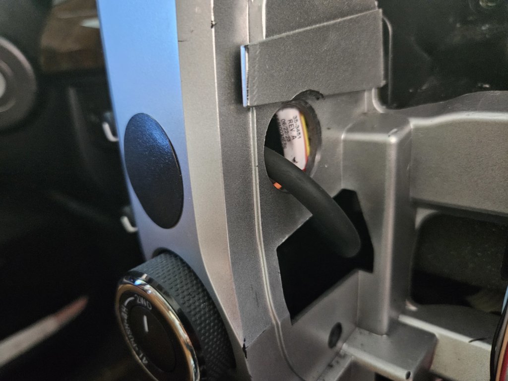

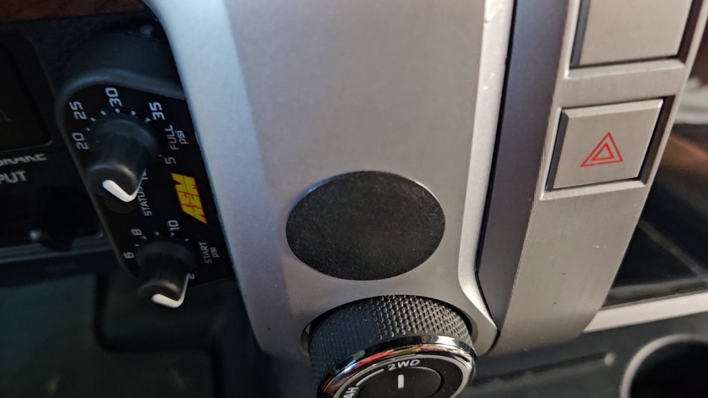

    Decided to back mount the AEM controller on our 2016 TRD Pro project truck right under the gauge. It's cut and mounted from the back and then plastic welded into place as well. Going to look clean once everything is in place

    Those AC gauge mounts are insane to me. 105* and I want that AC blowing exactly where I want it. Not just off willy nilly or blocked off entirely. They do look cool though.

    It's not as bad as it looks. There's still air flow coming around it, but yeah... in 105*, I agree, it would not be a good choice. For us up here, it's fine, and honesty, the LC blower upgrade will quickly return flow to original.

    Now I'll need to look and see if that vent is more visible than the left side. Nice having everything readily available in one spot, with zero questions asked. Can't wait to see everything finish installed.

    I went with the left side vent since at least it seemed like the center vents had more airflow, but I could just be imagining that. It gets damn near 120 degrees in July and August in Phoenix and even though the gauge blocks some of the airflow and you can no longer adjust the direction it really hasn’t been an issue at all. I would still take the same route again.

    I like that it it is such a clean and discreet install. The left side is where I chose but I won't lie, it sometimes is hidden a little too out of the way. That said, I still like it better than a traditional pillar install. Lots of time to sort it all out, but I am liking seeing all of the options being revised. I'd love a HUD option someday.

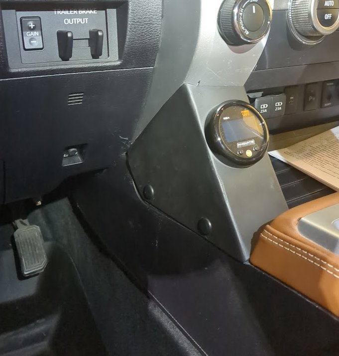

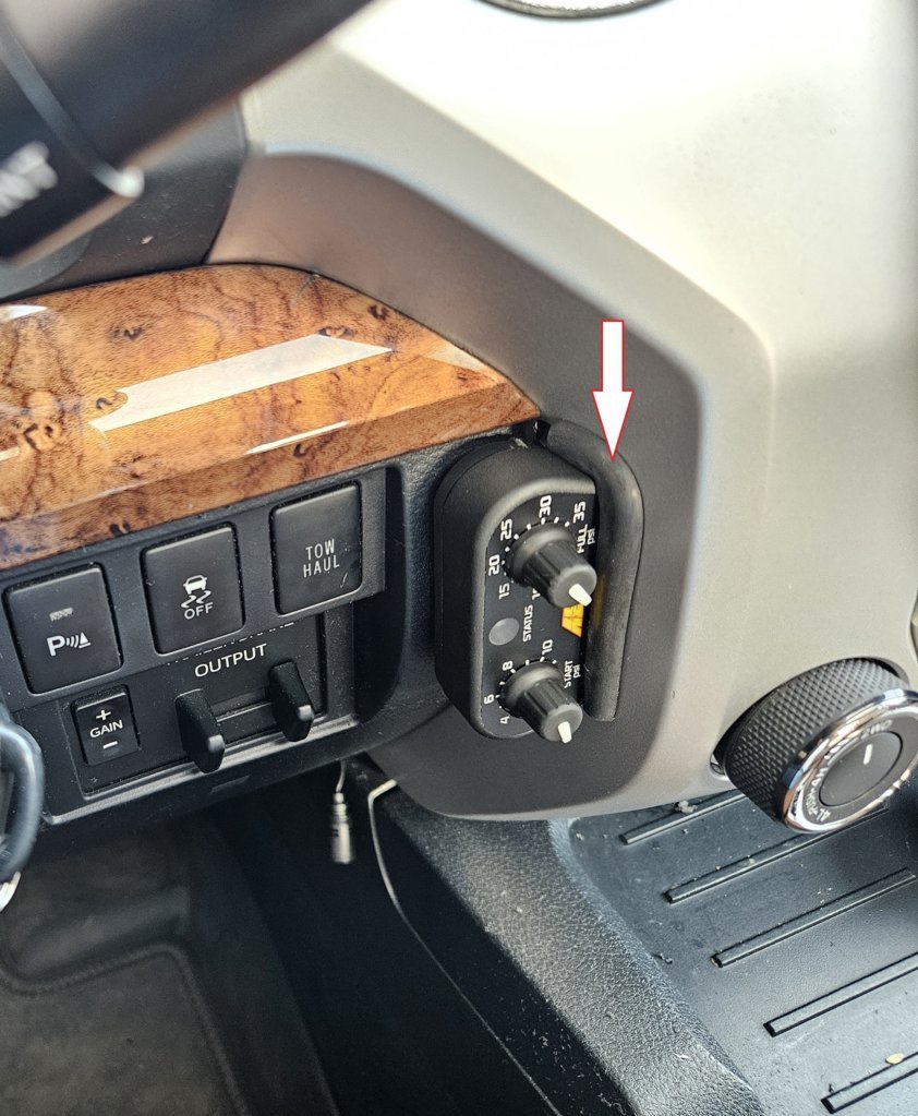

    Looks great! I made mine near that area. I drilled a hole in the front to access the test button if needed. I installed a removable plastic cover to cover the hole. The fuse can be removed if necessary by pulling the controller out slightly. Initially, I added a rubber grommet around the controller mount border, but in my opinion, it was too wide. I'll add a thinner rubber grommet to see if it fits better.
    here is the rubber grommet I want to replace. A 3D printed base is also an option.
    Another option for the gauge.

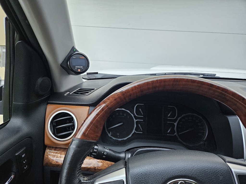

    I'm with centex, the vent gauges baffle me. This is still the best spot imo.

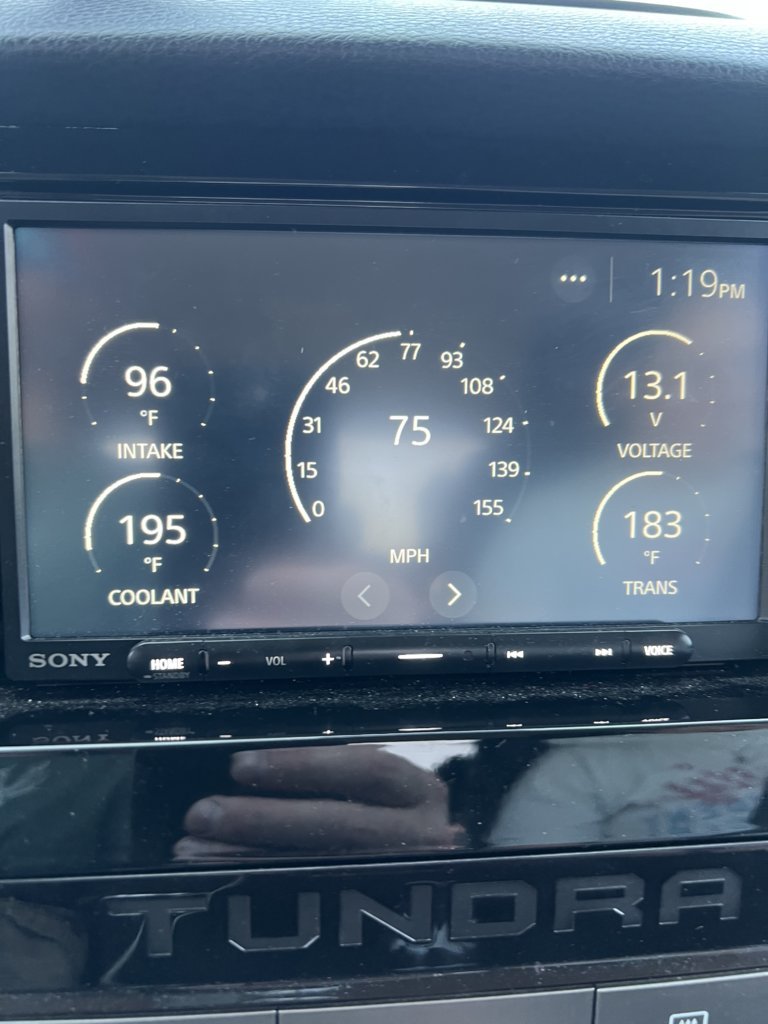

    Temps after an hour at 75 with a 20-30mph head wind. 91* outside.

    what is your calculated load values and is this just cruising or is this towing?

    Yeah buddy, what's ambient?

    91* ambient. Truck is running around 4” of vac and flirting with 1psi boost.

    75-80% load. No trailer.

    That's huge for baselining. Thanks for sharing, and I'm glad to see you are running very similar values to what I've historically seen, especially on the IATs and ECTs. Just confirmation that neither of us are anomalies. That's comforting in a way.
    I'm completely envious of all you people who run that low on the trans temps. That's just never, ever, been my reality. 190's consistently to maybe 203 these days at highway speeds, high 180s with speeds down below 60MPH. I know 10% isn't a huge swing, but I'd prefer to be at the floor of that swing, not the ceiling like I am.

    4* temp delta from that massive FMIC... Nice! :) and that's what is actually being fed to the motor, as there is nothing between the reading and the engine that would increase IATs!

    I’ve seen it touch 199-200* ect a couple of times but that’s it.
