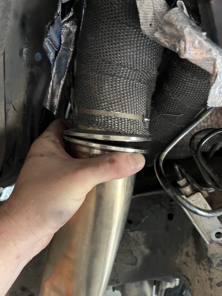

    That’s a good thought. I’ll try that when I get back from the store. From what I can see, if I can rotate the top down pipe a little farther it’ll line up better so I’m grabbing a better cut off tool to trim the fender.

    Wtf. I can get the v band on now but no matter which way I twist it I can’t get the things to seat. It’s almost like they are warped.

    Well it’s in but I’m not thrilled. Emailed Jesse to expedite me a new one because we leave for a 12hr road trip Friday. I’m gonna go ahead and order some 1.5” wheel spacers like I told myself to last night.
    Just to be clear, this is not a problem with the kit. Just something you have to deal with when you run oversized tires and aftermarket wheels and try to modify things designed to fit a certain way.

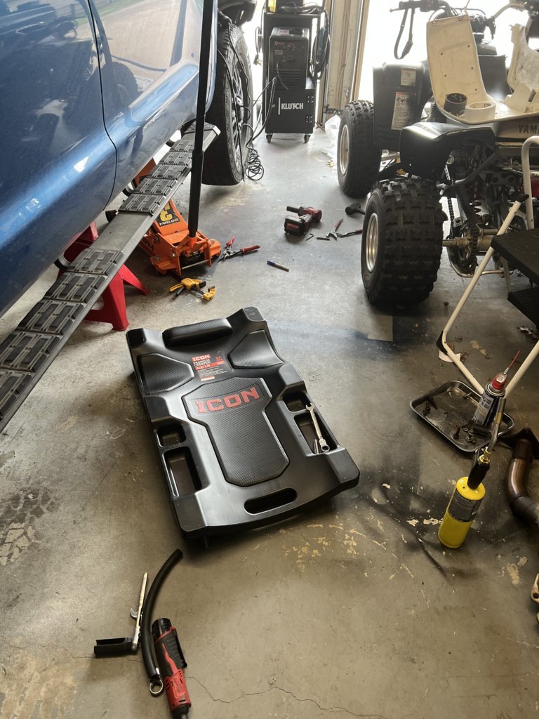

    It’s amazing the amount of tools you need in order to do one simple thing.

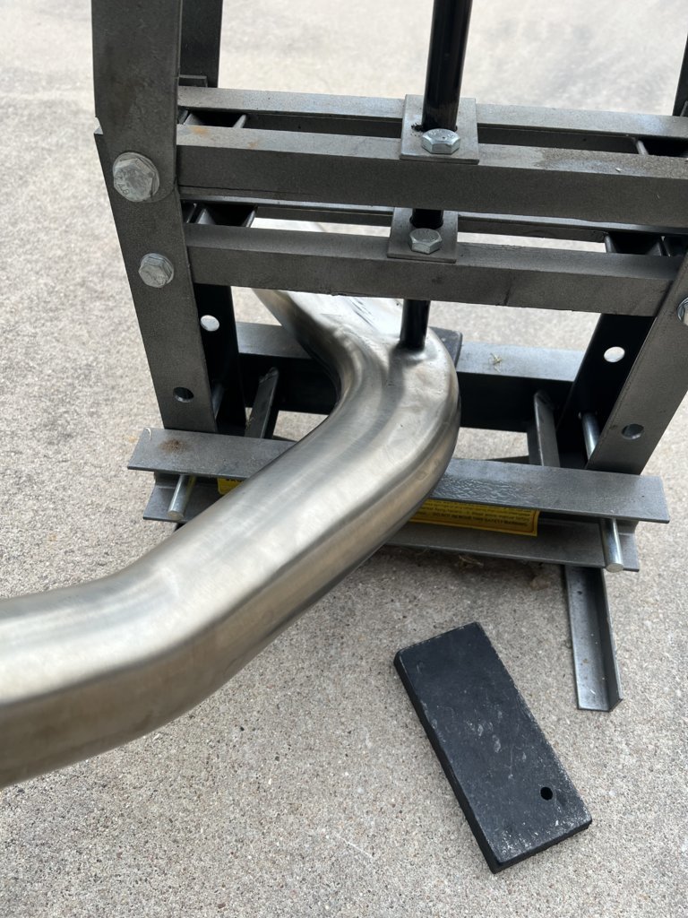

    Ya I had to. I’d lost 1/4-1/2 turn on my steering. I started small with just a hammer trying to dent it but it wasn’t making enough of a difference. That’s why I decided to pull it off and put the press on it and turn a 1hr project into a 5hr project.

    I got it red hot and pulled it with a ratchet strap and that got me 90% of the way. Then I cut the pipe on the inside of the 90* to get it the rest of the way but there must be some really tiny angle that’s still not quite right to get the flanges to line up perfectly. I loosened all the pipes and tried to mate them up but no go. Oh well.

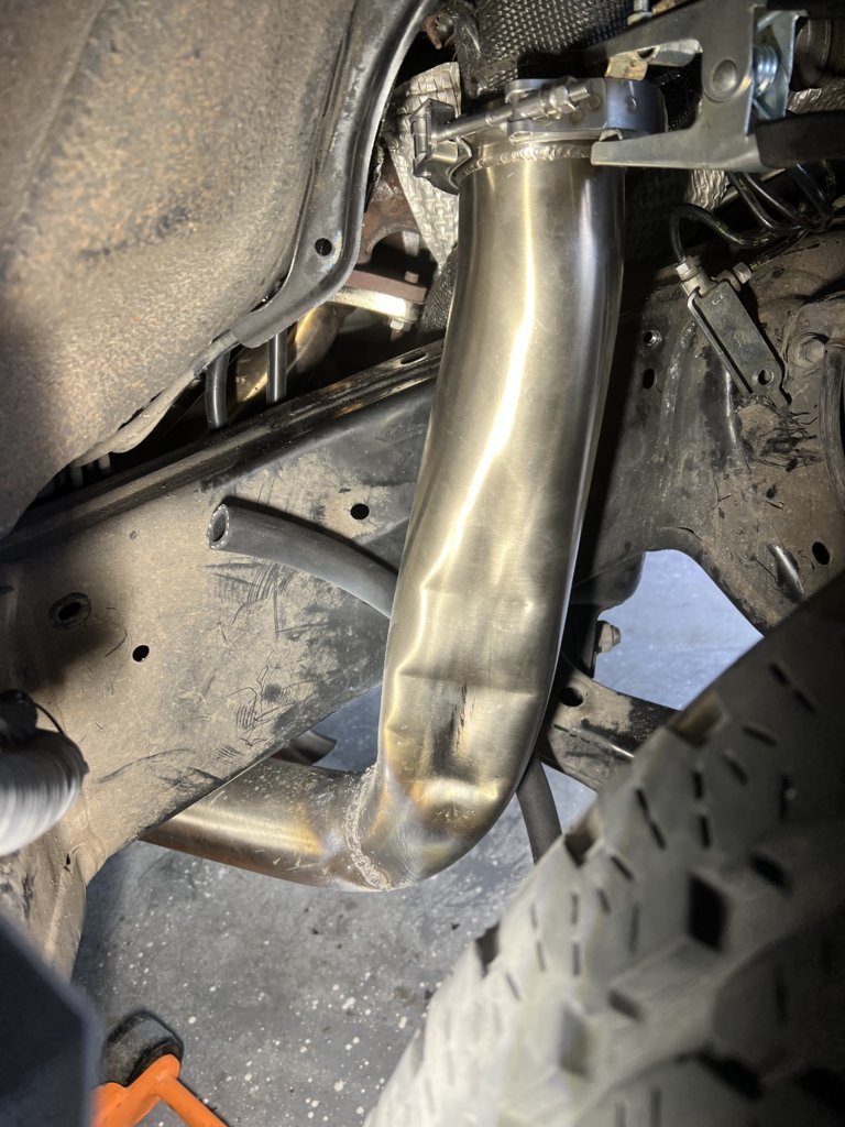

    Well the pipe doesn’t rattle on the frame but the tire still hits. I’ve got some 1” spacers coming from a member to help that problem.
    I remembered this weekend that Jesse said they had a bad storm and lost power to the shop from a tree which means he may not be able to make me a replacement pipe in time before I leave for my trip.
    So my thinking on this is to unbolt the downpipe from the turbo completely, get it bolted to the lower downpipe firmly, and then put a slice in the lower pipe about 3/4 of the way through, bolt the top down pipe back to the turbo, and then weld up the lower downpipe. With the slice in there I should be able to bend the pipe enough so that everything fits back right. Thoughts?

    @centex - depending on tire size and wheel offset, you may always have a little rub on that one side. Even with some clearancing and 1" spacers I still have the tiniest bit, but I have 90% of my wheel turn back before then, and it no longer binds up or feels like I've hit a steering stop.
    Hope that helps manage expectations.

    Tires are 275/65/20. Wheels are some aftermarket moto’s that I have zero clue on spacing or anything as they came with the truck.
    That’s easy enough to manage or grab a bigger set of spacers or a small dent in the pipe. My original issue is I’d lost a good amount of turn to the right. I get 1.25 turns and I rub the pipe. And it rubbed on a solid 6” of the pipe and that’s with the pipe all the way against the frame. So I had to really go to town to get this thing some clearance hence why I switched to the press instead of a socket and hammer and ended up where I did.
    Lesson learned, when I go to clearance the pipe, it stays on the truck.

    Replacement downpipe is on the way. The timing couldn't have worked out better, as we'll take that one back and fix it and put it on the 2016 TRD Pro. That way there isn't a charge for the replacement :)
    We will look into possibly adding an oval piece there in production or pre-clearance them moving forward. The trick is heat and a big socket or cast pipe. If you use a press, it can throw off the angle, as you are well aware of. Glad you were able to at least get it back on and running, so you weren't stranded tho!
