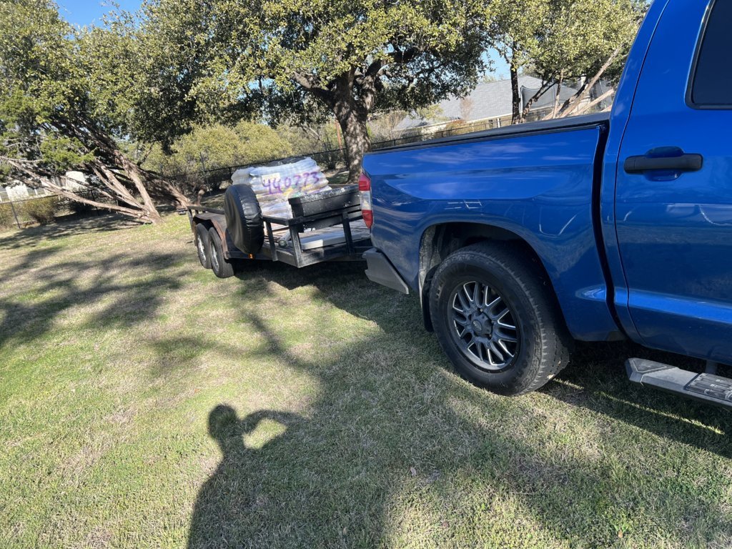

    4K pounds with ease. Didn’t even get into boost but you could feel it coming on accelerating through 4th around 50mph. I skipped honey do’s last weekend for truck work so I gotta finish this project before I can do more tuning.

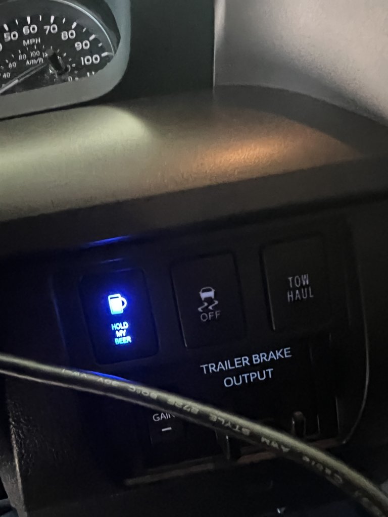

    Water meth switch is installed and functional. Prolink is installed and functional. Question. What is everyone setting their start and full psi at on the meth controller?
