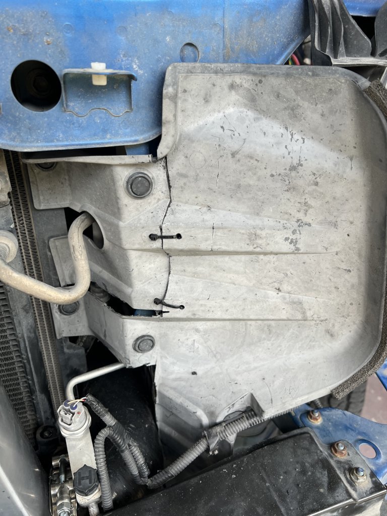

    PSA, make sure you turn the splash shields the right way before you trim them to fit.

    This was because you tried to fit the right side shield in the left side and therefore no trim required at all in both sides?

    Yes I honestly think the hard part is behind. There is still a bunch of work to do to get it finished but it’s definitely on the downhill slope. I’m so glad I broke this out over days and didn’t try to squeeze it all into a single weekend. I don’t recommend someone brand new to wrenching try this but it’s definitely doable by the average backyard mechanic. It’s not a bolt in but it’s not hard.

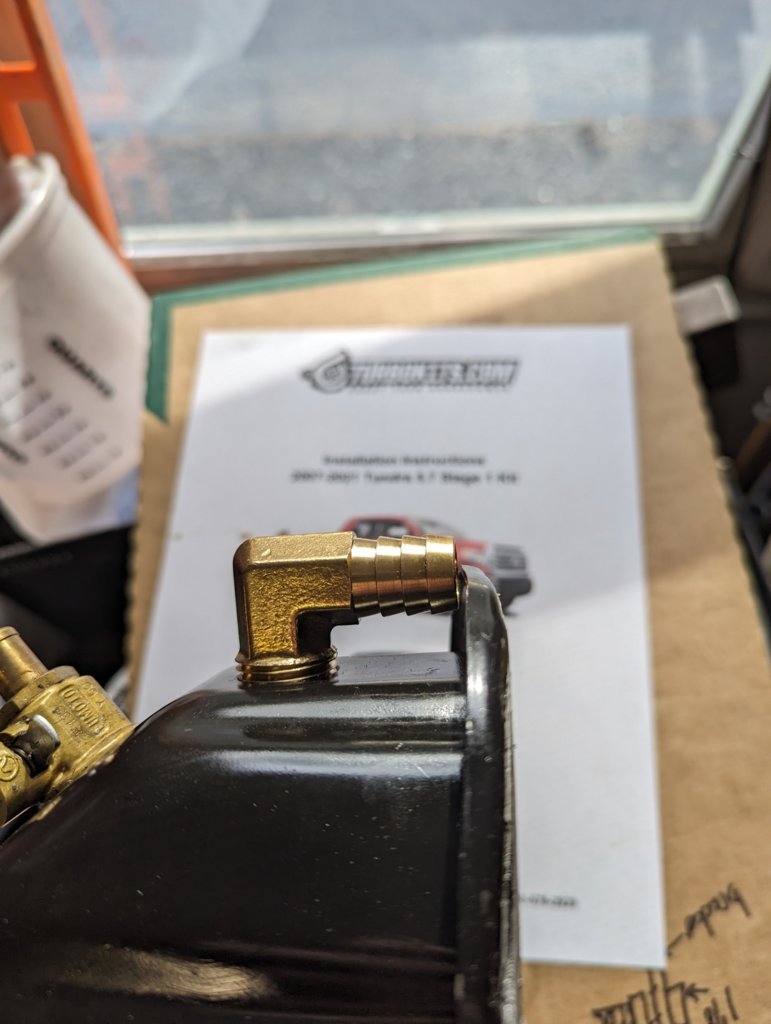

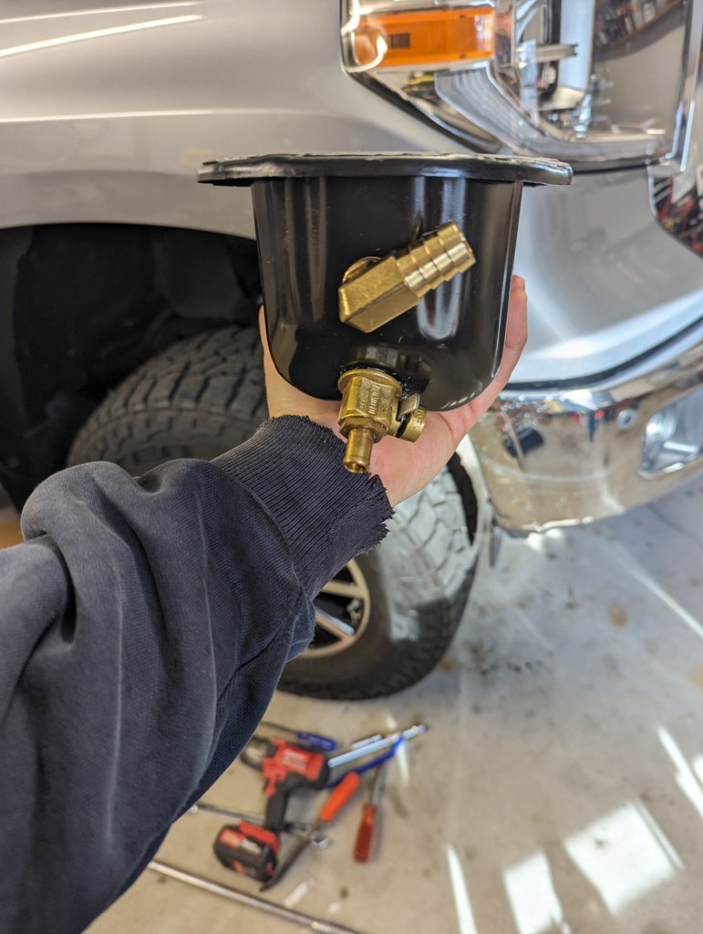

    How did yall do the oil drain? Drill and tap or just drill and start threading the fitting in?

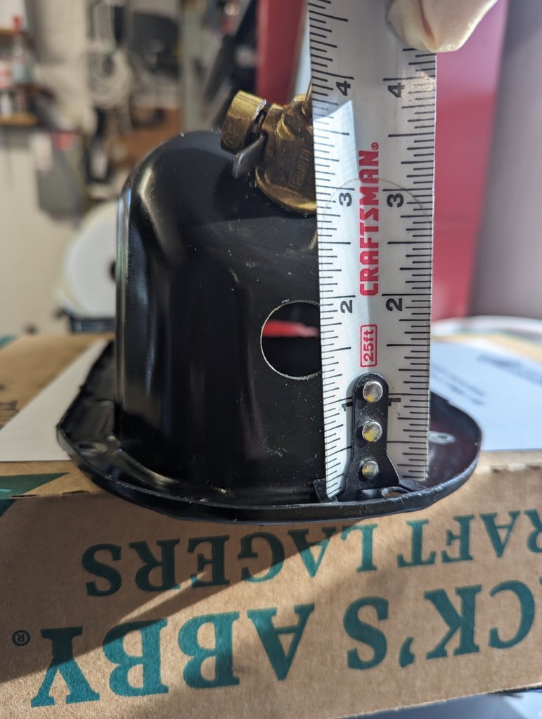

    The pan was thin enough to drill, test fit, then rtv sealant on reinstall, let cure.
    I tried to make it so I didn't have to clearance the oil pan flange but you need to in order for the return to stay above the oil level in the pan. Another option is to get a fitting welded on instead of threading it in so you don't have to clearance it.
    Needs to be higher than this:

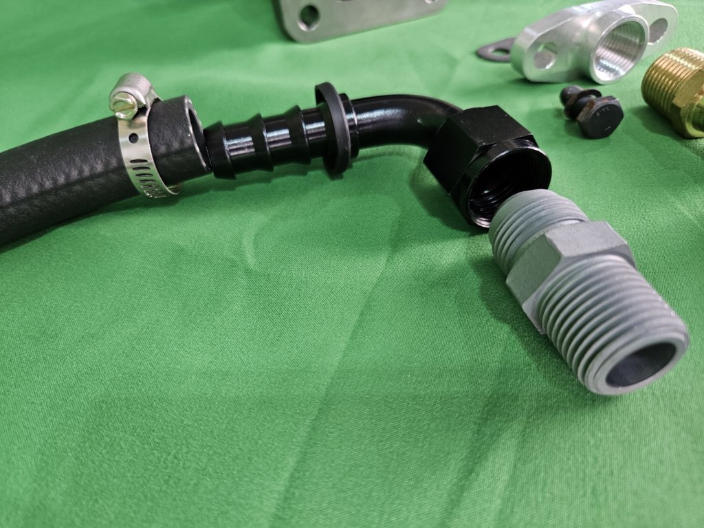

    If am not wrong I understand this is the new adapter for the oil pan. Maybe can be installed closer to the top of the oil pan. What came with your kit? @centex

    I’ve got that 90* and -10an to npt adapter with my kit.

    Oooh! That is so much easier. Not sure if the drill, test fit, sealant upon reinstall process is different or not.

    That is so much easier! I do appreciate the continuous improvement Jesse incorporates.

    The install should be the same I think, but definitely this new one is easier to handle because the position of the hose-end can be aligned/move independently.

    Yes. Sealing the pan only takes about 1/3 - 1/2 of the tube. You'll have plenty left for the threads.
    Def dry fit first to make sure you won't have any issues, and def needs the hole to be higher than my photo with the tape measure. Envious of that new setup you guys have. That'll work really well

    In regards to the oil drain, yes, we switched fittings to allow for an easier and higher up install of the oil pan / drain fitting and line.

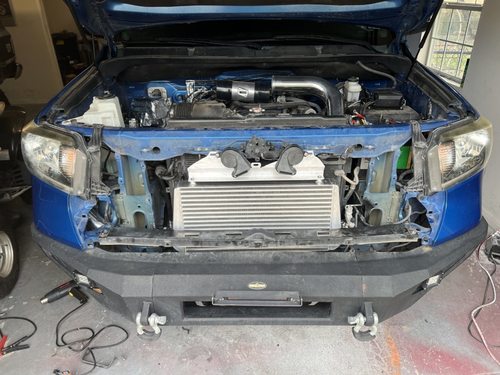

    I think the worst was the lower intercooler bracket. Glad I bolted it in before doing the intercooler because it would have been impossible otherwise. Although I did donate my 12mm flex head wrench to the truck as it got stuck tightening the last bolt on that thing.

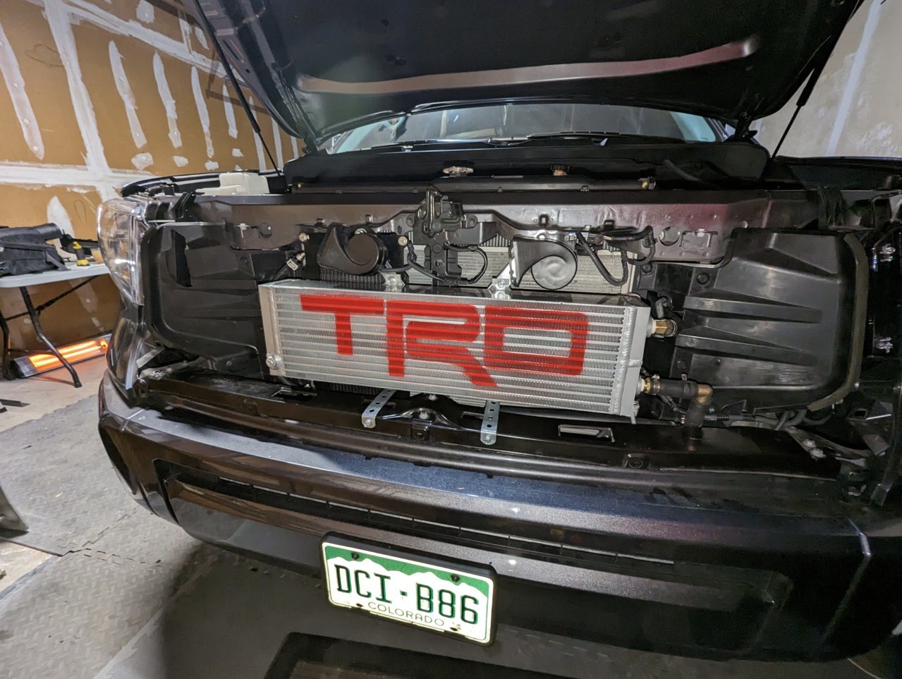

    Just PAID for and got our NOMAD Valve Body upgrade on the way for the 2016 TRD Pro project. Our plan is to get the kit on, Stage 1, Inj, Stage 2, More boost, etc. Just like we did on the 2014. This way, we have stock -vs- Stage 1, -vs- Stage 1 w- Injectors -vs- Stage 2 at 7ish PSI. We will run some dragy's as well at each step. Then, we will install the valve body and see if any of the numbers change :)
    Then we will really start pushing the limits of the kit, truck, engine, etc. See if we can break 600WHP, then shoot for 700WHP, see what this 140K motor / trans can handle. As we said, were not LOOKING to blow anything up, but this new project truck is the one we want to start pushing the limits on!!
