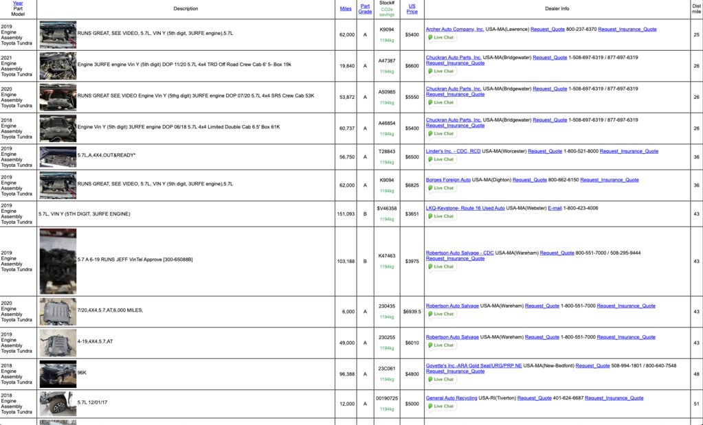

  24. Jan 17, 2025 at 6:33 PM
    #1524
    bflooks
    bflooks [OP] New Member
    May 9, 2020
    #46273
    2,058
    Metrowest MA
    There are few up here locally between 25k and 130k miles for $5k-8.4k. labor costs are the same regardless of what I put in, so I need to take the weekend and decide if the XAT is worth the extra money. I'm leaning towards yes because even if for no other reason that they have been rebuilt. Not a knock on a stock engine. It was my original plan. But here I am at an unplanned fork in the road. Stock would be faster, in theory.
    Oh! And I have been following your motor "opportunities" and I don't envy you at all. It'll all be worth it in the end, right?
    e30cabrio[QUOTED] likes this.

  26. Jan 17, 2025 at 7:17 PM
    #1526
    bflooks
    May 9, 2020
    #46273
    2,058
    Metrowest MA
    That is the list I'm shopping off of. :) One showed compression at 200 on all cylinders, which I might be inclined to buy and ship to XAT as a core, but IDK. Decisions, decisions. If labor was cheaper I'd 100% roll the dice on transplanting one of these.
    e30cabrio and Mdl like this.
