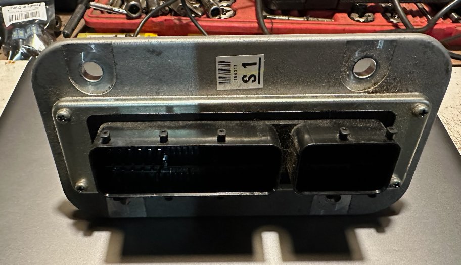

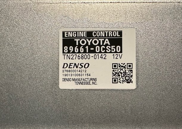

    Out and ready to be resuscitated! Also found an exact match in Wisconsin for $150 if we need!
    Brian, for your records, its a different part# than what the VIN coded to when talking with the dealer.

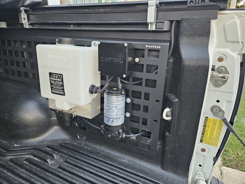

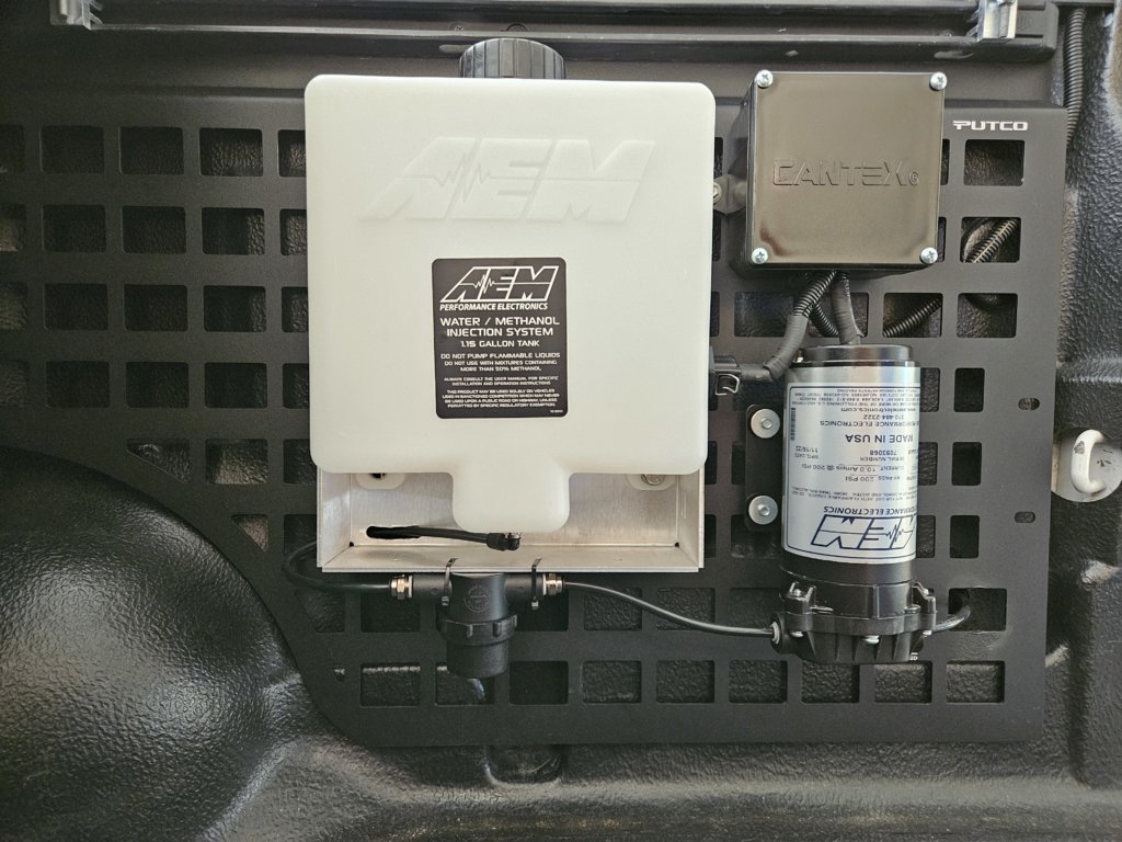

    This is how it looks after adding a junction box in the bed molle panel. :hearteyes:

    That looks clean... Nice work!
