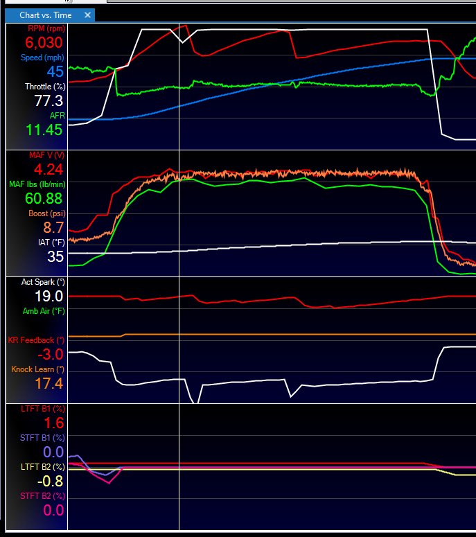

    @24% DC... :)

    The 9 PSI run was technically at 28% SCG1 Boost control duty cycle... But still a huge difference from the lighter spring.

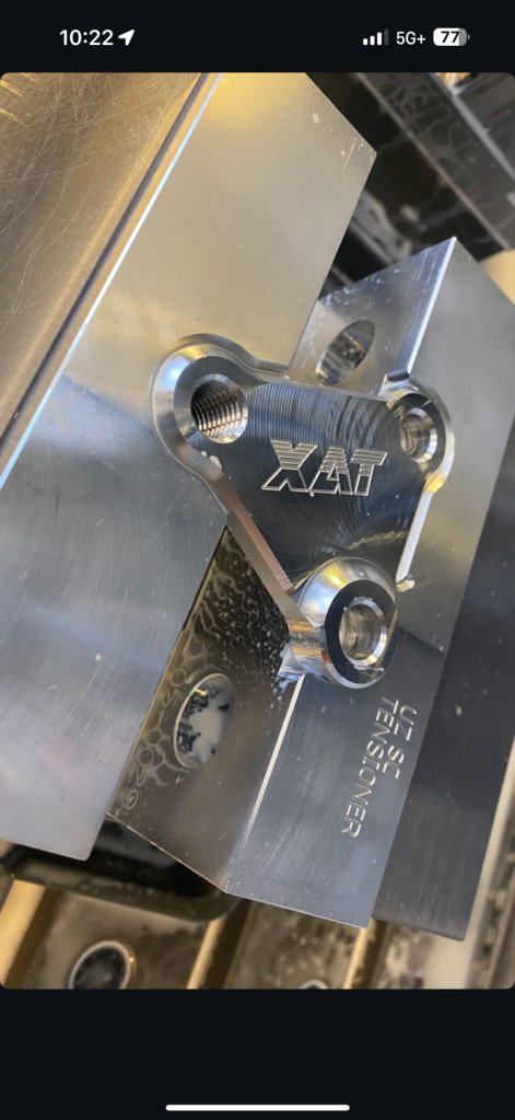

    The jig says UZ SC Tensioner, I wonder if it's engine-specific or if the engine family shares the same mounting holes? Cool stuff, always love seeing someone bring another product to market for our trucks.

    I messaged them they may have a billet tensioner in the works for us.

    Says UZ SC Tensioner. Hoping that's 2UZ-FE. That thing looks pretty!

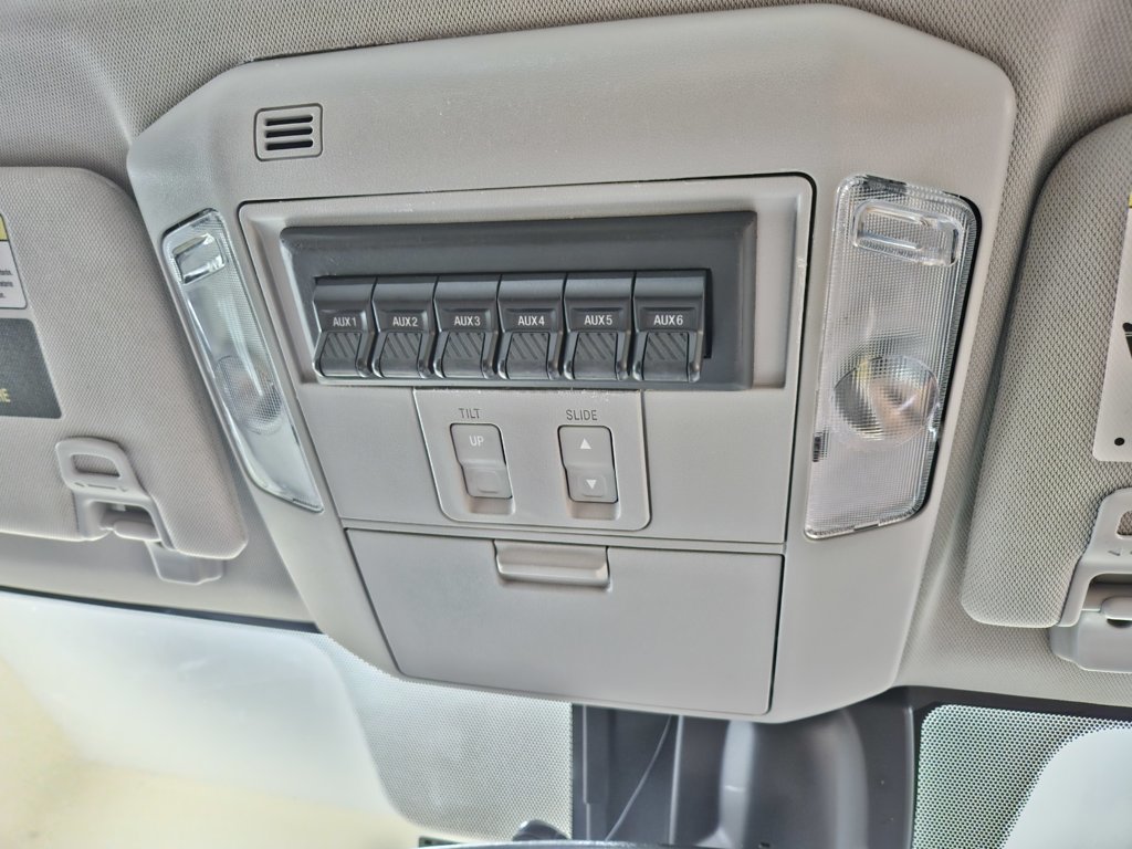

    • Model and 3D printed a frame for the upfitter switches

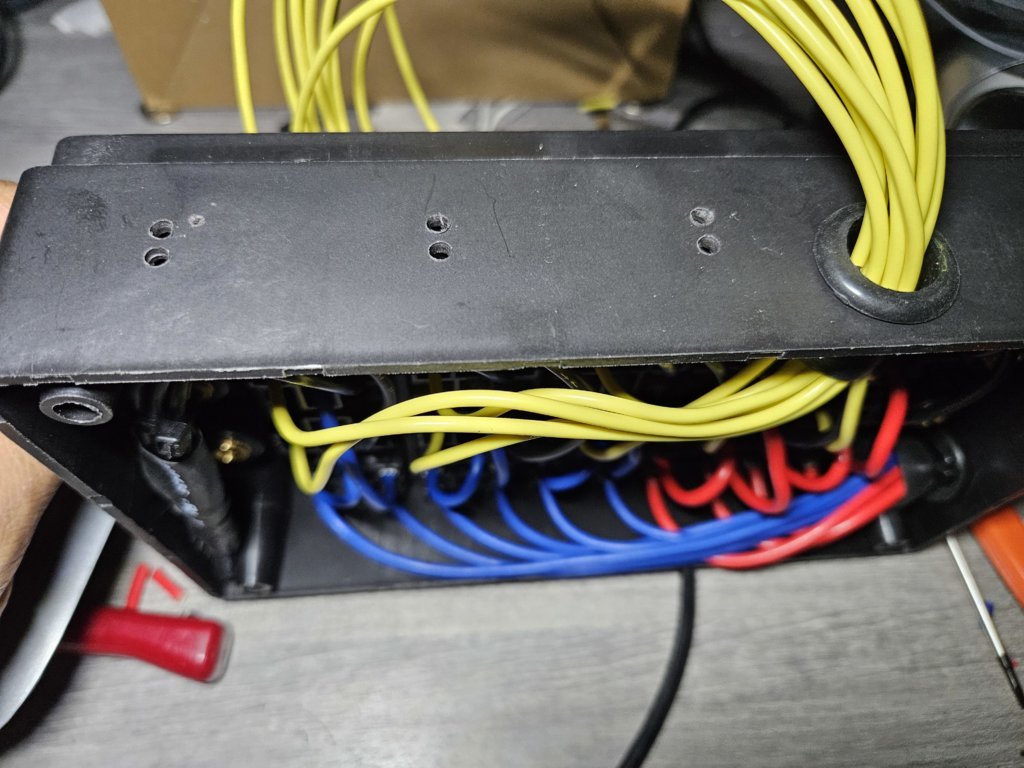

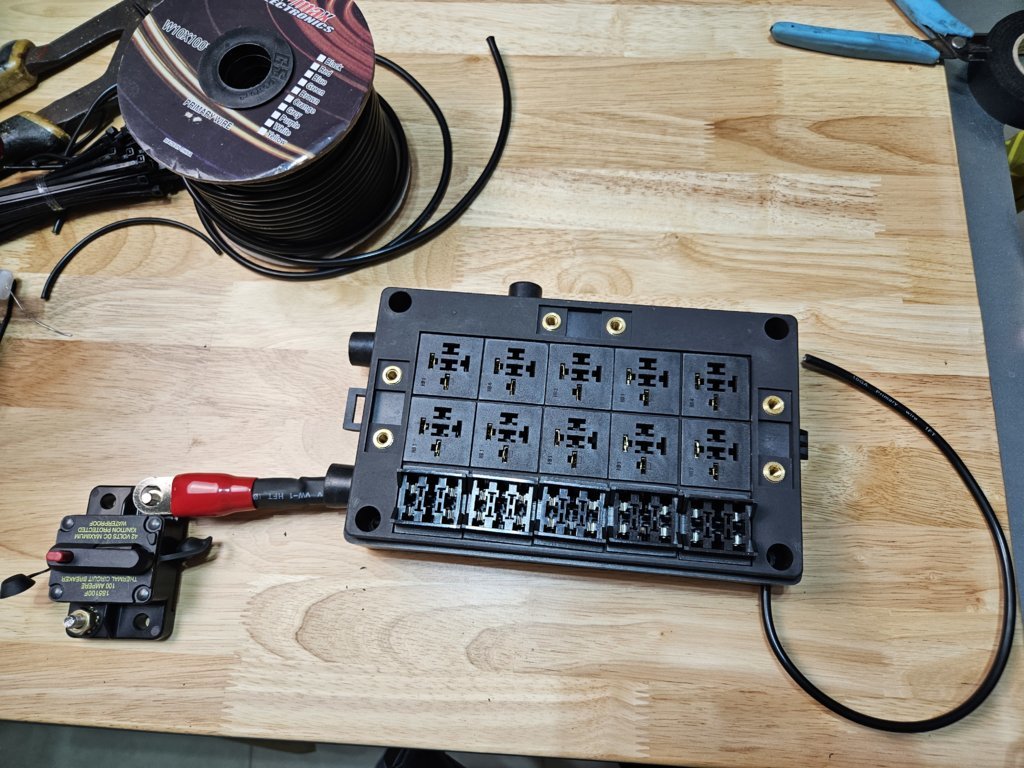

    • Wire relay/fuse box
    • Purchased the exhaust cutouts
    Upfitter switch with 3d printed frame
    New relay/fuse box
