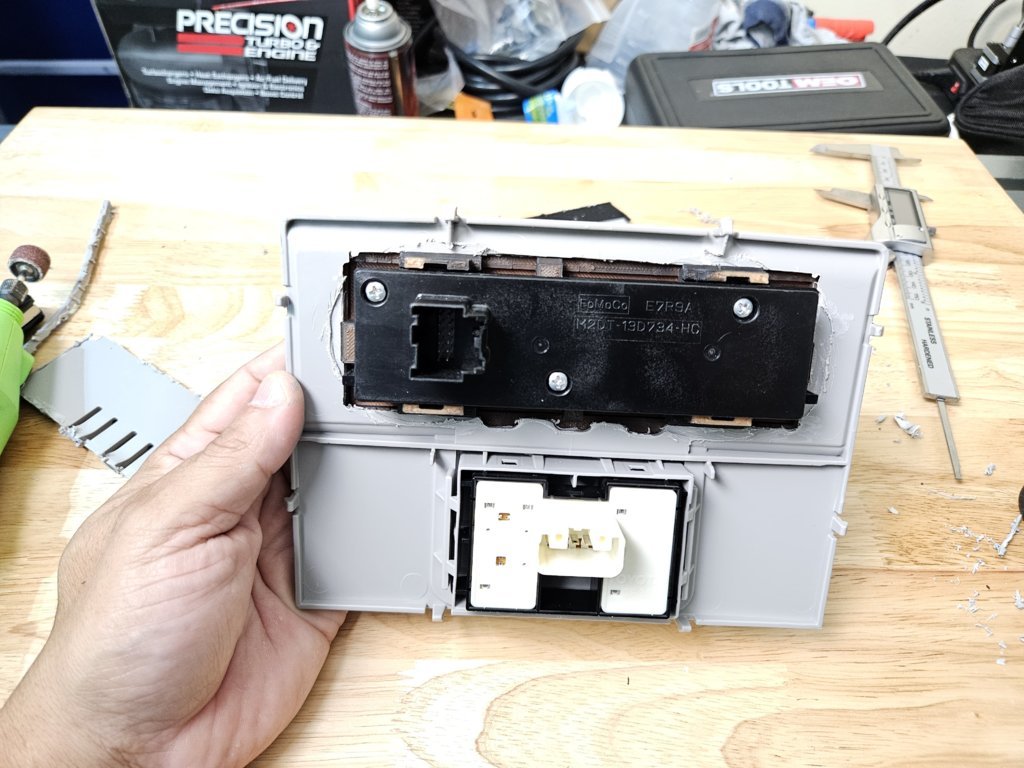

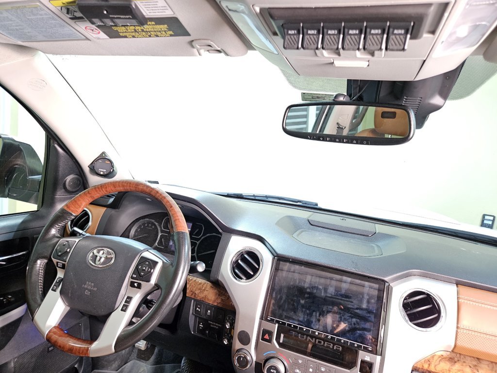

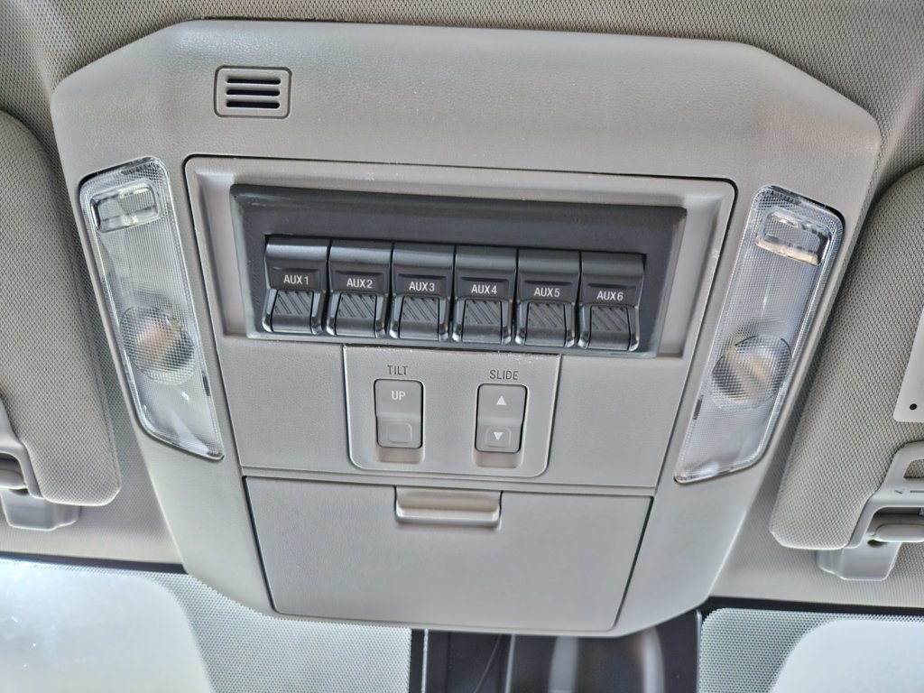

    Added these switches to control any turbo related stuff. I like it a lot and looks perfect for this! This will control a relay box. So far the water/meth. and SCG-1 boost controllers will be connected to these relay-switches. The idea is to use the acc. power to activate the relays if the switch is in ON position. The intention is that all systems will be turned ON by default when the truck is ON but if for any reason a have to deactivate any of them, it will be just matter to turn off the desired system using the assigned switch. Also, I want to add a set of exhaust cutout valves that can be controlled using one of these switches too :goingcrazy:. First, I need to confirm with @TurboKits if these cutout vales can be used with the turbo kit installed. Just for fun and make some noise :bikewhoops:.
    The switch is the upfitter switch that comes with some Ford trucks.

    Yes, absolutely, cut out valves will not interfere with the turbo function at all. The additional flow may actually give you a .5 PSI bump in boost. Just make sure they are after all the turbo piping and sensors.
    That looks awesome!! Maybe a 30 shot of NOS on one of them :mudding:

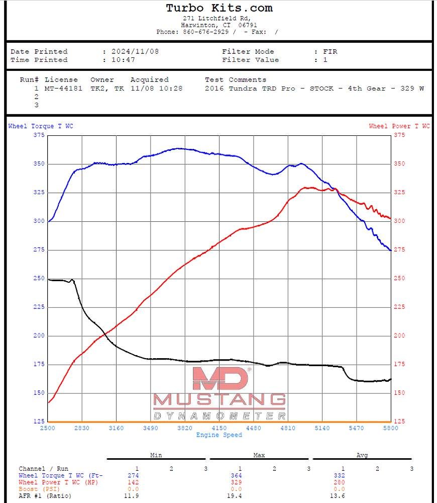

    Was on the DYNO all morning doing some baseline stuff with the 2016 TRD Pro, it's now moving into the "pre-surgery" stage and will have the turbo installed soon. I also did a bunch of Draggy runs along with the DYNO runs all in 100% stock form to have a super accurate starting point on this build. We will then install the stage 1 kit, stock pump, stock inj, get a DYNO, get Draggy, then install injectors and pump on Stage 1, get DYNO, get Draggy, then install Stage 2, get DYNO, get Draggy... SO stay tuned, lots more data on the way...

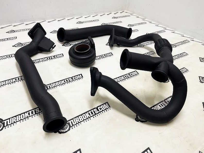

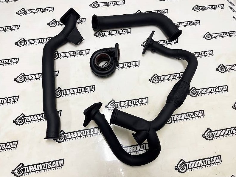

    In regards to Brians truck. We got it 100% finished with the coated piping, re-wrapped heat wrap, injectors and pump late Wednesday. Got about 100 miles of logging and testing on it so far and am working on map revisions to take it up to the 7/8 PSI level. I suspect this will happen pretty quickly due to how much data we have and have had on his truck, the Stage 1 and Stage 1.5 tunes were absolutely dialed, so a quick inj constant scaling is all it took, and the truck seems to be doing exactly what we want. As long as no major variables pop up as we turn up the boost. We suspect the tune side will flow pretty quick and easy. Then back on the DYNO for some final results and then Brian can have it back for some fun and Draggy for you all!
    Thanks as always for the questions, feedback and genuine interest in what we have been doing!

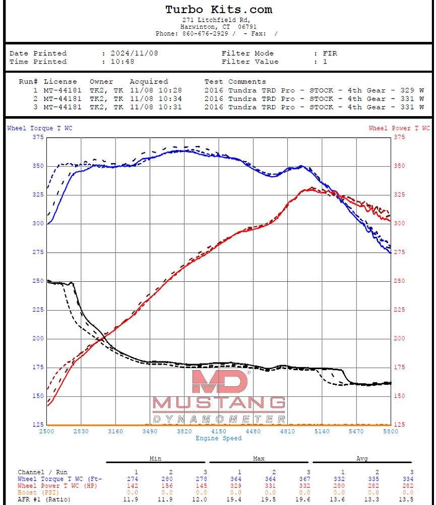

    We know, we know, not really that exciting, but we wanted to get as much data in the stock form before we added the turbo kit to our 2016 TRD Pro shop mule. This is bone stock, TRD Pro exhaust, 138K miles. We also did some Dragy runs. Here are the details and videos
    Stock DYNO came in 329 WHP / 364 WTQ, which is almost exactly where the 2021 SR5 came in with the TRD Pro Exhaust & Intake Installed. So we were glad to see the consistency.
    DYNO Video:
    https://youtu.be/DSRqqubqsno?si=oTwjHruScHTY3CT1
    A little 2nd - 4th Fun: *not sure what it proves, but it sounded great and was fun to do! LOL
    https://youtu.be/N4noMFc42NE?si=rk1DOaWHlZvZK7dg
    DYNO Chart #1:
    DYNO Chart to show consistency:

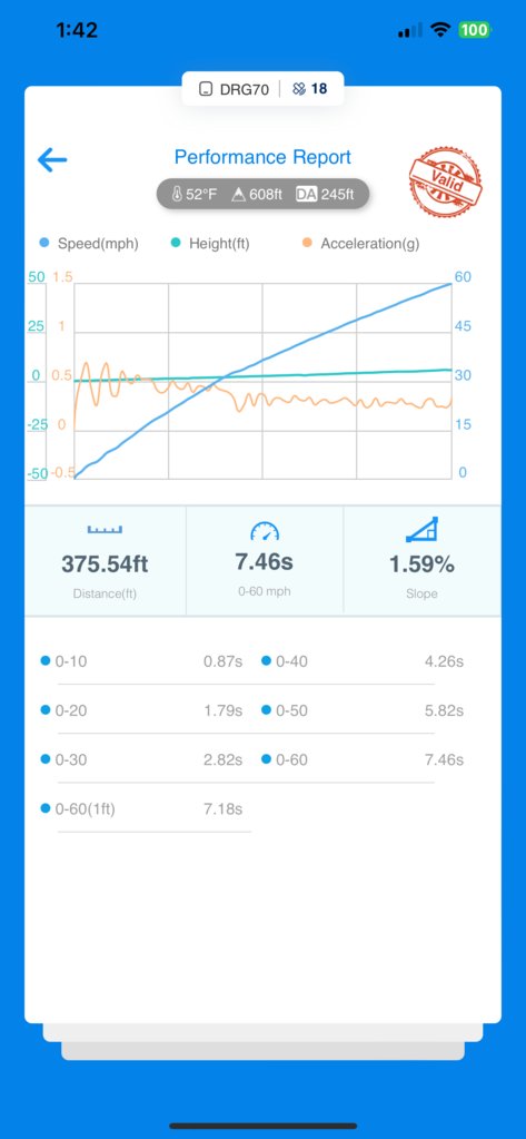

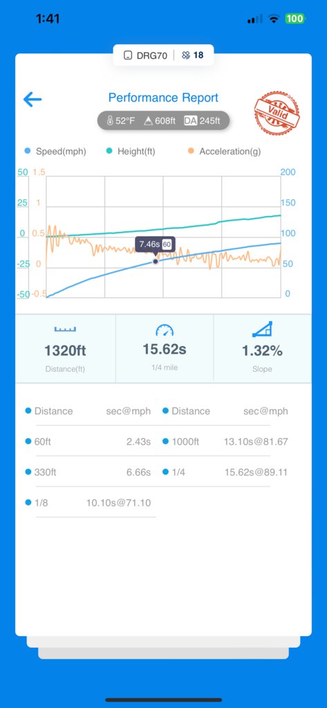

    Dragy Times were fine, wasn't really sure what to expect, but had about 4 of them all within a small % difference
    0-60 MPH
    = 7.46s
    1/4 Mile = 15.62s @ 89.11 MPH
    Dragy Video:
    https://youtu.be/eCdK23DbOZg?si=Pgjk7eni1xIX0uNA

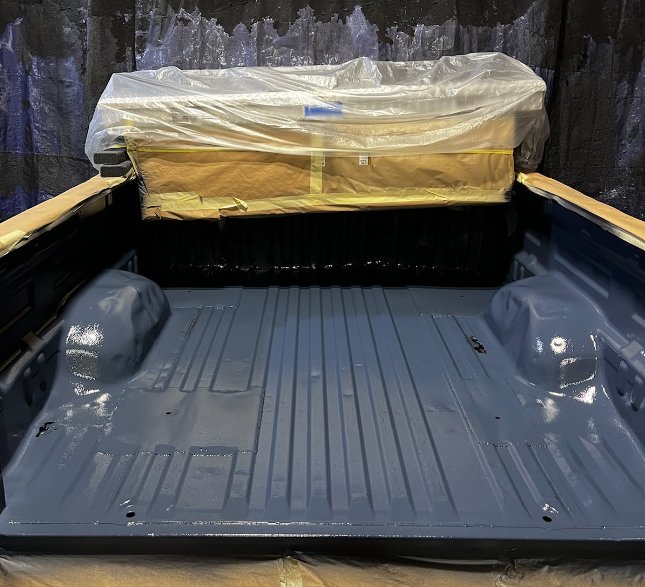

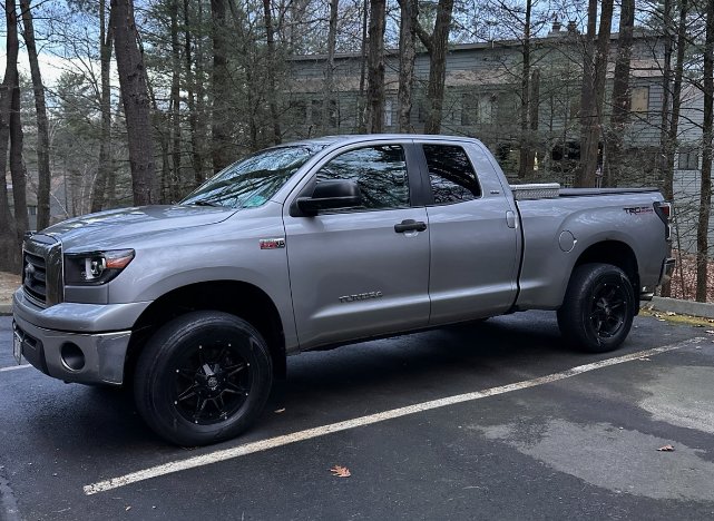

    We had someone chomping at the bit to buy our 2014, it was right after we found the 2016 TRD Pro, so we went from Final DYNO #s Fri, to quick tow to New Hampshire Sat, to delivering the truck on Sunday. All while the 2016 TRO Pro getting in, registered and build planned. We also had someone want to buy our 2008 test mule, so that was delivered a few weeks after.
    Here is the 2014, all polished up in its new home. He in the midst of adding a custom interior!
    The 2008 just had the bed repaired and a full detail and is looking sweet too.
