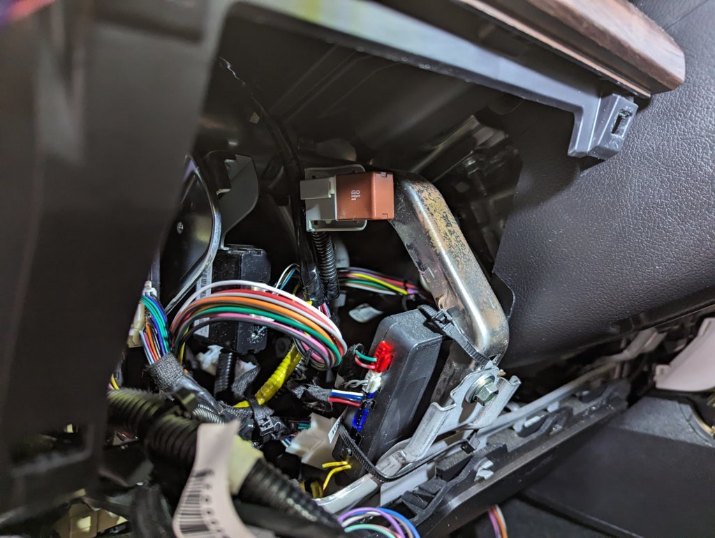

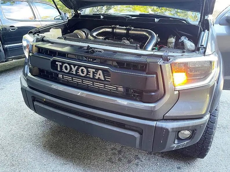

    For the gauge map sensor I am considering to install it close to the vaccum hose near the interior fuse box. I am curious about in what spot you @bflooks / @TurboKits installed it?
  2. Sep 21, 2024 at 7:27 AM
    #1292
    bflooks
    bflooks [OP] New Member
    May 9, 2020
    #46273
    2,058
    Metrowest MA
    @Jego let me dig up some photos. I essentially zip tied it to the dash frame to the left of the steering column. What I didn't realize at the time of initial install was the emphasis by Innovate in the install instructions talking about how it must be mounted entirely vertically. It led me to question if that is what could have contributed to the glitch I was having with it not reading above 0.0psi and I ended up remounting it as a result of the research and troubleshooting.
    EDIT FOR PHOTO: Found a better photo from the spring during my install. I moved the sensor to directly below the relay in this photo. It fit in that space, so the print faces the driver's door and uses the relay and the to support the top left of the sensor, with the zip the less than perfect part of the frame, above the remote start module (red/white/blue connectors).

    Nice! Thanks!

    It's easy enough to access for troubleshooting, but it's also up high and away from the rest of the mess that comes with 2 additional systems in that general area. Anyplace wilm work, though, just be mindful of that vertical requirement.

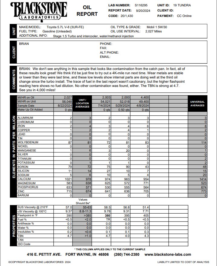

    Just got the last of my 2k mile OCI Blackstone reports back, and the first running 5w-30 vs 0w. I'm over halfway to the 4k mile OCI I'm working on now, and the goal is to return to the 5k mile OCIs I have always run since it was purchased new in 2019. The numbers don't lie, and the first test (4/8/2024 results) was with 0w-20 on the stock/NA engine. I have zero complaints.
    I took this sample from the oil drain pan, not directly from the oil pan on the truck (my fault), so I was concerned everything was going to be skewed. This is also the same oil that I had the oil cap come off (my fault) on my first trip to Maine. In total, this sample has about 12 hours of towing on it and the rest of the miles are daily driver miles.

    We also installed under the dash, since you are running a vacuum/boost signal in there for the AEM controller, just split it and keep it clean and out of the engine bay.

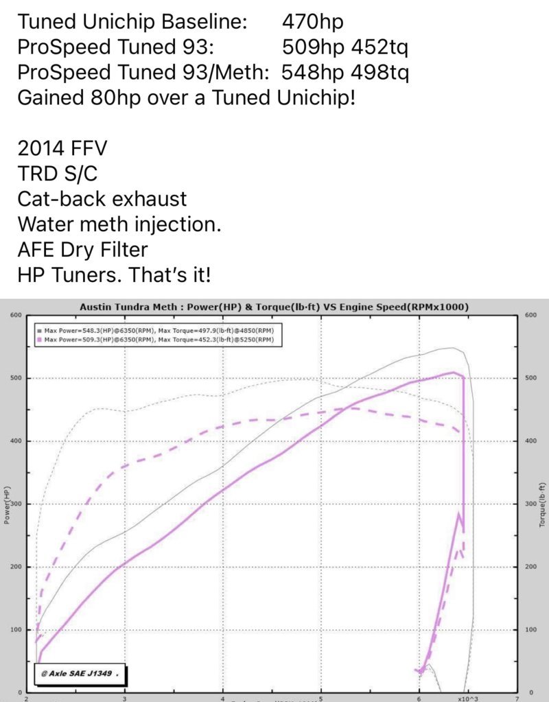

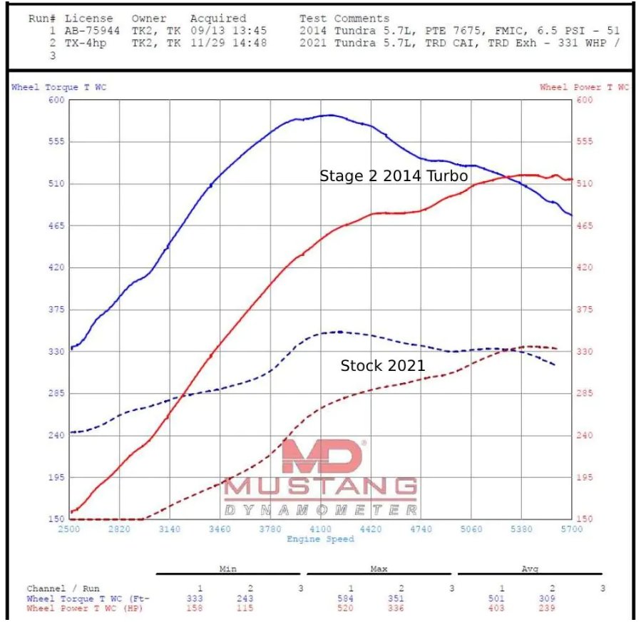

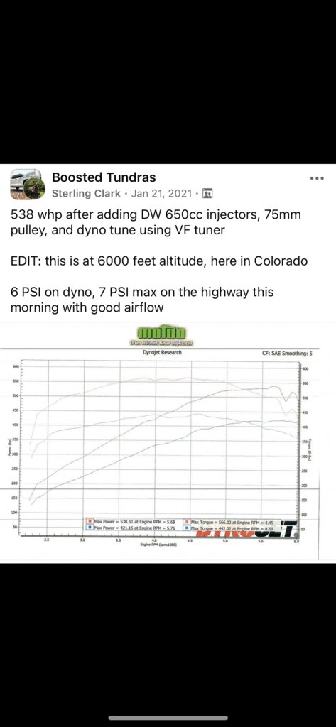

    Where are the SC DYNOs making those #s at 6.5-7PSI?

    Comparing dynos for peak numbers is kinda dumb, but here is some anyway! Not that any of this matters of course as it’s already been determined that these motors stock can reliably handle maybe 650-700 crank hp max anyway and this can be achieved by both setups. On the right applications (not a stock tundra engine) the 7675 turbo is good for 1,000-1,200hp, the TVS2650 SC is good for 1,000-1,200hp. The trans would never hold that power either unless you do one of Prospeeds built 4L80 swaps with motec and very few people are investing that much coin. In a nutshell, pick your preferred feel for power delivery and sounds that it makes and have some fun!
    Below is a stock TRD pulley setup which was 6ish psi.

    SAE J1349 is from my understanding Motor/Crank HP. Which would be in line with what the TRD blower can flow. Nice gains from the factory set up to inj and tune as well. I don't think these are wheel HP #s tho.
    As we build our new TRD Pro project. I will make sure when we are on the DYNO we do more styles of runs. Our focus for the stage 2 release DYNO, was repeatability and consistency. We would start the DYNO monitoring at 2500 RPMs and roll into it until about 2K in 4th, listen for the TC lock and then roll to full throttle, so we were 100% TPS by the 2500 RPM start of the run. I am sure if we played with start times and got more "stabby" with the throttle, we could see torque and boost come on a bit lower.
    Either way, ANYONE who has an SC, understands the absolute pleasure you get driving a Tundra with 500+ HP. Regardless if it's making the venerable SC whine or the jet fighter sound of a Turbo. Just knowing that when the noise starts, so follows the power, is enough to enjoy driving a boosted tundra for 100s of 1000s of miles! Heck, I play with the throttle for no reason when I am driving, just to hear the turbo whistle up and the BOV vent off. LOL
    Thanks for the input.
