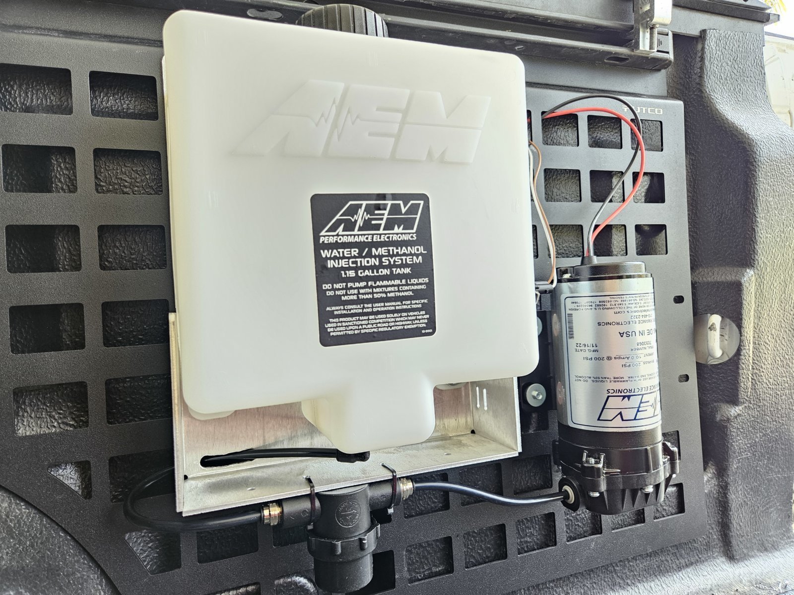

    Some progress with the installation of the AEM kit. I spent some time figuring out where to install the pump. I ended up installing it on the molle panel next to the tank. Also, made some modifications to the base of the tank to accommodate the hose connection to the added in-line filter. The tank was relocated for better clearance and fitment of the filter and pump.
    Disappointed with the in-line filter. It broke when tightening the hose connector. Next time I am not going to tie it to the end, let's see. The new one is on the way. Should be here during the week.
    I bought grommets to protect the cables and hose that run through the bed of the truck. Additionally, I bought connectors for the pump connection.

    I like how clean that Molley panel lets you install things, and I absolutely love the idea of having all the components protected in the bed instead of the pump on the frame rail. I'll be curious as to how loud it is mounted back there since these beds act a bit like drums. Also, try a bit less force on the fittings next time. That side of the pump isn't exactly high pressure. Perhaps an easier way to handle things is to have a filter at the fill cap instead of south of the reservoir. I'm looking into this type of option: https://www.amazon.com/dp/B07P82JMJ...automotive&sp_csd=d2lkZ2V0TmFtZT1zcF9kZXRhaWw
    Jego likes this.

    Agree, the molley panel is ideal for this setup. That was the main reason of installing the pump in the molley. Also, is nice to have everything in the same place for maintenance, inspection, repairs.... The filter at the fill cap is a great idea. I will test it this week using the manual activation, let's see how loud it will be.
    Quick update today I installed the wires for the level sensor and pump.
    I found a spot to run the 4 wires without making a hole in the bed of the truck. There is a small open area behind the tail light in the upper section. See pictures below.
