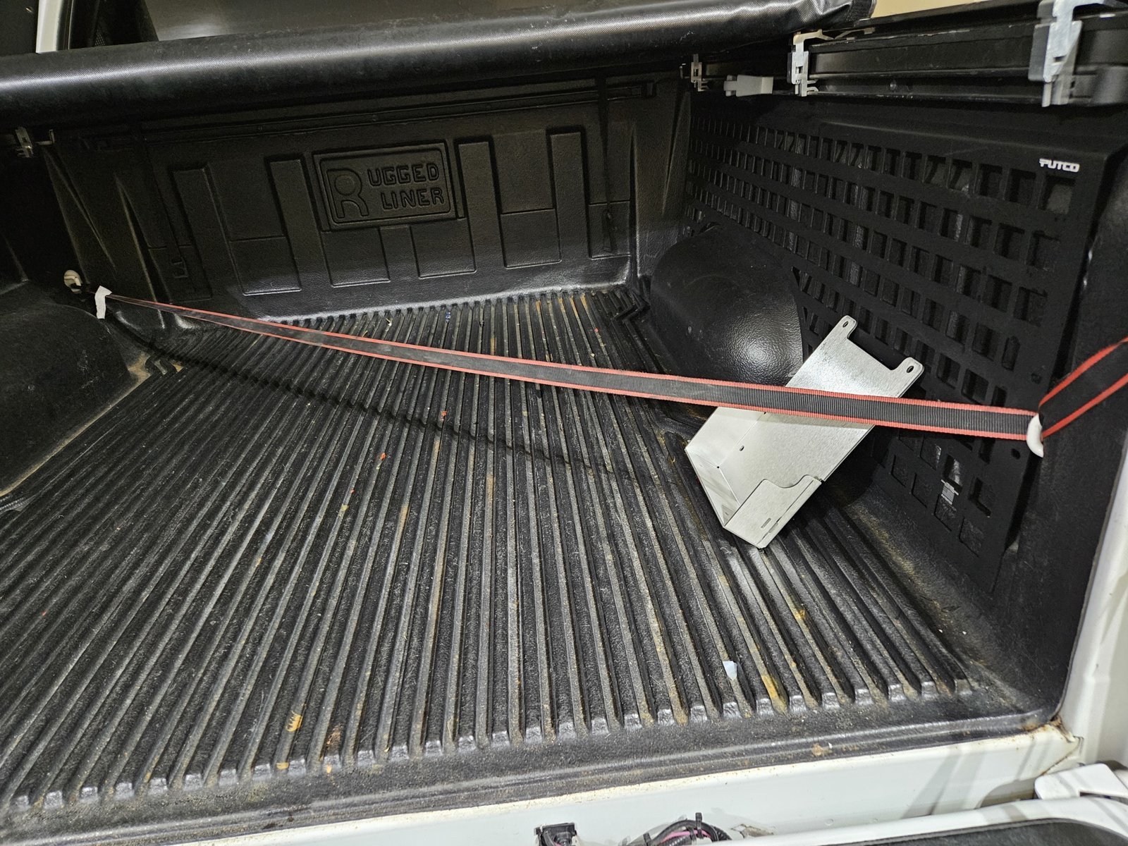

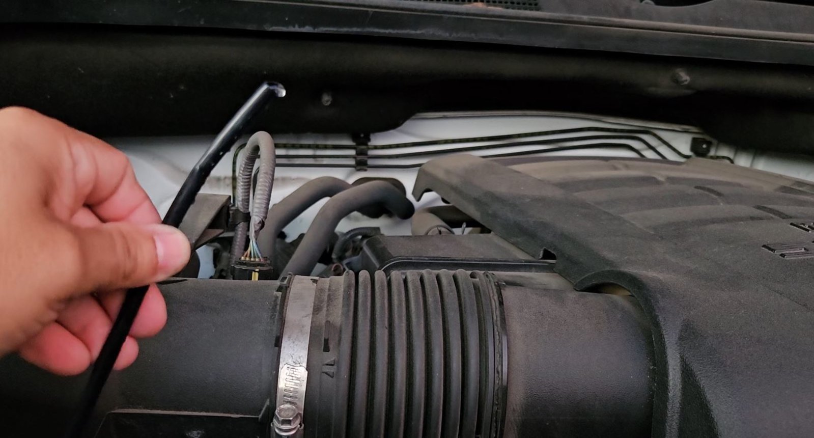

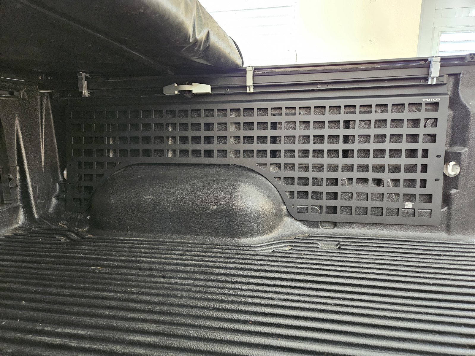

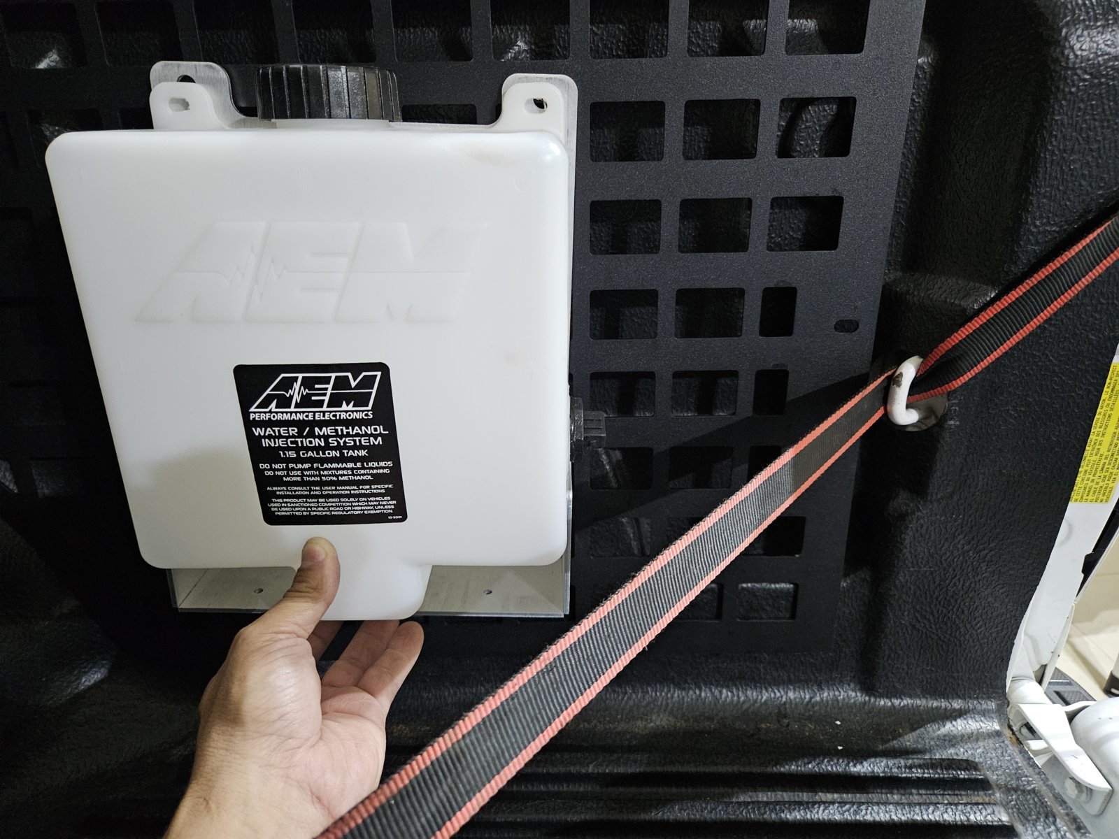

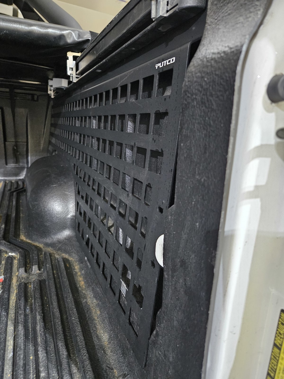

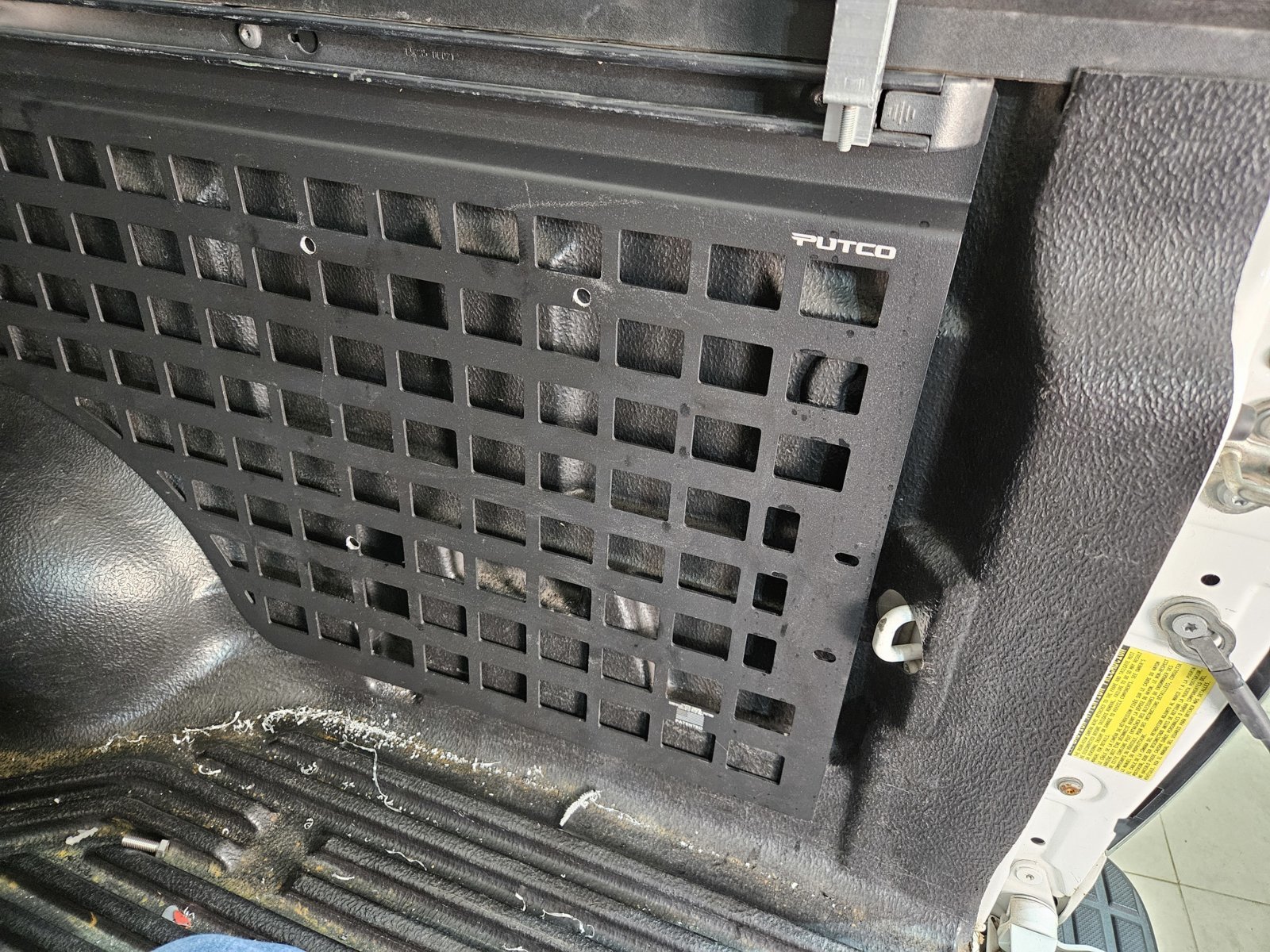

    Quick update on the water/meth tank install. Ordered the driver side molle panel but received the passenger side. I decided to keep it and go ahead with the install in the passenger side. Looks good but not 100% compatible with my bed liner in the bottom side. I am ok with it, not a big deal.
    The tank holes are not compatible with the molle panel mounting plates. I expected that since the beginning so made 2 more holes to the base in the bottom section and 3 holes to the molle panel. Also, verified the spacing for future strap usage in order to avoid contact with the tank.
    Only 3 holes matched the molle panel area and the base.

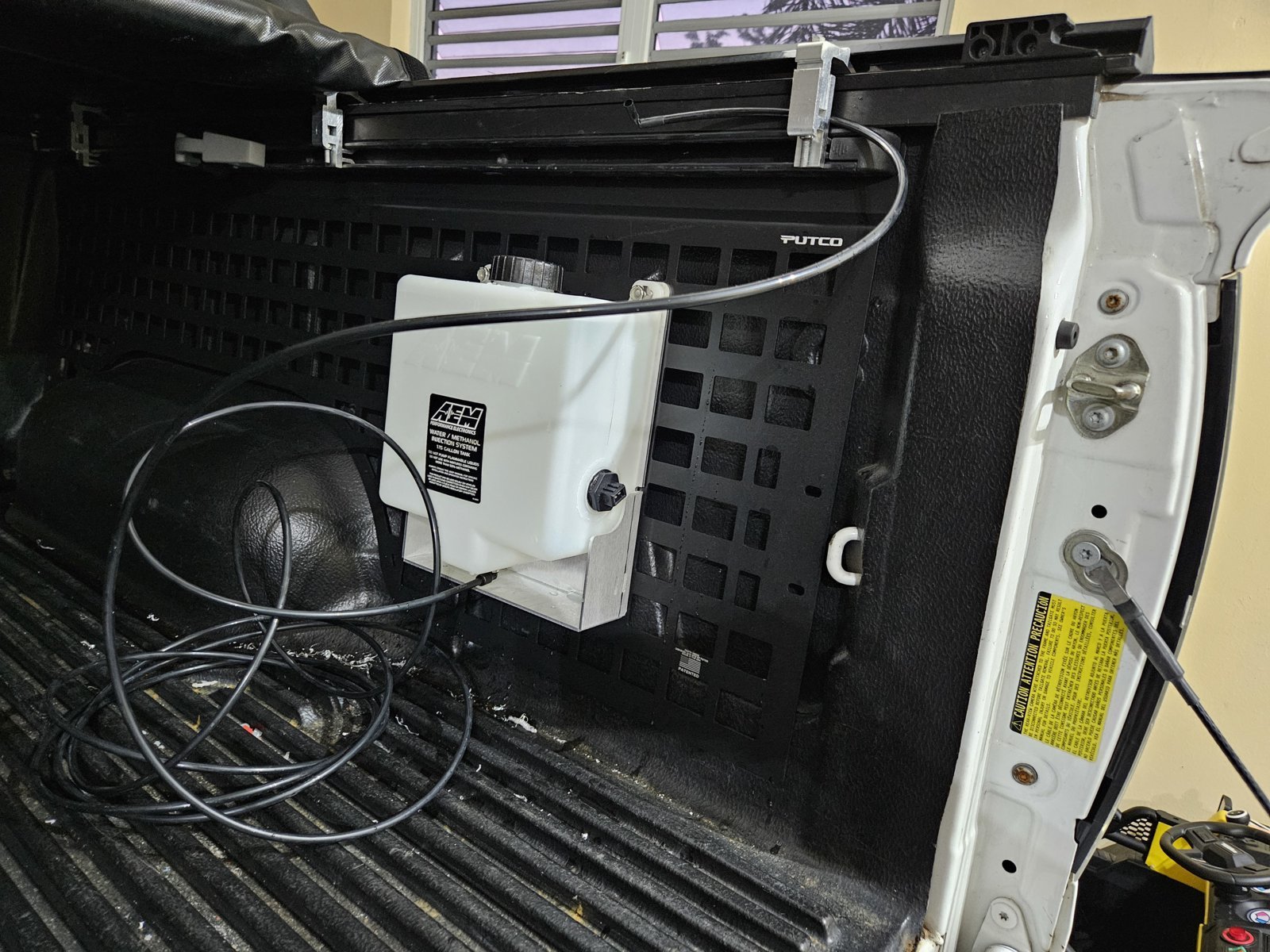

    Added the fourth bolt to the base.
    Connected the hose and added water to the top to test the water level in the front, near the air intake where the nozzle will be installed on stage 1.
    Observed that water goes out of the hose up to 4 in. approx. above the intake. That means the water level is over the nozzle. I still have some space to relocate the tank and install it few inches down of the actual level but looks like that wont be safe because it will be too close to the nozzle level.
    Video capture:
    What I am planning:
    Option 1: Keep the tank in the bed. Relocate as low as possible and add a solenoid to close the line when is not active. The solenoid will open the hose at the same time the pump is activated.
    Solenoid from AEM: https://www.aemelectronics.com/prod..._methanol_injection_accessories/parts/30-3326
    Not a 100% convinced to go this route without another failsafe option in case the solenoid fail and keeps open.
    Option 2: Remove tank from bed (Spent some time looking for other places but still looking for ideas. Also the pump must be installed below the lower tank level)

    @Jego - what is the issue, exactly? Are you saying you have siphoning due to rake/install location?
    The solenoid is the only solution I'm aware of specifically made for this issue. It is something @TurboKits.com and I discussed for my install, but we haven't really pursued that yet since my startup issues have been resolved. Jesse did add an inline check valve just before the nozzle, so maybe that's why I don't have the issue. I can pull the line from the nozzle in the engine bay and it won't siphon at all. It's a simple barrel check valve.

    I did a quick test to make sure the tank level is below the nozzle, but it is not happening right now due to the tank location. That will cause the tank to drain by gravity if I keep it at that level.
    The check valve Keeps the mixture in the line for instantaneous injection and prevents it from being pushed back into the thank when it is not injecting. I will add it too. :)

    I hear you on the idea of a one way valve preventing backflow. I thought I had it for a side effect of sorts.
    Jesse will correct this to 100%

    Looks like a check valve with a high crack pressure (the min. presure to open) can help prevent this issue too. The water/meth pump is rated at 200psi. It should do the job. Let's see what Jesse suggest!

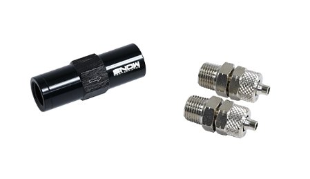

    So the AEM V3 nozzle has a built-in check valve, due to the high vacuum at decel, we added a second check valve in line to make sure nothing was dripping out at this high vacuum scenario. The AEM Solenoid is controlled by the meth controller and will NOT open until the meth is activated. The added check valve in line seemed to have helped the weaker check valve within the AEM nozzle and we don't feel there is a need for the solenoid at this time.
    This is the extra check valve we used, 2 benefits, the added "drip" protection as well as giving an extra break spot for hose if you ever need to run or replace it with new hose.
    snow performance high flow water-methanol check valve quick-connect fittings (nitrousexpress.com)

    Thanks Jesse and @bflooks for your support in this process.
    Order placed! Definitely that's the way to go.
    Summary of what's next
    • Relocate water/meth few inches below the actual mount
    • Add the Snow Performance HF check valve.
    • I really like the idea to add the AEM solenoid too as an extra. I will add it too :).
    This will be a 3 point check. The check valve in the nozzle, the Snow Perf. Check valve, and the AEM solenoid. :)

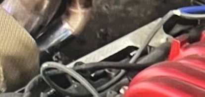

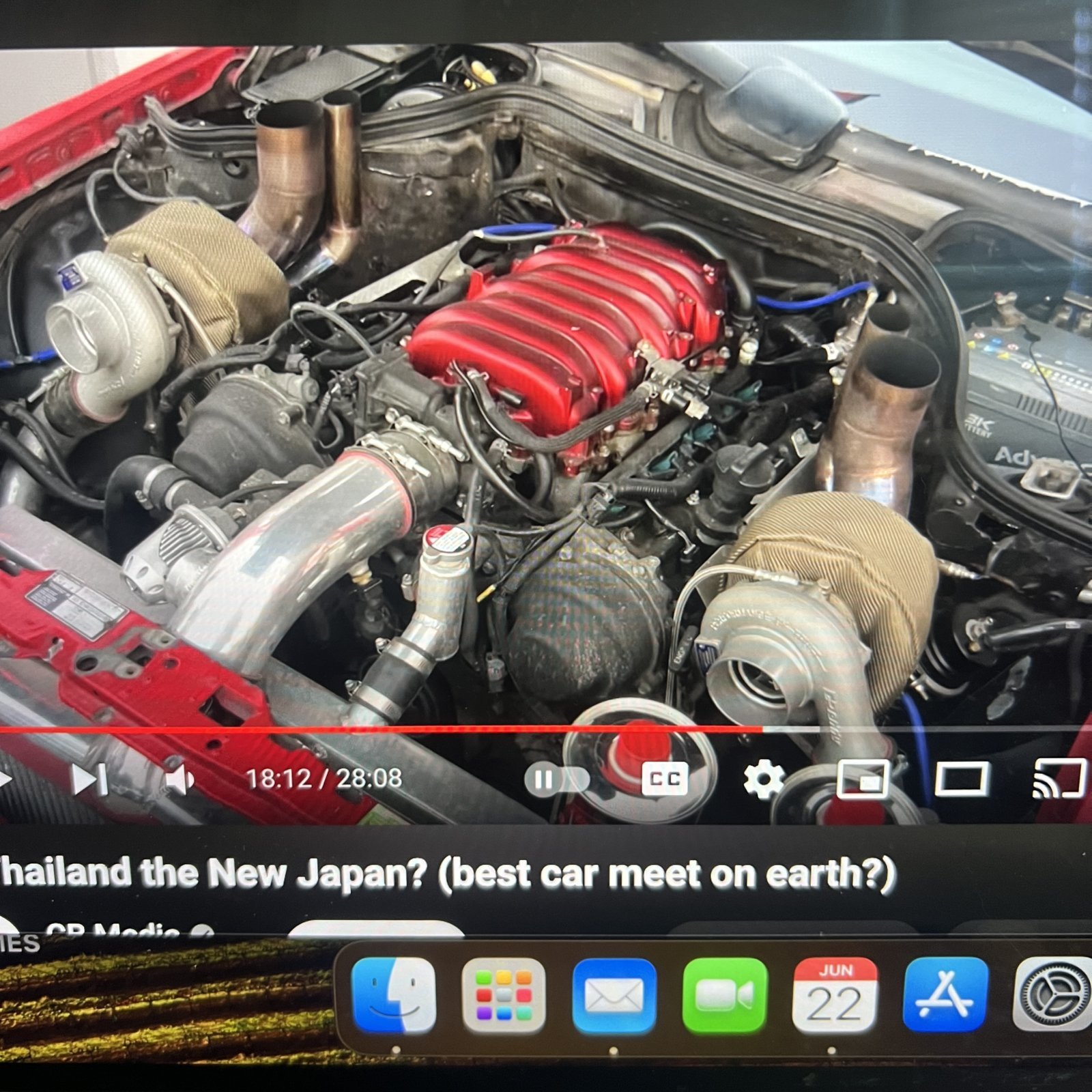

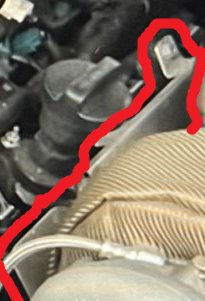

    Ran across a twin turbo toyota V8 in a video, never saw the whole thing so not sure what it was. Its in Thailand
    Jego, Mdl and bflooks[OP] like this.

    I like their engine heat shield design and appreciate their ability to direct dump right out of the hood, or run without air filters. I'm assuming it's a track vehicle to allow this, but IDK. Pretty cool, regardless. Can only imagine the power they're making.

    The heat blankets can be had here. You see them offshore and in plants all the time.
    I'm pretty sure its a strip/show truck.

    Not the blankets, but the plates running along the engine as a heat shield. I've had to wrap everything under these in heat protective tape and heat looming. The bolt on plates are a much cleaner (and faster) approach.

    Went right over my head. Yeh, its nice and clean. Sure makes working on it mo betta
