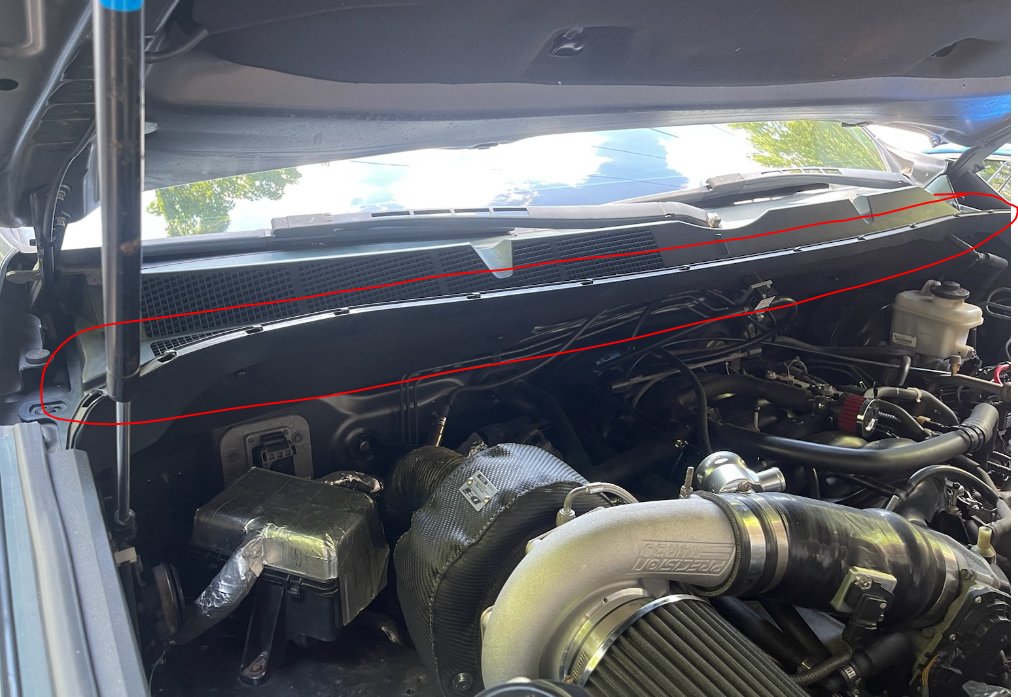

    Yeah, I was thinking quick to add some spacers to the hood mounts, getting the back / windshield side of the hood off the weather strip/sealing surface, but wanted to make one change at a time. However, yes, agree, pull cool air in, evacuate warm air out!
    Saw the logs, looks great. Loving the IATs!
    coTony and bflooks[QUOTED][OP] like this.

    Use the 2.5 Gen hood bulge as your intake. Should be able to create some venting system under the hood to distribute accordingly. With the BD 40” Light Bar up there and the holes drilled behind it provide an air stream for sure. Whatever you do I am sure it could be made cheaper than a fiberglass hood with a scoop on it for air intake

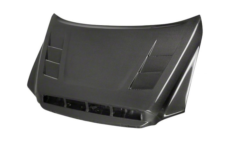

    upload_2024-6-12_19-18-13.png upload_2024-6-12_19-18-46.pngupload_2024-6-12_19-19-12.png
    or the vented hood like @reywcms 's dad's rig

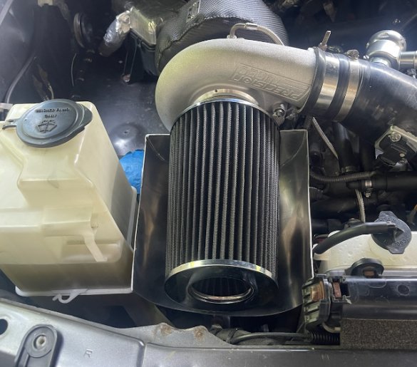

    Also, remembered I grabbed this from Oreilly's a while back, it's from Spectre and IIRC was under $40. Just installed it and will see if it helps. I wonder if the filter is pulling in hot air from below, mixing with the cold air from the front ducts. Ultimately, I think the aluminum heat soaks, but we'll see. I could always put some of that gold thermal tape on the underside.
