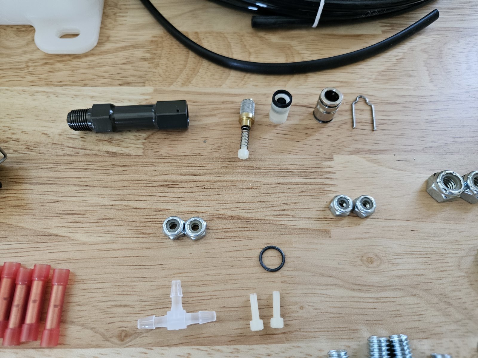

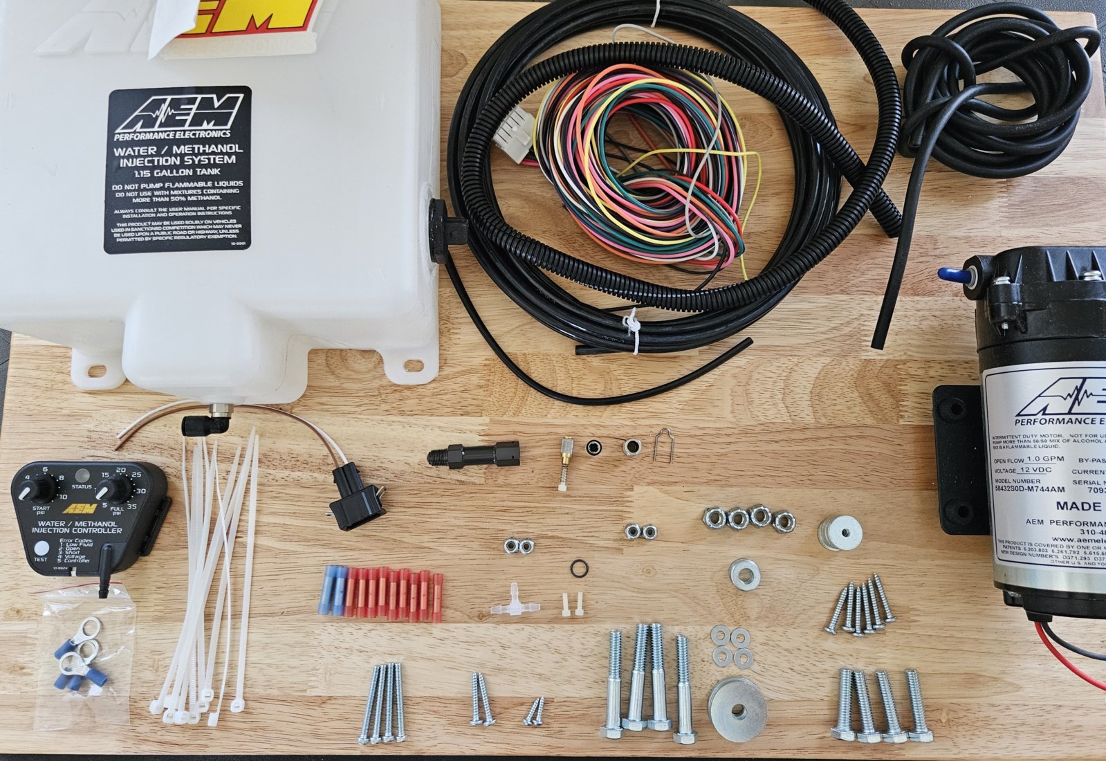

    Sorry for the delay. I was in hospital last night, got flu. :(
    Here is a pic of the whole content. Glad to know it is the v3 nozzle. The installation guide confused me because it refers to the v2 nozzle.

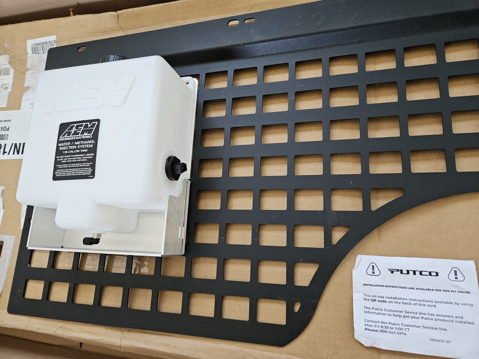

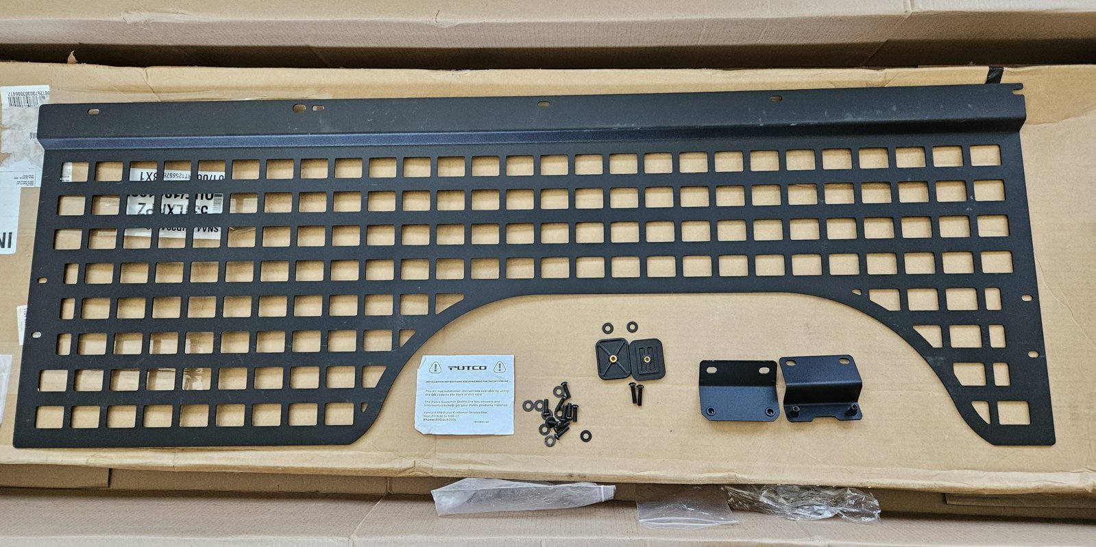

    The molle was delivered yesterday. As I mentioned before I wanted it to install the water/meth tank.:)
    And will look like this:

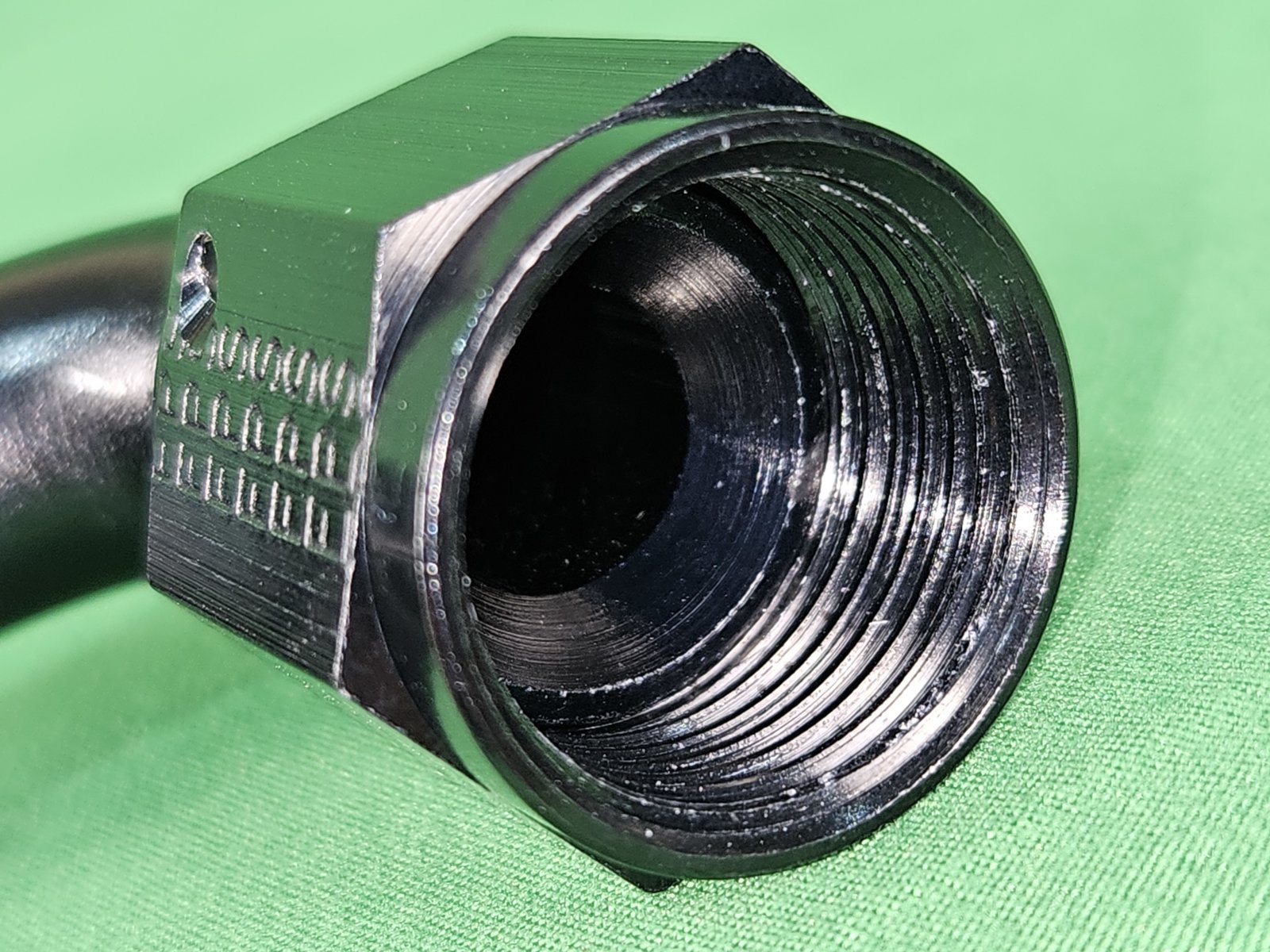

    Nice! I'm taking a lot of notes from your experience. Thanks for sharing! I can't wait to hear from you after that 5 mile climb! These last few days I haven't been able to do anything due to the flu that my children and I had. We are getting better now. It will be impossible for me to work on my Tundra the first 2 weeks of July so I will probably ended doing the heavy part of the installation on the third week of July. In these next weeks I will focus on those things that doesn't required much downtime of my Tundra like the molle install, water/meth kit install, and the connector box relocation. Also, I have to spent time on videos editing. This is probably all I can do based on my available time before July. I need a vehicle these days more than ever due to summer vacations working from home and taking care of my 2 boys. I will post more pictures as soon as I have more.

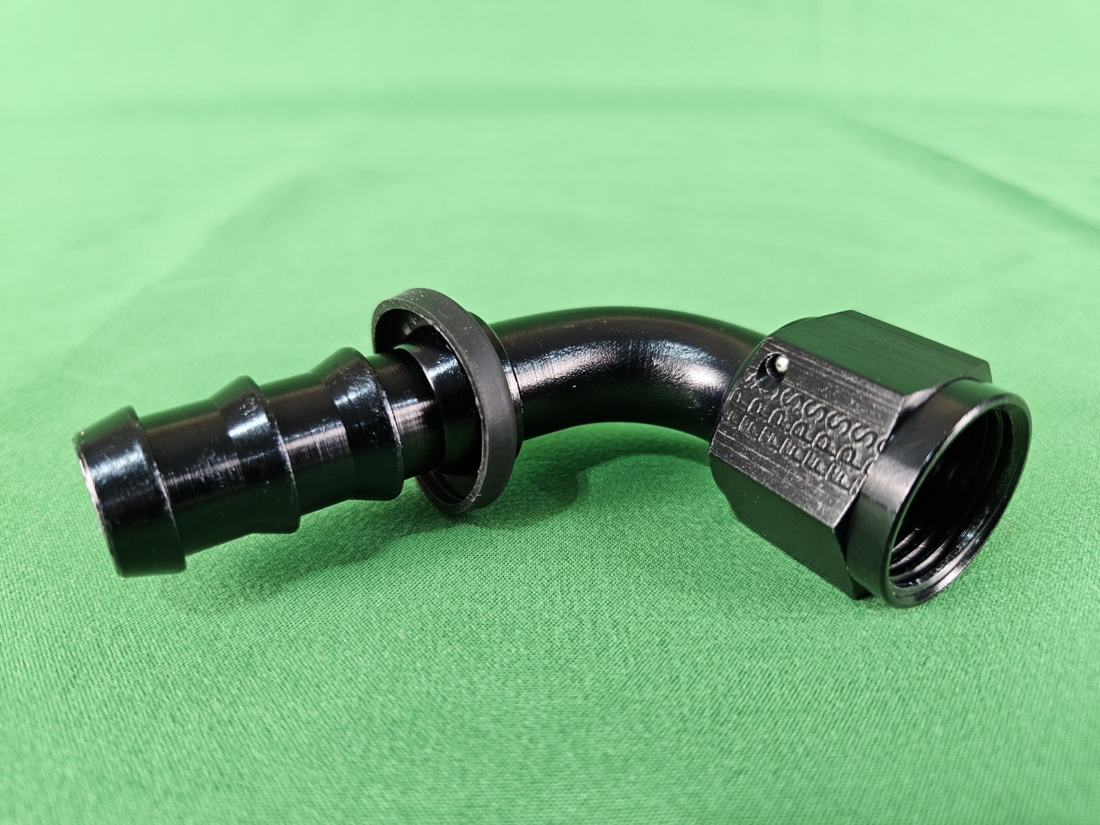

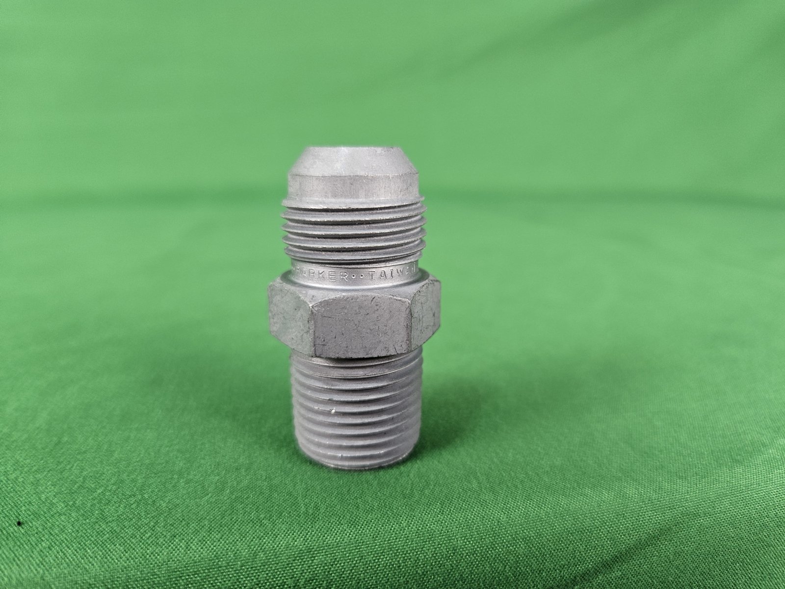

    Just 1 update for now. The new oil drain fittings were delivered today. Thanks Jesse for the update!

    Oh man, no fun when the whole house is sick. I have 4 boys and I swear someone is always sick or needs a ride somewhere! LOL Take care and feel better!

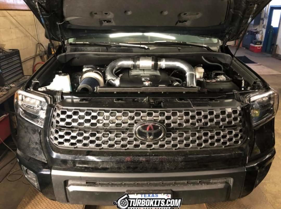

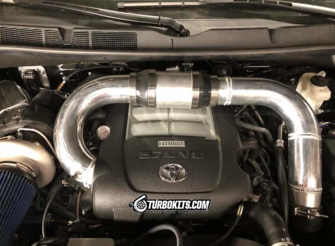

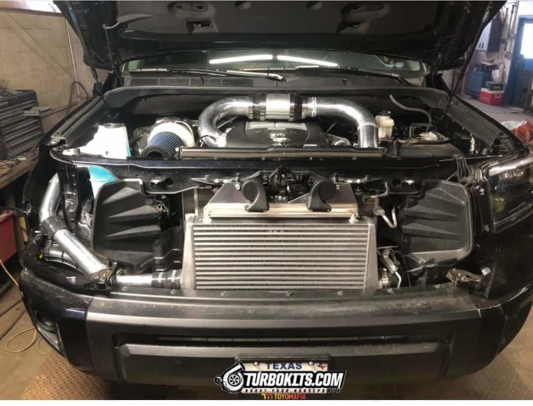

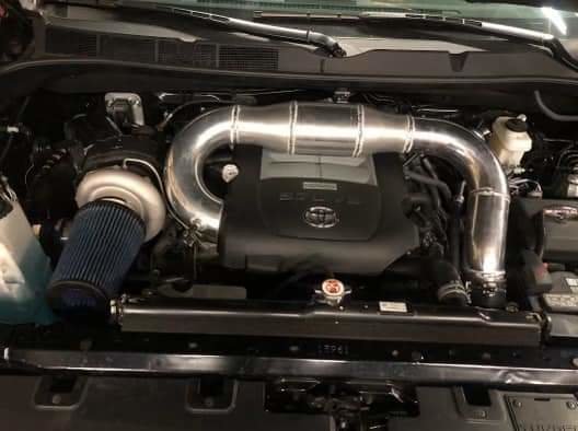

    A woman in my local Tundra group claims to have a Stage 2 kit she got from Turbokits.
  16. Jun 12, 2024 at 6:33 AM
    #1096
    TurboKits
    TurboKits New Member
    Nov 11, 2022
    #86522
    532
    If she's trying to sell it, it's a scam. That's the 2021 we did. The truck went back to stock as the customer had a family emergency and didn't have the time to allow us to finish the tuning side. I actually have that MAF piping in my office! Scam Alert!!

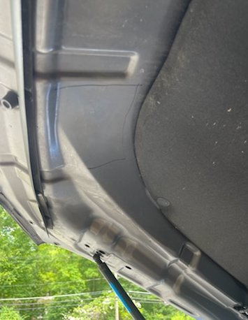

    Did this on my lunch break, too about an hour, maybe less! I've been wanting to do it for a while, was actually way easier than I thought. Thank god for the THIIINNN hood metal stamping. LOL. I'll get some weather stripping on the edges and eventually find and add a proper scoop.

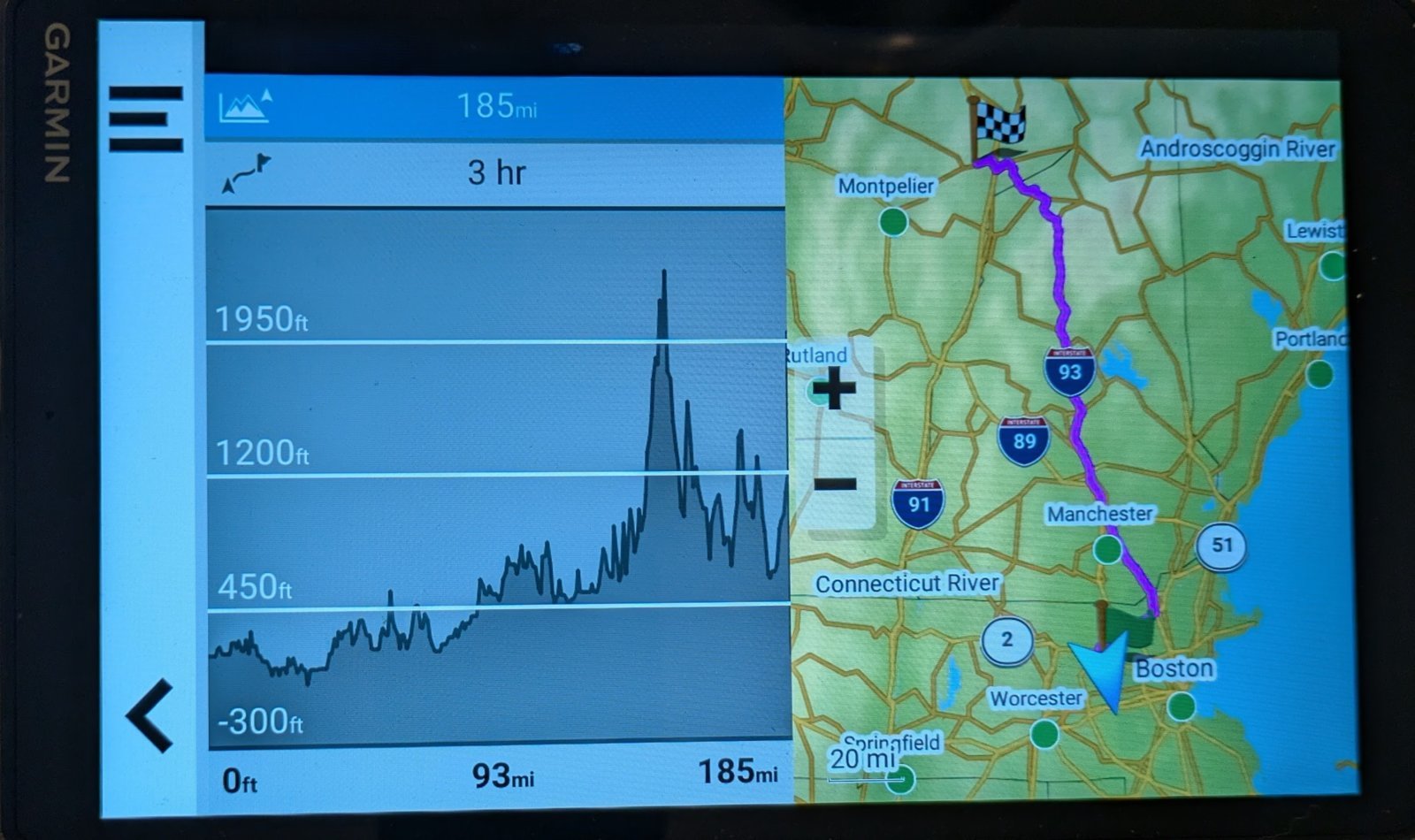

    I'm curious to see how the venting works, @TurboKits.com! I was thinking I needed something to let the heat escape, not just bring in cool air, but I do suppose one requires the other.
    As a small update, I got about 40 more miles of towing in today before the big trip tomorrow. No longer hills with boost, but with the new OEM thermostat installed, the truck now rides 192-196 unloaded, and 199 (on average) just cruising while towing. A 5th gear 0.0PSI incline did get me to 205, but then water meth kicked in shortly after and held it at 203. So, MAYBE the thermostat is helping? IDK yet. Will know for sure tomorrow. On this run, IATs averaged 5-10 degrees above ambient, so no complaints there.
