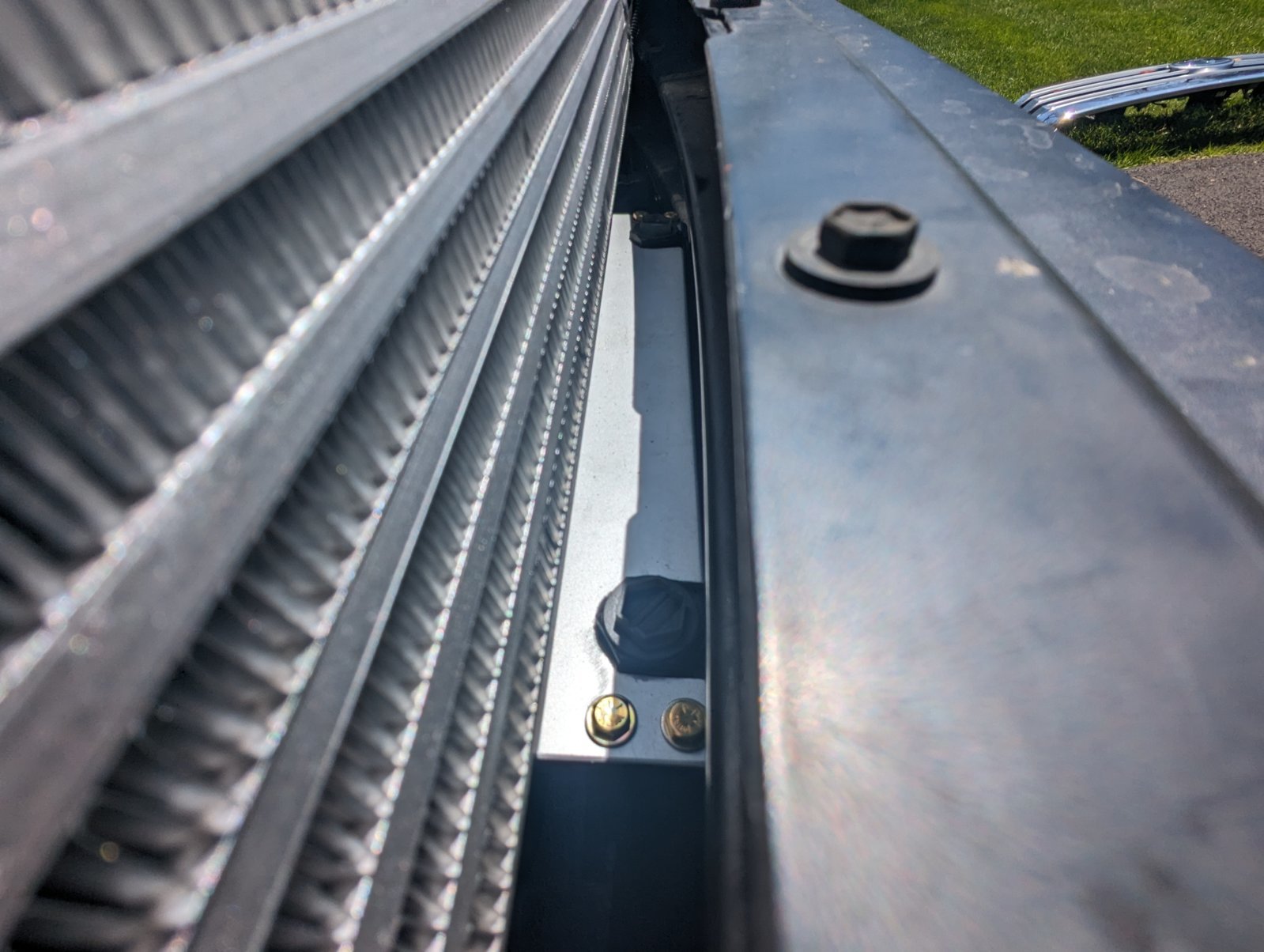

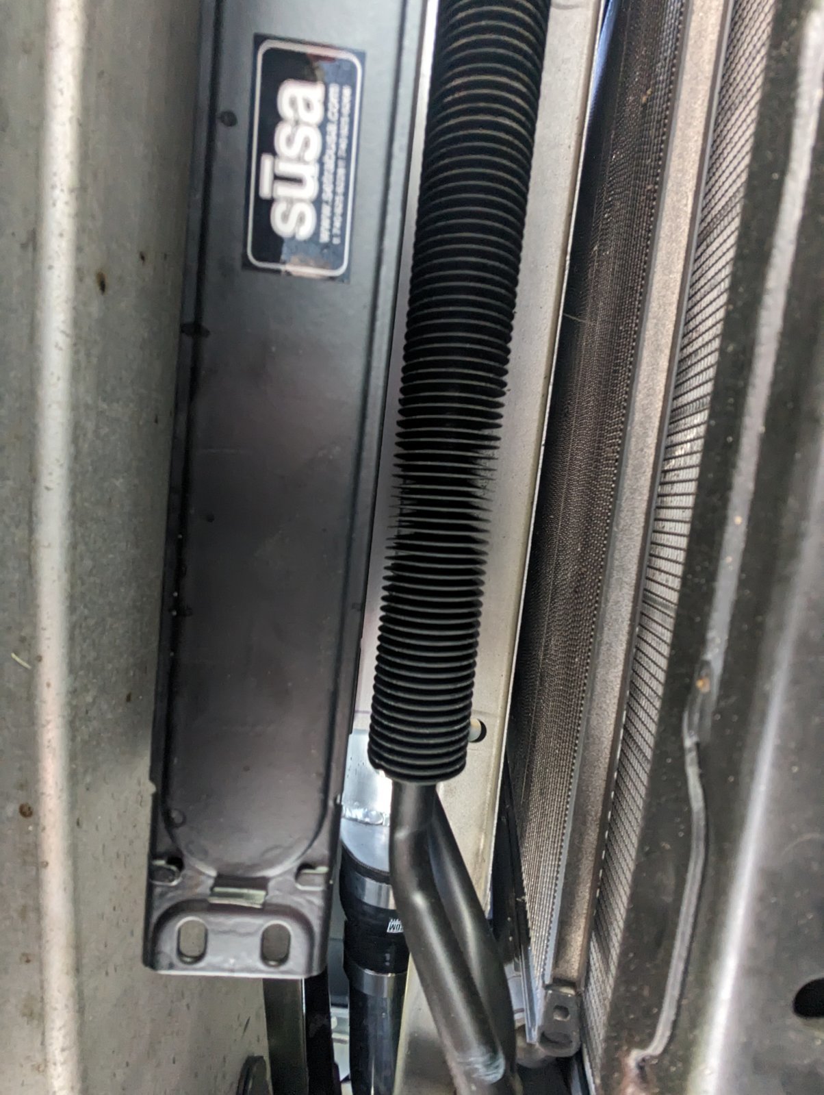

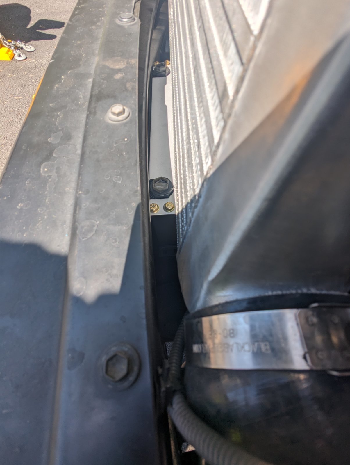

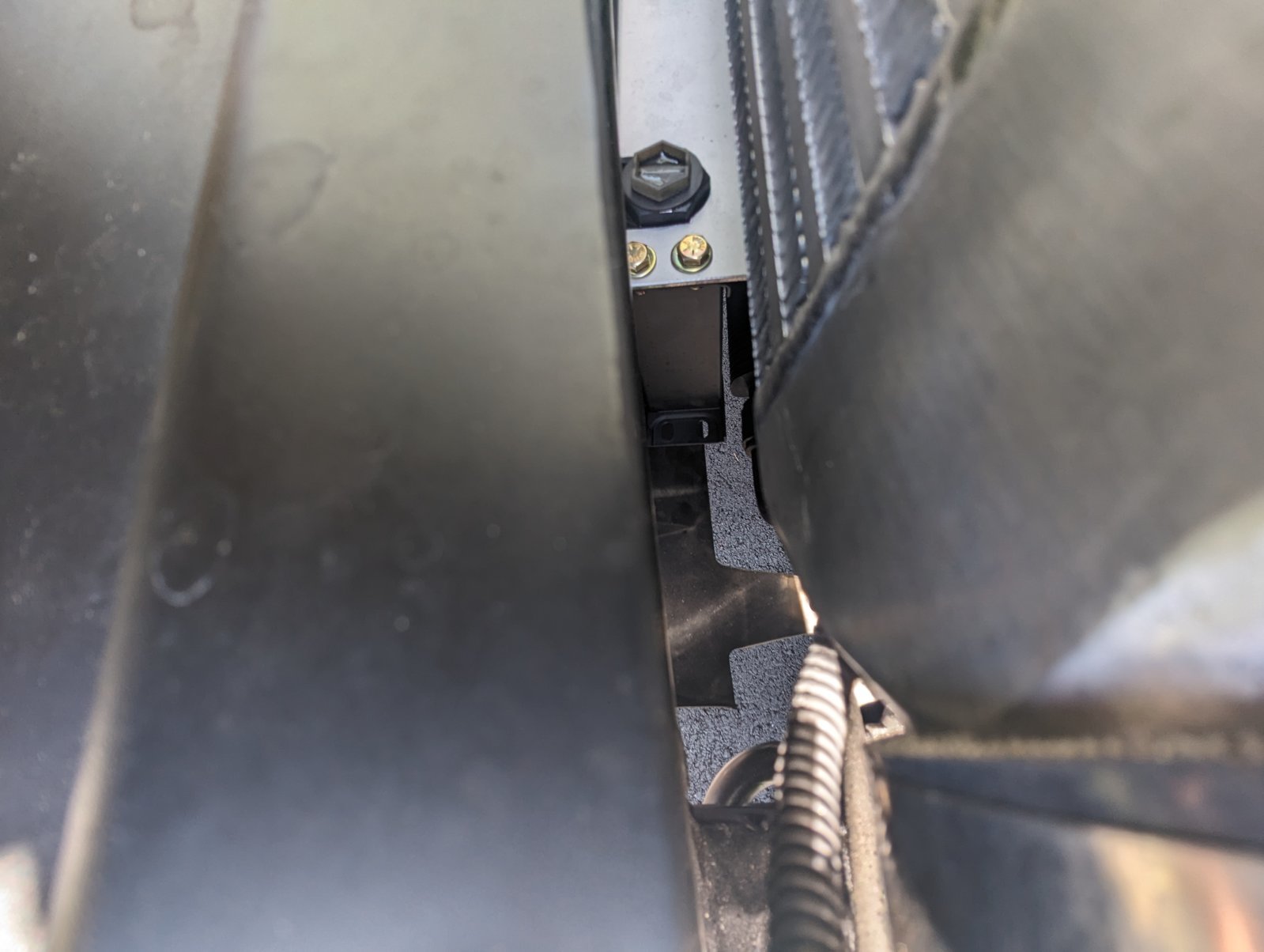

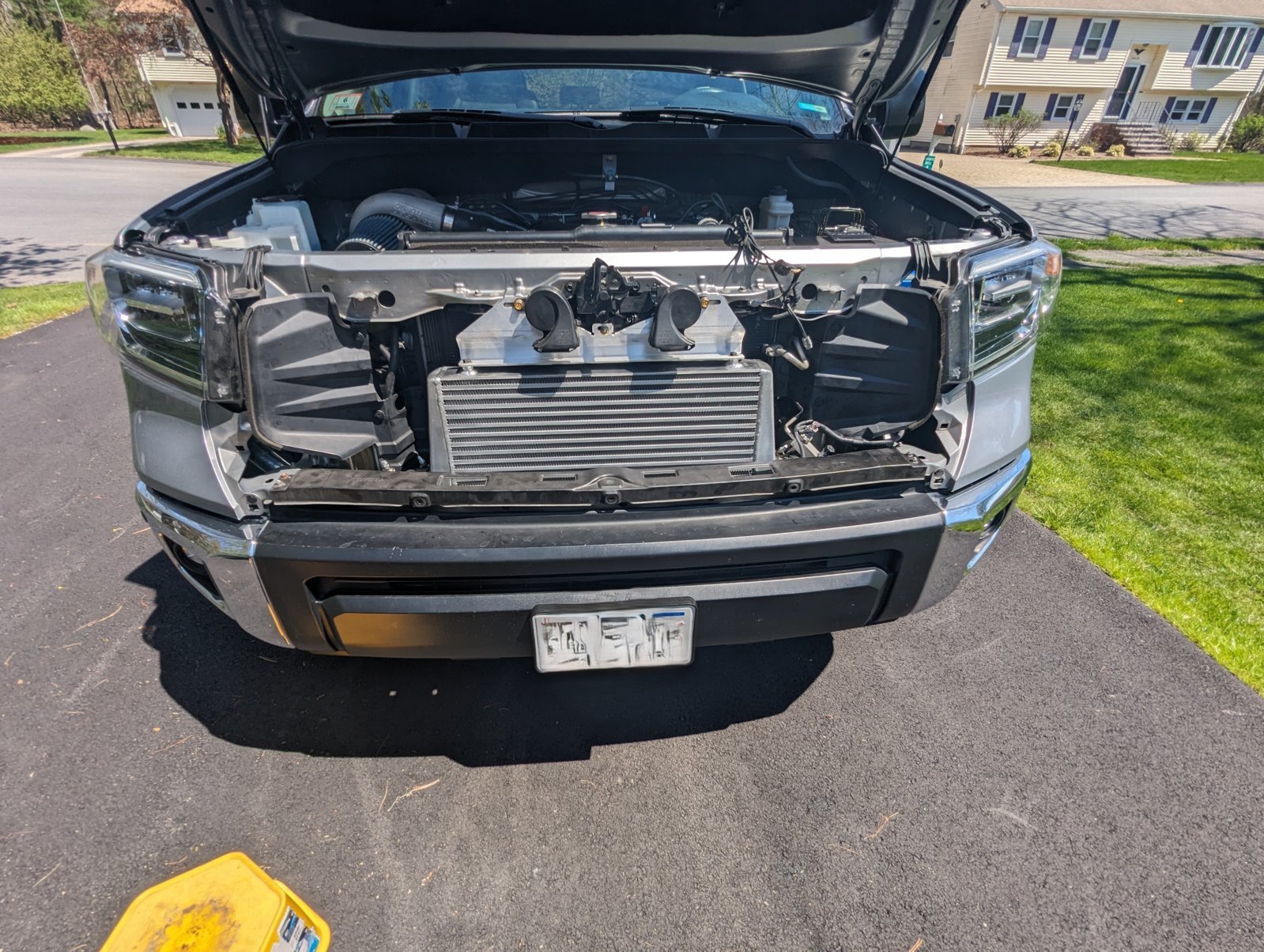

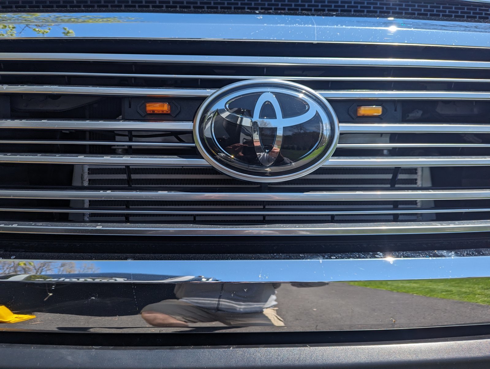

    Some quick photos to help with the cooler(s) relocation and install. My phone is filthy and the sun is giving a nasty glare, so set expectations low for overall quality.
    PXL_20240502_161356796.jpg PXL_20240502_162922663.jpg PXL_20240502_163142320.jpg PXL_20240502_163214263.jpg PXL_20240502_163202389.jpg PXL_20240502_161457831.jpg

    @TurboKits.com - please relay my thanks to the fabricator, again. I'm realizing the photos aren't doing the strength of the mount any justice, and perhaps the location isn't ideal, but that's not his or your faults. I had an existing aftermarket part that you haven't had to deal with yet because it's a 19+ issue. I also asked you to relocate a larger version of said part. Even with less airflow, I'm doubtful I'll lose anything as a result of the new unit being ~30% more efficient, but we'll know more soon enough.
    Just wanted to be crystal clear to all that the location is 100% the direct result of me bringing a solution because that's been the standard for 19-21's. Square peg/round hole scenario. All my fault.

    Hmm...that trans mount may actually interfere with the default ic pump location for s/c applications

    Possibly and perhaps. For reference, that vertical black bracket is the center hood latch support bracket?

    The current Setrab Pro line 15 or 20 rows that most use from the GCS kit wouldn't work without more fab work to try and offset both parts. Test results over the next few weeks will better inform if this is/should even be an option.
    I am betting there are better options, though, and I'm sure Jesse already has 10 different options he's mulling over after yesterday

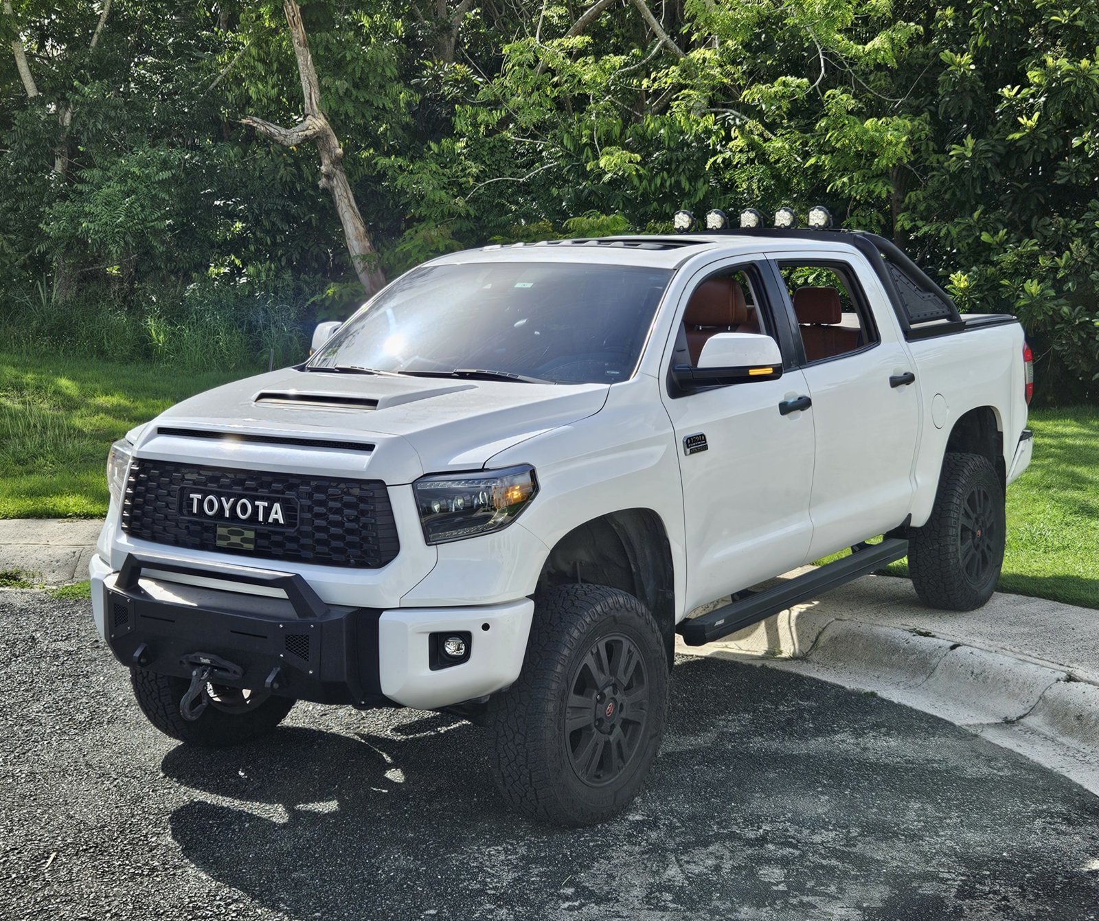

    Very close to complete the lift kit install on my Tundra. Some minor tweaks to be addressed this week. My Turbo kit was delivered this week and I am super excited about it! My Turbo kit install Journey starts at some point this week!

    Excited to flight follow! Looking forward to seeing how things go for you and seeing how similar the experiences are.
    Truck looks great, btw.

    Thanks! Here is another pic. that I took today. This is my dream truck! :)
    Nice! I am glad to know that specially because I want the stage 1.5 too. :) For sure I will be learning a lot from this experience too. At least my kit already has all the updates from your feedback. That helps a lot specially for me living at PR, really far from Jesse. The other thing is that I have to mod the cross over pipe due to the 6 in. lift kit. This is something that I knew before. Jesse sent me the cross over first to test it, but I asked him to send the whole kit anyways because I really wanted it. I am decided to do all I can to make this work on my lifted Tundra.
