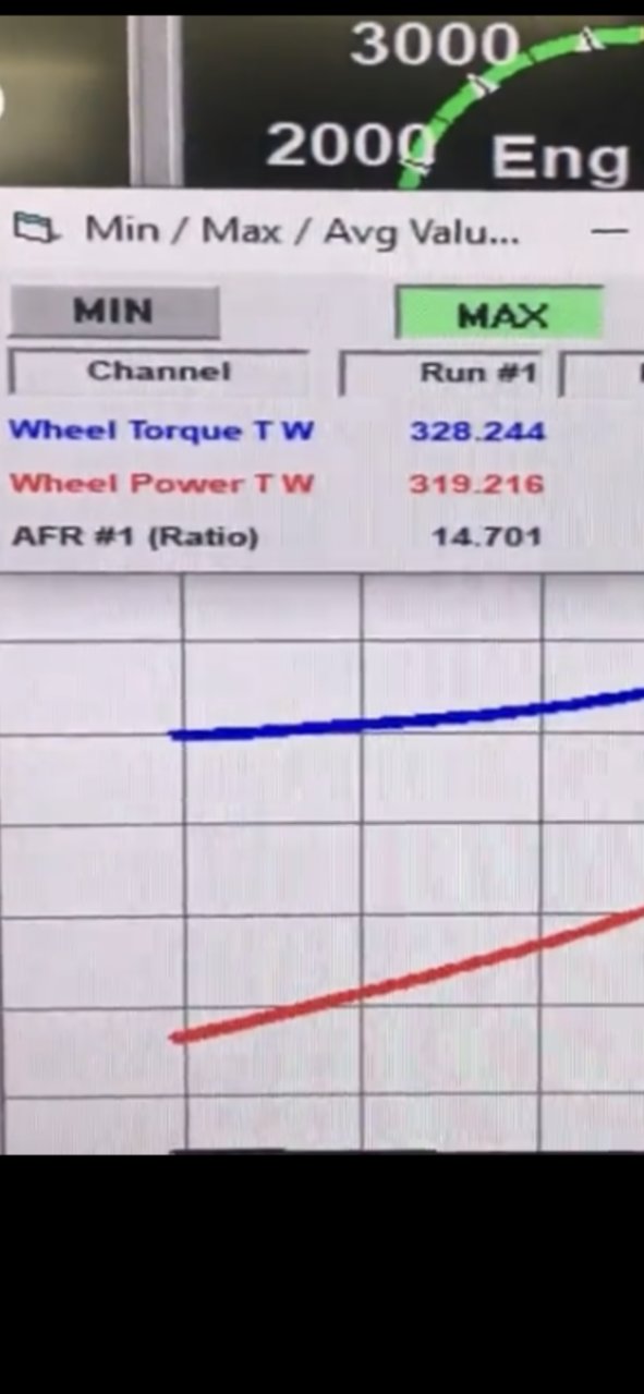

    Here are the real numbers with no adding or subtracting and no fudging!!!:)260AB2D0-7BE9-43D8-B871-A8EA8B30623C.jpg
    TRD Cold Air Intake and TRD Dual Cutback Exhaust. First real world numbers I have even seen on a Tundra ran on a Dyno!

    Harrop supercharger, TRD Pro Fox suspension, CB +1 shackles, 295/70-18 Toyo ATIII, TRD Pro forged rims
    I forget, is this a Dynojet?
    Lots of people here dyno their Tundras?:monocle:

    Ken
    SE Texas
    Mustang Dyno
    ZPhilip[QUOTED] likes this.
    Mine went 295hp, 321tq on Dynojet. All stock besides TRD intake(doesn’t add power) and 34” tires. Your numbers might be higher because of the exhaust.

    S/C'd 2020 White 1794 Tundra
    Mine was 282/301. Stock intake. Trd exhaust
    Interested to see the gains on the same dyno

    3) Pipe & Turbo Weight: Yes the uppipe / turbo mounting pipe has a beefy bracket built into it. Keep in mind, we aren't testing theory on Ken's truck, we are purely using it to creat a from scratch install guide, which would have been difficult to do on our test mule, as the turbo has been on an off multiple times, and with various design changes. But, we have had this set up on our test tundra for over 2 years and 20k+ miles, long highway driving, daily, snow, trail and off road, it has been consistently tested in multiple environments.
    4) DYNO#s: Ken's 2021 Truck, 6K miles, Intake & Exh, stock crank HP = 381/401, figure 15HP or so from the intake an exhaust, deduct 15-20% for the DYNO loss and the #s are right in line. The good news, it's a tad irrelevant to our testing, as what we are looking to compare are the before and after #s, the delta / gains. So we will be running both the stage 1 and stage 2 DYNO tests on the same exhaust DYNO with the same settings. We easily expect 25-30HP per PSI out of the 7675 turbo.
