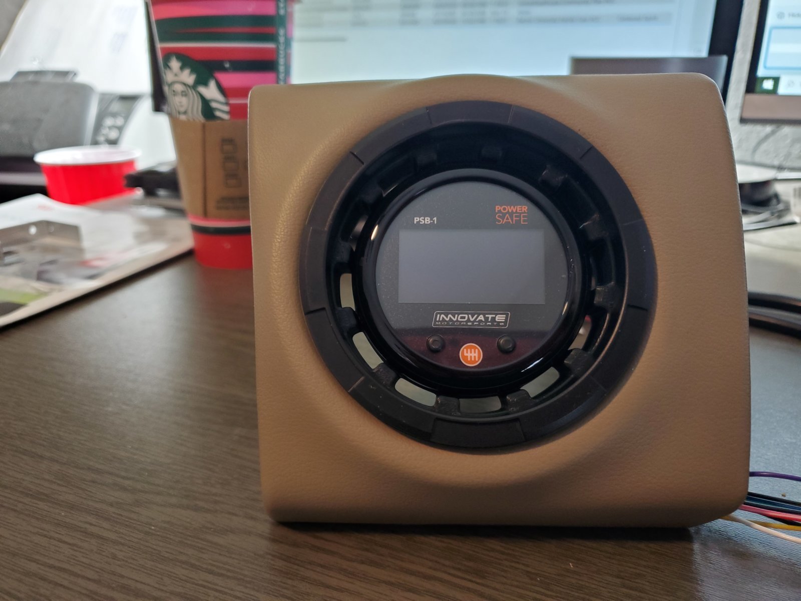

    Yes, I'm using the standard (52mm / 2 1/16") pod for my Innovate PSB-1 gauge. Everything fit like a glove.

    Whoa nice find!! Does it hold the gauge nice and tight, with the SCG1, you do push the buttons often for settings, I am assuming the gauge hold tight and doesn't move around with pressure from the buttons? Thanks for sharing, making me rethink the mounting in our truck :)

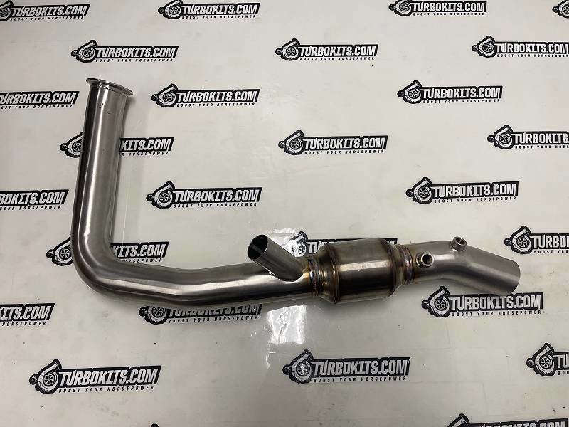

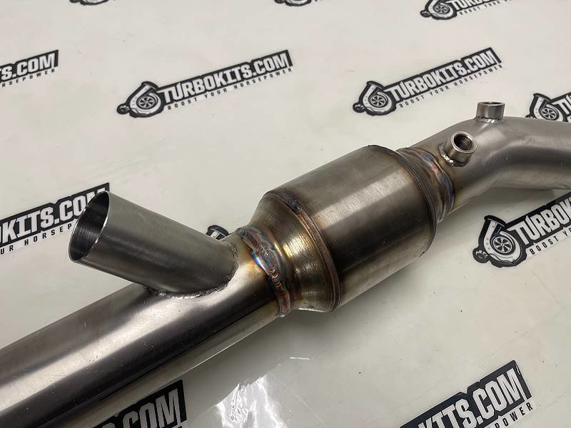

    Hey guys, just built one of our high flow CT pipes for another customer. Wanted to post some pics for your viewing pleasure. This is the highest flowing up to 850HP EPA certified high flow CAT on the market :cool:

    Nice. Those are the cats I've had on my s/c setup for about 20k miles. So far no issues. I blew out one of the stock cats prior.

    Damn, looks smaller than the hi-flow cats from ARH
    TurboKits[QUOTED] likes this.

    Yep!! Only way to go... Best flowing and EPA certified, so no hassles there. The only issue is the cost...
    Yeah, they released them a few years ago when the EPA was going nuts on the diesel guys. Other than California, which is it's own beast. These are 49 State and EPA certified.

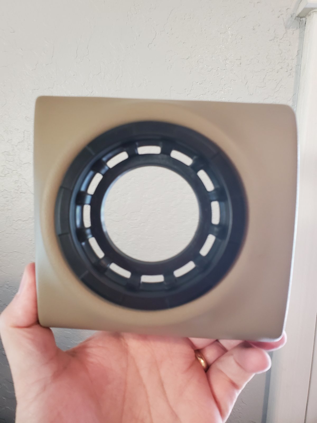

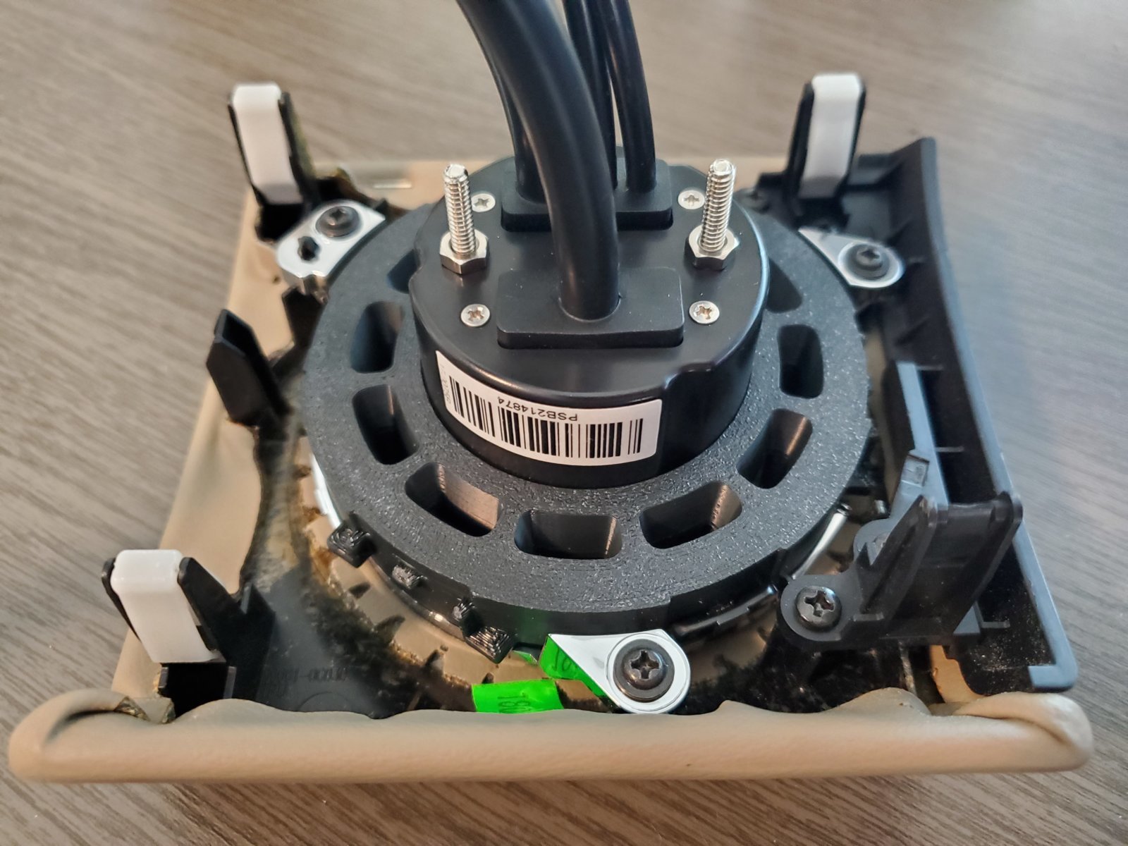

    It clips into the factory ac vent panel just like the stock vent and is just as secure. I push the buttons on mine quite a bit and never had an issue with it moving or being loose. Here are a few more pictures I had taken during the install. I do have the black trim rings around my ac vents which lay over the chrome ring (just wanted to call that out otherwise you'd see the chrome ring visible around the gauge pod).

    We're also improving the design too, for the tundra specifically.
    The tundra has some extra tabs to grab the mount (or vent body) that differ from the Tacoma, so it's a good/solid solution, but there's room for improvement there and so we'll be doing so.

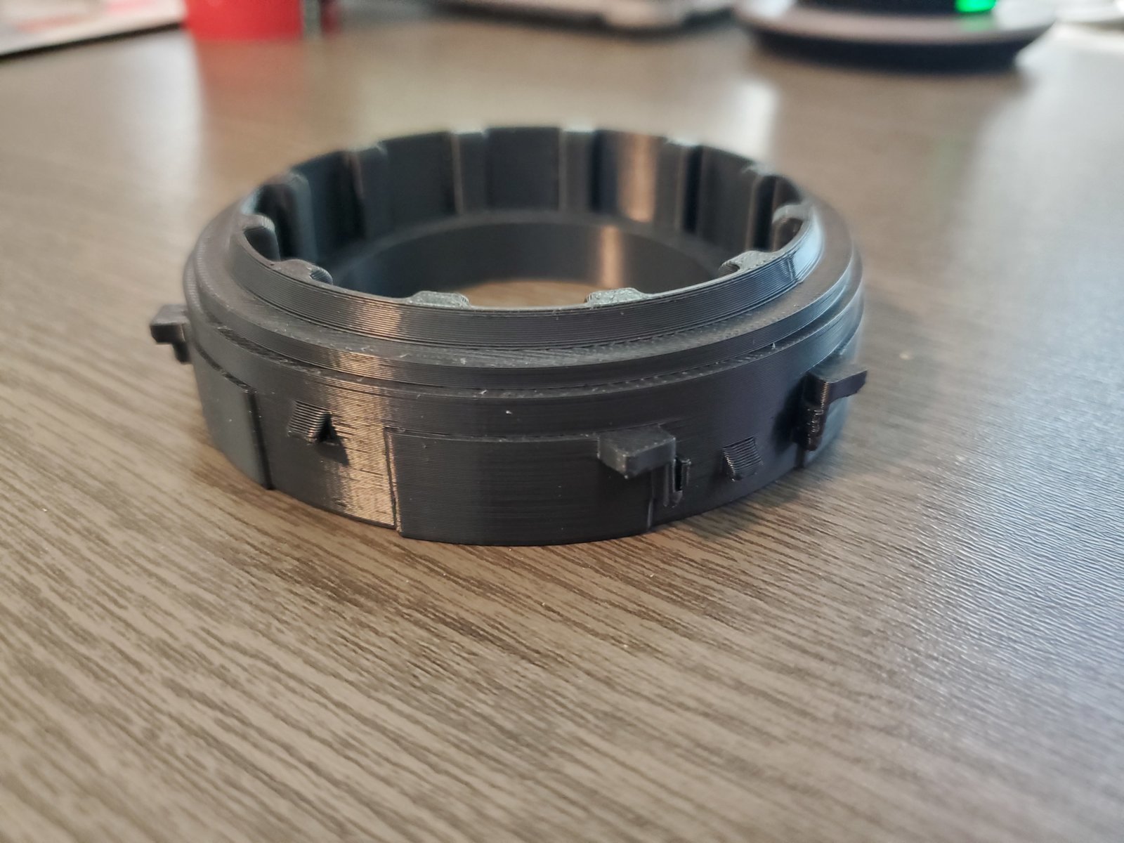

    Wondering what material are these. PLA, ABS, ....

    YotaWerx uses ABS for ours, as heater use can get nice and hot, not to mention interior temps on hot days

    The one I linked from etsy the seller confirmed he uses ASA.

    Good to know! ASA is similar to ABS but exhibits better UV resistance, mechanical properties and aesthetics.

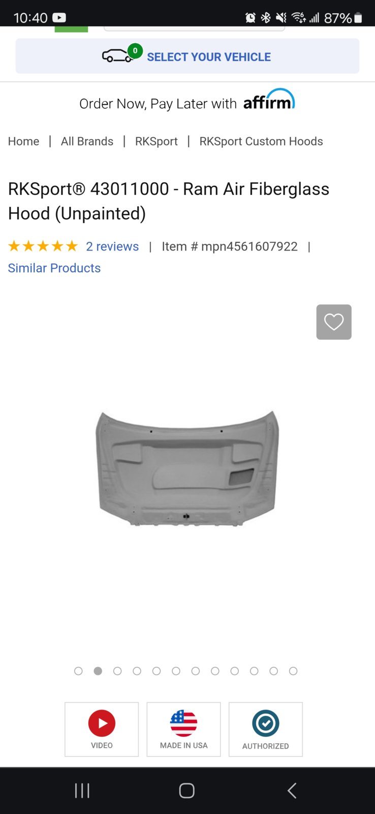

    I posted it early in the thread, but this ram air hood would be PERFECT for the turbo setup. It dumps the outside air directly over the turbo!
