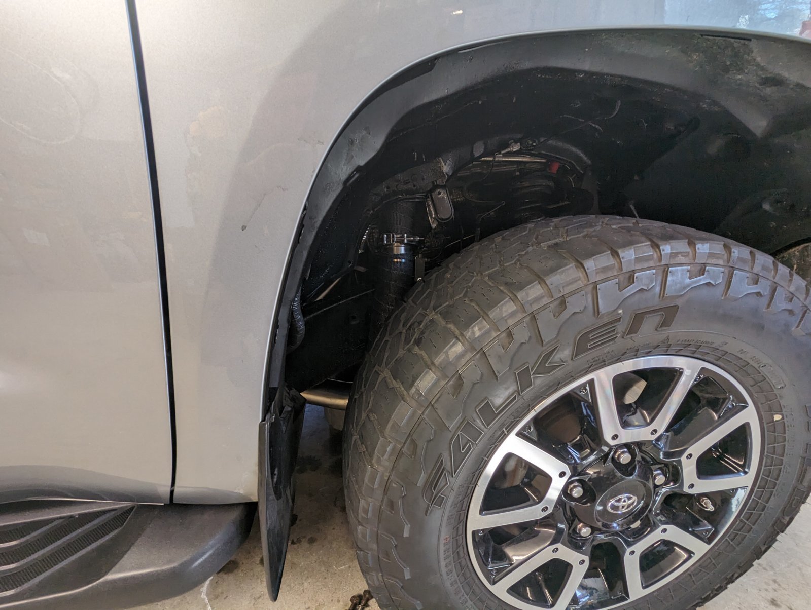

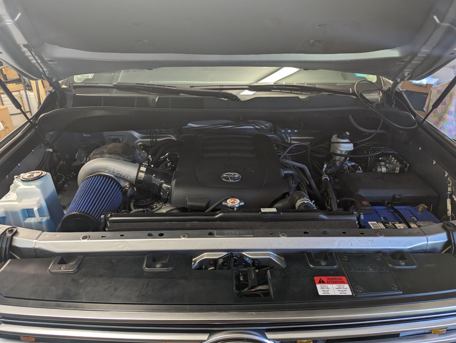

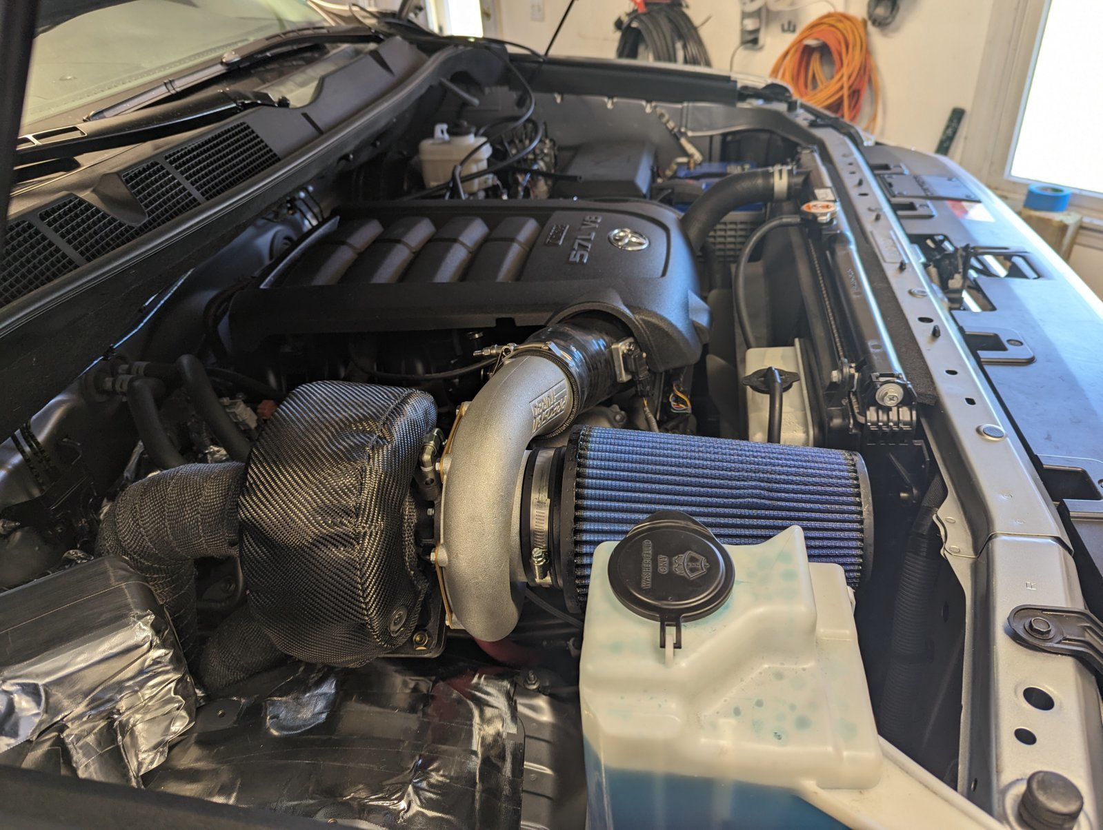

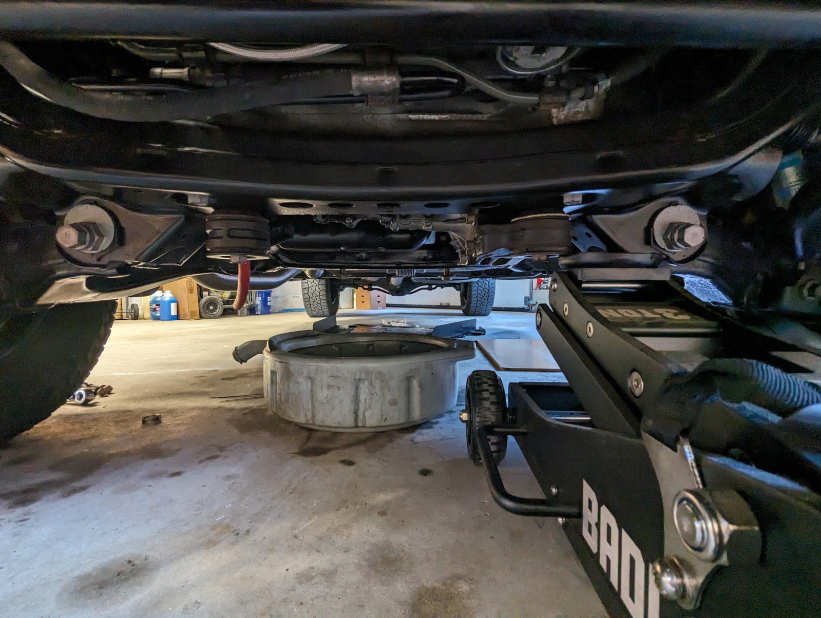

    Not finish install, but a little Turbo Charging a Tundra porn. Be mindful that I dropped the camera down well below the front valance to get the photo of the downpipe.
    Tomorrow and Monday are wiring the AEM Meth Injection and Innovate SCG-1 controller.
    Small snag on the oil return line (my temp replacement is the red hose hanging down) and Jesse is addressing Monday (I just emailed him a little while ago about it). As a result, fire up will likely be Tuesday.
    No, I did not ask for a matching air filter to my battery and washer fluid, but I'll take it!

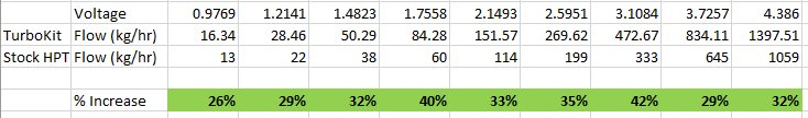

    The voltages do not change, the sensor is and the ECU needs a 0-5v signal. The magic is in the scaling inside the sensor, it doesn't reach the 5v max until more flow passes the sensor. If you look at the picture on the product page, you can see the flow -vs- volt scaling sheet that comes with each sensor. Keep in mind. The sheet is based on flow and volts scaling for our 3.4" ID stage 1 coupler, so if you are larger, those #s will increase by the same percentages as the increase in ID size. Most any tuner, that can scale for a larger MAF housing, should easily understand what needs to happen to make that sensor work! Thanks for your interest!

    Yea I follow all of that, I'm just trying to wrap my head around how much of a difference the sensor is vs stock. Showing the flow rates vs voltage doesn't help me much when I don't know those same metrics for the stock sensor.
    That's why I was asking when a stock sensor maxes out, if this sensor is dropped in what's the new voltage. The range is still 5V, but the new lower voltage at the same flow rate would explain how much voltage room we gain, which is all I really care about. Or if you have that same sheet you show but for the stock sensor so there's a baseline to compare against.

    Looks like it's roughly a 30% increase in flow for the 5V range based on your values and assuming HPT values are correct for a stock intake:

    Hey snivilous, thanks for chiming in with the info. Yes the numbers at a quick glance and what we see are about a 30% gain in flow before 5v. So thanks! This is again on a 3.4" ID MAF tube size. So anyone going larger, will see the same 30%, but it will be 30% of the larger MAF in terms of top flow (HP) at 5v.

    Slow progress today. Sort of.
    I ended up in a time crunch and Jesse offered to adjust his schedule and save me nearly 1/2 of my drive to them. Huge thank you, Jesse! Great meeting you in person.
    While handing off a few pieces to get me back on track, he happened to have his daily driver with him, which happens to be one of the test subjects. He kindly took me for a ride. I'm even more excited now than I was before I started the project. Smooth is the best way I'd describe the power.
    Alright, items accomplished (and failed ) today.
    Accomplished:
    • Oil return line swapped and checked off the list
    • Exhaust clamp installed and checked off the list
    • Meth tank installed
      • After mocking up the intended location, I realized it would be a PITA for me to access due to my tri-fold tonneau cover, so I moved it to the back of the bed
      • This will be much better for me, but things began to unravelled from here
    • AEM pump mounted and soldered in
    • AEM Meth kit wiring is laid out and required lines are routed through the firewall and into the cab
    • Vacuum line for AEM and SCG controllers routed through the firewall
    • Got oil for a safety net 500 mile break in, which will be perfect since the truck is about 600 miles shy of 50k and I can keep my "on the fives" schedule.
    Fails to be tackled another day:
    • Wiring a 30' run of power and ground on a recently rust Prevention coated vehicle absolutely blows. This set me back a lot of time.
    • Due to my relocation of the tank, I needed more hose than what came with the system. Jesse helped me out on this one because he had some in stock. Not 3 zip ties in after running the length of the truck, I nicked the line with the knife and completely hosed myself because now neither section of line is long enough. Awaiting more line.
    • Wiring failures all day. This isn't hard, but this isn't a project to get into when having an off day.
    • I don't like redoing work, and that's what a lot of today was. None of this is a fault of the kit or Turbokits or Jesse since the AEM and SCG installs are completely standard, per the manufacturer instructions.
    So, I was planning to have it started tomorrow AM. That's now pushed to Thursday AM at best due to personal obligations. I just got in from the garage a little while ago and tomorrow just isn't happening, unfortunately.
    Thanks again, Jesse.
