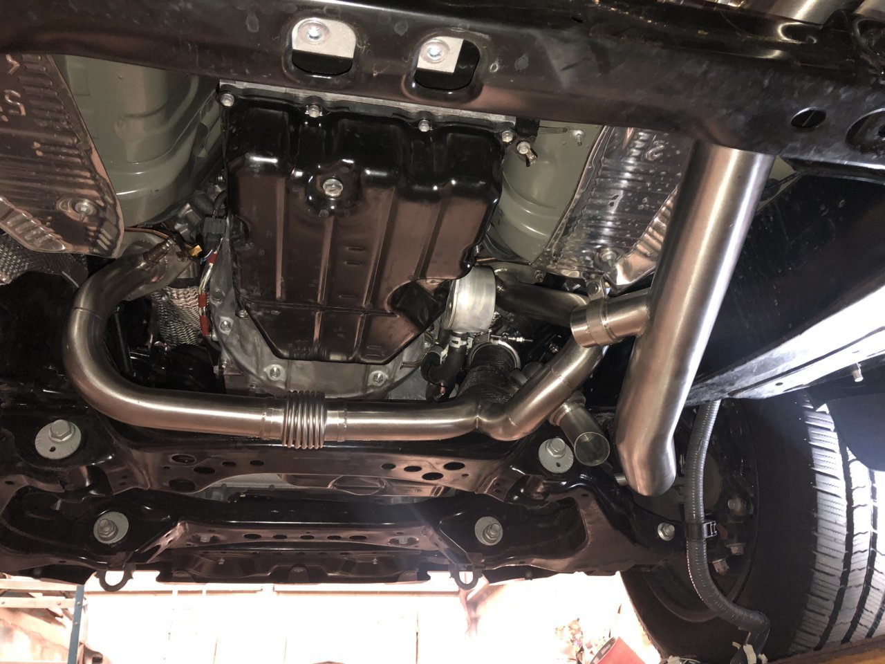

    I believe we posted this before, but it does not hang down any lower than the lowest part of the truck, ie front suspension, control arms, etc, rear "pumpkin". The 2021 had about 8" if clearance and the lowest part of the downpipe was still at 8". The rest of the piping and sits up as tight as possible. See pics.
    In regards to the CAT shields. Kens 2021 had them, luckily we didn't cut the opening for the downpipe, since he ended up needing the truck back and we went back to stock, but other than the downpipe loop that comes up under the frame rail, and cutting an opening for that. It looked like everything else would be covered without much hassle.

    What is the cost for a new downpipe if/when it gets damaged?
    Understanding the geometry of the Tundra is key since it is a pig. The breakover angle is not forgiving and scraping the bottom as you play in the rocks are common

    We do not have the kit pieces priced individually yet. If something like that were to happen to a customer. We would absolutely work with them, get the pipe back and fix it would most likely be the most cost effective. I would suspect the downpipe to be in the $200-$300 range as a stand alone purchase.

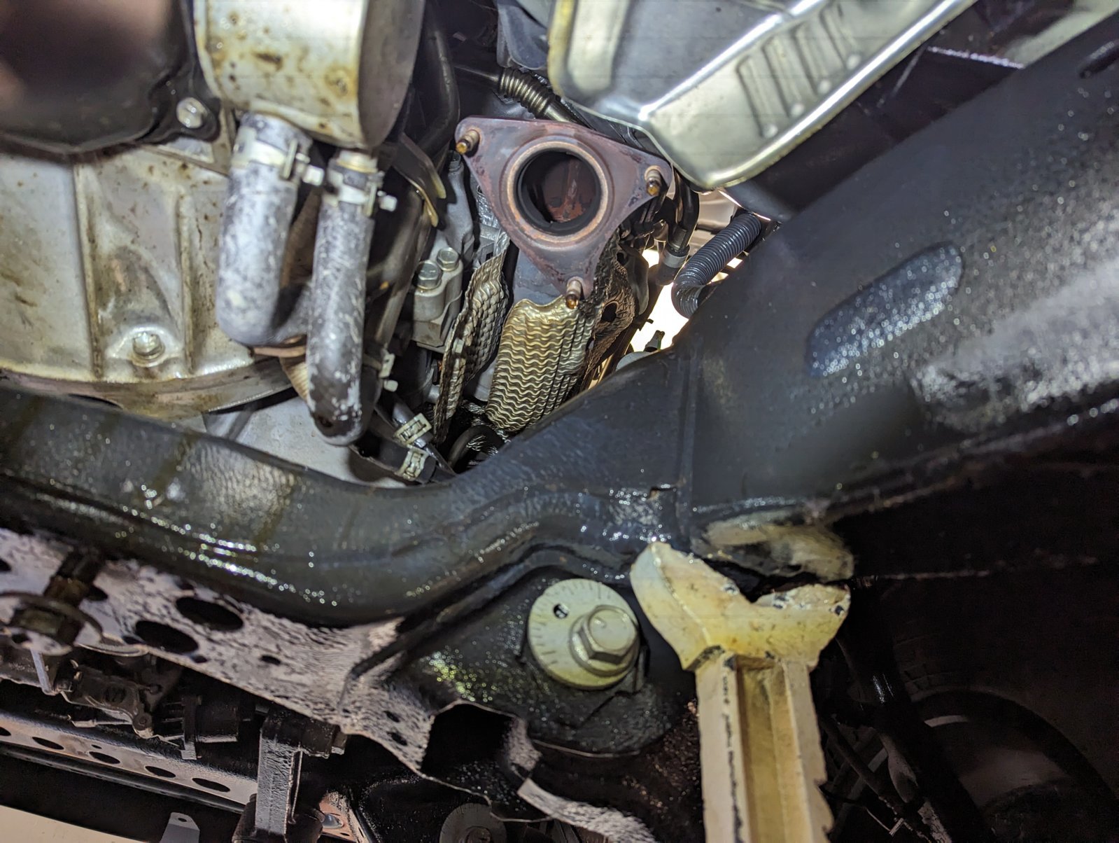

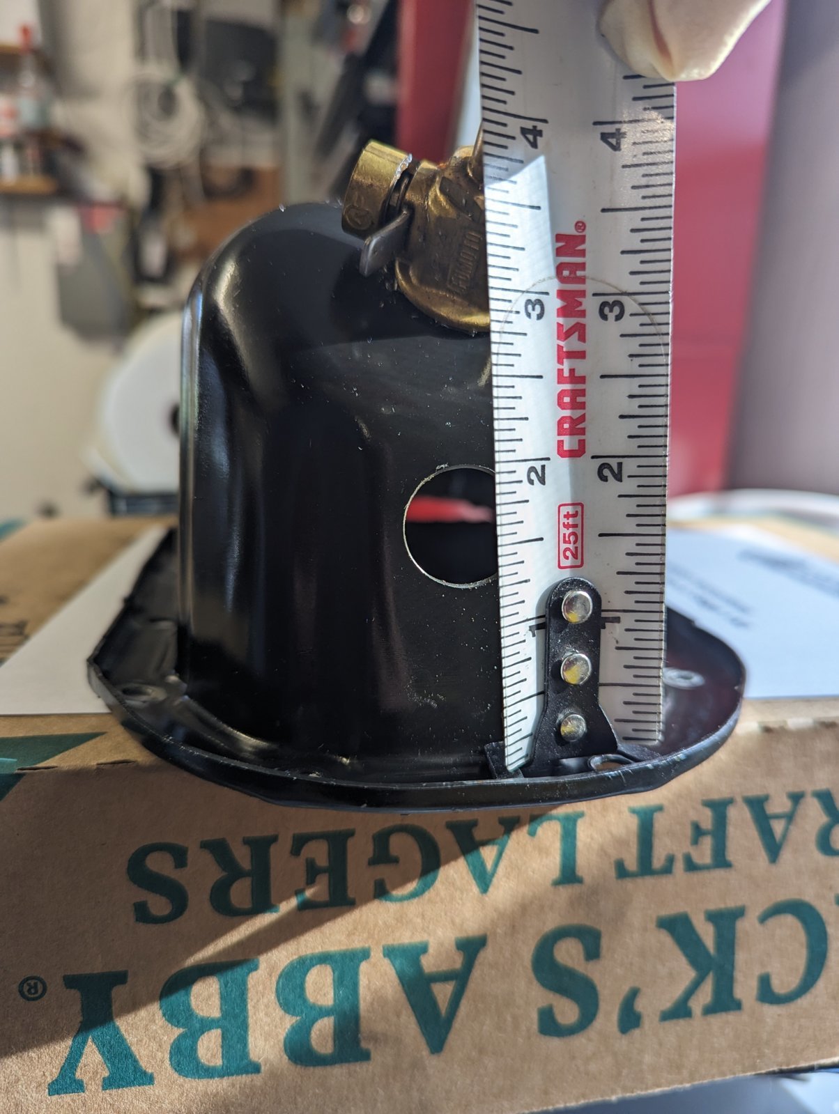

    I forgot how much I despise having to drop the cat protection plates. Also didn't realize just how amazing it is to be lubed up in their rust prevention. :mad:
    Just ordered a bunch of Blackstone kits so I can have a before (Mobil1 0w-20 at 5k mile OCI) and after (Mobil1 0w-30) to help determine correct OCIs going forward. All intervals are considered severe duty so there will be a some consistency in the results.
    I envy you all who have height for a lift.

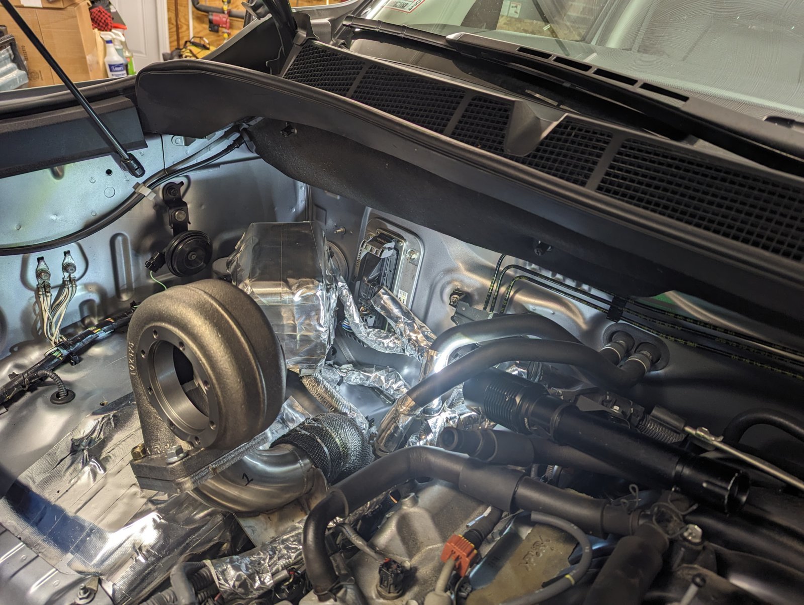

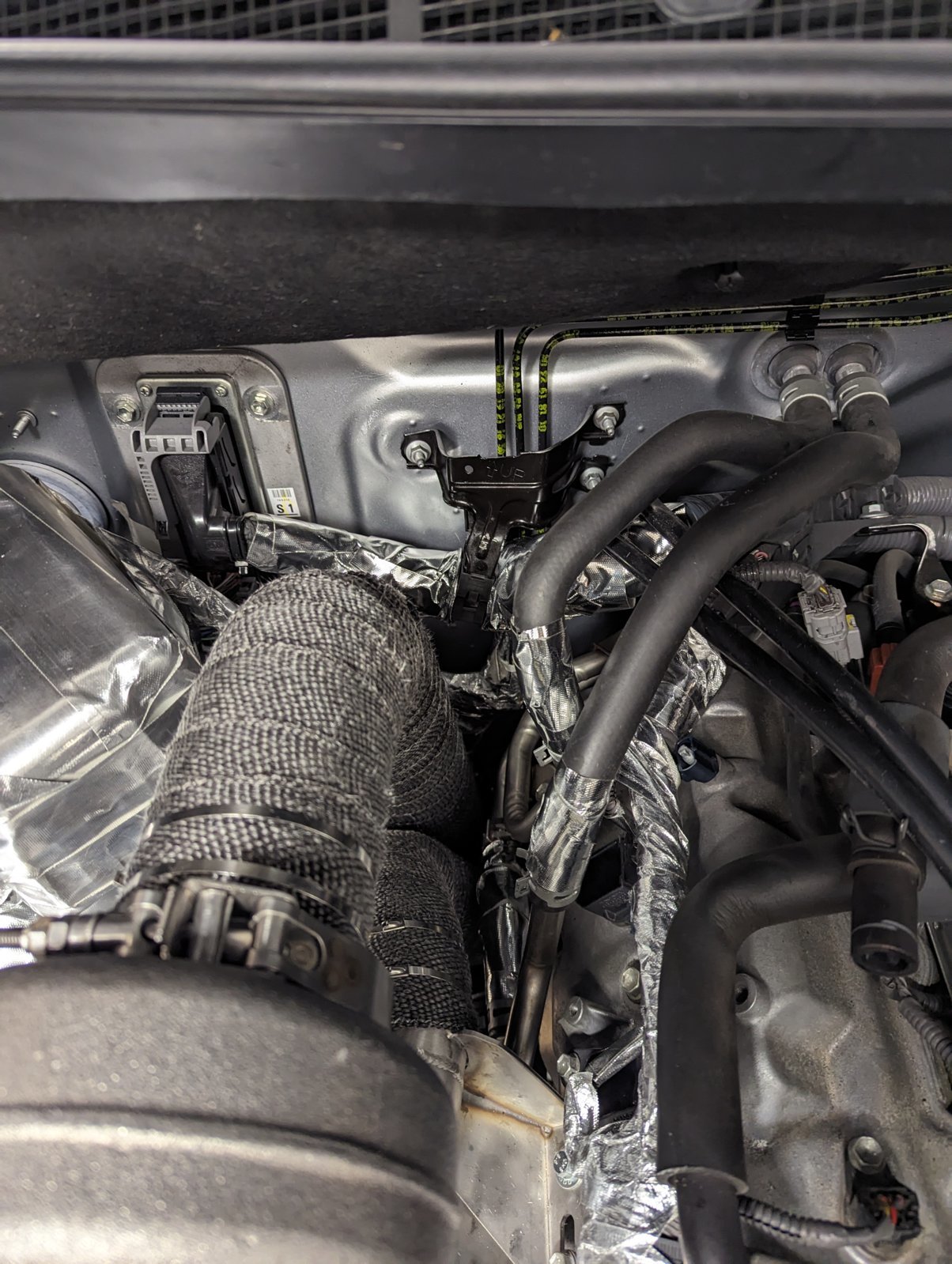

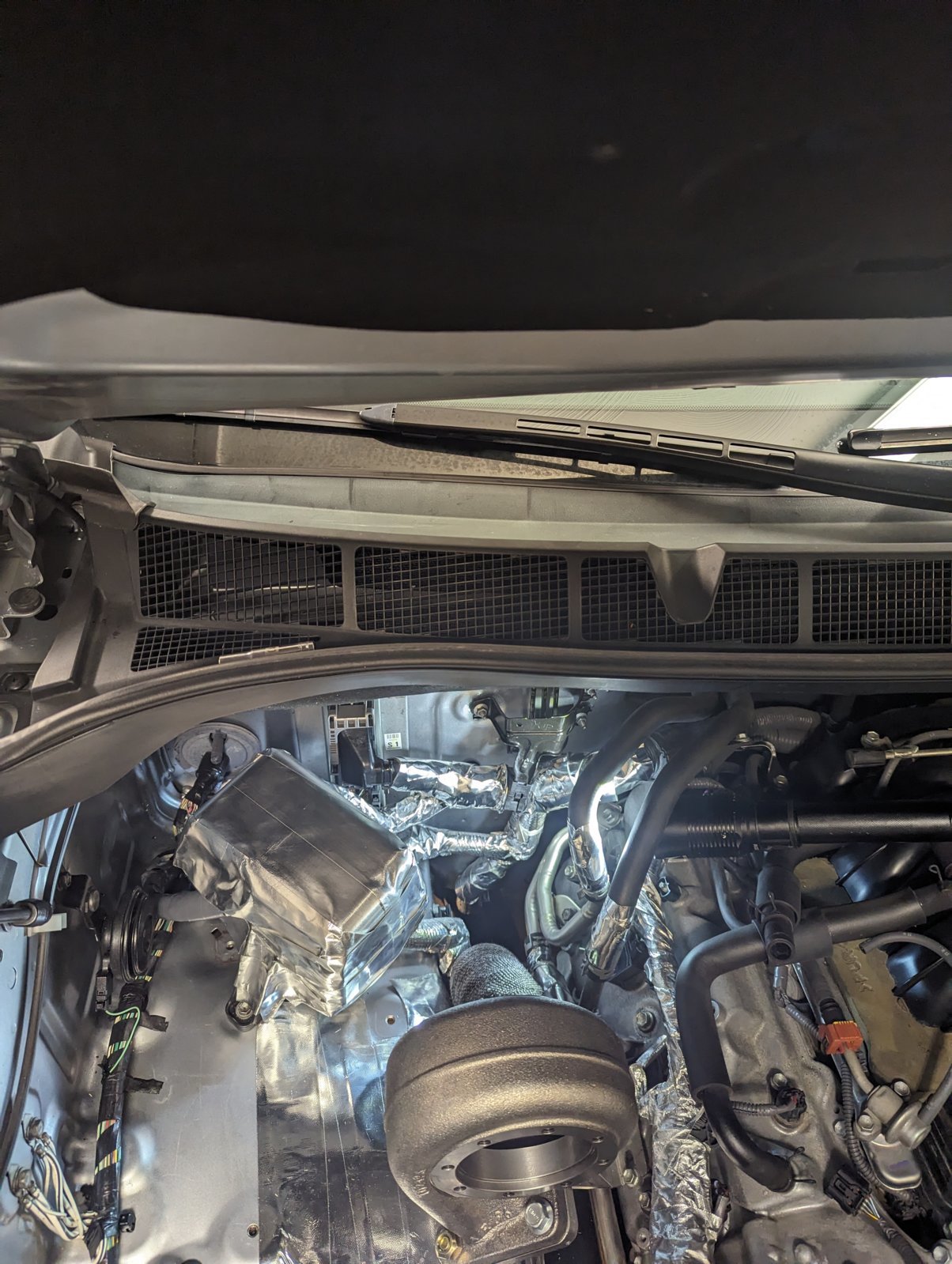

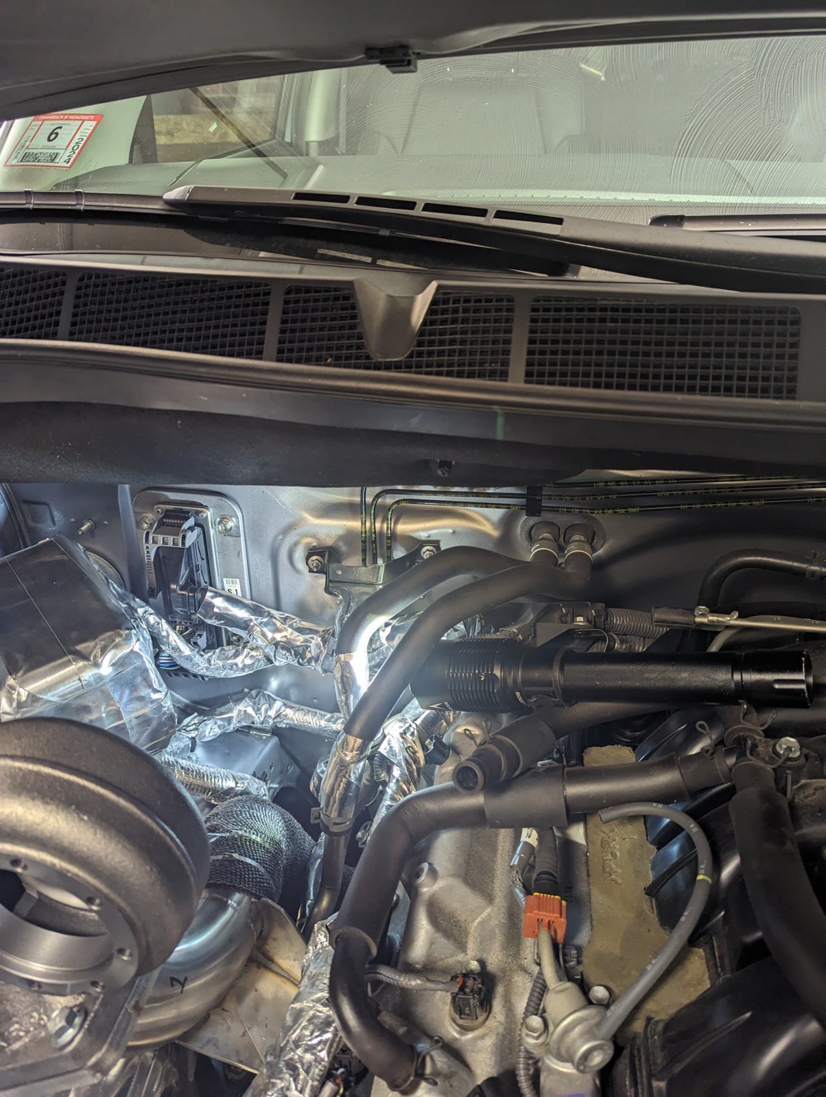

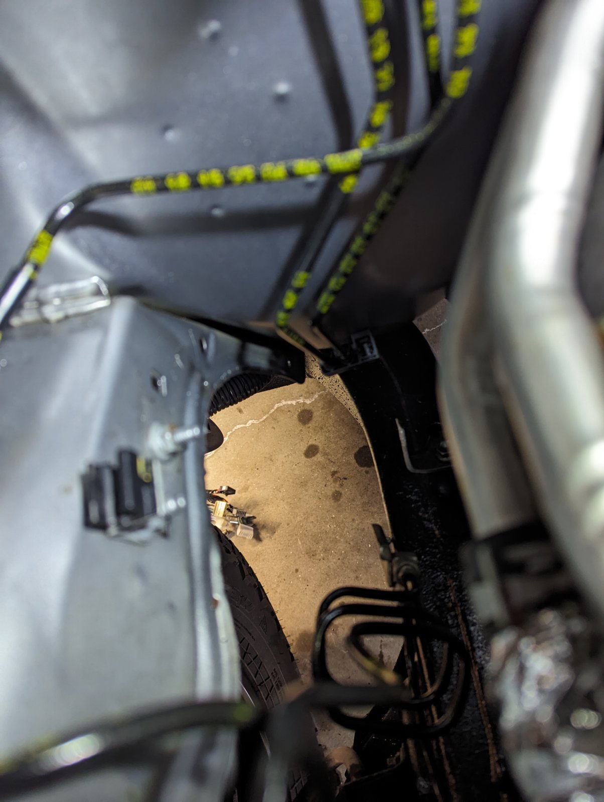

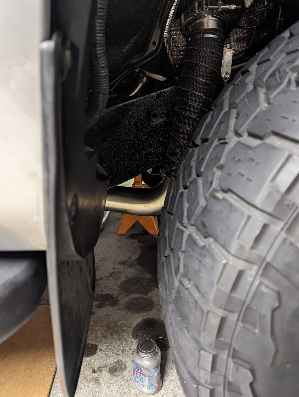

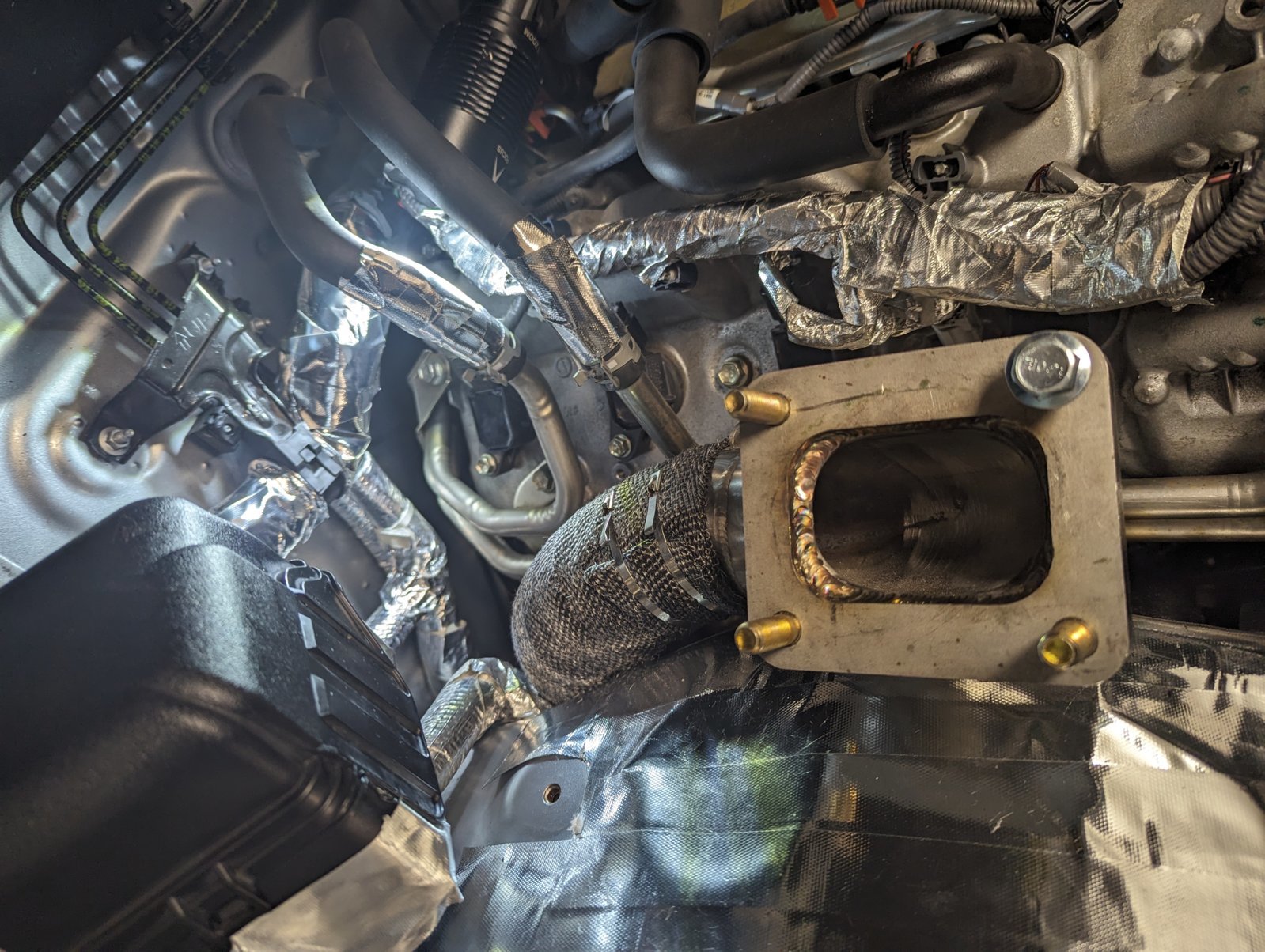

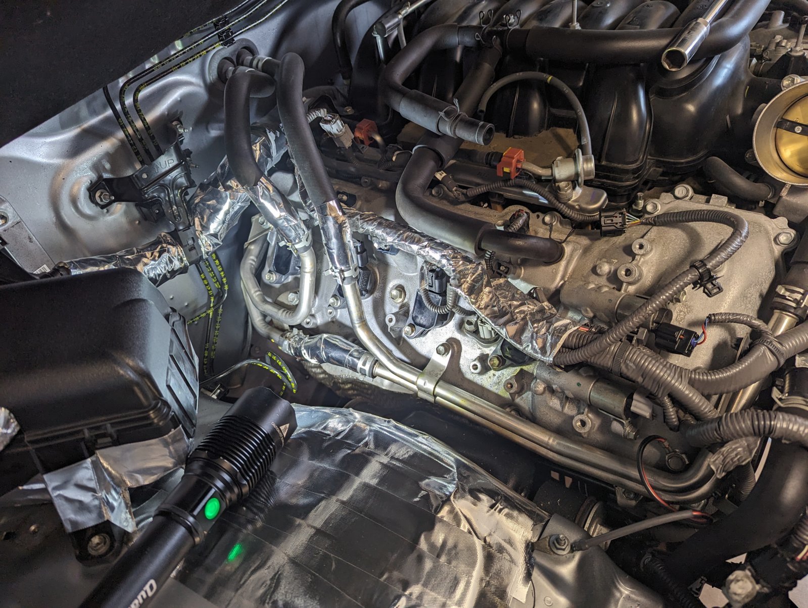

    Update: It's been a slow go on my part, so not a lot excitement to share at this time. Biggest takeaway is that my garage is about 6" too short to make parts of this as easy as it should be, but progress is happening regardless. I suspect it is like a remodel with the infrastructure and framing taking forever before it all comes together quickly. I did get to the point where I can start installing parts. For those curious, the cross-over, while loosely mounted, does hang just a tad below the front crossmember. I am not terribly concerned about it, as it is by ~1/2" and if it doesn't come up during finish install, I'll just add a small spacer to the front of the larger cat shield to clear it.
    My intention is to capture a few post installation temps with a focus on the crossover tube. I'll snag temps unwrapped without plates, unwrapped with plates, and then (if the temp increase by more than 5-10*), I'll wrap and get another number. These numbers will be captured while towing since that's what I care most about.
    Photos I think you all will care about, to include front driveshaft clearance as well as original spark plugs (ordered as if looking from front of vehicle).
    PXL_20240327_214033681.PORTRAIT.jpg PXL_20240327_214147143.jpg PXL_20240327_174227932.jpg

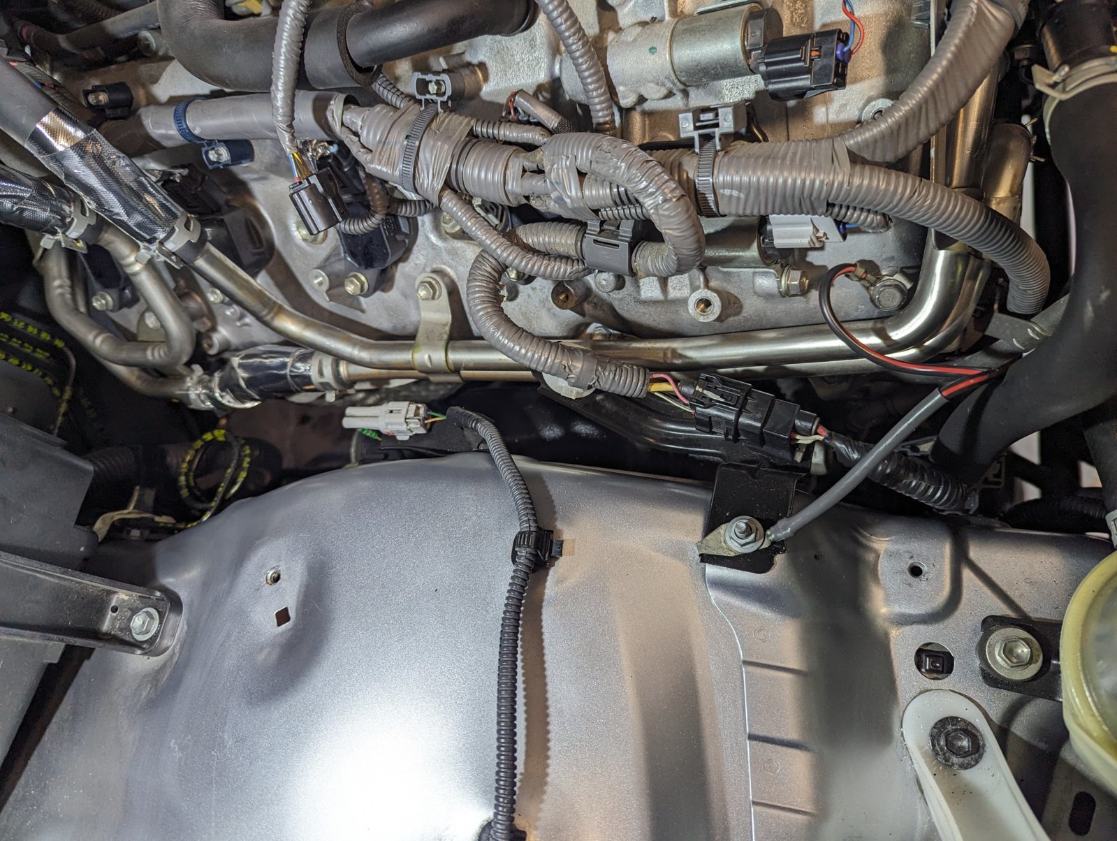

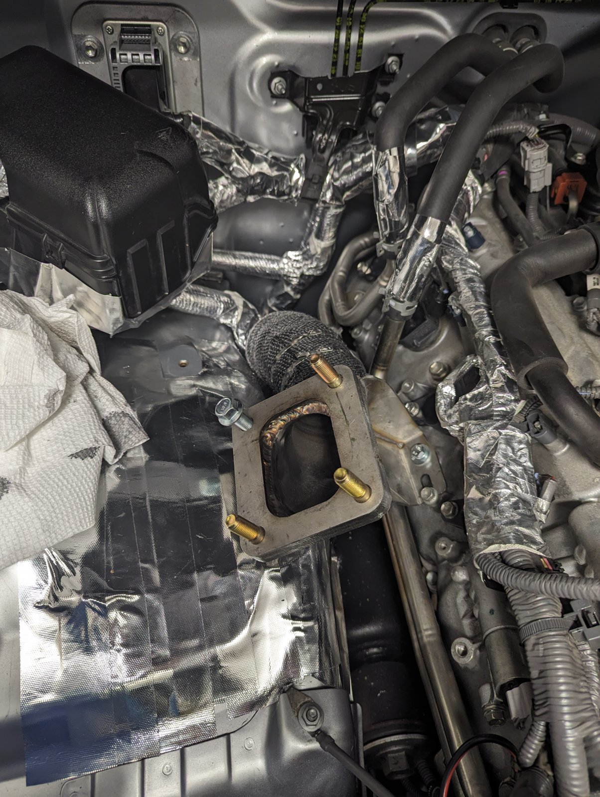

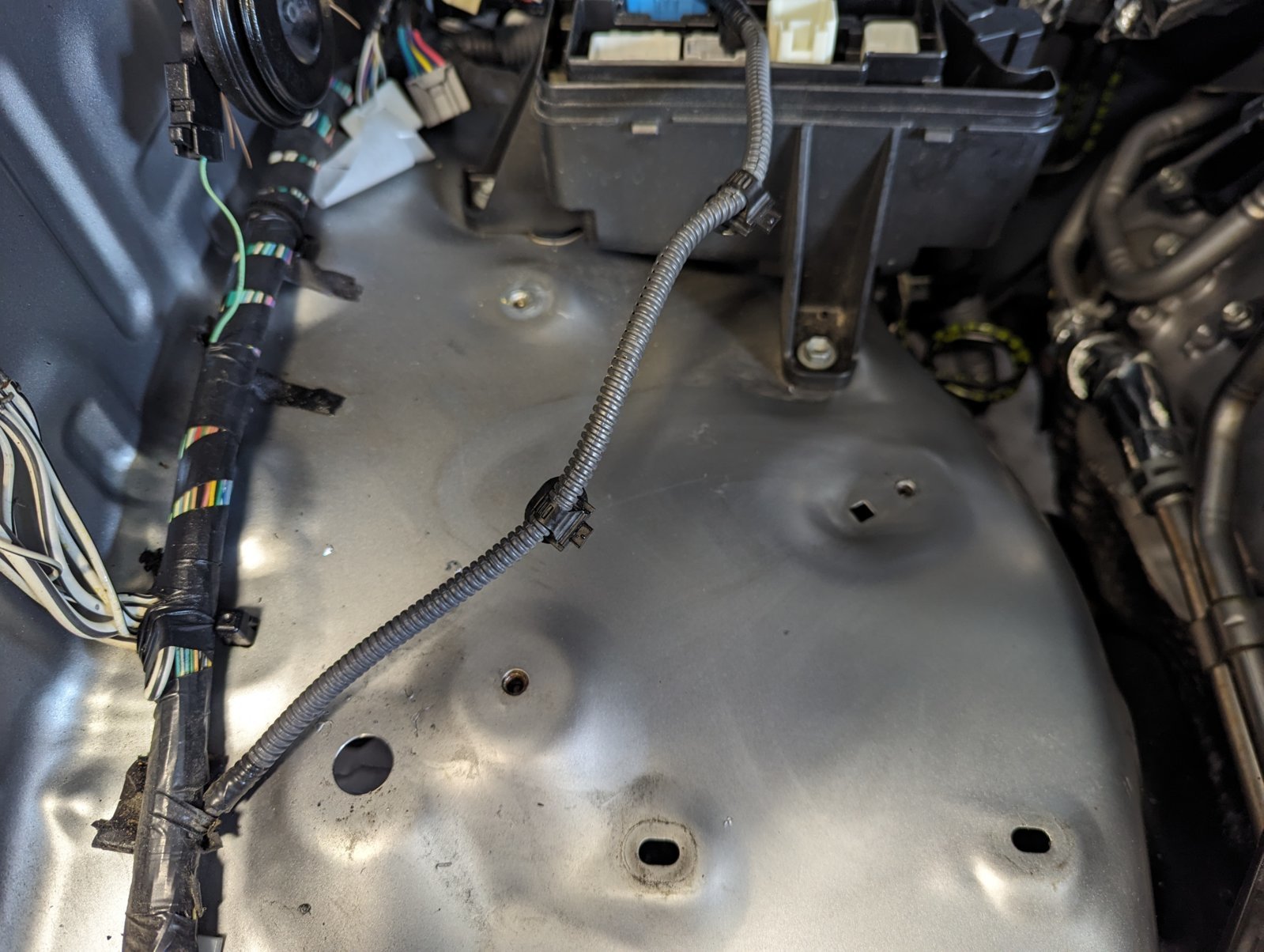

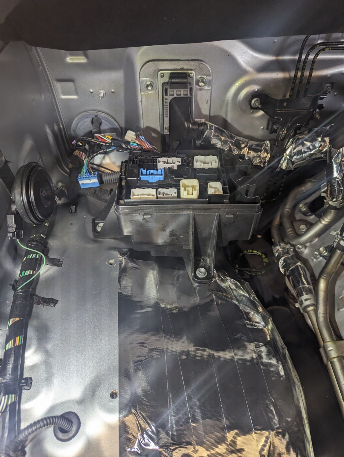

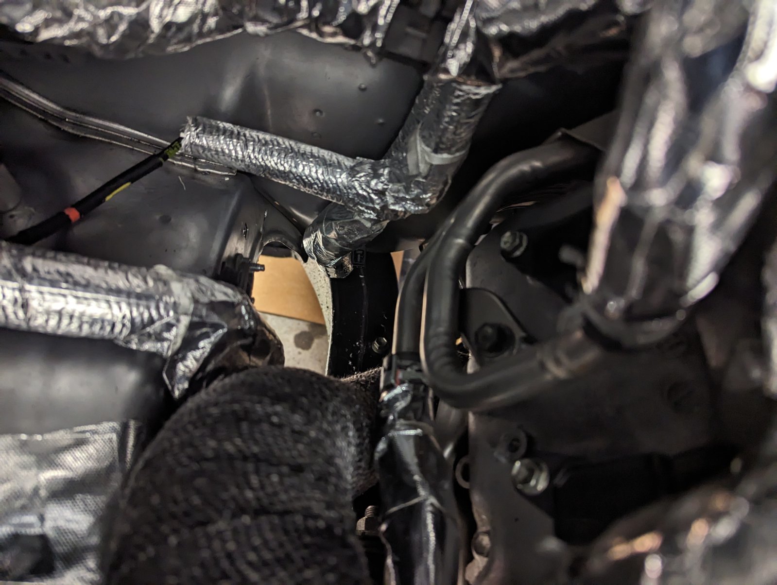

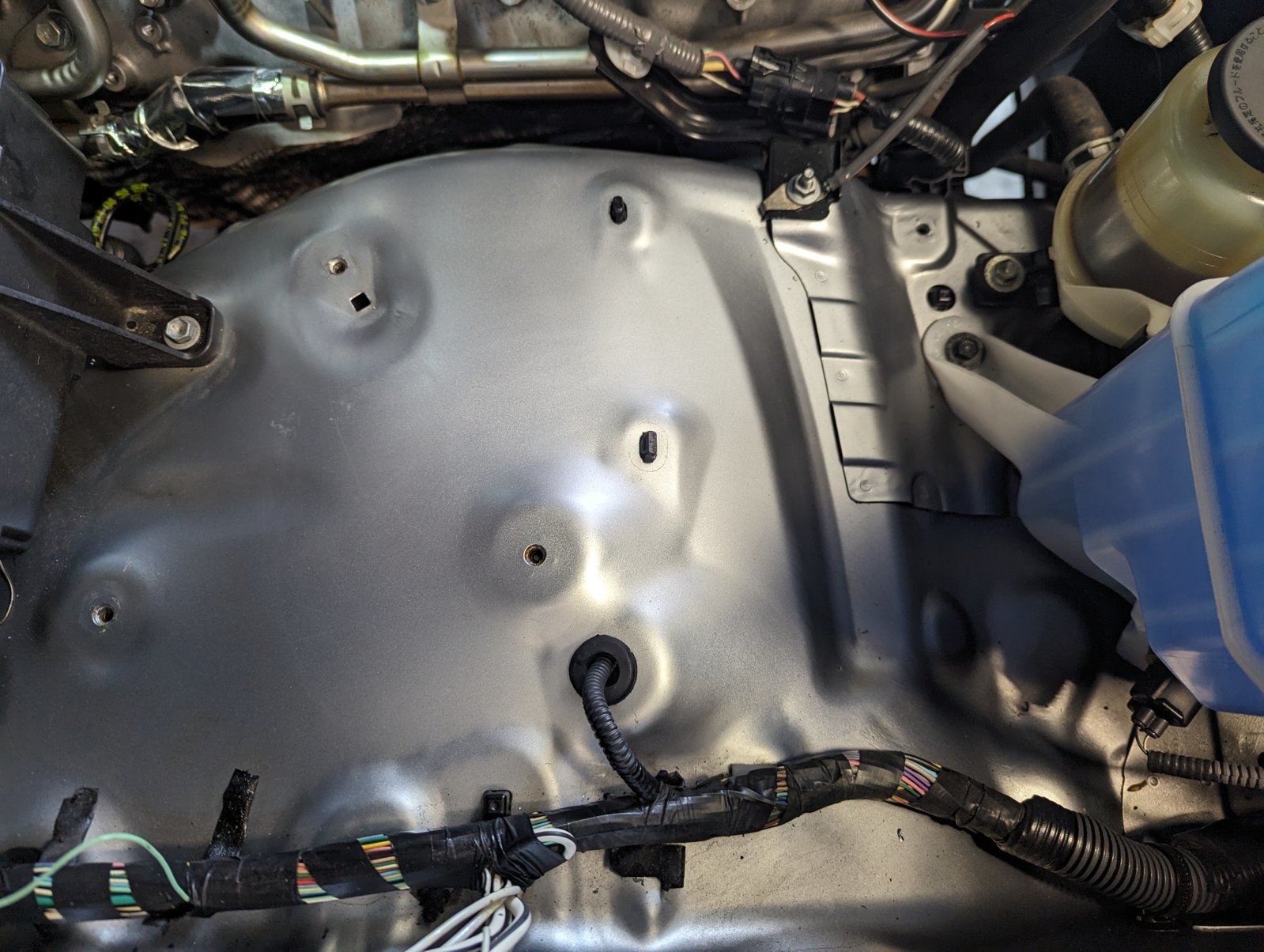

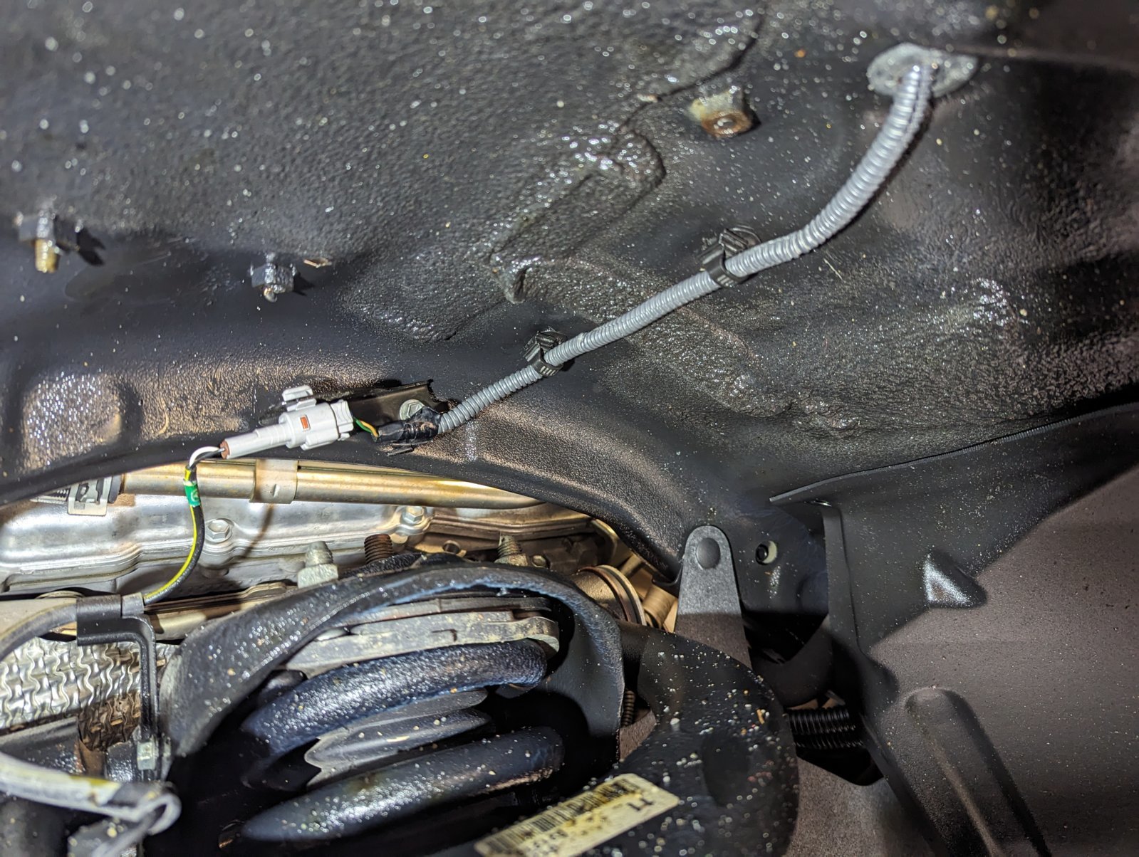

    I'll add more context to them tomorrow, but it's most of the prep to make room. Boring and time consuming, but, goal was to make it last and not look hacked. The only 2 permanent modifications have been painted with grommets added and factory clips reused where possible. The tape isn't exactly my best work, but the garage is also 55* and a heat gun worked miracles. Too bad I didn't think of it until halfway through. Appears I missed photos of the heat wrapping, so I'll get that on the downpipe install.
    The amount of Dawn Power Scrub, paper towels and gloves I've gone through because of this undercoating is rather alarming. I'm glad to be mostly done with that aspect. Bolting in new stuff is much cleaner.
    A little reminder not to start the vehicle
    Oil pan drilled for oil return - location was critical because I didn't want to clearance the pan and there was just enough space to clear it and the hose. Dry fit is key.
    Not much room for tubing but figured I'd share the photos since not everyone drops their catalytic converters.
    Speed sensor plug and wire relocation reusing factory clips. The hole had to be expanded by about 3/8". Painted and grommet added.
    Heat tape added to all areas likely to see increased heat. I was aggressive with it since it won't be too noticeable against a silver vehicle. Also had to pivot the box about 30* using existing holes. The spacer on the back leg was just a 1.25" spacer and a longer M6x1.00x70mm bolt to accommodate. Box sits flat. Can also see the start of the taping of wiring that didn't have thick looming or might be near increased heat sources.
    Instructions called for slight modification of the bottom lip of the inner fender. I found it is best to use an adjustable wrench from inside the wheel well and gentle bring it outwards. No cutting, no hammering and can be bent back if ever needed.
    Progress on the heat taping after the plugs were done. Started on the box but need to figure out how I want to handle the cover (individually wrapped or wrap it all as one and deal with it when/if I need to access it). I also wrapped the "hook" in the middle completely (unlike the photo shows).

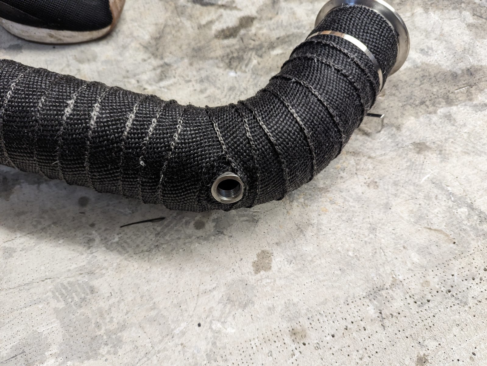

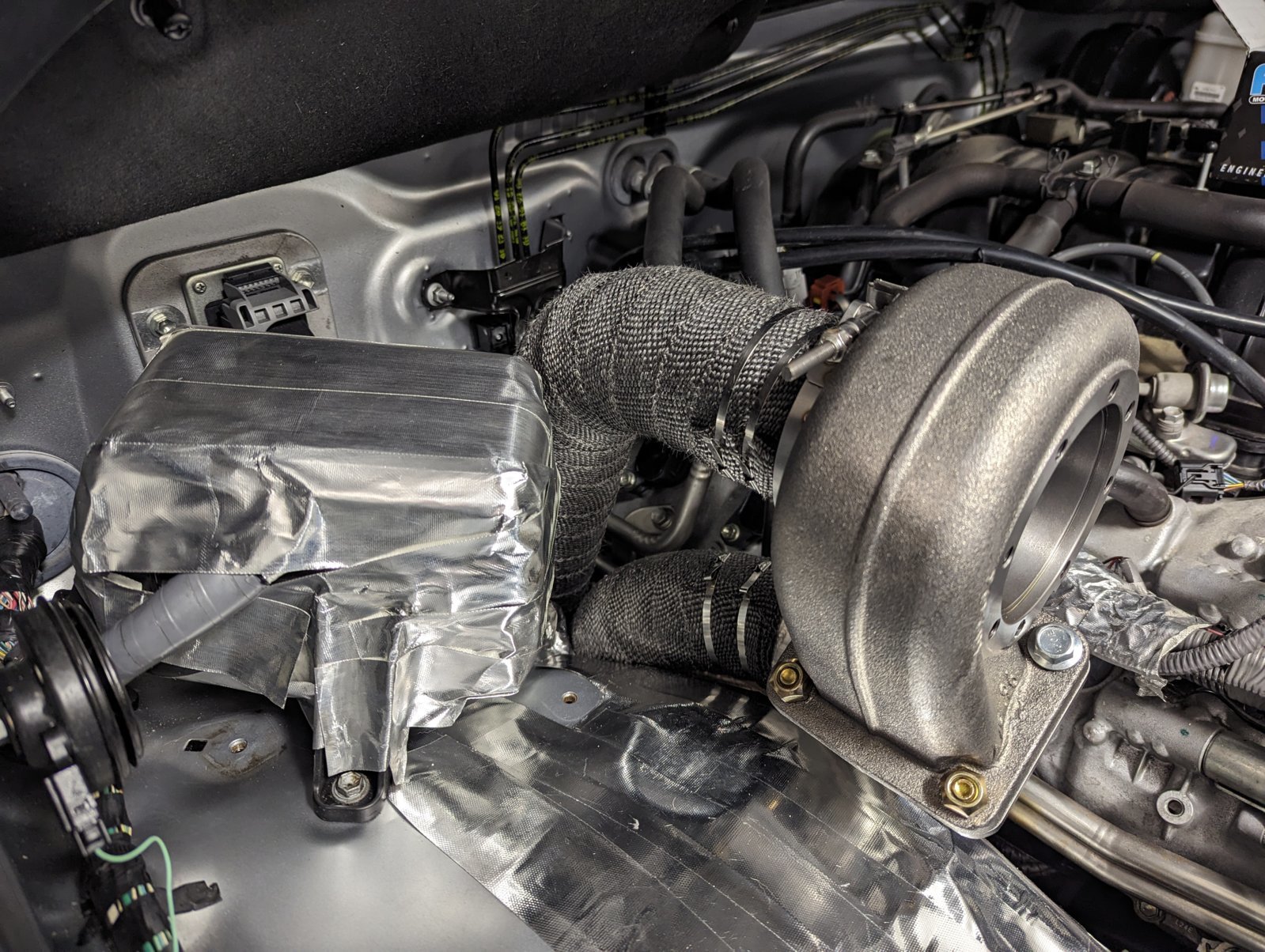

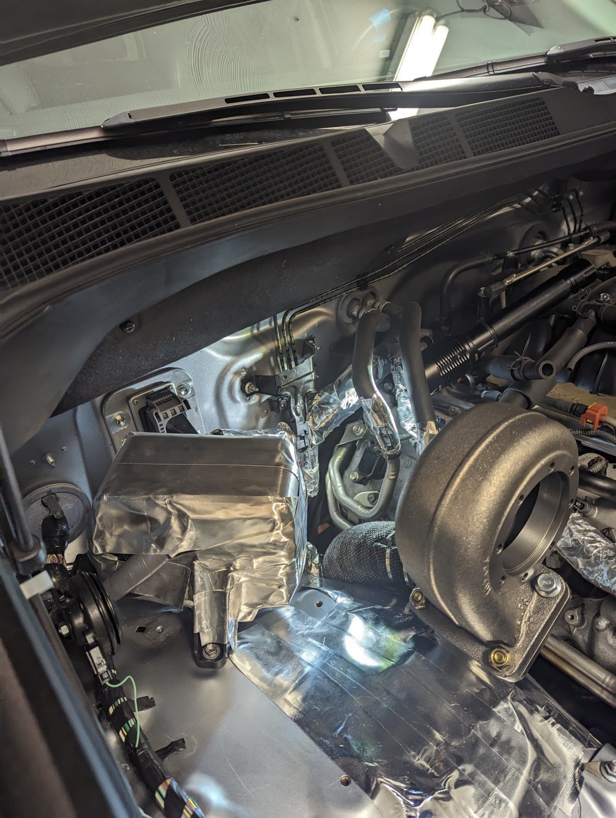

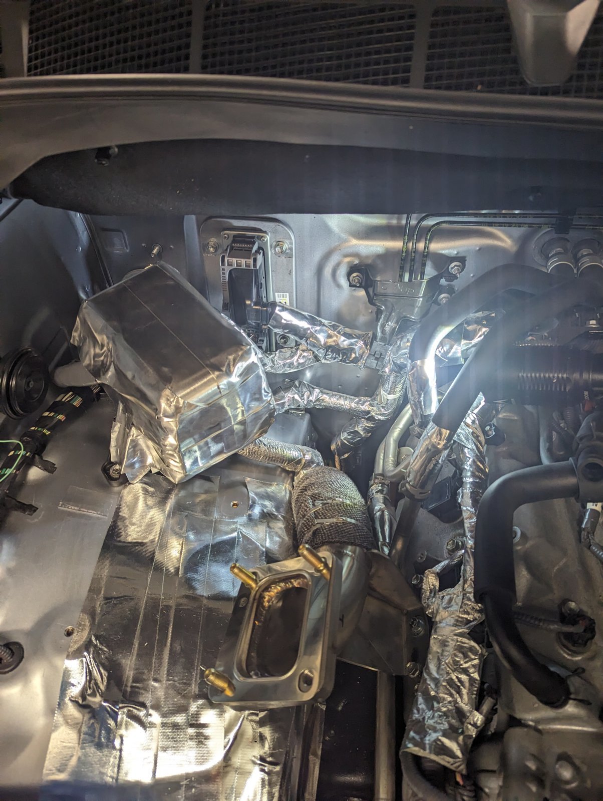

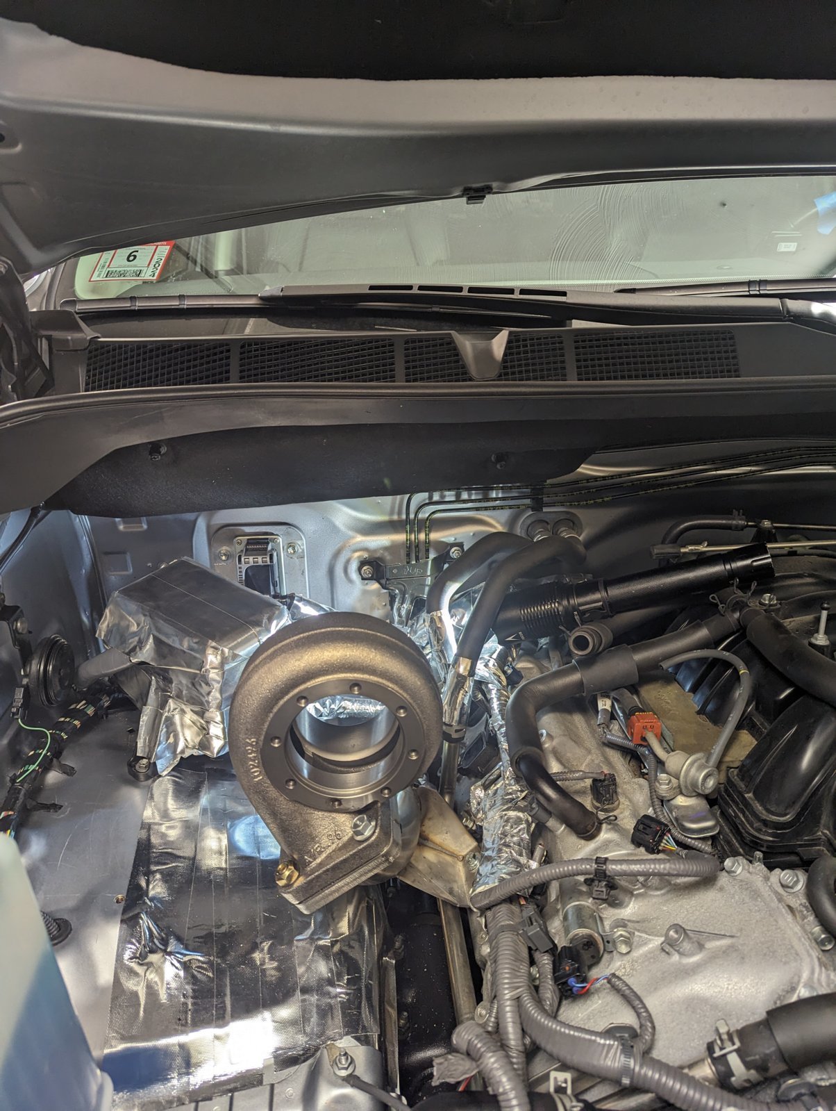

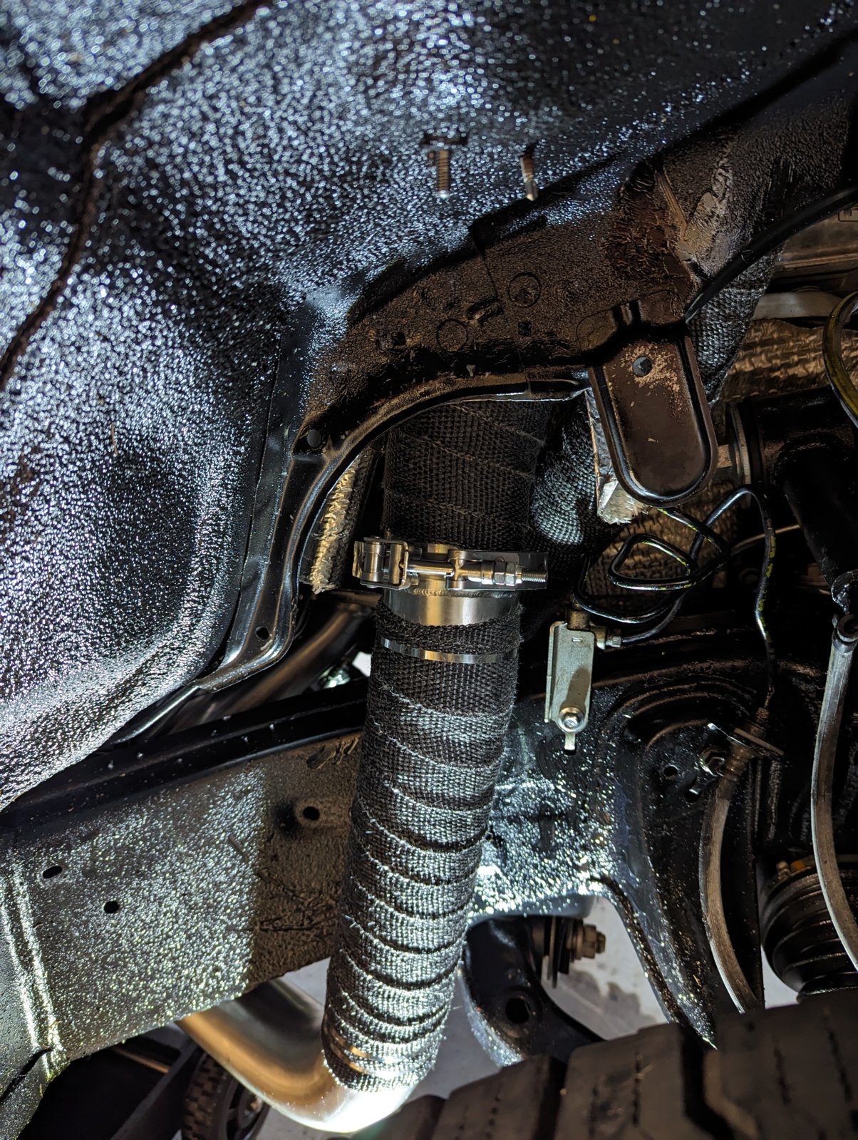

    It was a trying day today but only because it was a lot of buttoning up heat protection and then redoing things I apparently failed at the first time, specifically, banding the heat wrap. :mad:
    Looking forward to some good progress over the next couple of days.
    Photos. I despise the heat tape. Be gentle on the judgement of that part. :crapstorm:

    The tape is part of the kit, but not exactly to the extent I'm at.
    Where they said to put 2 or 3 strips, I put 8 or 9 (e.g. inner fender). The brake lines on the firewall are a new add and just a precaution. It is an insulation wrap sealed at the joints with heat tape, but they're both reflective finishes
    While this is all likely severe overkill since I have the turbo blanket as well as the wrap on the tubing, I'd rather exercise caution since it will be primarily used for towing. Ideally there won't be a noticeable increase in temps, but while I had easy access to it all, I decided to suck it up and prepare for the worst.

    Thank you! I know tape and chrome looking wrap everywhere may seem silly to some, but for me, right now, it's the right call. I do look forward to seeing the data points post install.
    I do also wonder if there could be a better option than just tape for the majority of it, but that's not in my wheel house.
    A bolt in, pre-coated heat shield containing the hot parts would be fabulous and a whole ton faster. Probably a whole ton more $$, too.

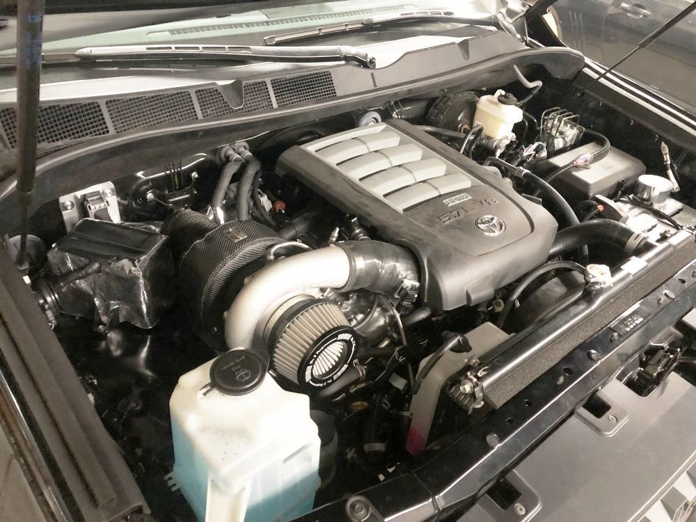

    Would the kit be able to accommodate moving the turbo up closer to the hood? My thought is if it can go slightly higher it might allow for more flow underneath it? But if it gets too close to the underside of the hood what’s the point in sacrificing one heat issue for another.

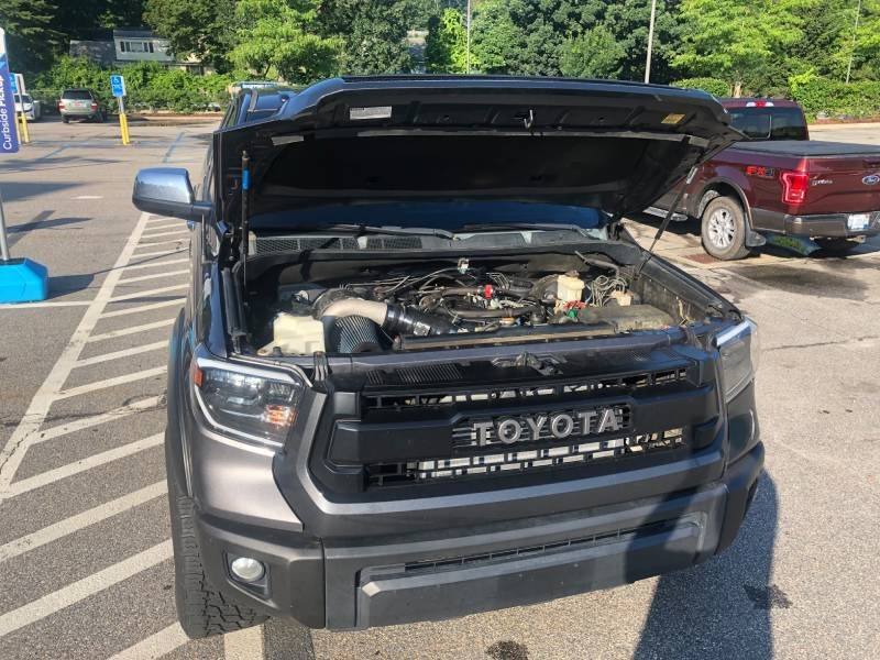

    The filter on 2021 in the above picture is an older filter we were testing, we ended up using a MUCH larger filter with a front open mouth to allow more fresh air through the front grill opening. So there isn't any room to move the turbo forward now. And with how the head expands for the cam gears and the fender comes in closer to the motor, there really isn't any additional room anyway.
    Here is the new filter:
    Yes, we have an extreme black thermal coating we have done on all of our other kits. We use a company in CT called Central CT Coating. The owner is a chemist and doesn't use off the shelf coating, but mixes his own. Been working with them since 2005 and the stuff is beautiful and works. We will eventually offer this option, but have to do one at least to get the pricing right. We are thinking we would offer Upipe, Turbine Housing and 1st Section of the Downpipe for about $400 and then Cross over pipe and second section of the downpipe would bump it to probably $600 or so.
    Here is what it looks like on our other kits!

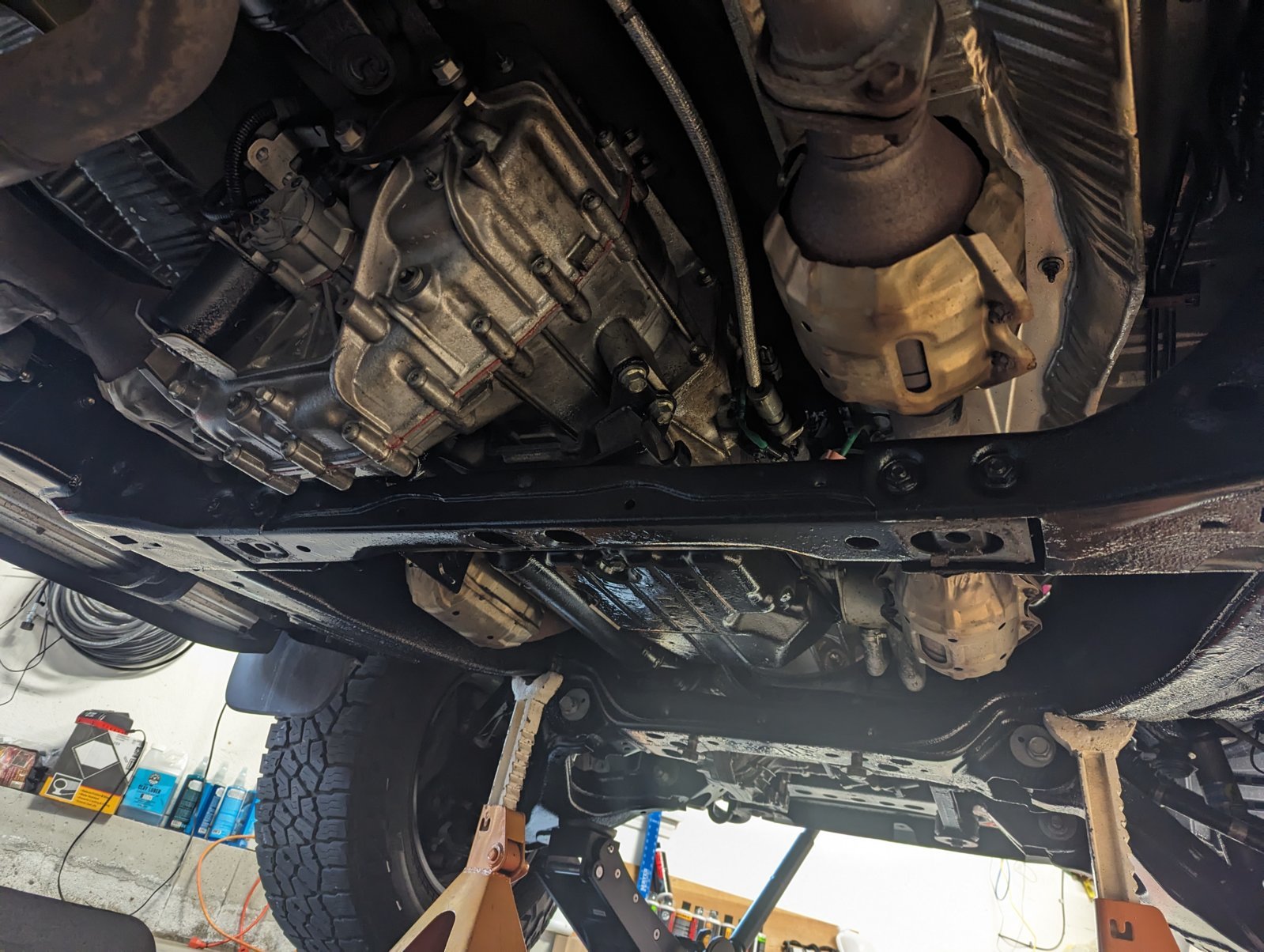

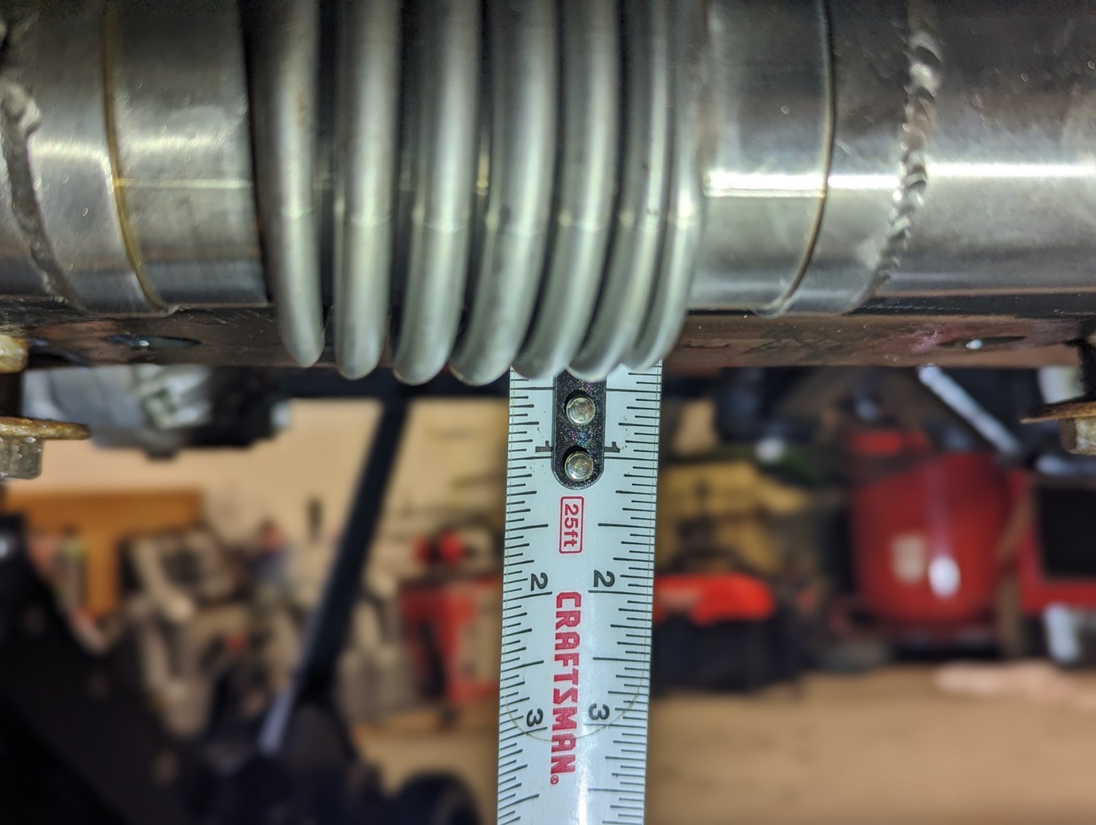

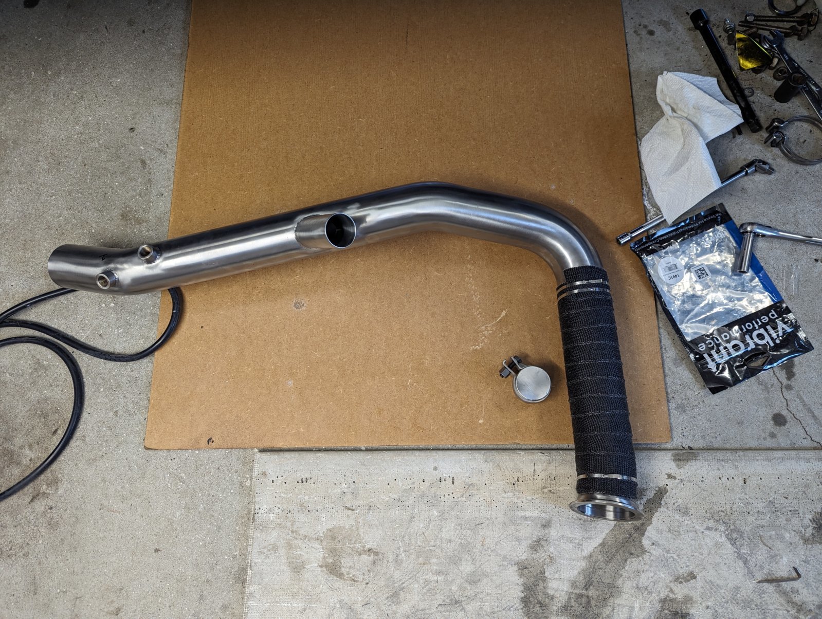

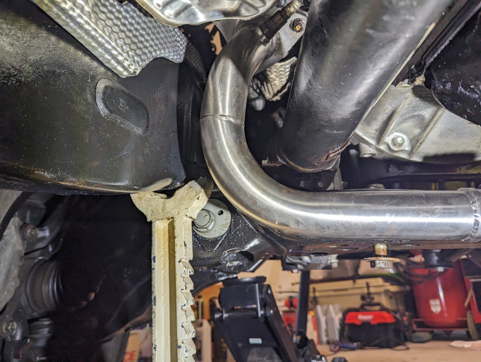

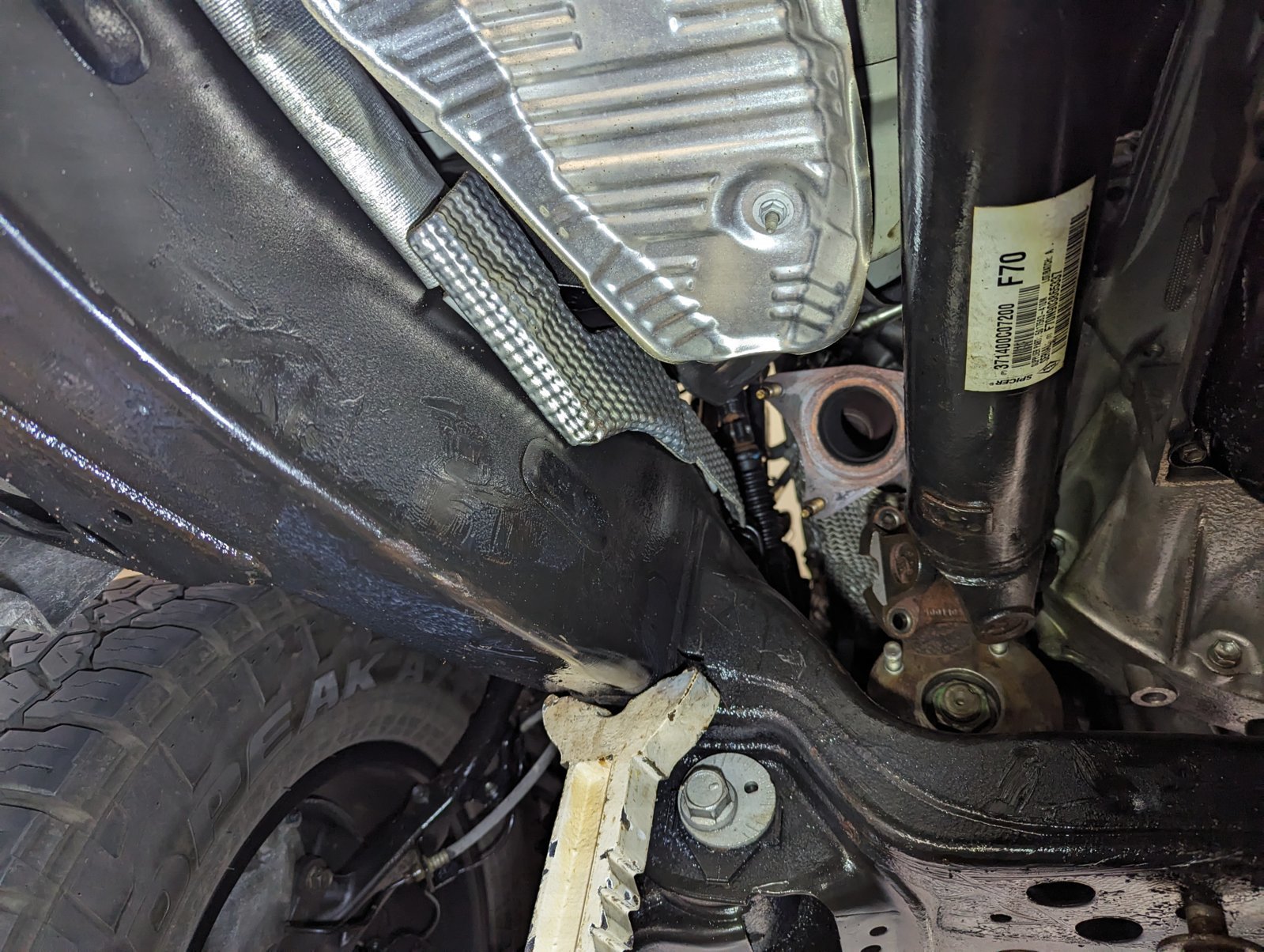

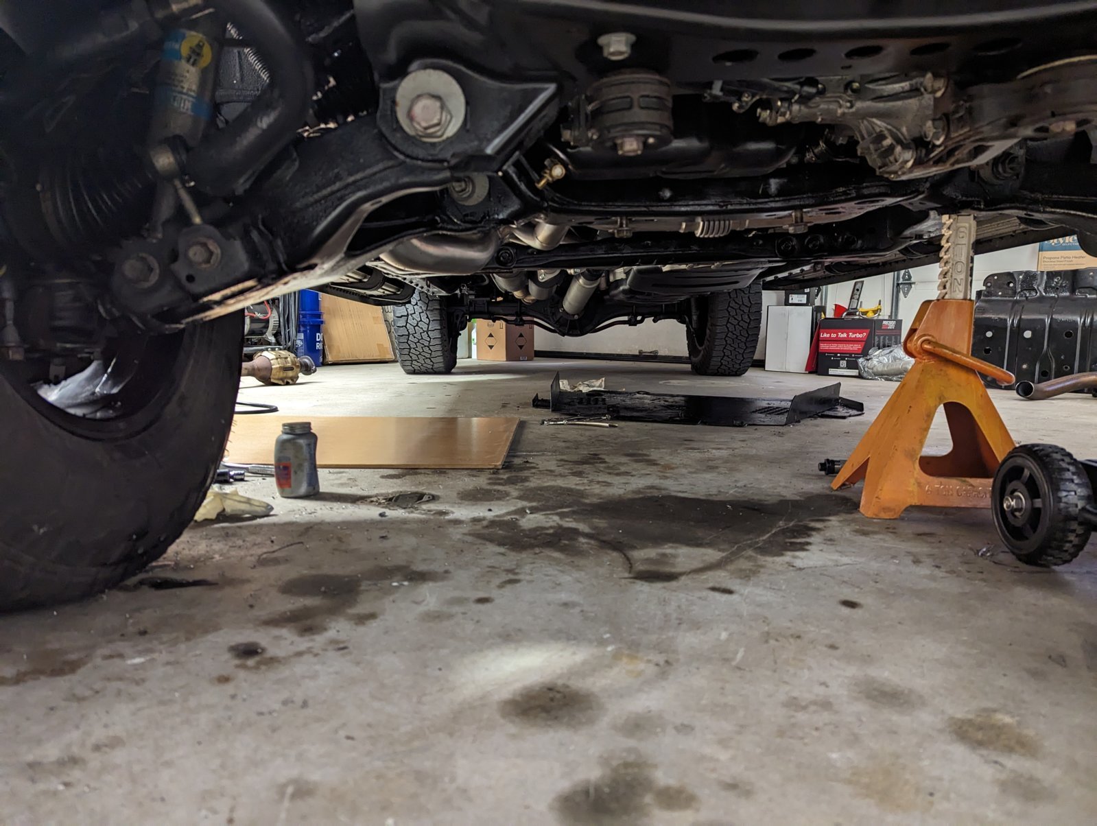

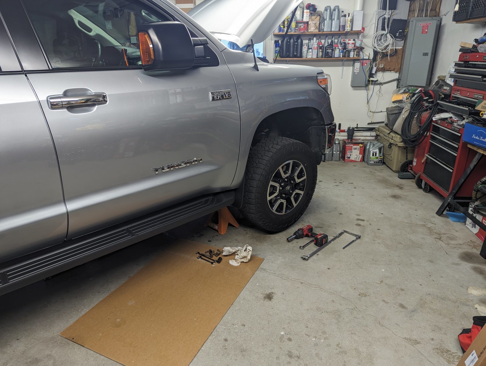

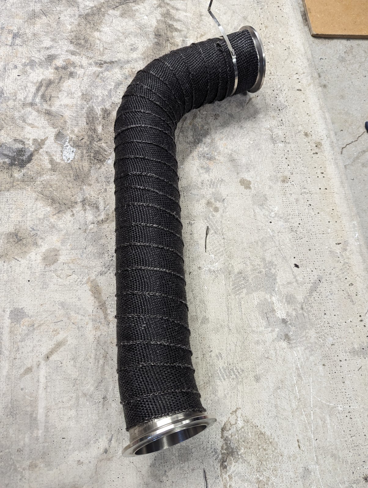

    Just a little bit of progress today due to personal obligations that aren't this project.
    Downpipes are wrapped and installed, everything's torqued down, and everything not in the engine bay is connected and done AEM injection kit excluded). I opted to wrap the "external side" of the downpipe as well since I had extra wrap and because it is a close fit. Figured it was cheap insurance for just the part outside of the frame that is non-traditional routing for an exhaust. I'll get more/better photos tomorrow. I know there is question about the downpipe and I'll take photos of it with a tape measure similar to the other shots.
    PXL_20240329_143437564.jpg PXL_20240329_203558861.jpg PXL_20240329_212027190.jpg PXL_20240329_231622392.jpg PXL_20240329_231701692.jpg PXL_20240329_231711830.jpg PXL_20240329_231642131.jpg

    Great picture from that side under the truck. It clearly shows it's well above the lower control arm and just about flush with the cross member!!
