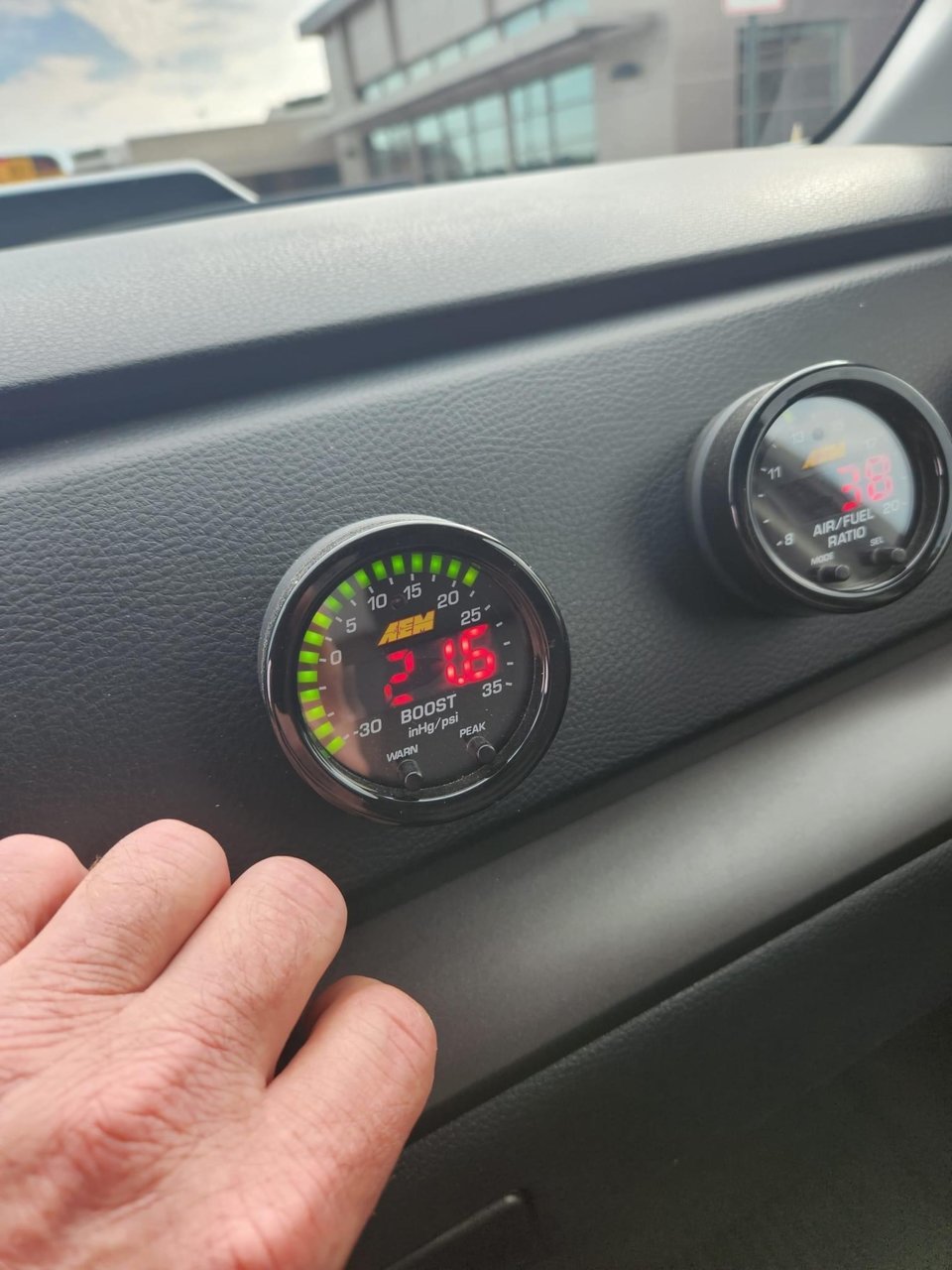

    Good things happening with the Tundra. Tuning should be wrapping up shortly. :)

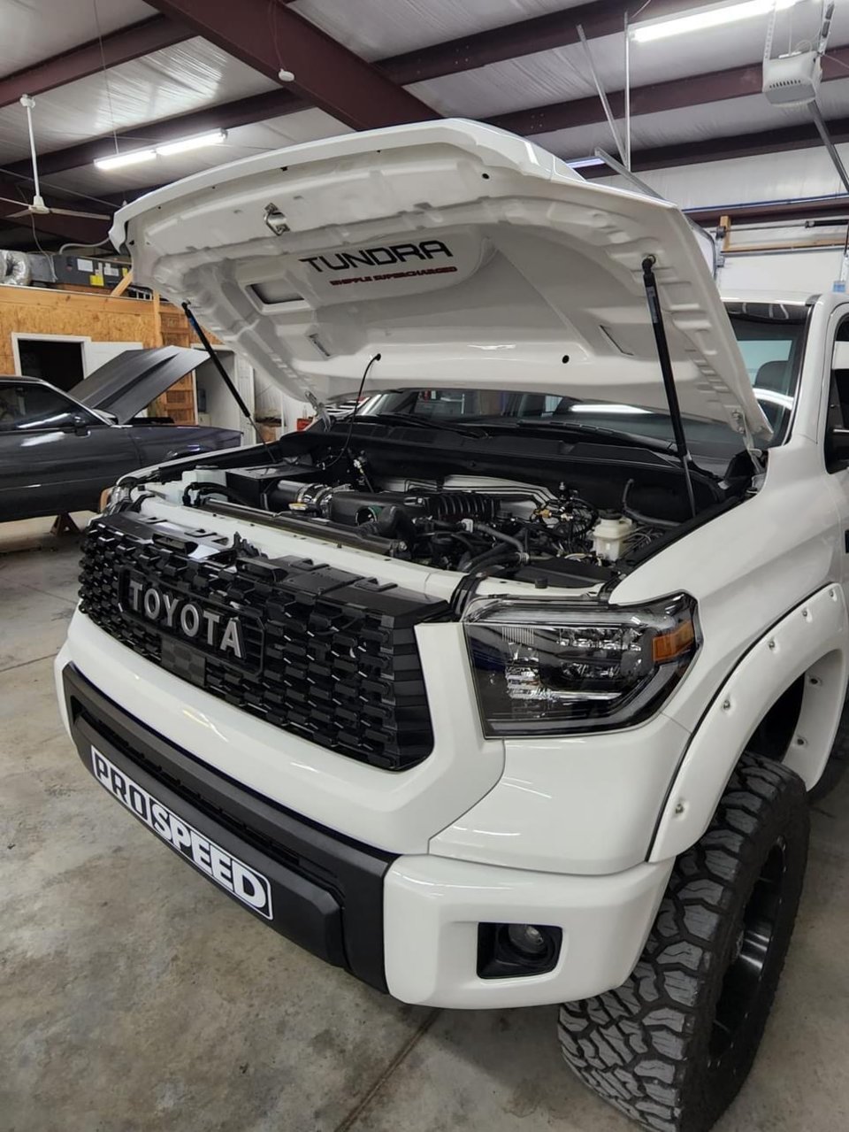

    That’s interesting that the MAF voltage was exceeded. The Prospeed builds I had seen that are pushing around 20psi making 700+whp all use the Prospeed 4.5” intake and don’t have that problem that I’m aware of.
    Saltyhero13 and M3Tundra-JK like this.

    Unfortunately the one place that Toyota screwed the pooch on this platform, there is no back up MAP sensor. The GM guys with HP tuners, can completely remove the MAF and use the factory MAP sensor to convert to speed density. There is no way to do this within the factory ECU tuning parameters that we know of, since there isn't a map sensor on the motor and no provisions for one in the ECU mapping.

    Unfortunately I don’t have a link with a ton of details since it’s on FB, but the one build that comes to mind belongs to Bryan Jones on the boosted tundras page, if you join and search. That one is a Whipple build. The other 700+ build was a Harrop owned by Brent. I believe so, but those high HP builds also use a Motec ECU I think.

    I LOVE that hood. Would be perfect for the Turbo setup. Would also be really cool to see the ram-air incorporated into an open top air box, that is completely sealed when hood is closed.
    @TurboKits.com should put it as an option on their site and drop-ship it from the manufactures :monocle:
    Saltyhero13 and Silver17[QUOTED] like this.
