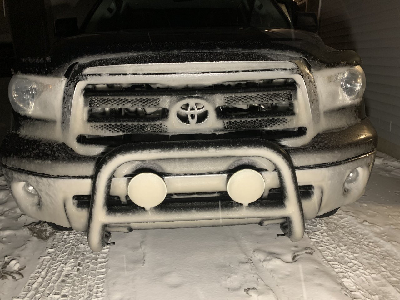

    Not an uncommon look around these parts… over an inch thick in some spots from a few hours driving home and had been like that for at least an hour. Just putting that out there as the other extreme.

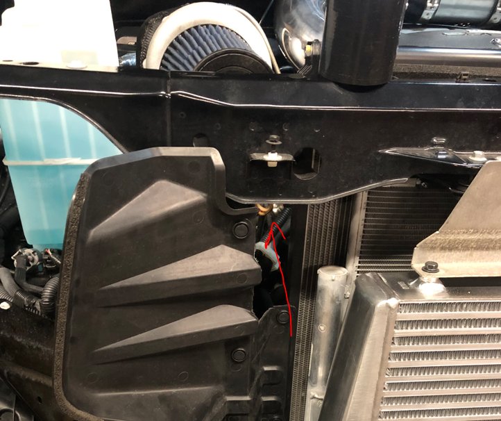

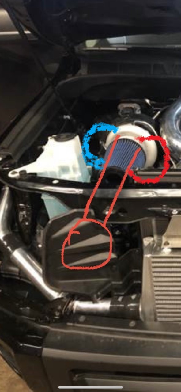

    If you’re referring directly to my charge air cooler, supercharger intercooler is a separate circuit entirely from the engine coolant. There’s an intercooler brick inside the blower for heat absorption and a front mount intercooler mounted in front of the radiator for heat rejection. The air is never more than 30-40 degrees over ambient entering the cylinders even on a WOT 1/4 mile pull (in fact it drops in temp at WOT in all of my data logs). I monitor it at all times with a scangauge.
    On the contrary, pulling air from the engine bay will be bringing in air that is already heated 50+ degrees over ambient before it ever even gets compressed through the turbo. The Richard Holdener video I shared in post 290 can better explain the impacts of an HAI better than I’m capable of if you’re truly interested. We don’t know the costs yet, so it’s hard to comment on that. I see there is no sense in discussing it any further in this thread, but just responding to your message in reference to my IATs.

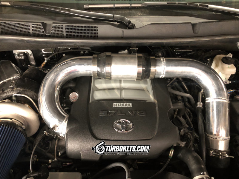

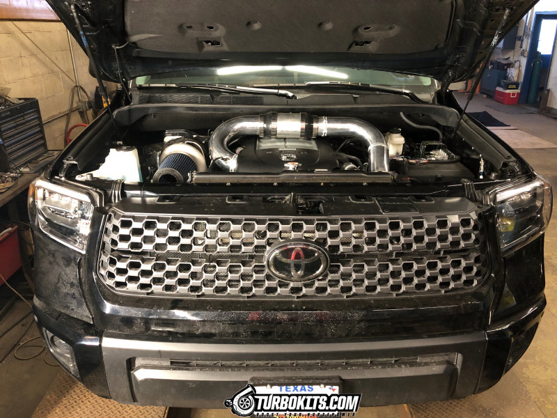

    Stage 2 Installed and ready to tune!!

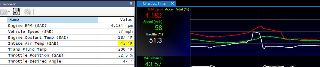

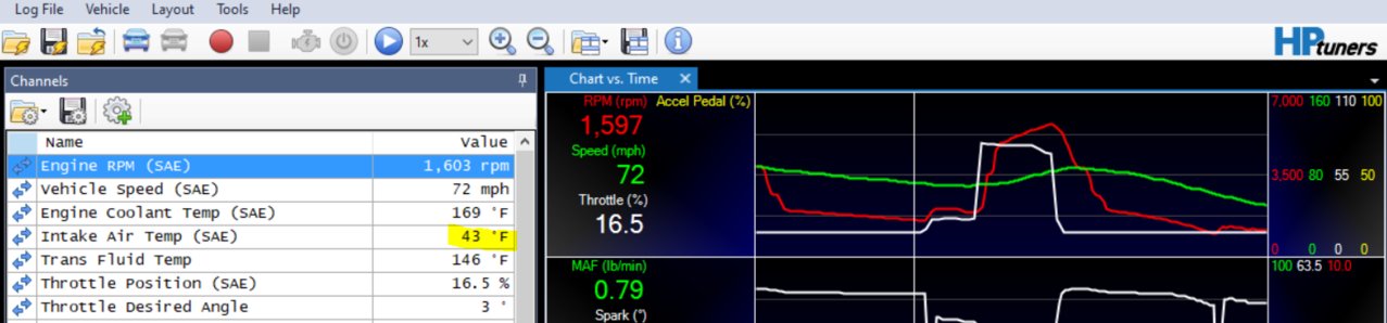

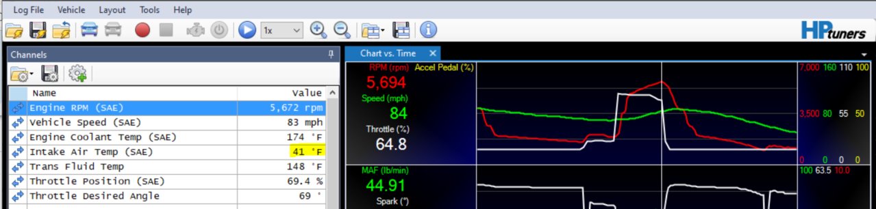

    In regards to all of the questions about IATs... Here is a video we just uploaded, it's technically 2 videos in 1, one about 30min into the drive and the other about 60min in. The drive totaled about 1.5hrs including back roads, stop and go and highway. It was 45* outside (+/-1-2*) and the highest I saw for IATs sitting in a line of traffic that took 3 lights to get through, was at a delta of 10*, so 45* outside temp, 55* IAT. For the most part, it was only 1-2* difference. The IAT / MAF sensor is AFTER the intercooler, but before the water meth nozzle.
    Here are 2 HPT log screen shots of a quick blip boosted run, still only 3ish PSI, as we are dialing in the tune now for stage 2 and higher boost, but you can see the first pic is where IATs started while cruising and then the second pic is what the IATs where at the top of the run, again, it was a short blip. Since this is such a hot topic, we wanted to get as much info out as fast as possible. Once we have the tune dialed in better and are running higher boost for longer duration, we'll post more info. We also realize this doesn't answer the towing / prolonged boost question yet, but we will get there.

    About what I expected. Intercoolers do a great job. Throw an IAT sensor in the pre intercooler pipe and that’ll really open some eyes.

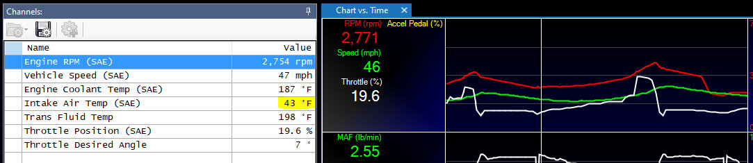

    Some more IATs, this was after about 3 or 4 boosted logging runs (by the way it feels amazing). It's about 30* out this morning, but here is the great thing, cruising 43*, boosting 41*... :thumbsup:

    Those iat deltas are better than my open filter cold air intake that’s right next to the fender.

    What PSI was it pushing for that little stint? Is that a 3psi pull for 3 seconds at 65% throttle? Looks great for low ambient, low boost, quick throttle stabs that won’t actually generate heat to contend with. I want to see the IATs on a 10 second sweep WOT dyno pull with the hood closed. Can you record that when you get the stage 2 on the dyno?

    These were full rip, 3ish PSI runs. We have not engaged the boost controller yet, still early in the tuning process. If these logs look good, which I suspect they will, hopefully more boost next time. In regards to the runs, they were about 2.5K rpm to redline, not part throttle stabs. Yes it is low boost, honestly, so is the 7-8 PSI we are targeting for the kit, but this has been such a hot topic, we wanted to post all info we can when we can...

    Intercoolers are great! Also, the water meth is bringing it back down to at least ambient if not a few degrees colder!!
