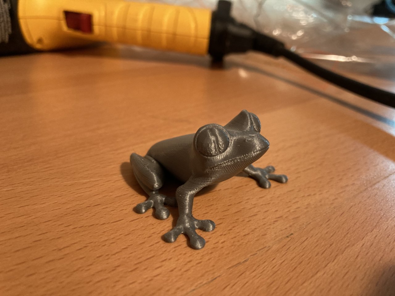

    Printing frogs n’ shit :rofl: (test prints for calibrations)

    Nice! My mother-in-law loves frogs.

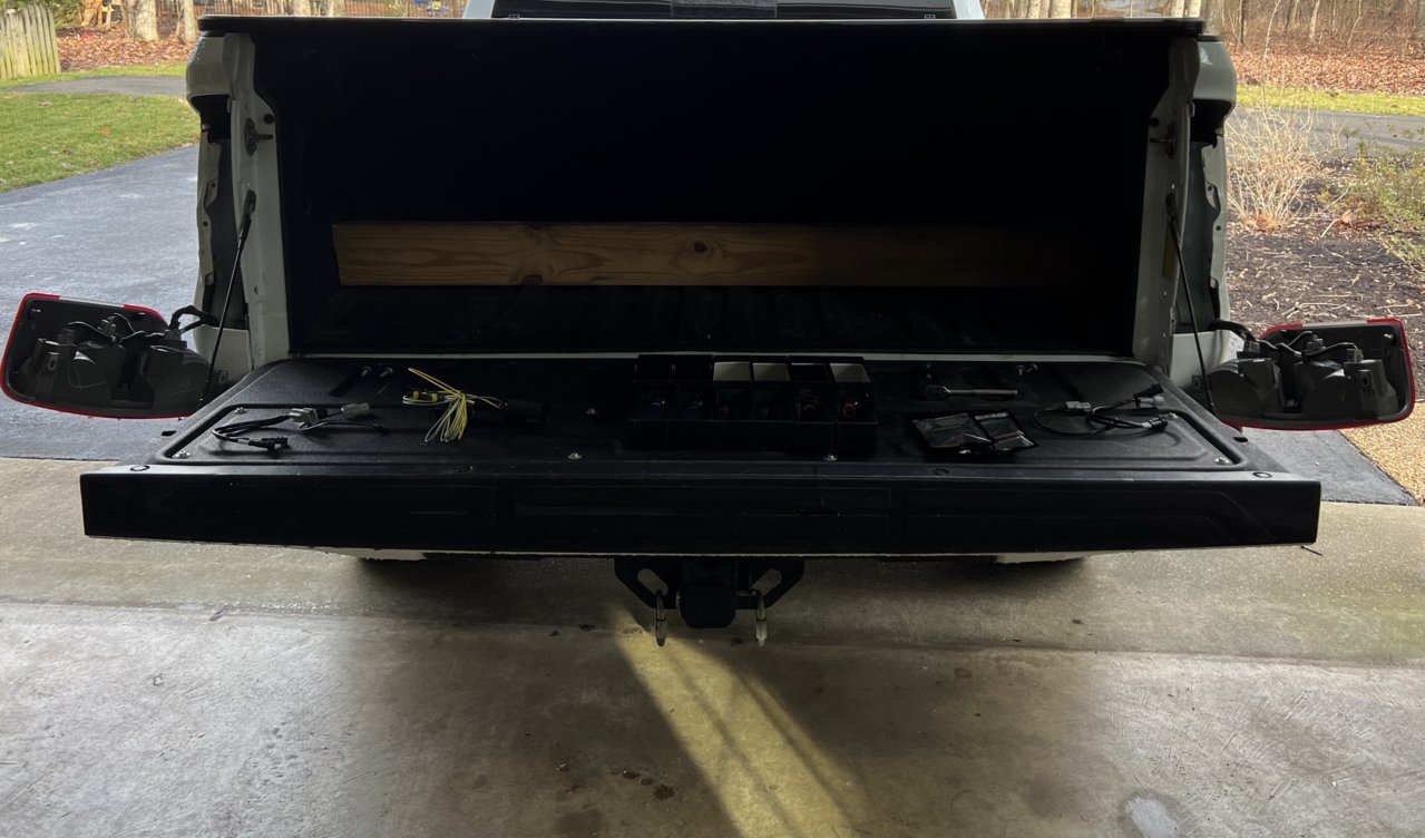

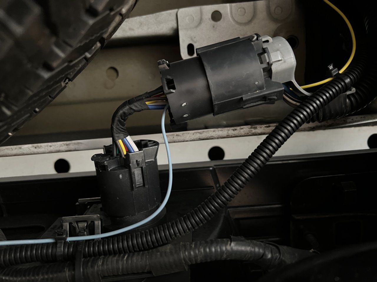

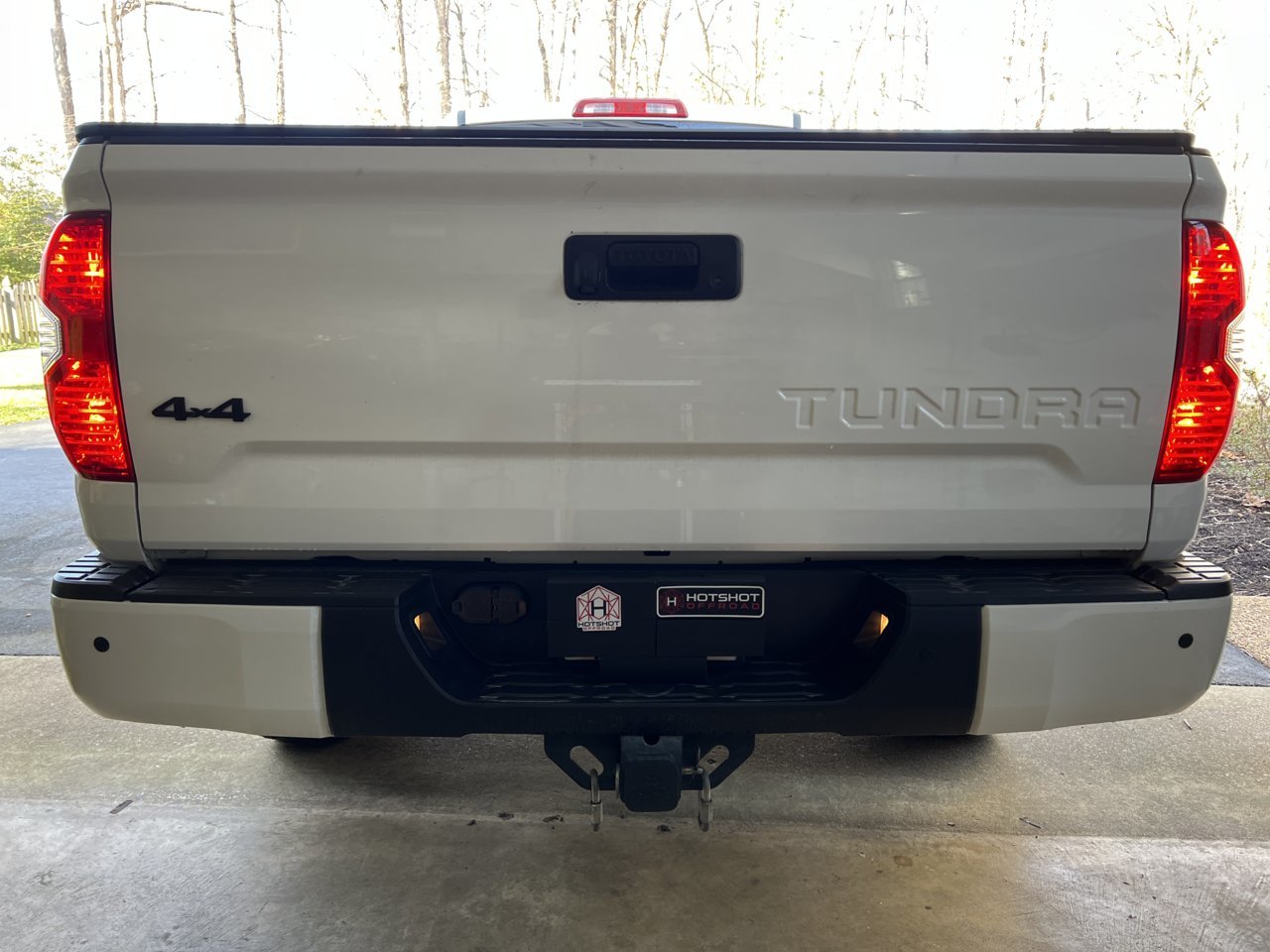

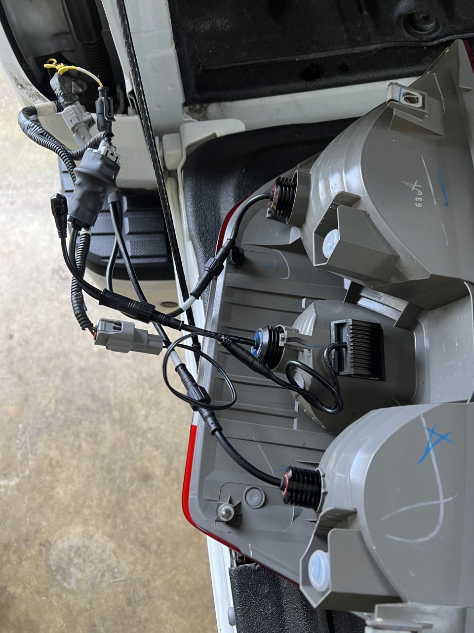

    Option B.
    Simple straight forward install and now extremely please with the end results!
    If there was a hard part it would be getting under the truck for the trailer harness adapter and zip tying the wires up under there. But it still only took just a few minutes.
    It looks great and appears OEM, you'll only know something is different if you know ;)
    I think I captured most of the combinations in the video. Let me know if you have any questions!
    https://youtu.be/bDobtnV6Yuc

    I would move those resistors to a metal surface. They need to be clear of all plastic surfaces and wiring.

    I stuck mine in the same spot for option A. Will they get hot enough to melt the plastic?

    Highly doubtful but it is good advice. It says to mount on metal on VLEDS website also

    They can get pretty warm at times. I would move them. They sell the really strong VHB tape at Lowes.

    Incredible. Everything I could have asked for on an install overview. Thank you!
    Looks like everything is working swimmingly as well! That reminds me... I might need to start including a few zip-ties for folks to tidy-up wiring. I see that you have that coiled bundle on the driver's side. Did you have a bunch on the passenger's as well? We left it longer because I was concerned with how people would want to route everything, especially if they have an aftermarket bumper or something like that.
    Notes to self - Include zip ties & review all wire lengths.
    Notes for everyone else - Instead of the blue and yellow coming off of the trailer connections that @adr0ck6 has on his kit the color scheme has changed to Hotshot Red/Black :cool:. Don't worry, all wires are labeled so that you know what goes where. I feel that it's pretty intuitive as things will only plug in one place, but we'll try to get an instruction of some kind out. All of you in here can hit me up at any time if you have questions though!
    Should resistors be mounted on a metal surface, yes. Will it cause a problem? Likely not in this case just due to the intermittent nature of the turn signal. Where do I mount mine? Truck body.
