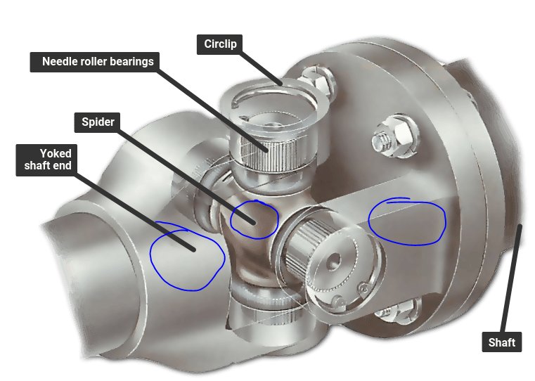

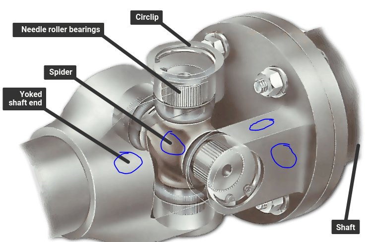

    About the missing zerks & propeller shaft maintenance on the newer models...
    From the Maintenance Manual:
    Propeller Shaft
    Lubricate the propeller shaft spiders and slide yokes with lithium-base chassis grease and the double cardan joint with molybdenum-disulfide lithium-base chassis grease, and re-torque the bolt. Only a qualified technician should perform this operation
    Lithium-base chassis grease here:
    Molybdenum-disulfide lithium-base chassis grease on this thing:

    I don't get it. How are you supposed to lubricate those areas on a 2018+ if there is no zerk?

    I had interpreted the manual as saying, just rub grease onto those exposed areas of the shaft??
    It doesn't seem logical at all, though.

    There are no zerk fittings so you cannot lubricate it. By adding lubrication on the surface, you will just attract dirt and make a mess. This parts are sealed and internally lubricated. Hence we do not have the zerk fittings.
